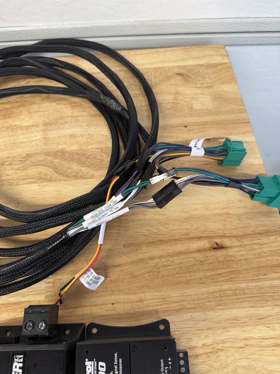

2024 w/ Uconnect 5 here.
I wasn't able to get the right parts, or emails from LLJ customs.... and their facebook page seems kinda hostile towards people asking for updates, in stock dates, etc.
So I got effectively the same thing from PAC.
https://www.amazon.com/PAC-Integration-T-Harness-Non-Amplified-Chrysler/dp/B0CL4V99ZJ
I plan to amplify all 4 channels and add a sub. After attempting to dry-fit all of this crap under the front seats, I decided that's probably going to be a lot more frustration that it's worth. Won't be able to access any of it without removing the seats.
So I'm going to use the tub in the back. I hate to lose that storage but I keep a toolbox in the back anyway, so what difference does it make. It'll keep the audio stuff from getting dirty/dusty from my dog anyway.
If anyone has mounted their stuff in the rear tub, I'd love to see it.

Jeep Wrangler JL Adding an Aftermarket Amp(s) 24-10-19 17-38-14 0958
Did a little fiddling today. Got the T harness ready. Ran a 4GA welding cable across the engine bay, back to the tub.
This was so much easier in my old JK - Lots of room for cables... These new fangled vehicles are bananas with all of the "stuff" in them.

Thanks. Trying to take my time and wire manage it. Got up early today to get the dash apart to install new speaker pods and get the t-harness plugged in if I'm making good time.
