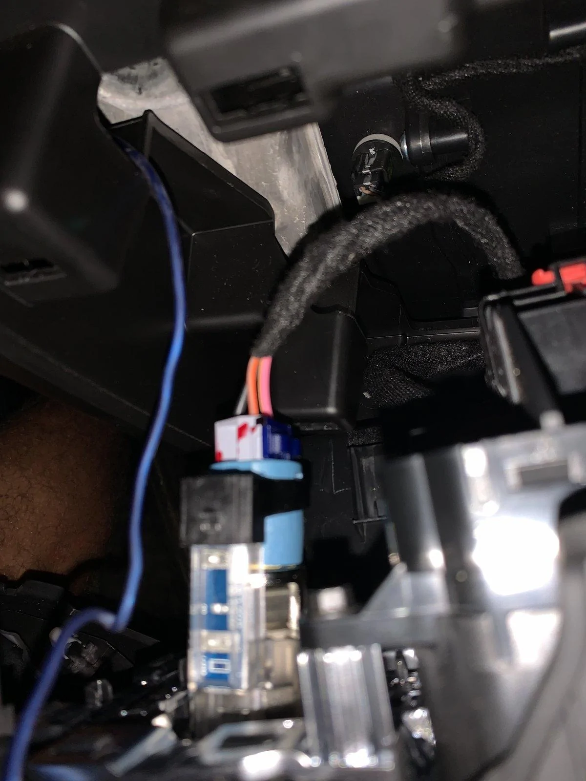

Looking at the back of the accessory outlet up in front on the dash...Which one is the positive wire? The pink or the orange? Going to tap it for my remote amp wire. Can’t find the answer anywhere
Nevermind. Got it. It is the pink one. All powered up
