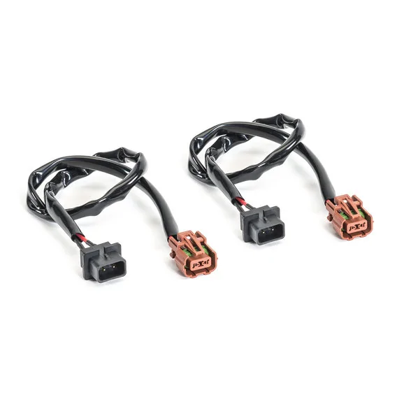

I added lights to my factory fog circuit non-destructively by modifying an extension harness into a piggyback that switches a relay. [And, I use a second relay to switch the additional lights separately.]
The harness is available at Quadratec (the only thing I'd ever buy there):
Jeep Wrangler JL Adding additional fogs to the factory fog light circuit 1000005855
