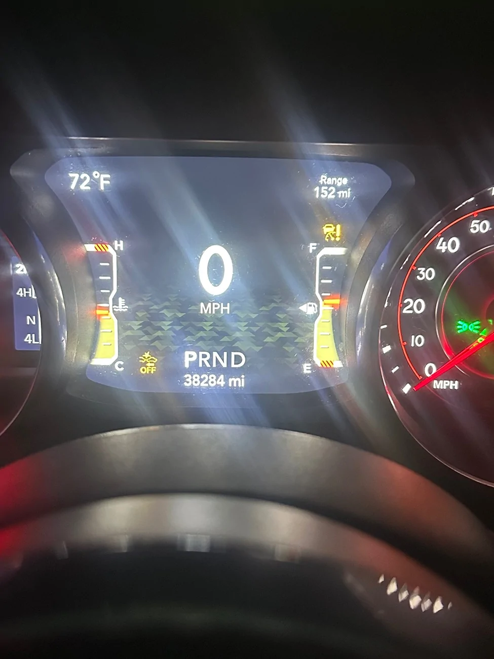

After oil change instead of simply resetting oil life on the screen, I did some “hard restart” something involving pumping brakes 3 times with jeep ignition on, etc.. can’t remember the exact steps. However, after this. I keep getting the “service electronic stability control” message, forward collision detection turned off message, a light for something to do with cruise control, and a red light that stays on below the tach.

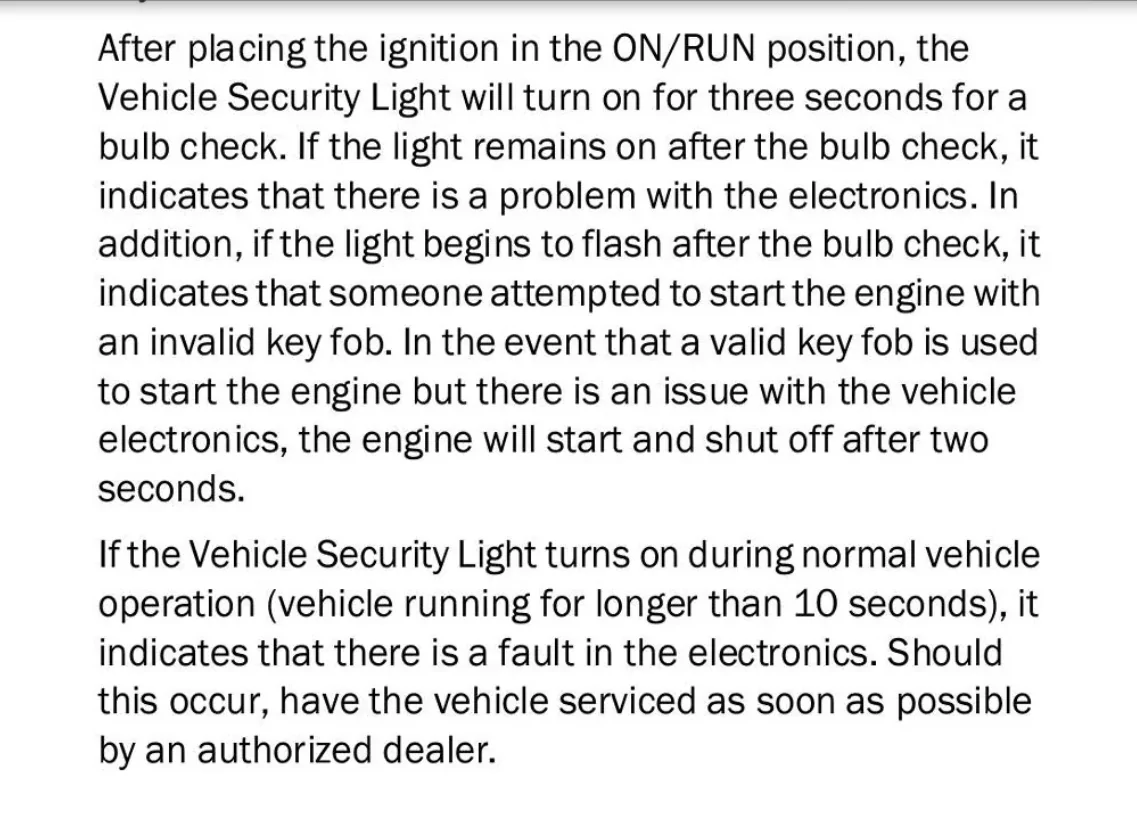

The red light is your vehicle security light. I’m hesitant to say it because it’s a common knee jerk response here, but many people report multiple lights on the dash with battery issues.
It is possible that you may only need to charge your battery. What wires did you put wire loom on? Did you do any testing without the engine running, like running a winch, that may have drawn down the batteries. Here is a pic of the owners manual regarding that light.
Take the last line with a grain of salt

Battery voltage checks good. I even bypassed the aux battery this morning and I’m still have the issue

Lights were gone for a bit but came back again, this is with winch and accessory lights disconnected. I don’t know what to try next. Still have aux bypassed
