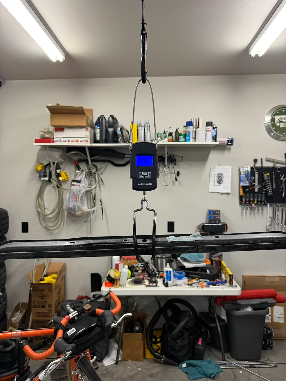

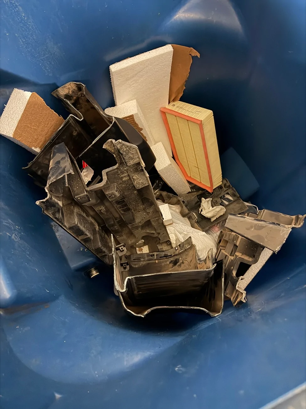

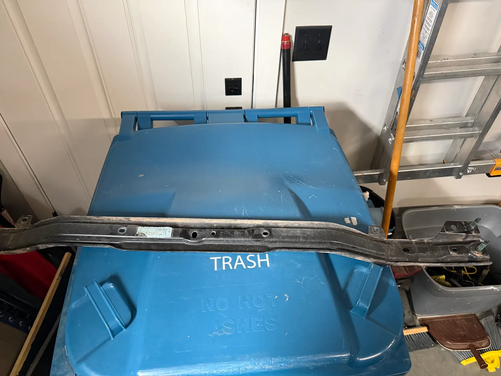

not really it is a thin steel piece that weighs 3.97 lbs I did not weigh the intact bumper but it was not much. I cut mine up to throw it away. the thin 3.97lb is the only metal in the rear bumper.
