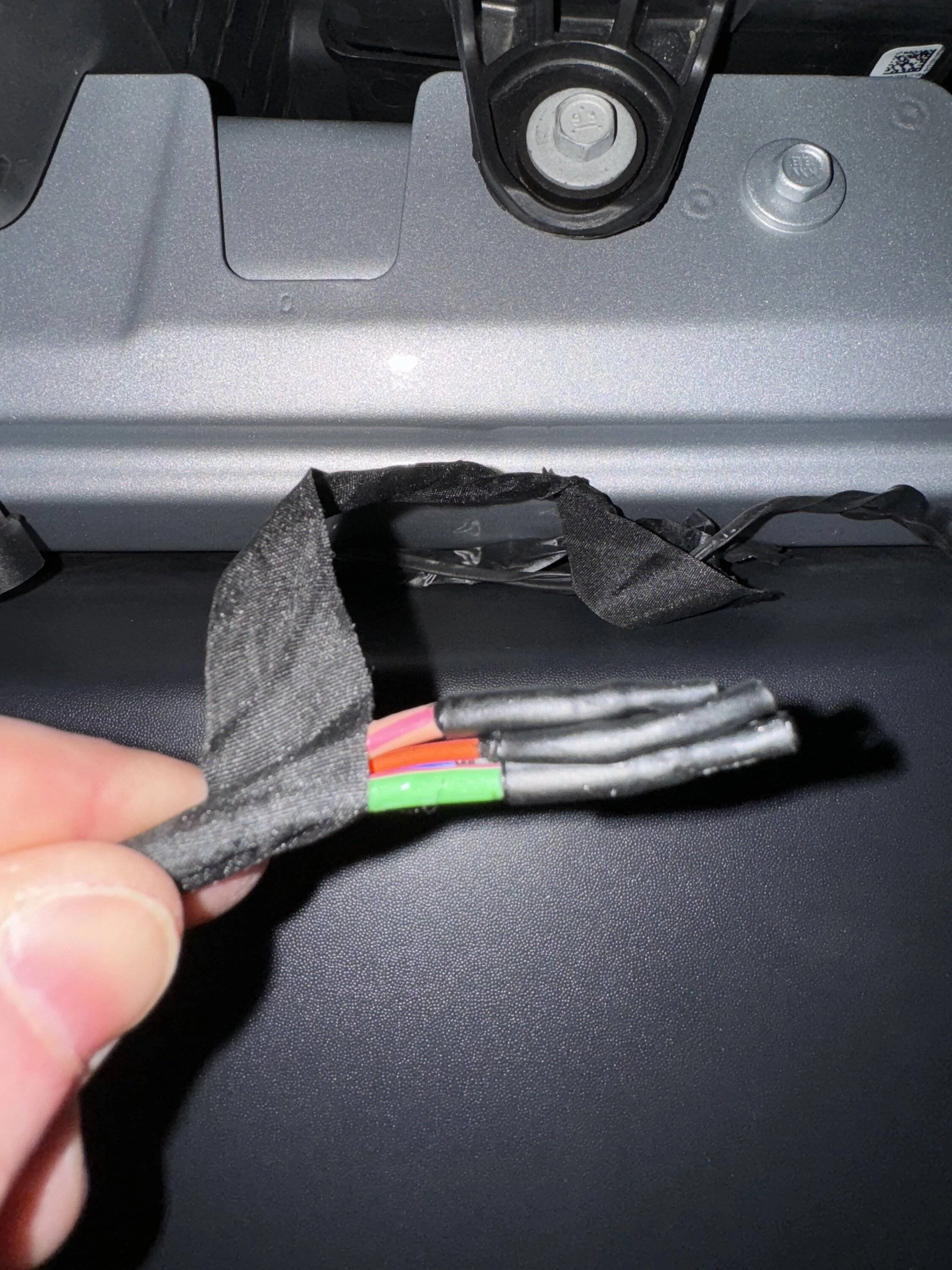

Hmmm try this when you can. Remove the passanger door check/strap cover. Just pulls out gently. Remove the door wirin plug. Then there is another large cover gently pull back. White clips might fall off. But you can put it back There should be a set of wires with shrink wrapped tops. 2 thick ones 2 thin ones. Those are hot wires.

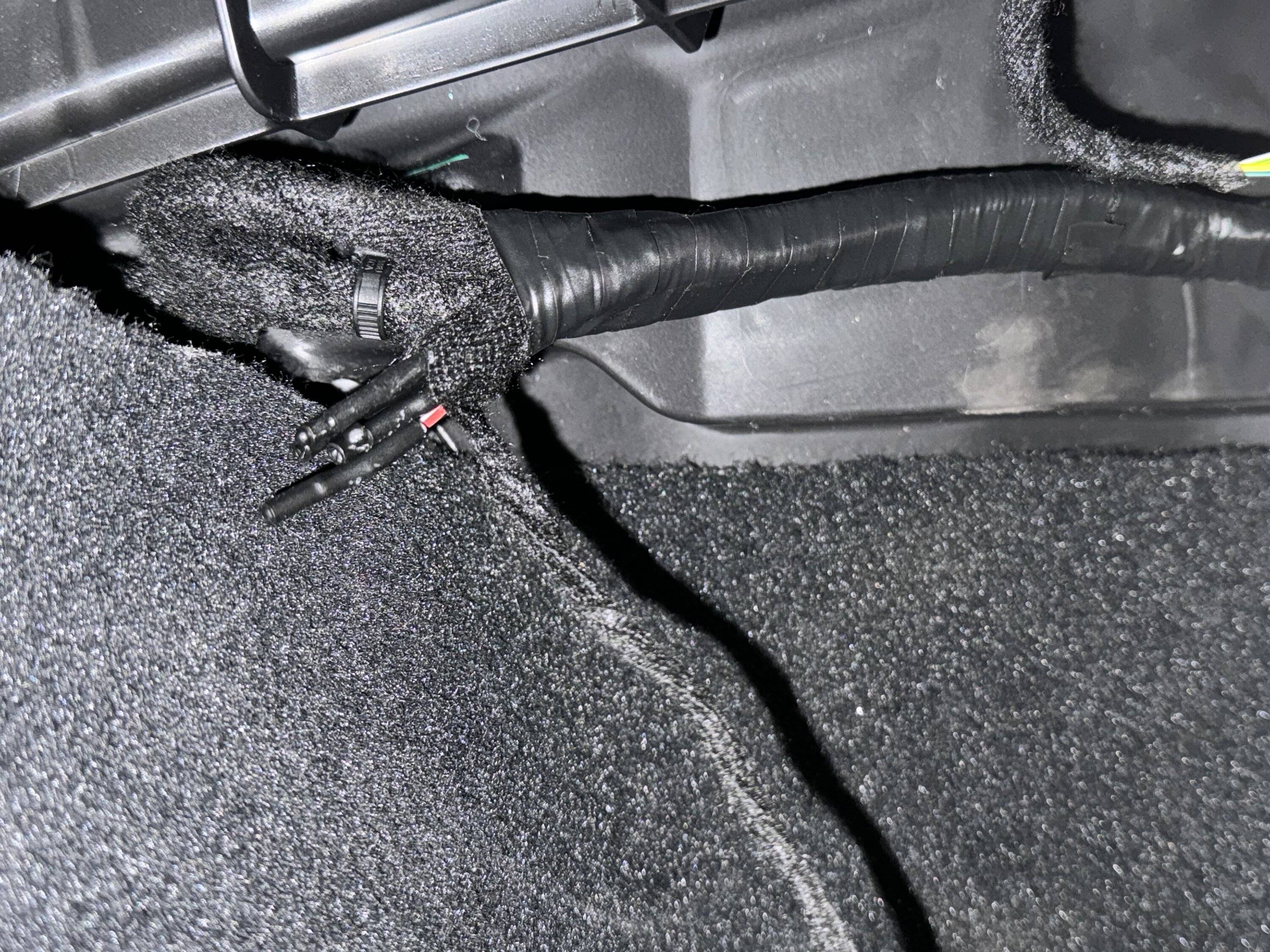

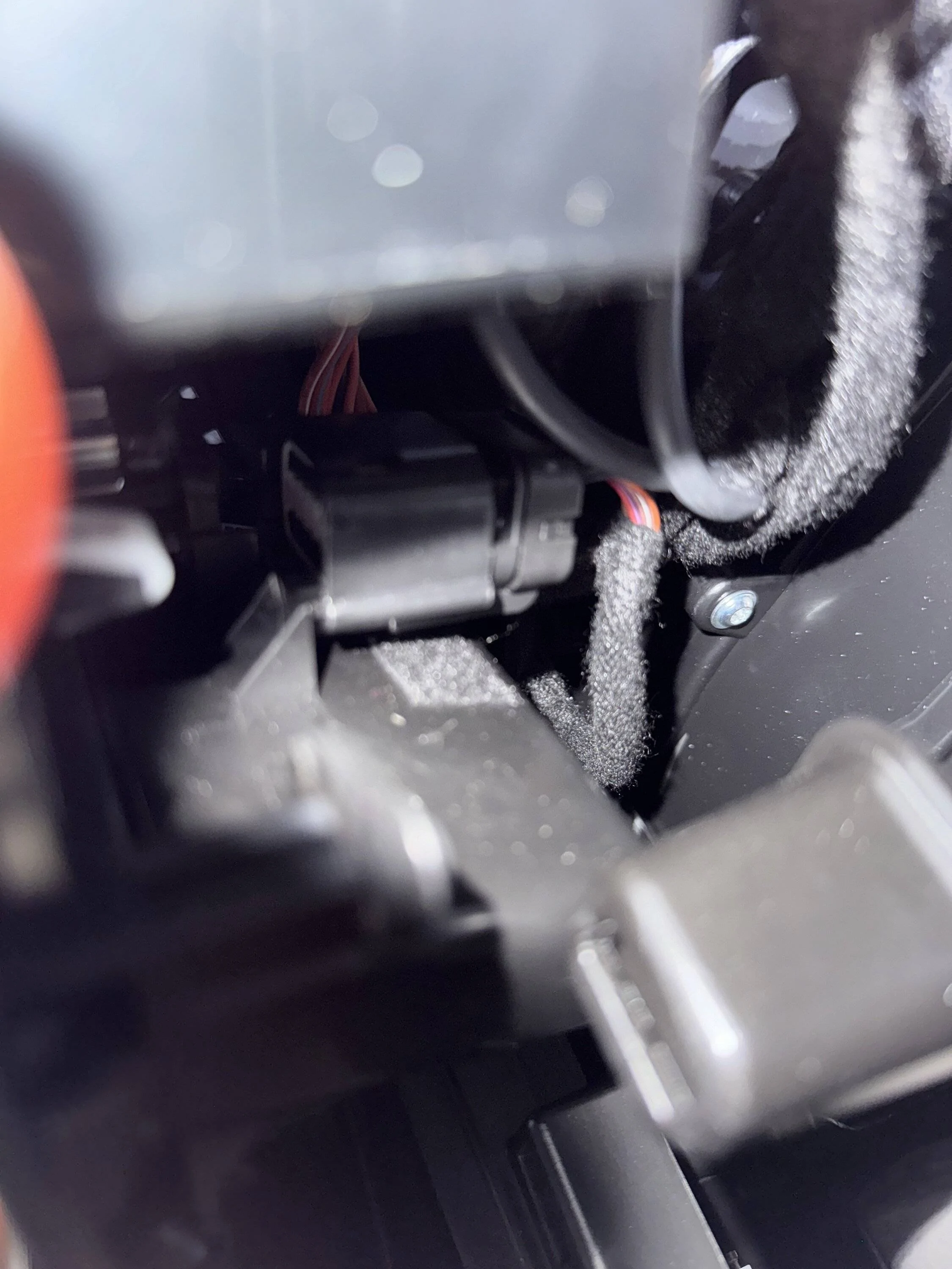

So I’ve got a 2024 Wrangler JL Willys, I do not have the switch controller in the dash however when I check my engine bay and passenger floor foot well, I have the four wires present and wrapped up in a wiring loom. I also have the proper fuse in the fuse block in the engine compartment.
does this mean I just buy the switch assembly and install it in my dash, flash and I should be good working?

I wonder if you have the connector for the switch assembly in the dash harness?
Gregj
lloydrage
Apr 3, 2024
17 jk. 22 jt. 23 jl.
Yes, I added the switch flashed it. Everything works
Sweet! Can you link the button? I was worried I had to add relays and fuses
scratch that. Can’t find the wires on my wife’s JL. Thanks though!
