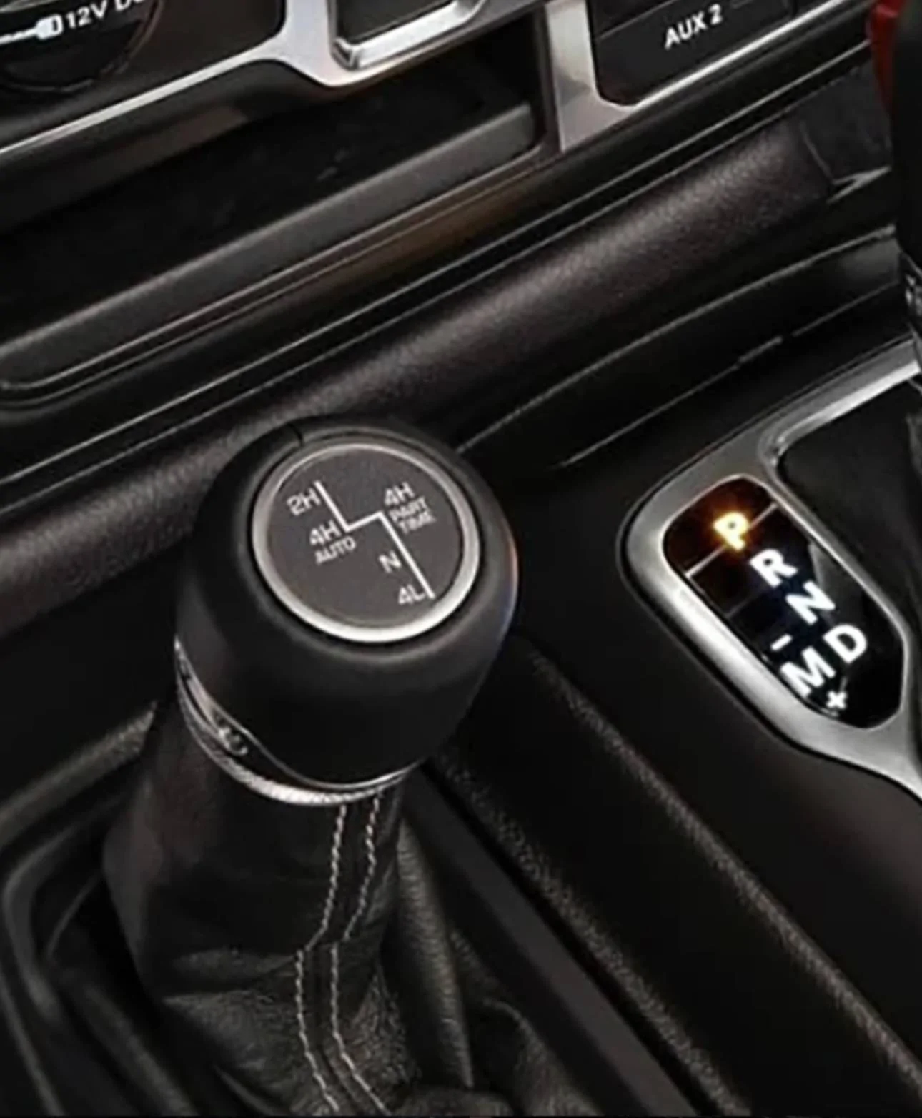

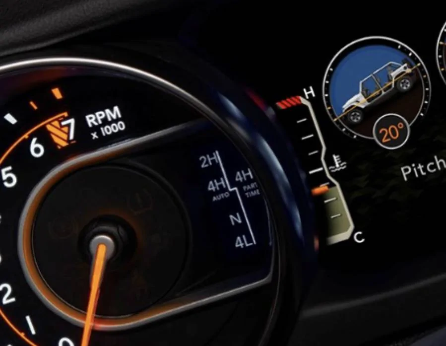

Shopping online isn’t easy.
On interior pictures, try and zoom-in on the left cluster or transfer case shifter and spot it. You are absolutely right that the difference on slippery surfaces is night and day. My jeep has it and is by far the most competent wrangler I’ve ever driven in a winter storm.
