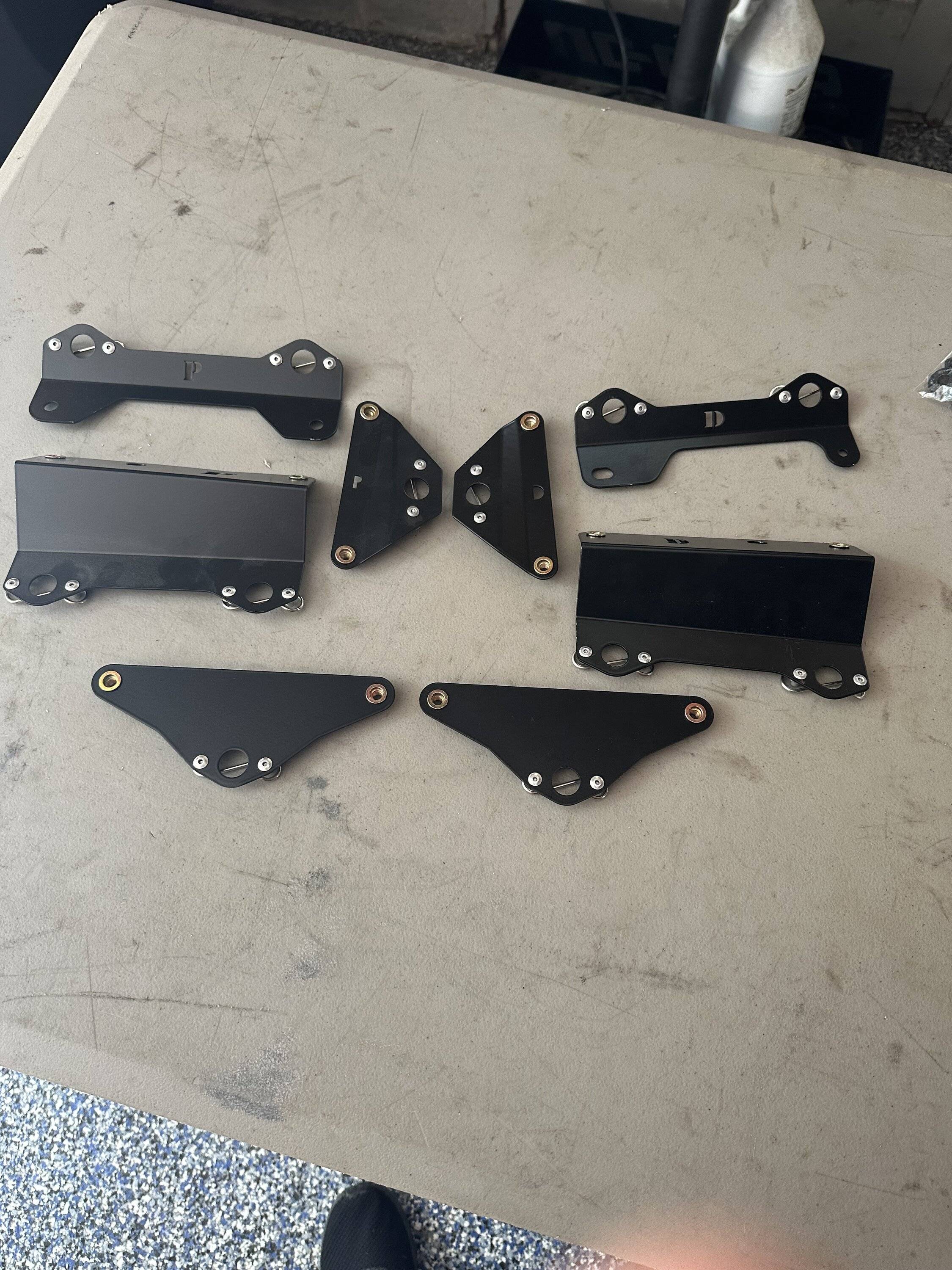

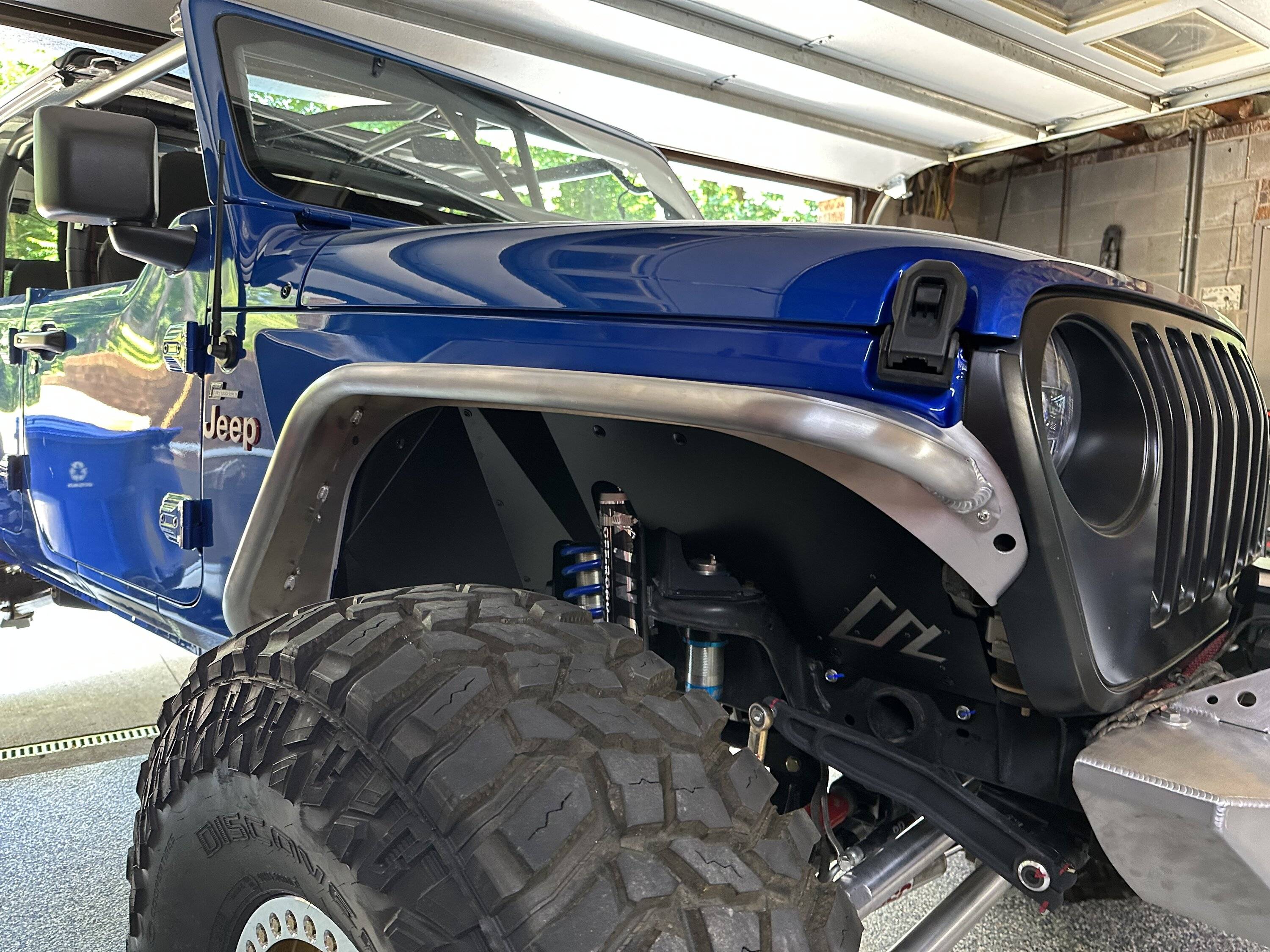

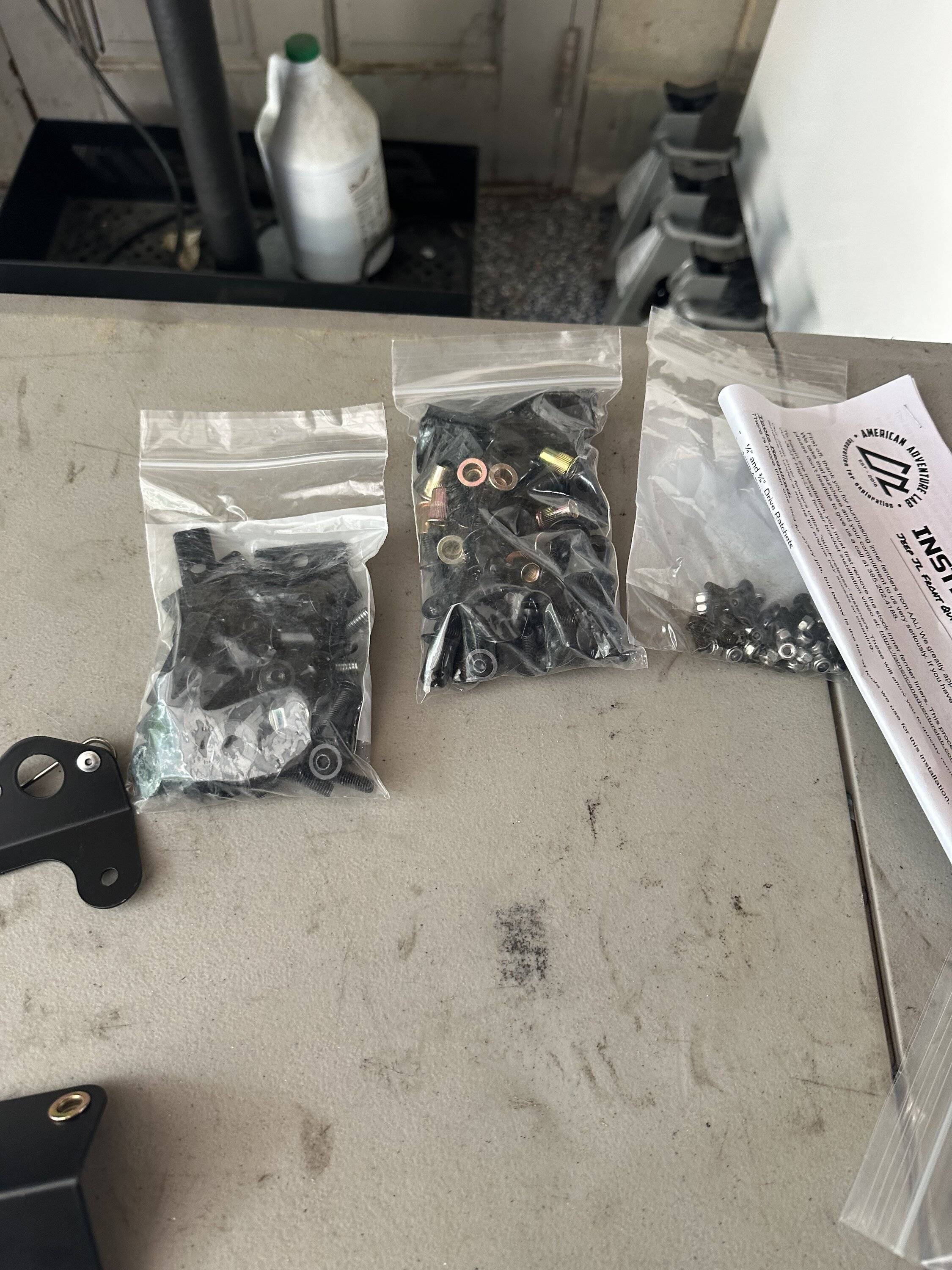

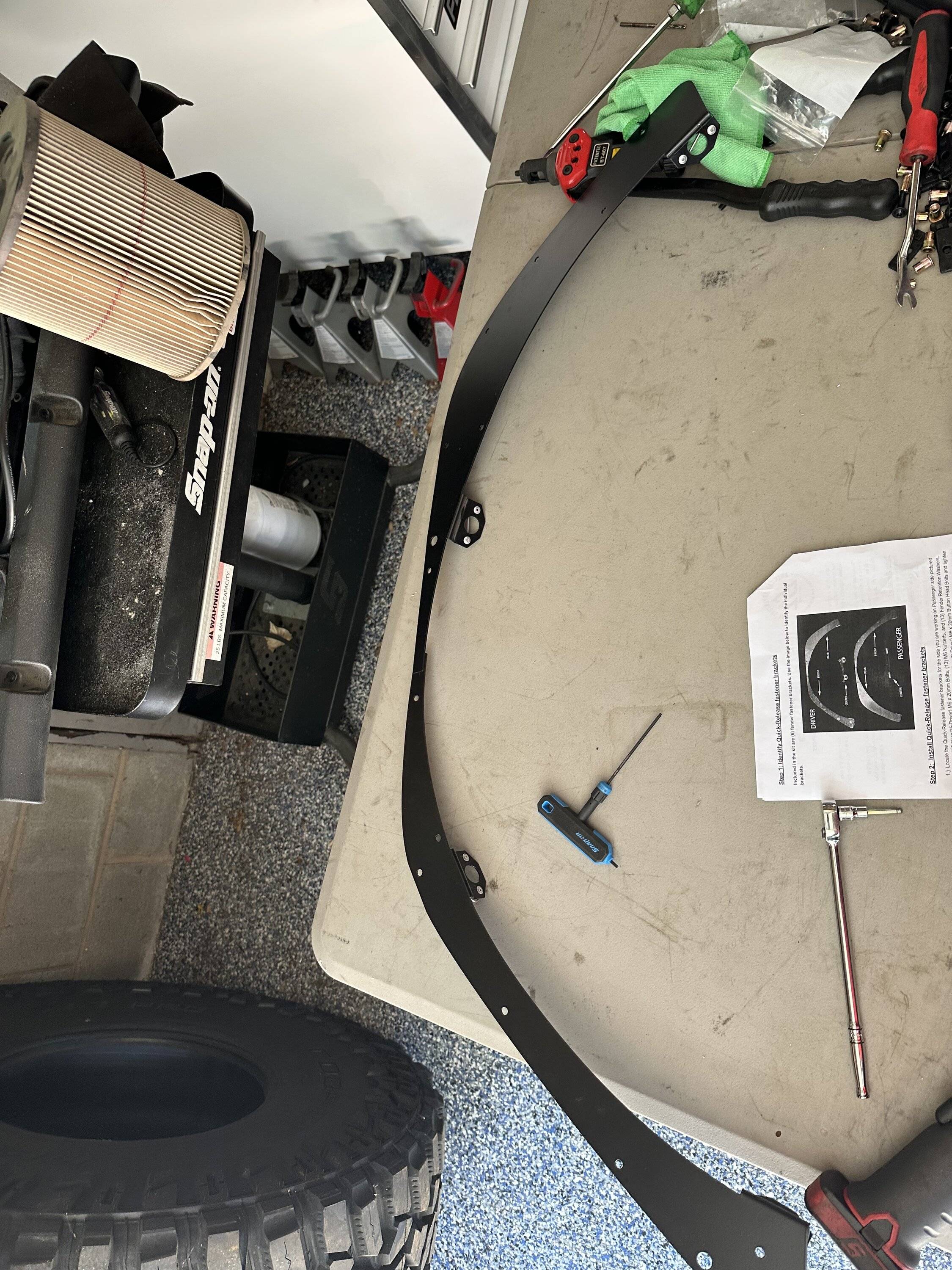

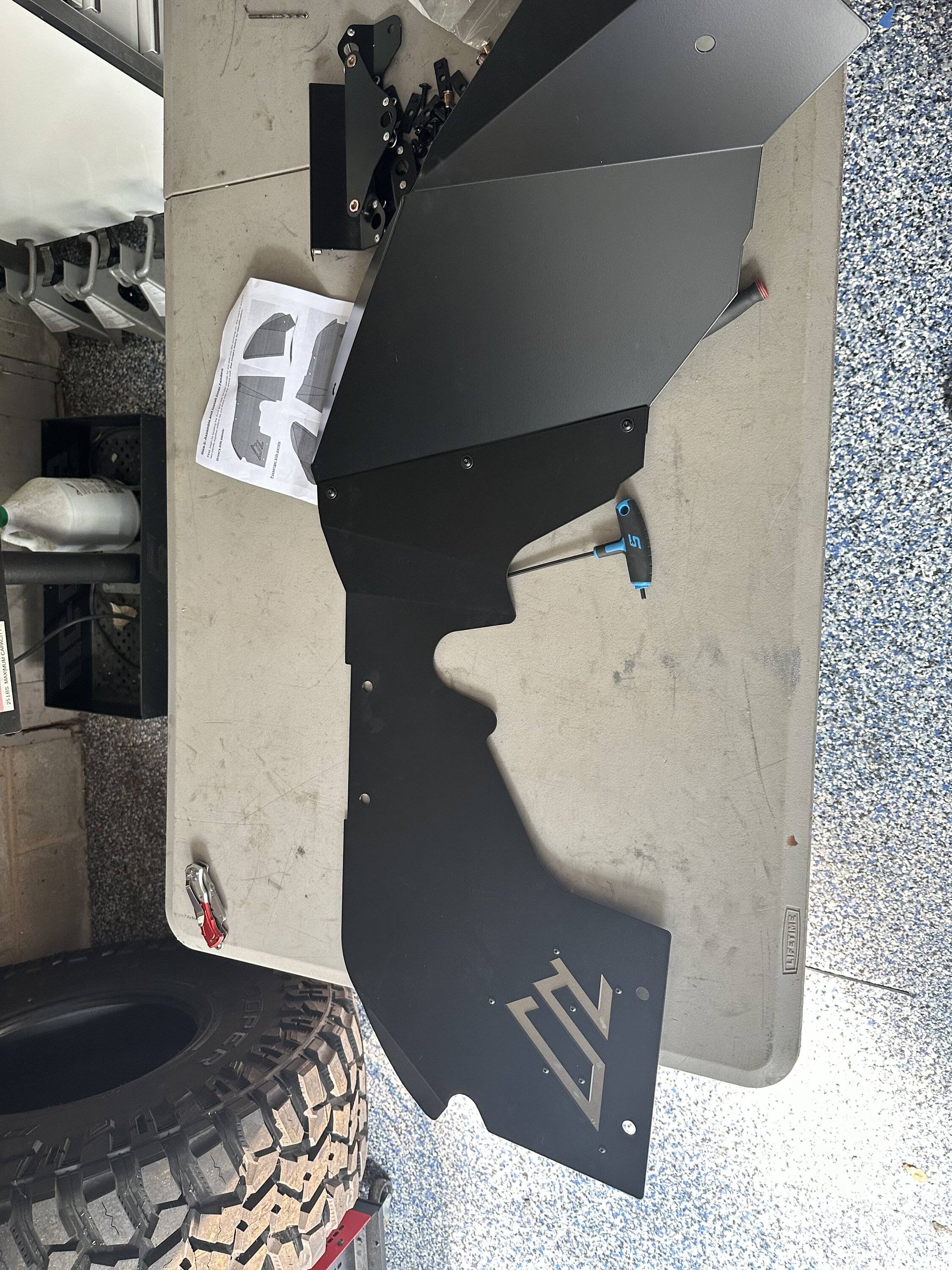

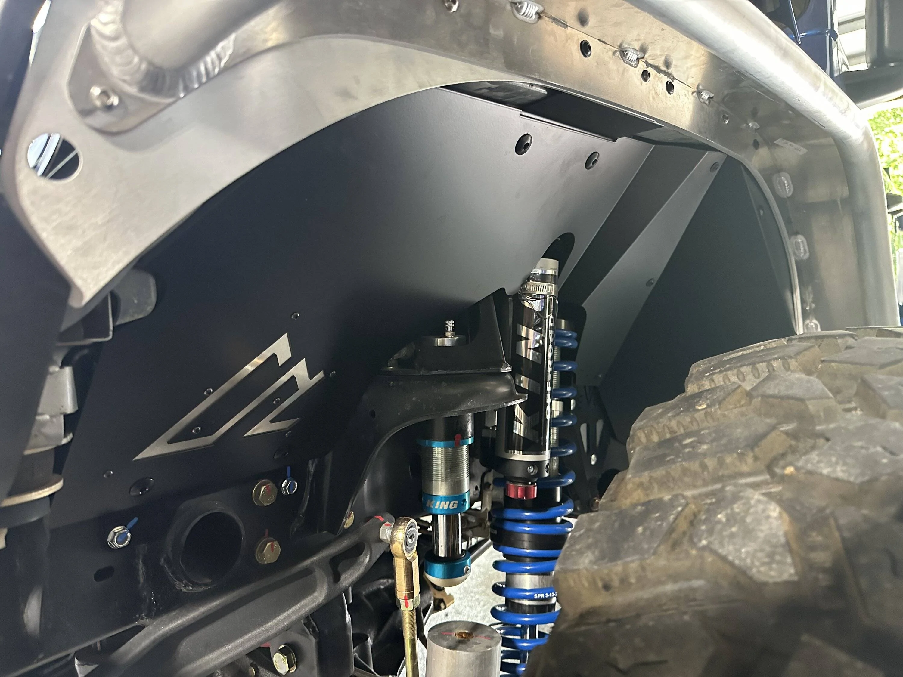

I grabbed a set of AAL Liners.
Had mine pre-cut for the EVO Coilovers, but they do offer several different cuts for different suspensions. @conFUcius and I installed the front set on his Jeep this past weekend. They are really awesome.
Mine will take a couple extra steps, but the install is the same for everyone. With the GenRight Fenders, I'll need to get some longer screw and whatnot.
I'll snag a video and more pics as I go through this.

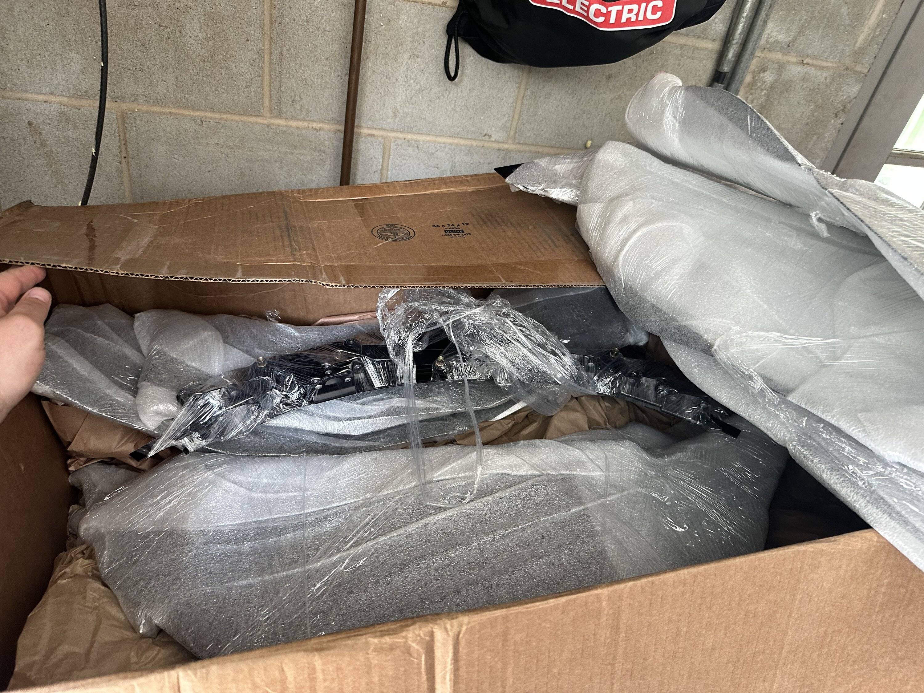

The packaging was done very well and none of the powder coated parts were damaged in my set or Stephen's set. His had one nutsert not pressed in properly from AAL, but we were able to replace it just fine. Otherwise, initial quality out of the box is great.

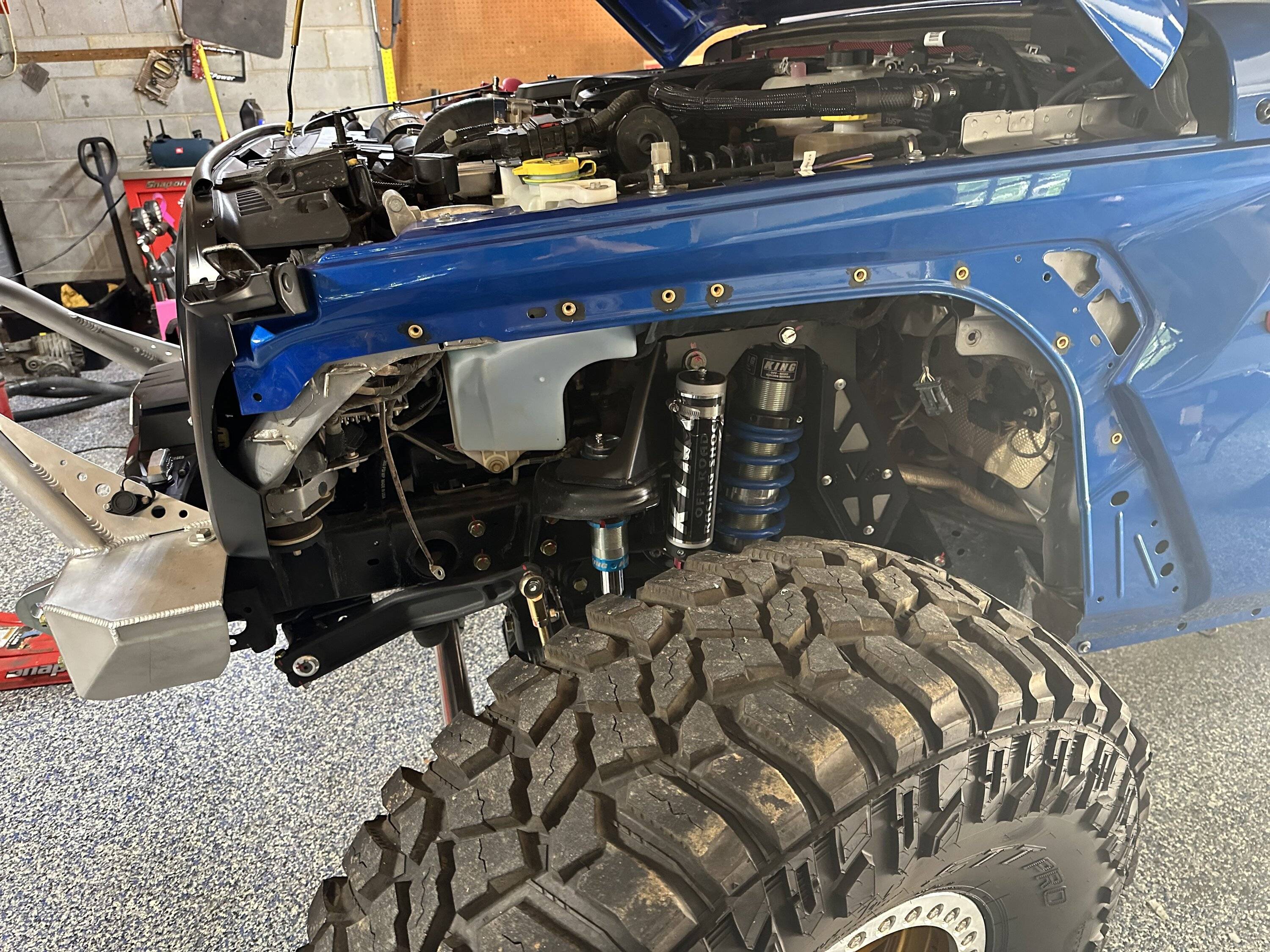

Nice! I put them on mine a couple months ago when I did my fender chop.

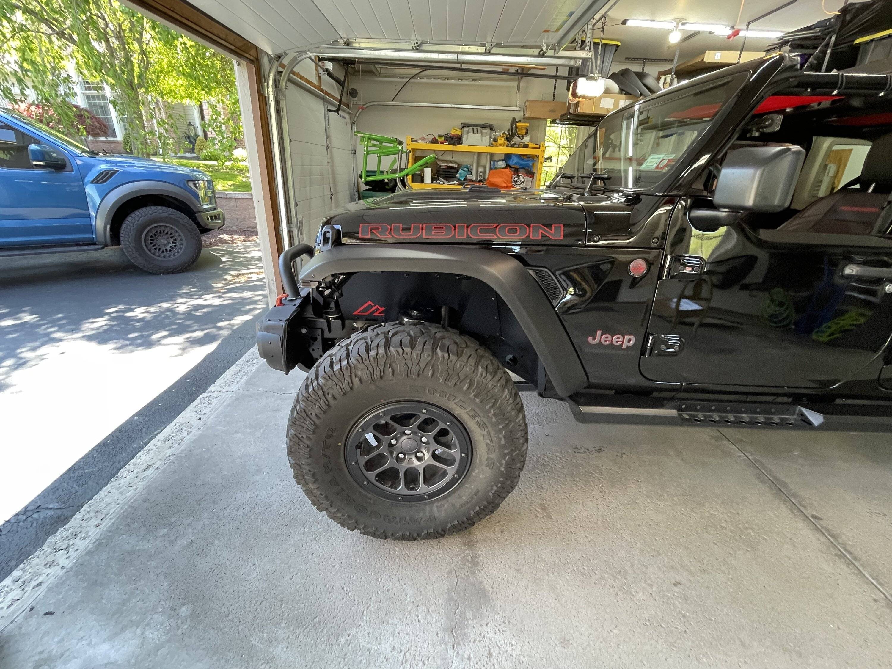

Stephen waiting 3 weeks or something for his. Mine showed up in 5 days. Lol. They arrived at my house here within a day of each other.
I waited about 6 weeks. When I called they made it sound like black powder coating is custom and takes time. Lol. But I like the product.

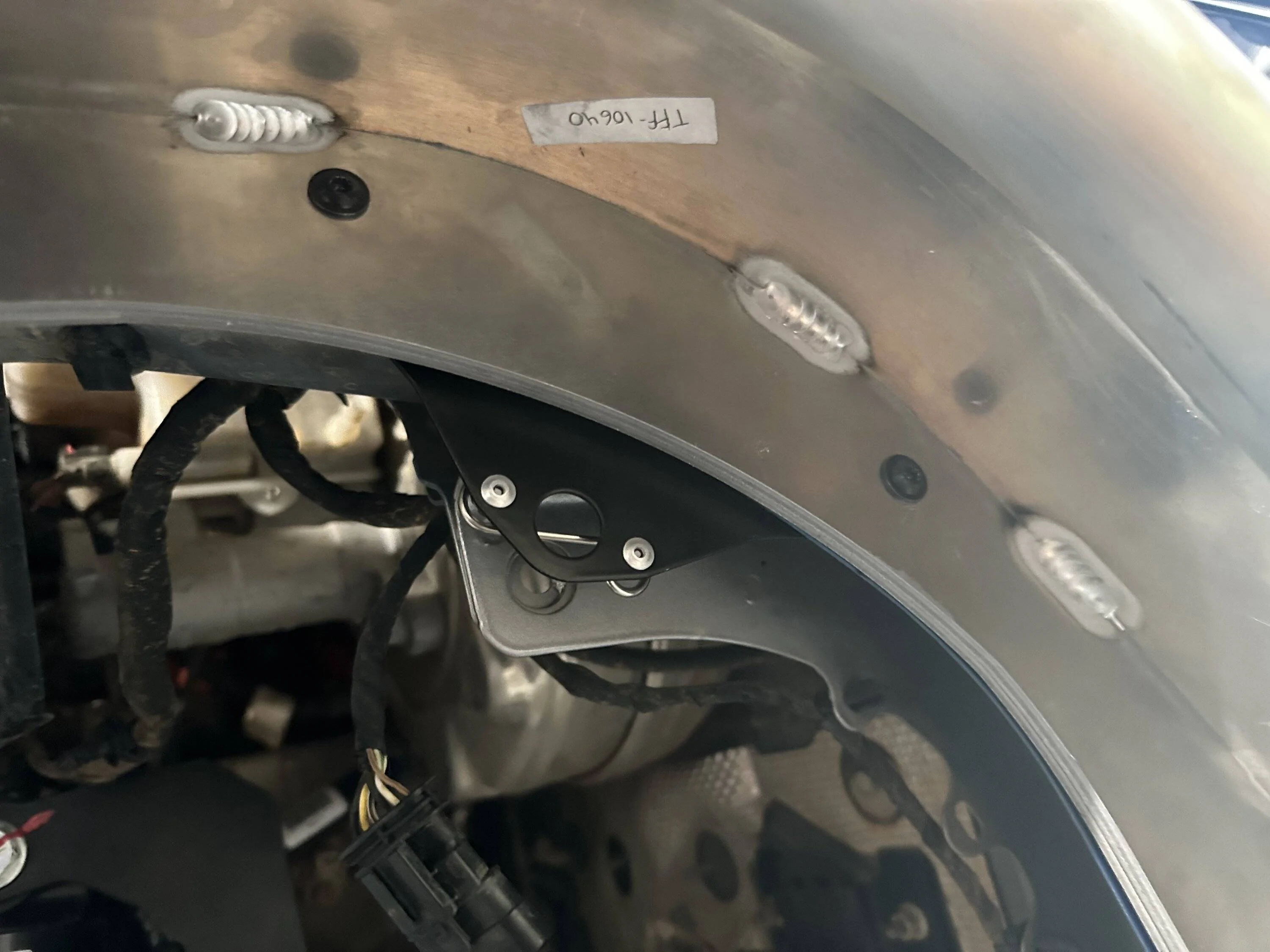

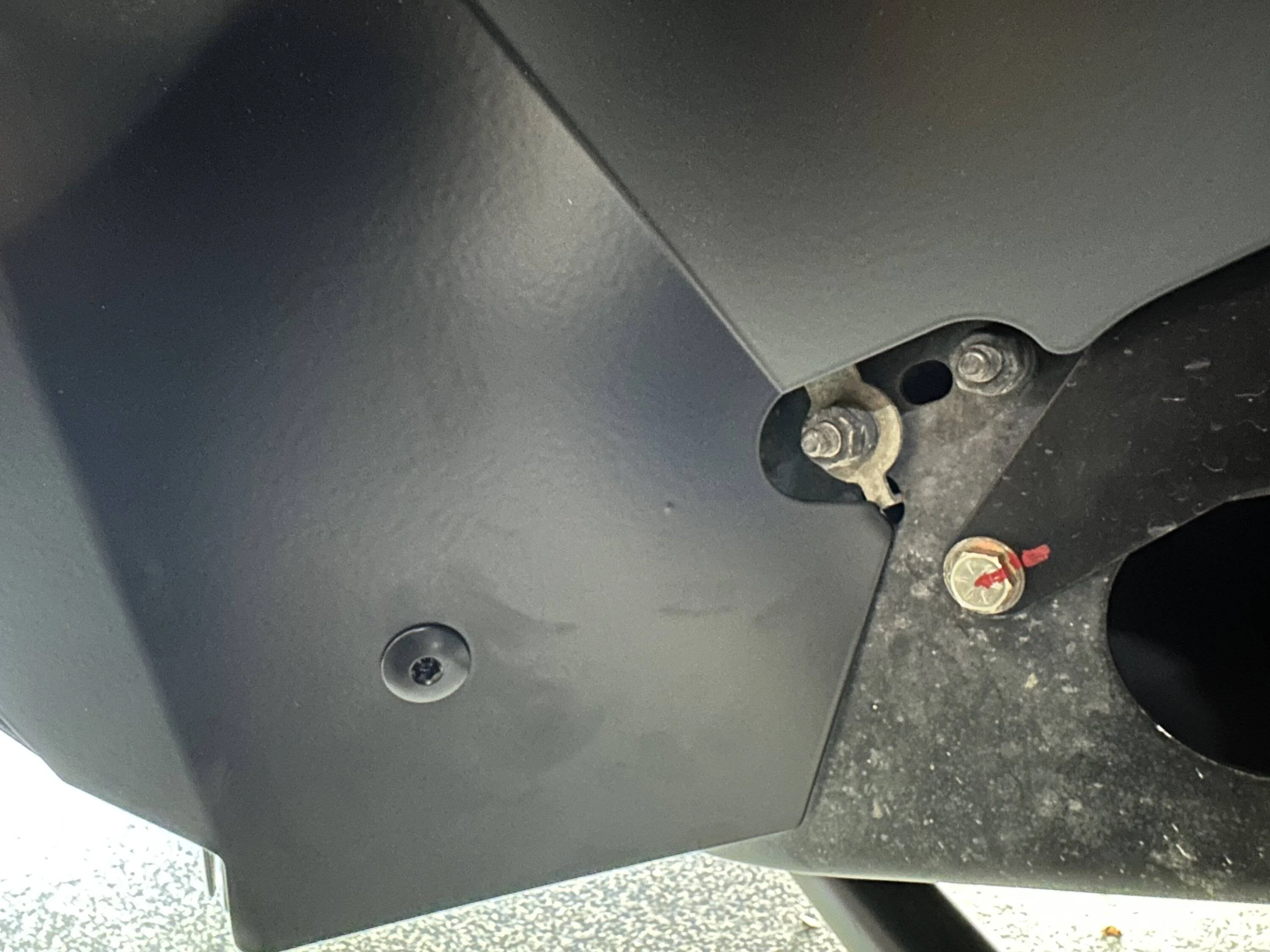

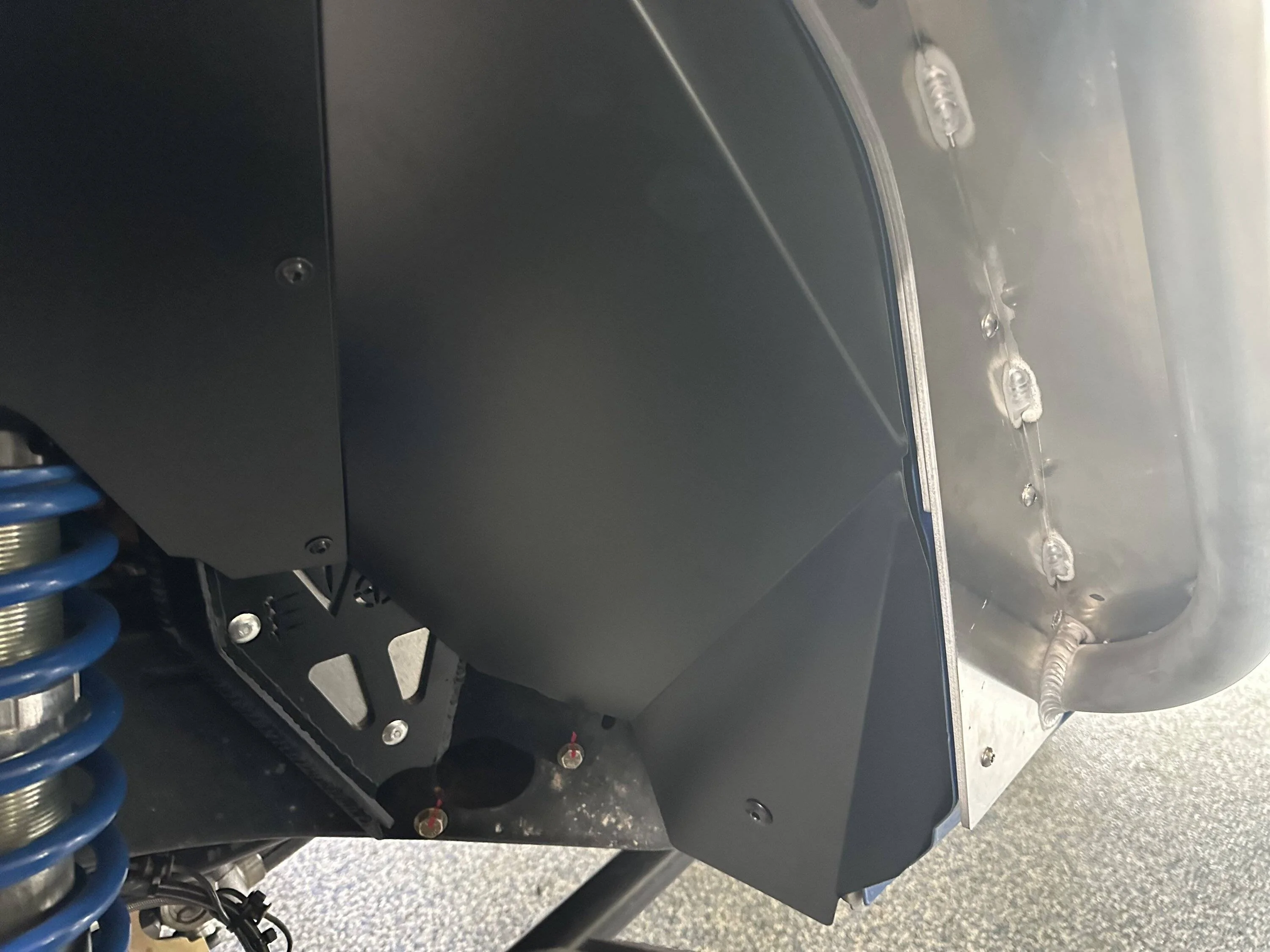

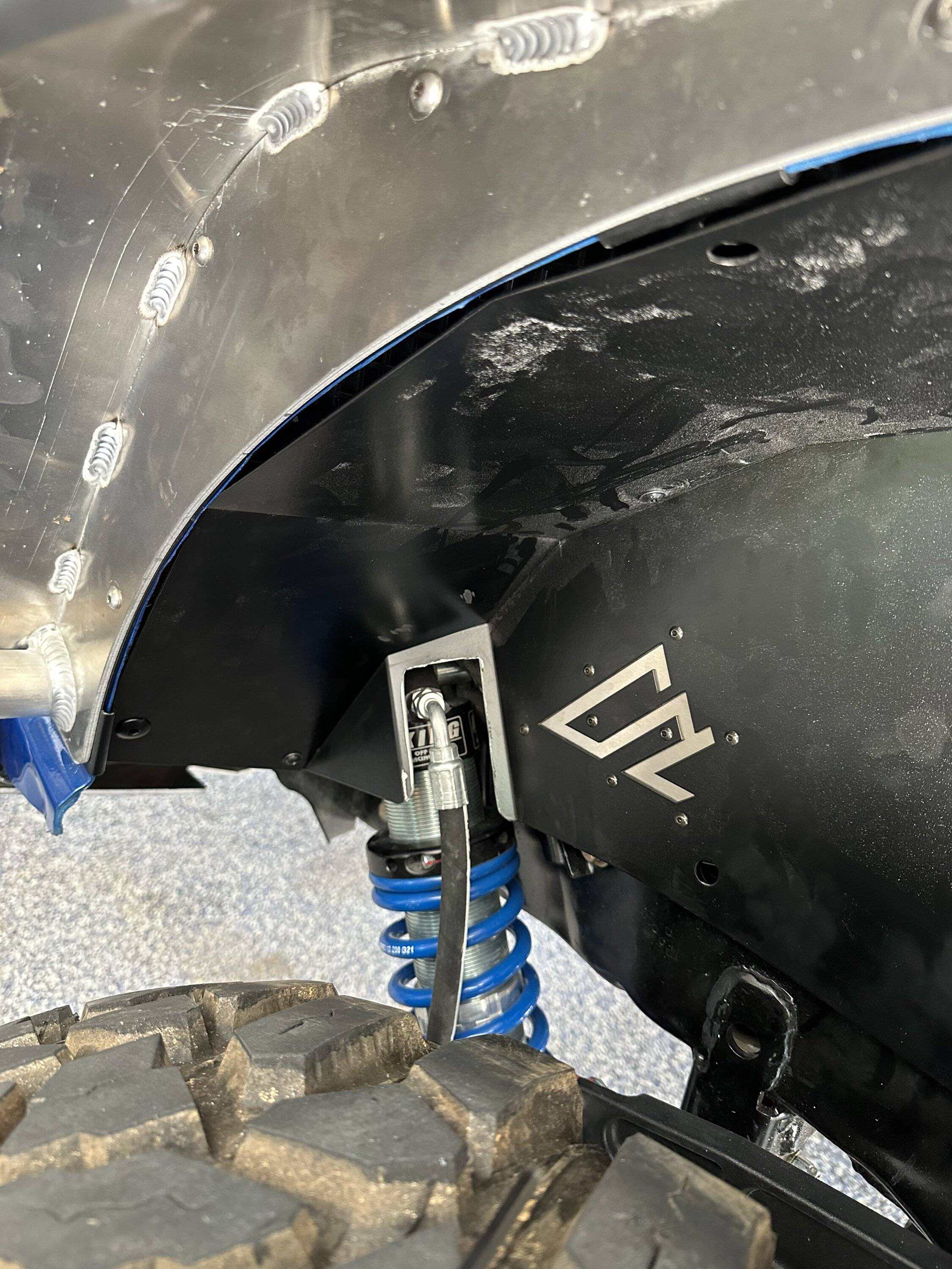

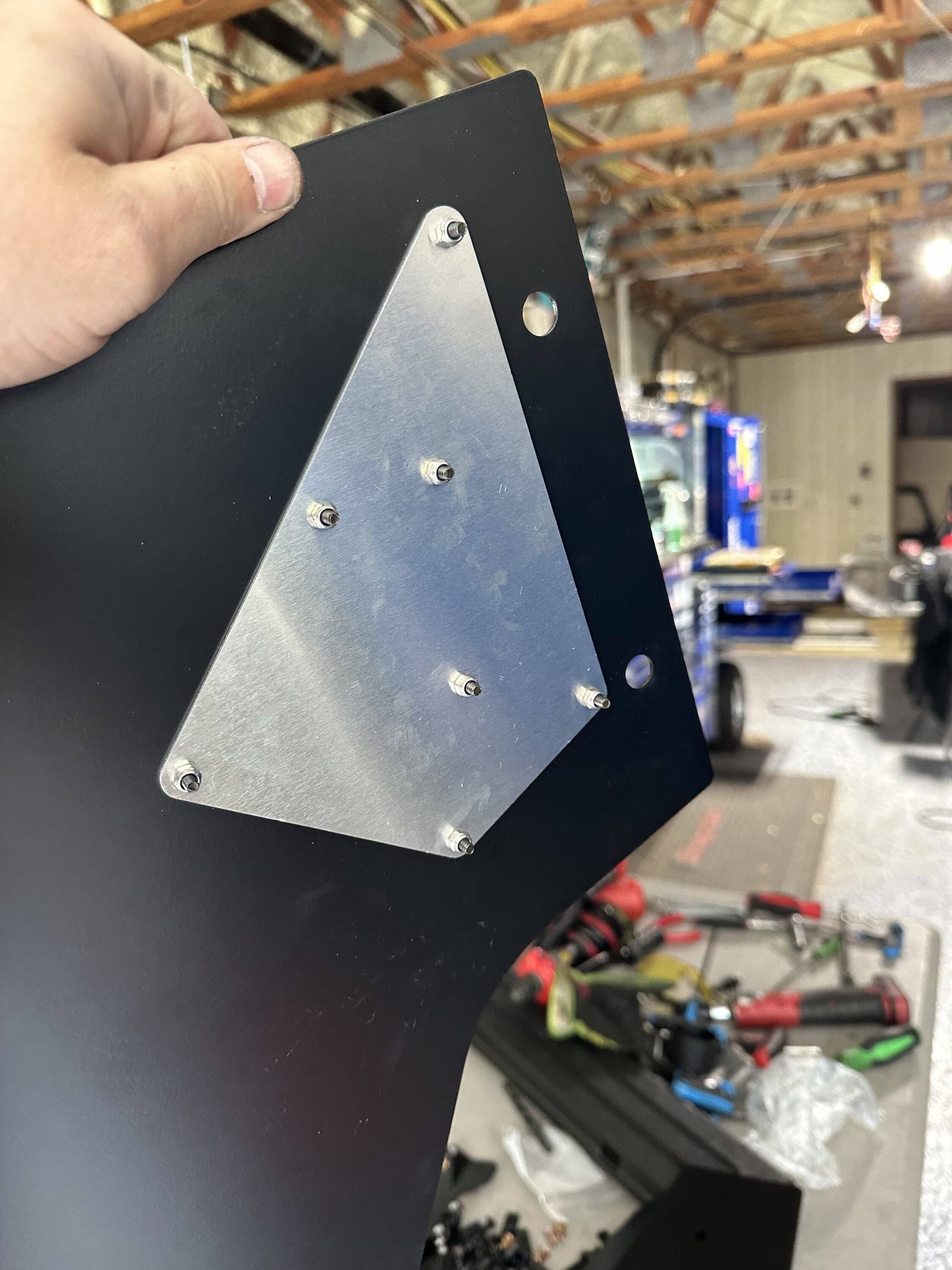

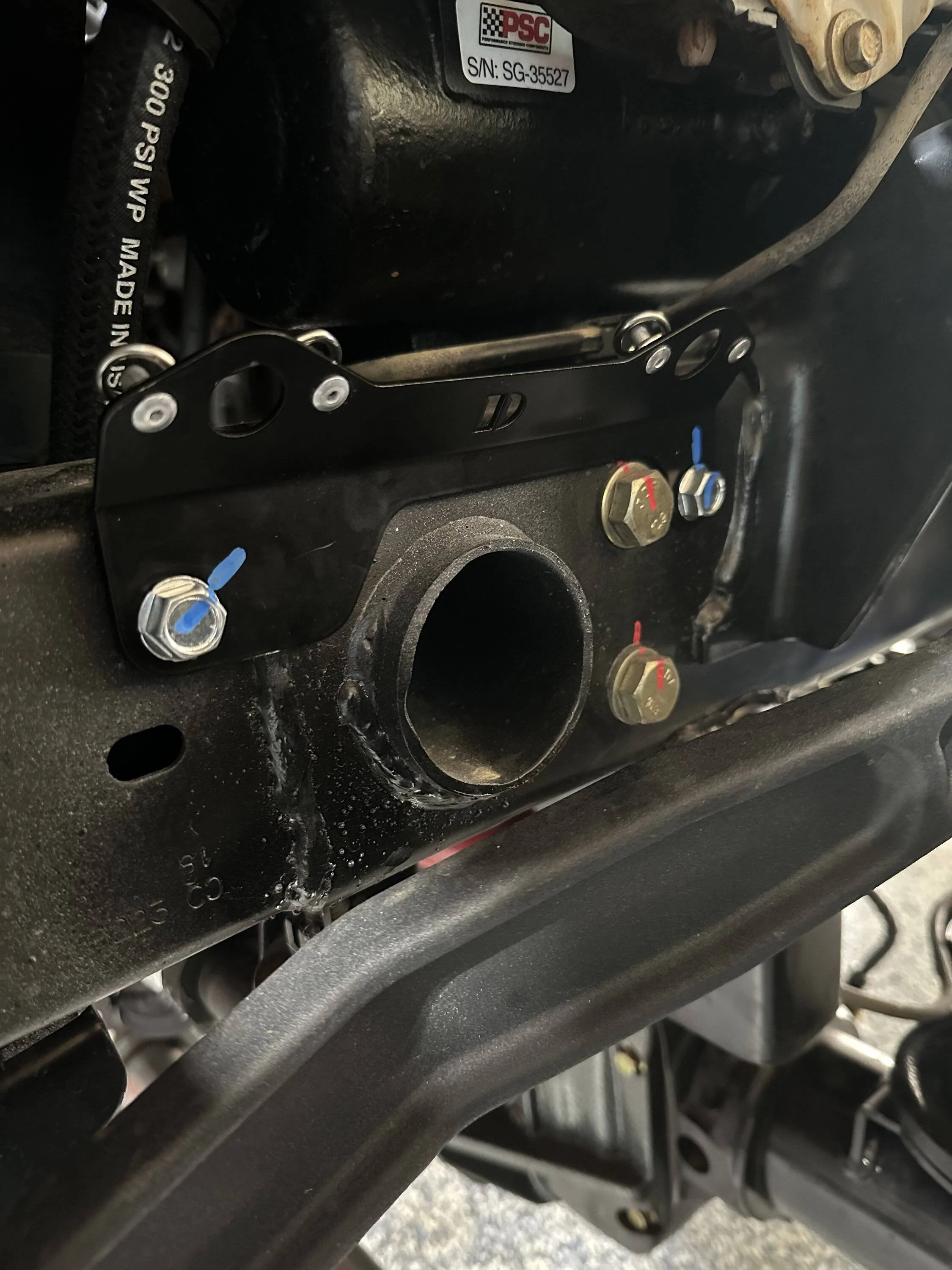

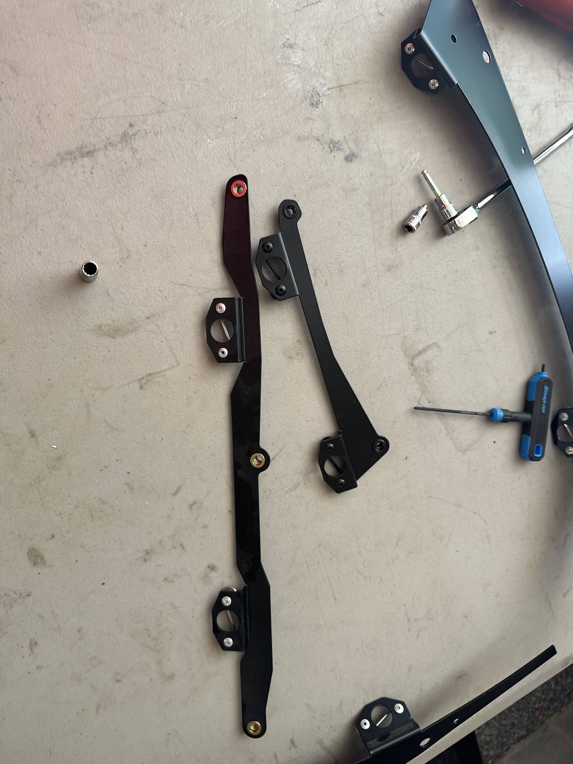

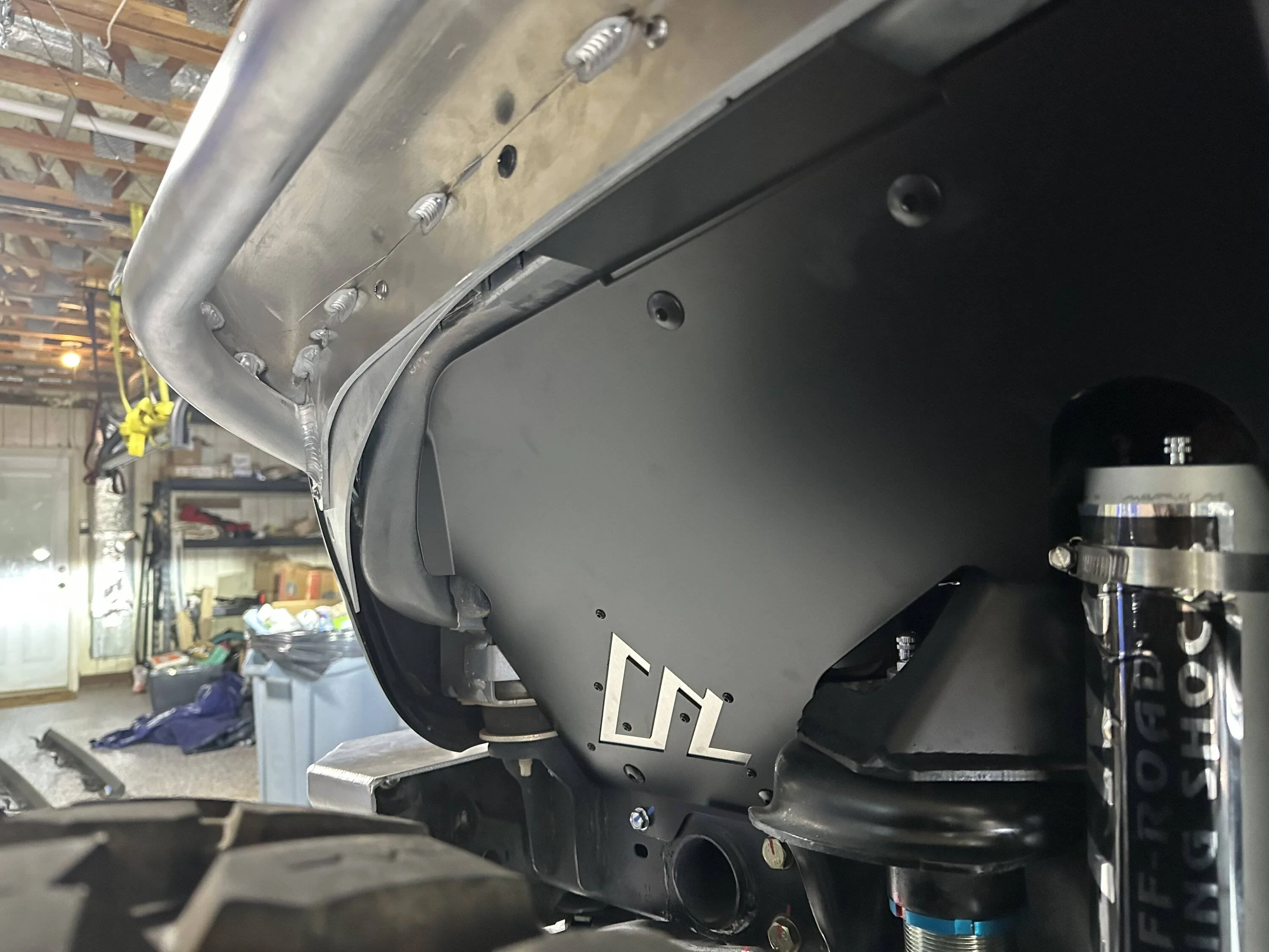

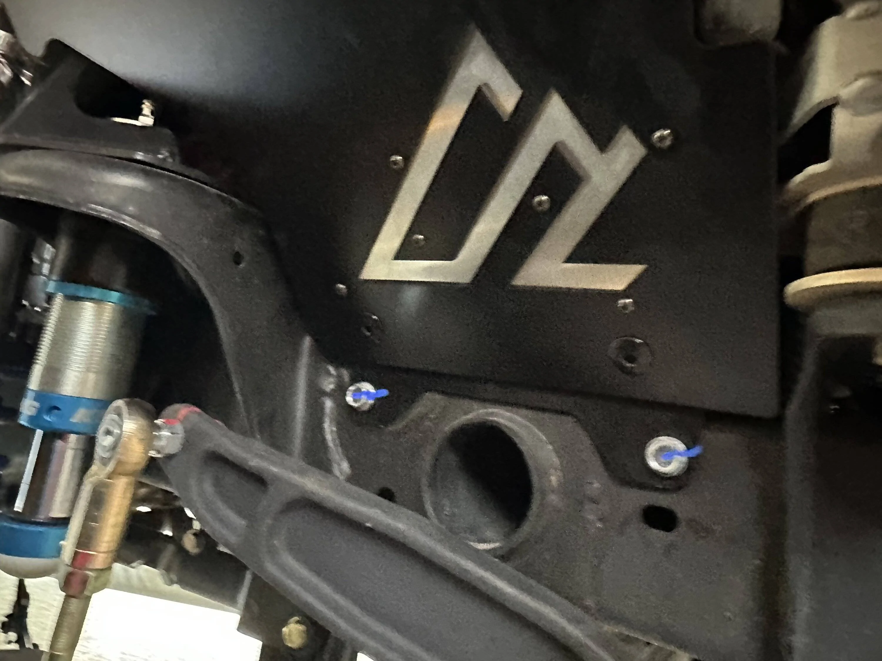

Drivers side brackets.
Got the 2 nutserts drilled out. The one in the middle; the AAL bracket comes with a hole there for the fender alignment pin that’s on the factory fenders. (I would just cut that alignment pin off if you’re running factory fenders.)

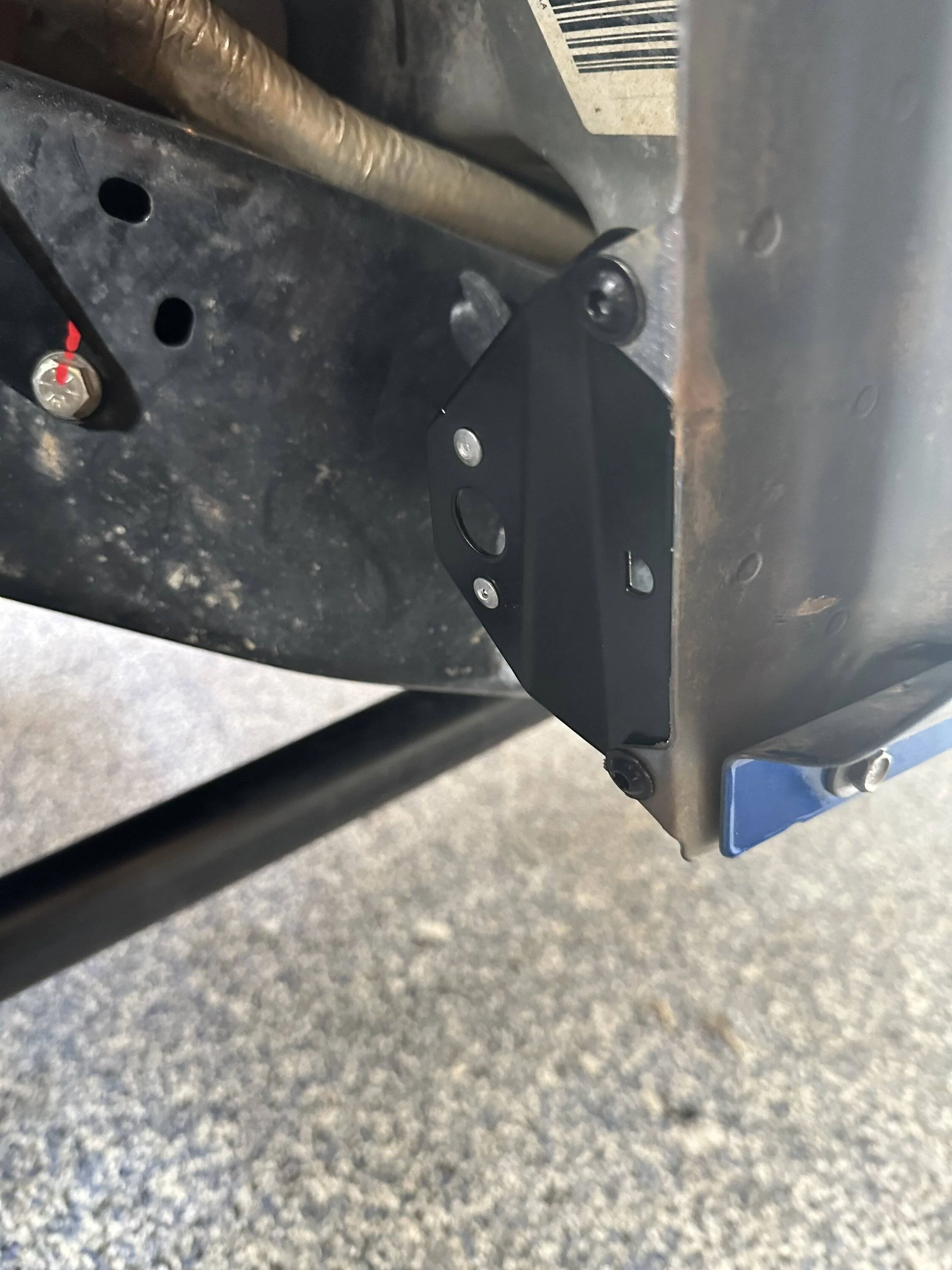

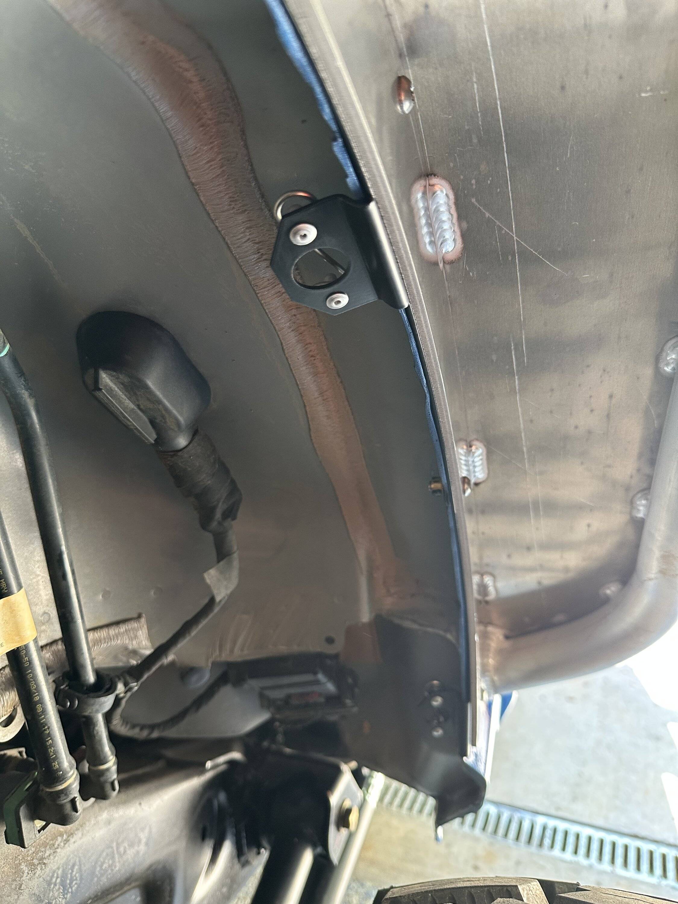

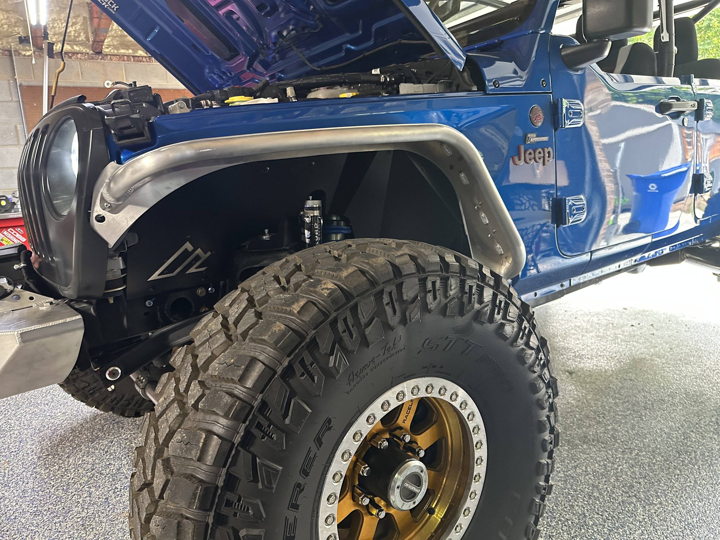

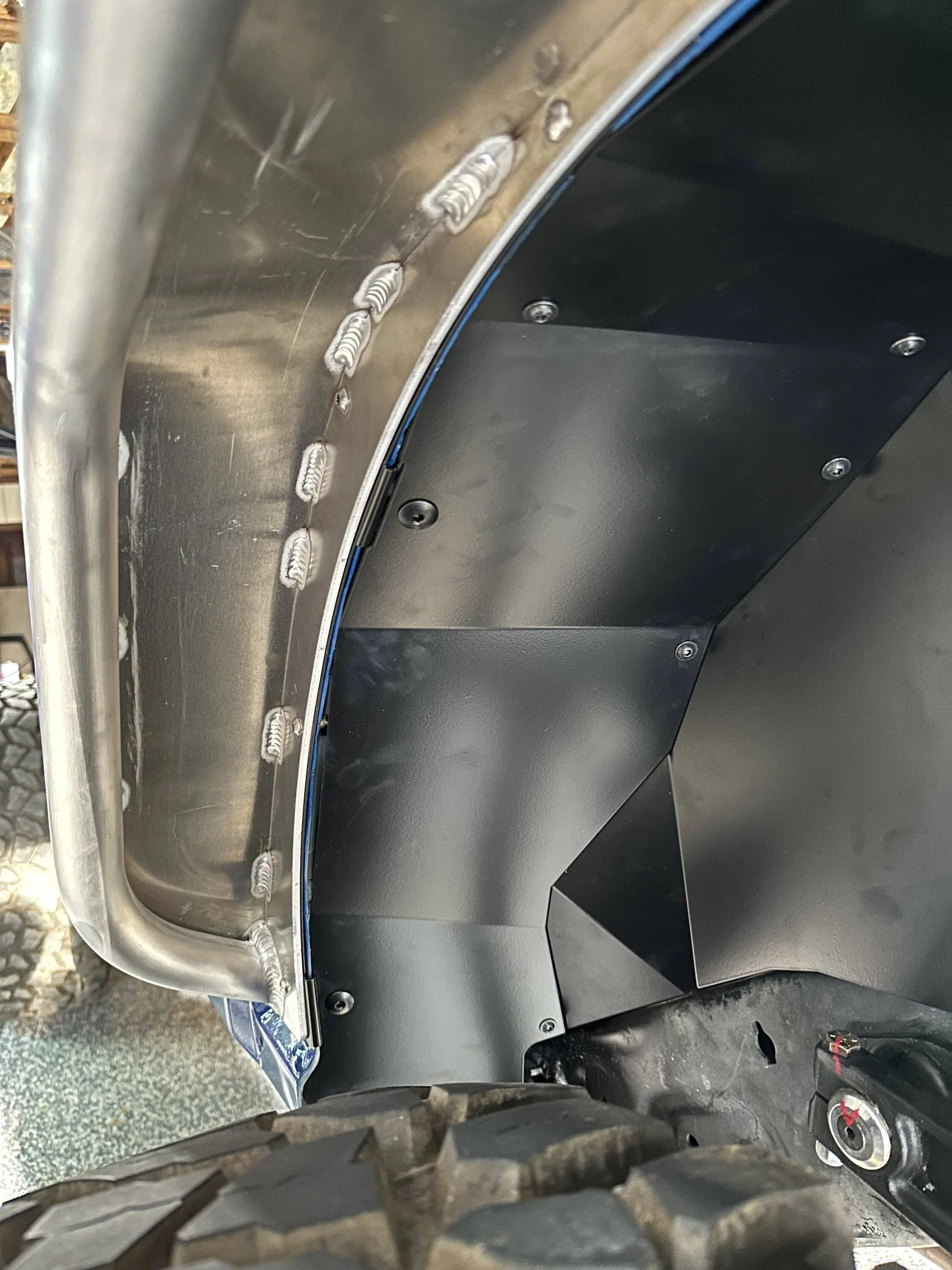

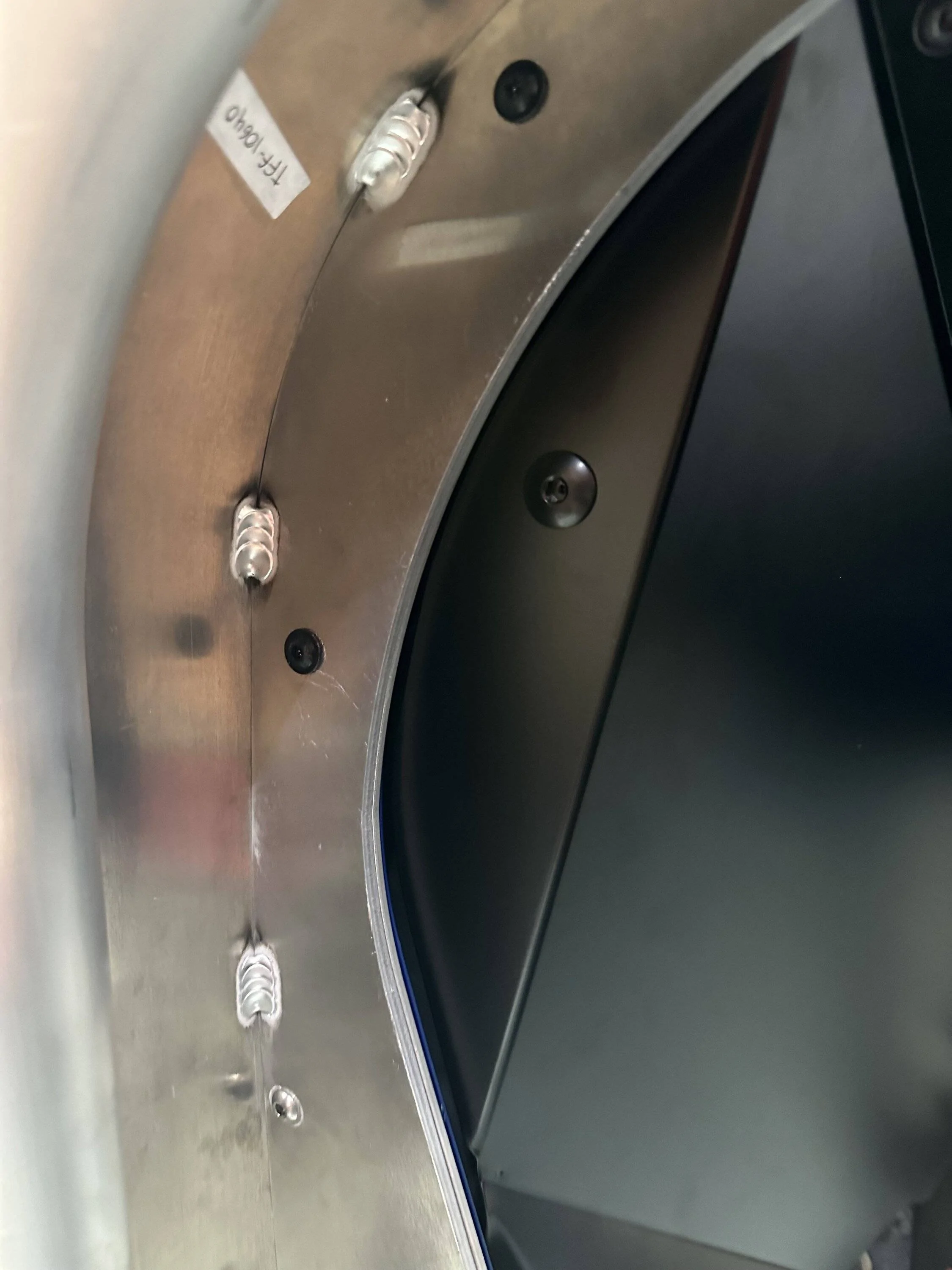

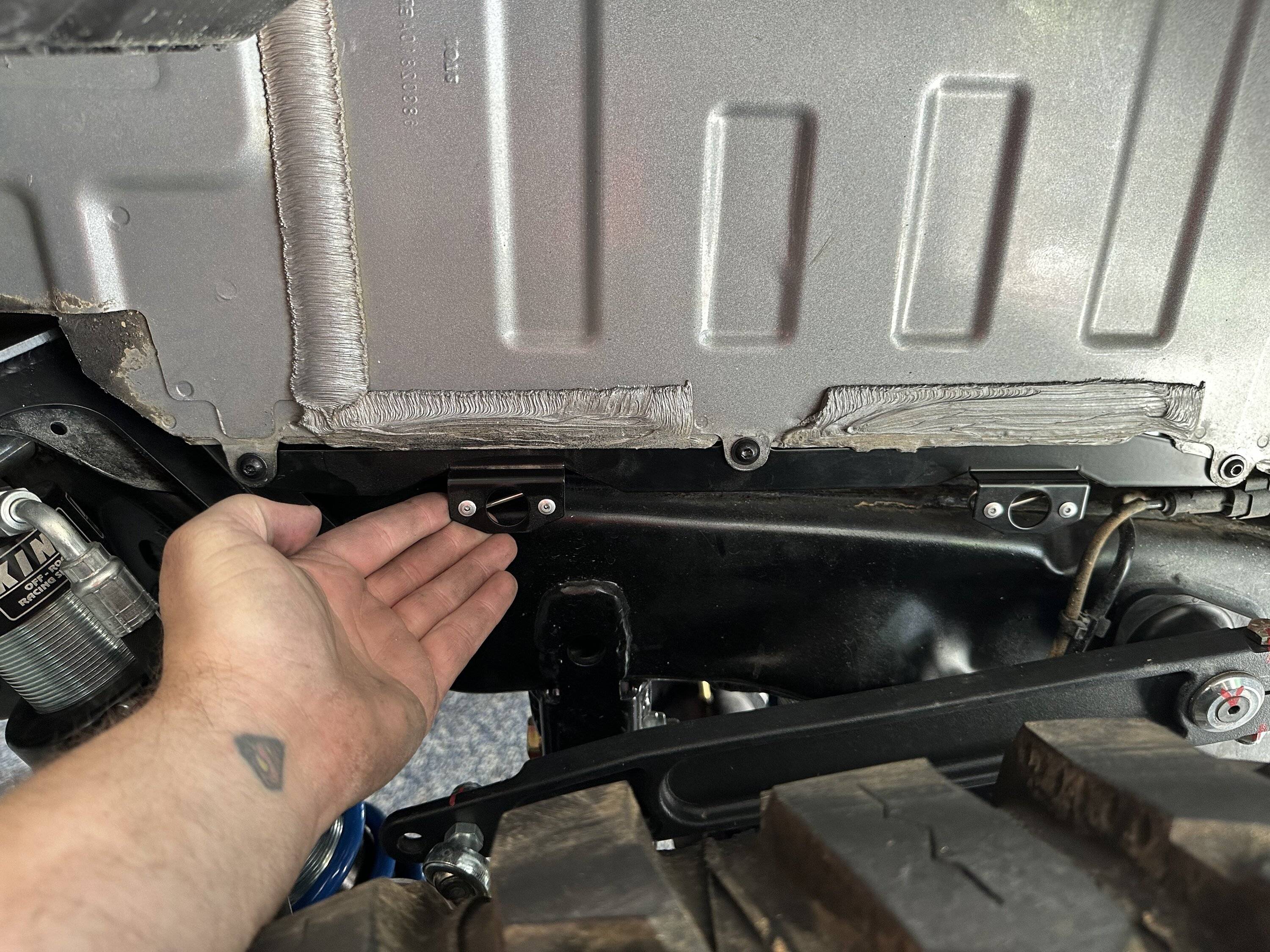

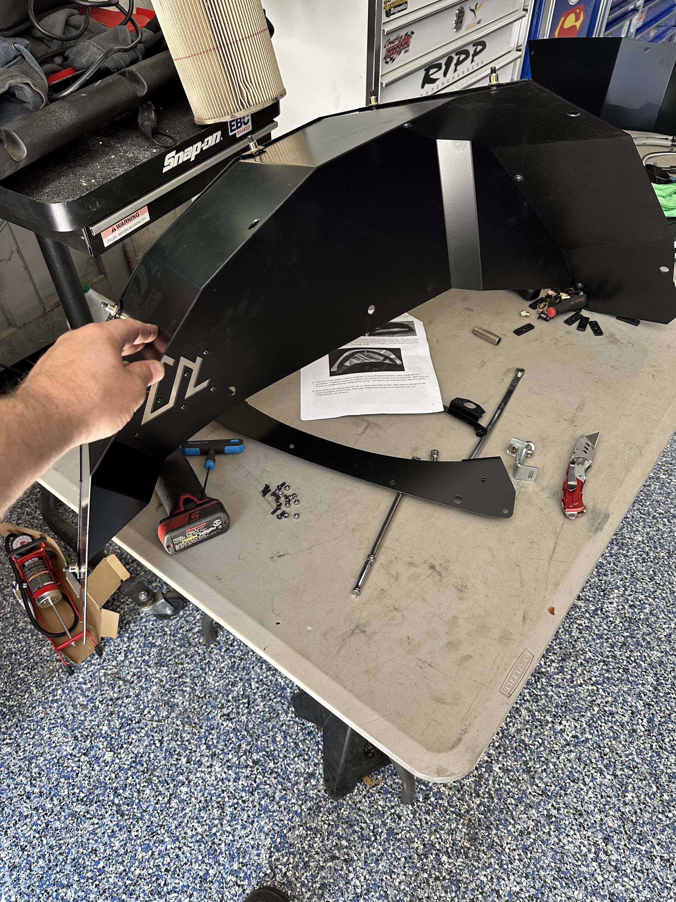

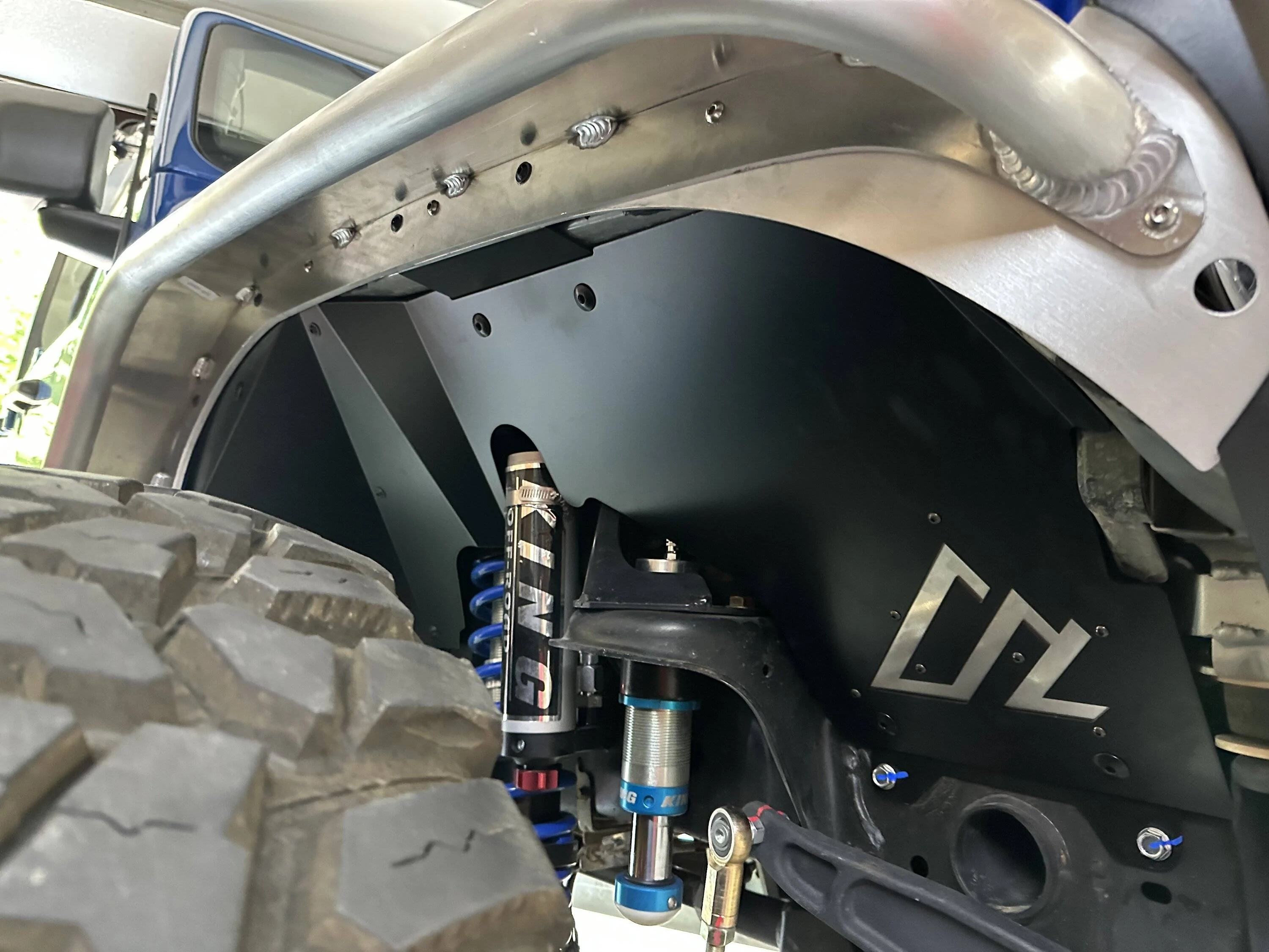

Passenger Front installed. Nothing special worth noting here. If you’re running a blower or you’ve deleted the FAD and factory steering, you’ll need to make sure the wiring is secured in a way that it won’t run on the back of the liner. What I have found best for long term anti-chaff is old radiator hose. Cut it length wise, and then zip tie in place. Works for years and years.

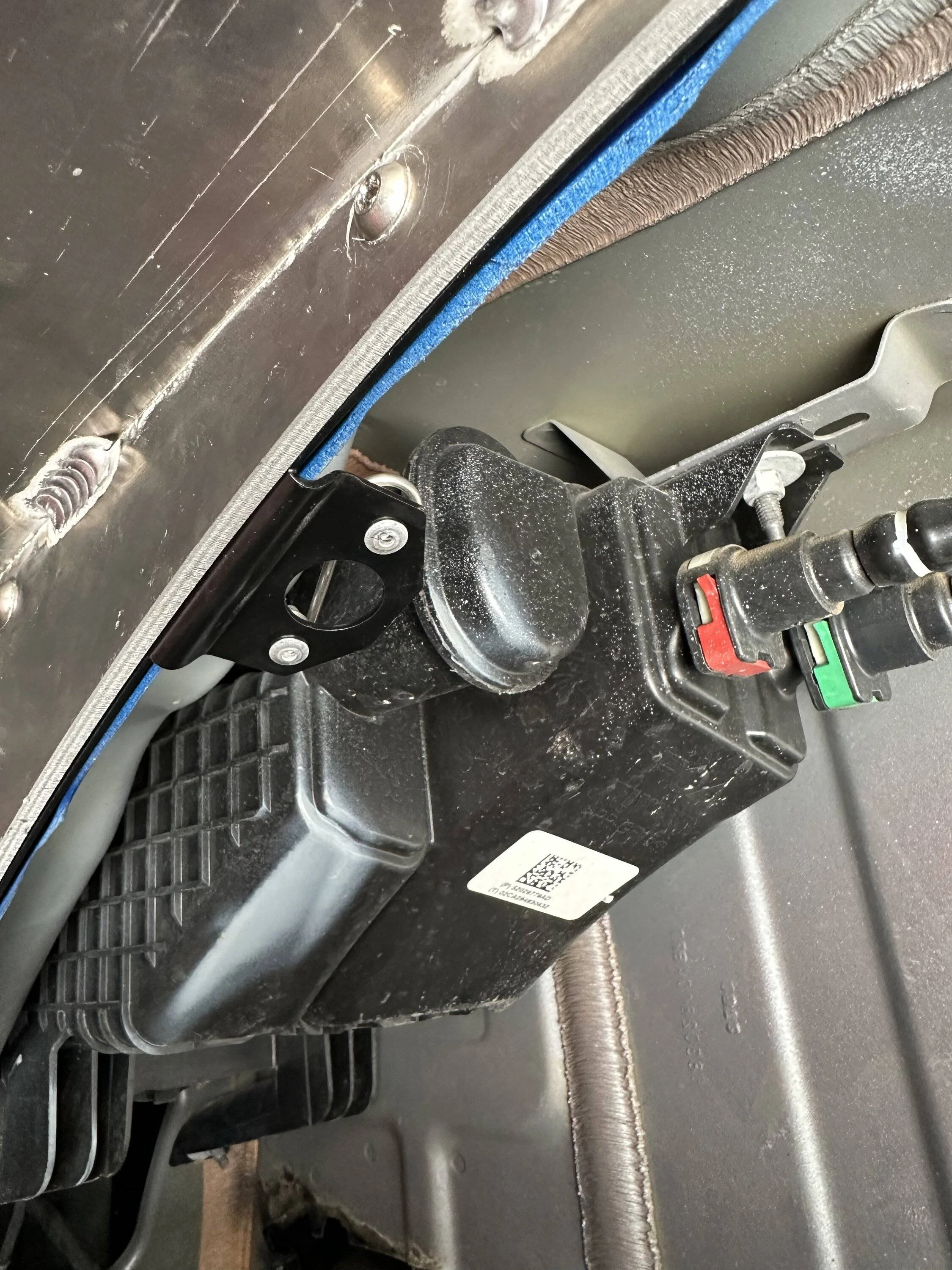

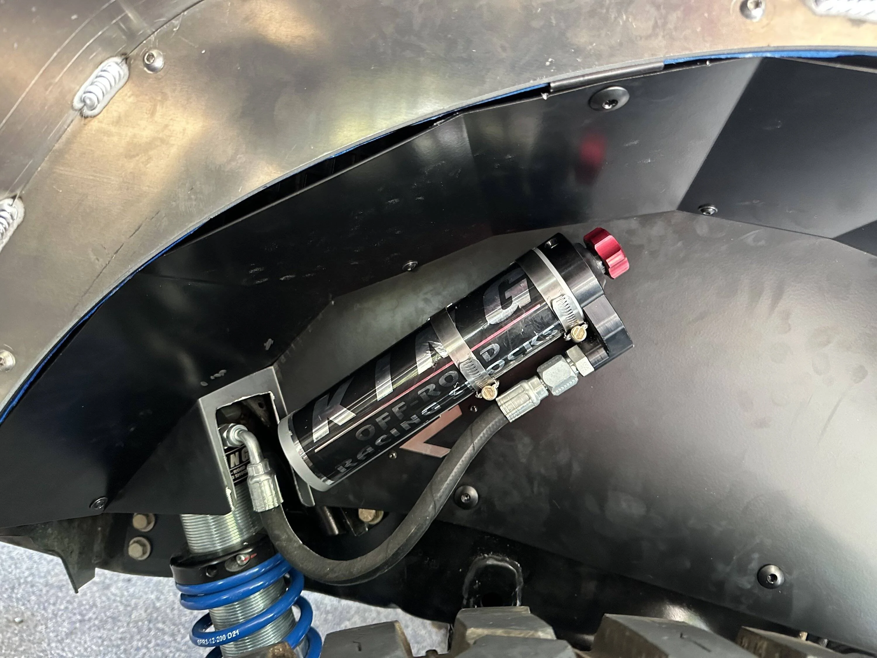

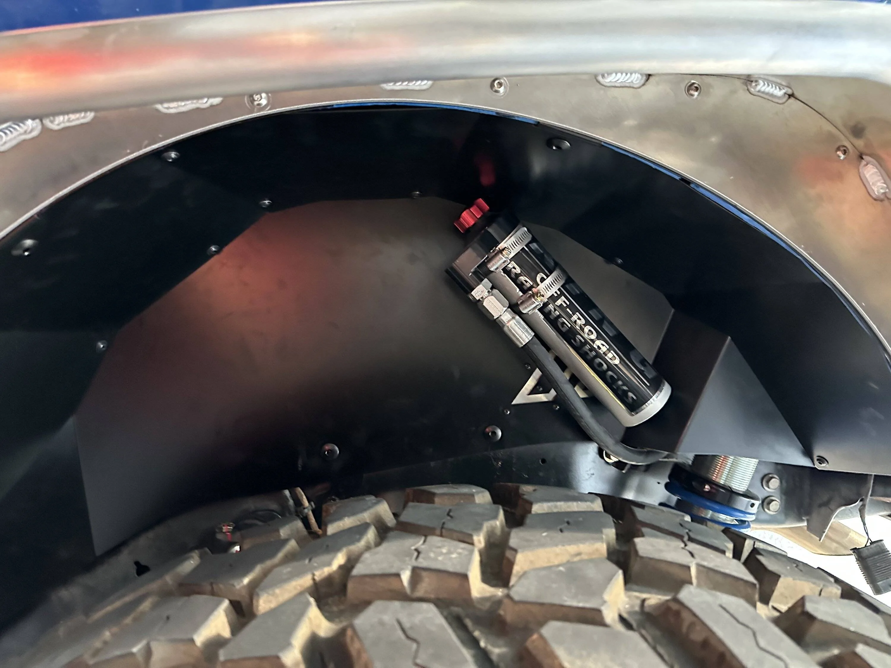

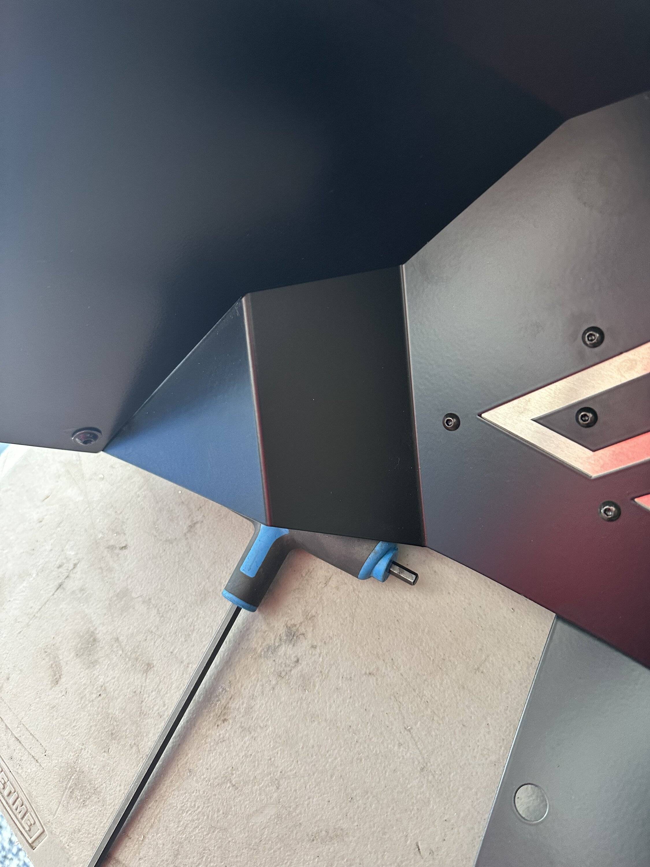

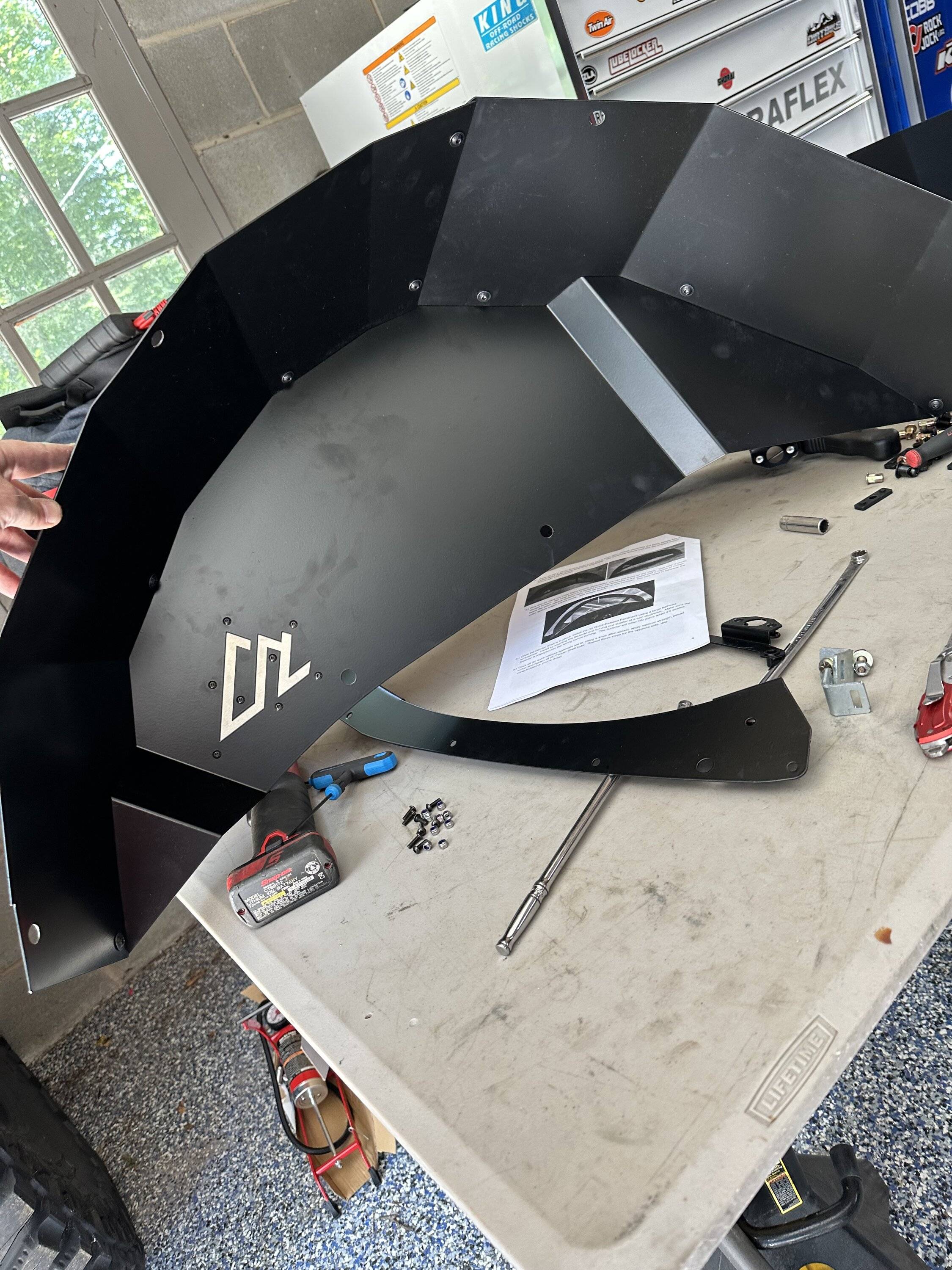

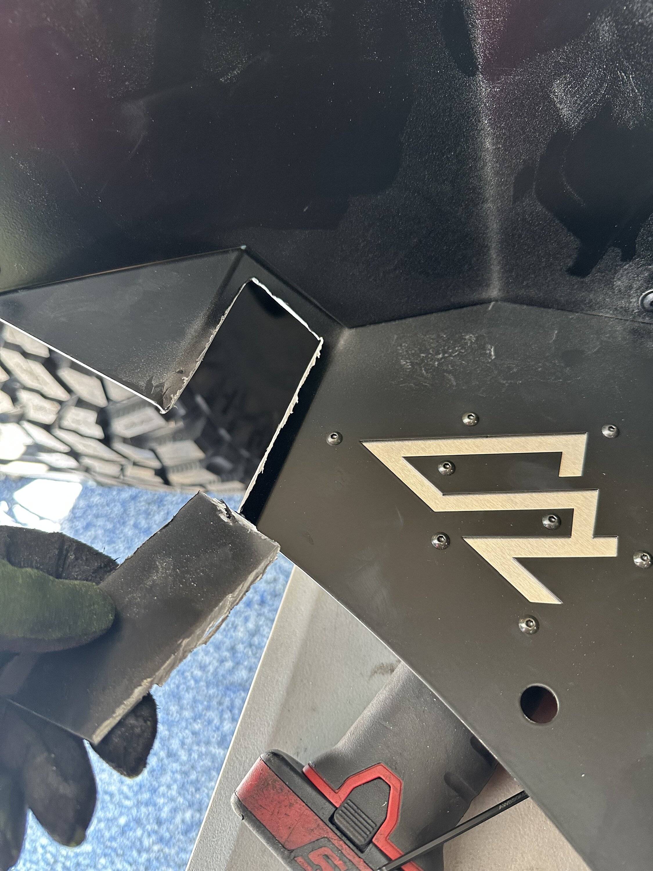

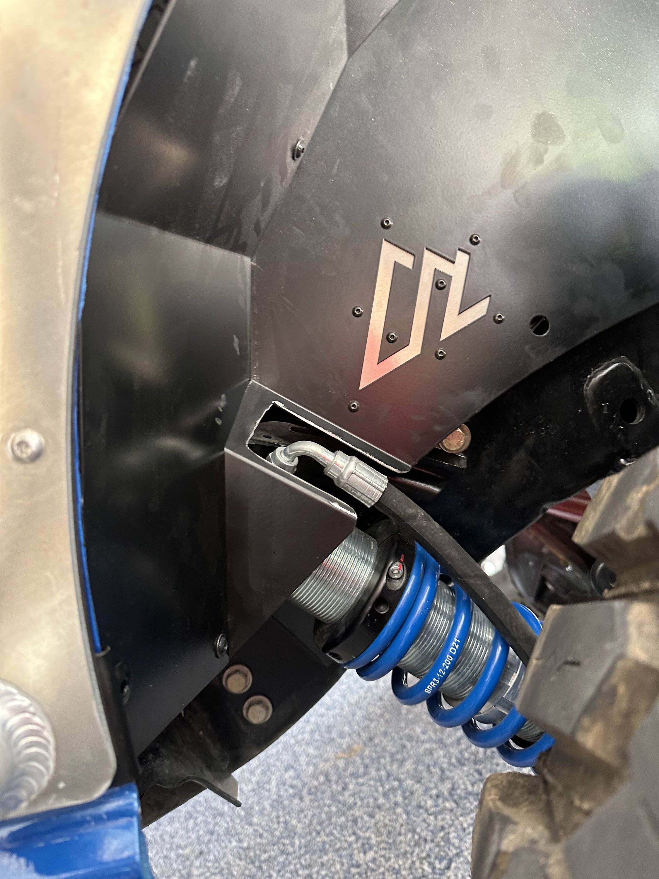

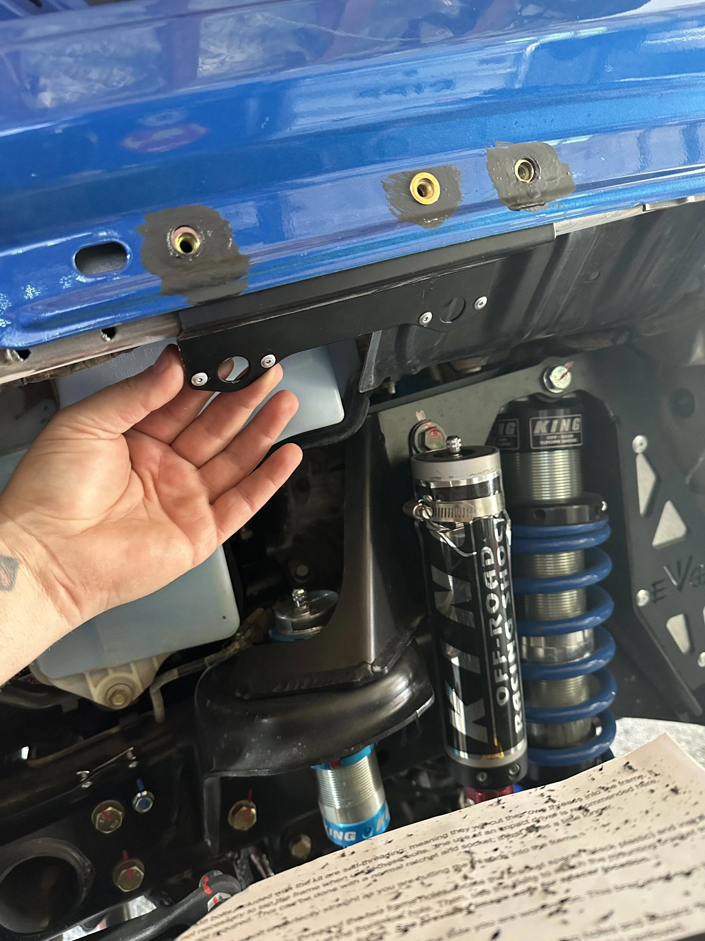

Got the passenger rear liner in.
This took a little work to fit the coilover and reservoir. I cut a relief for the fitting and then put some nutserts and 90 degree brackets in. Couple hose clamps and she’s solid.

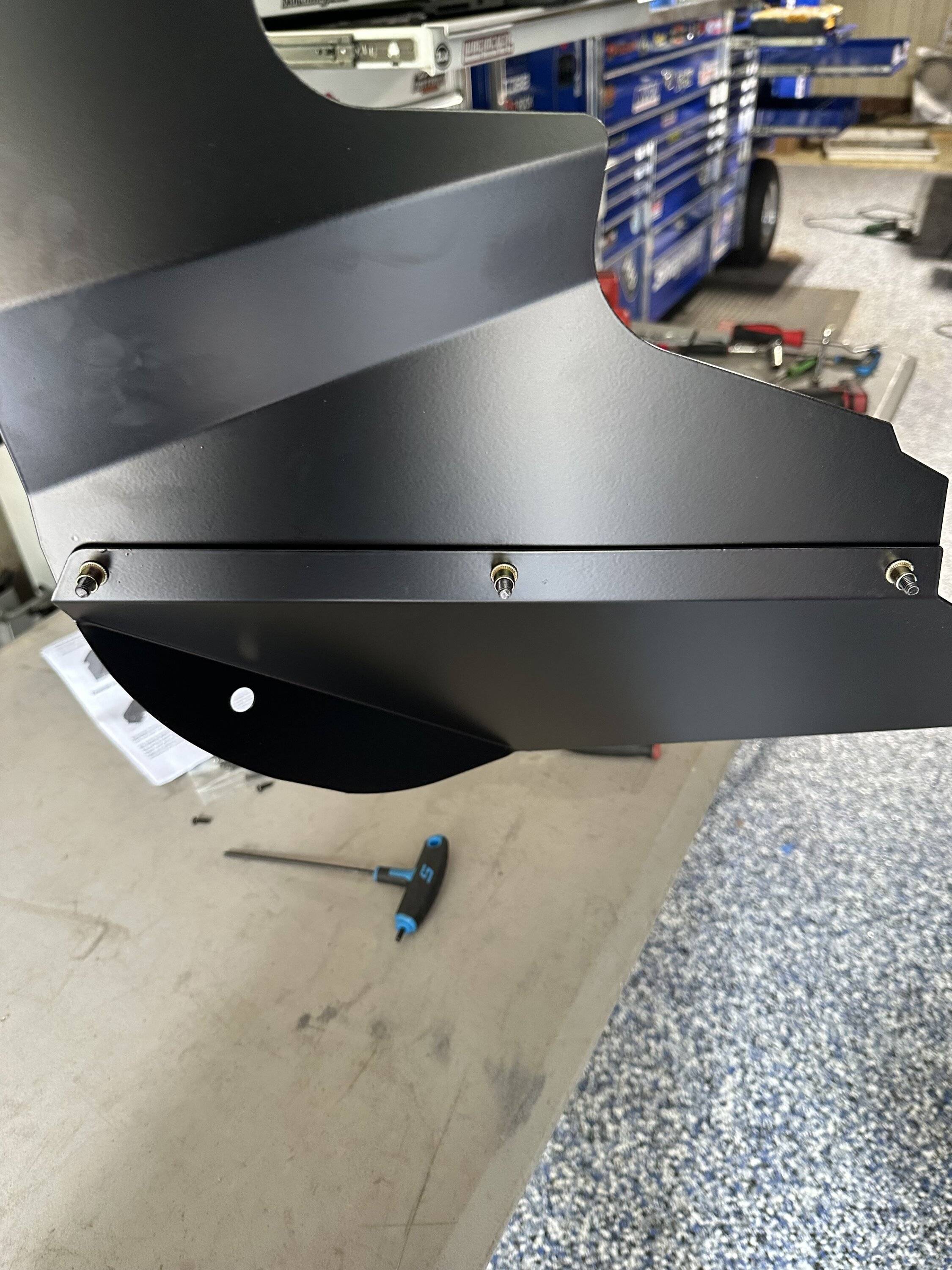

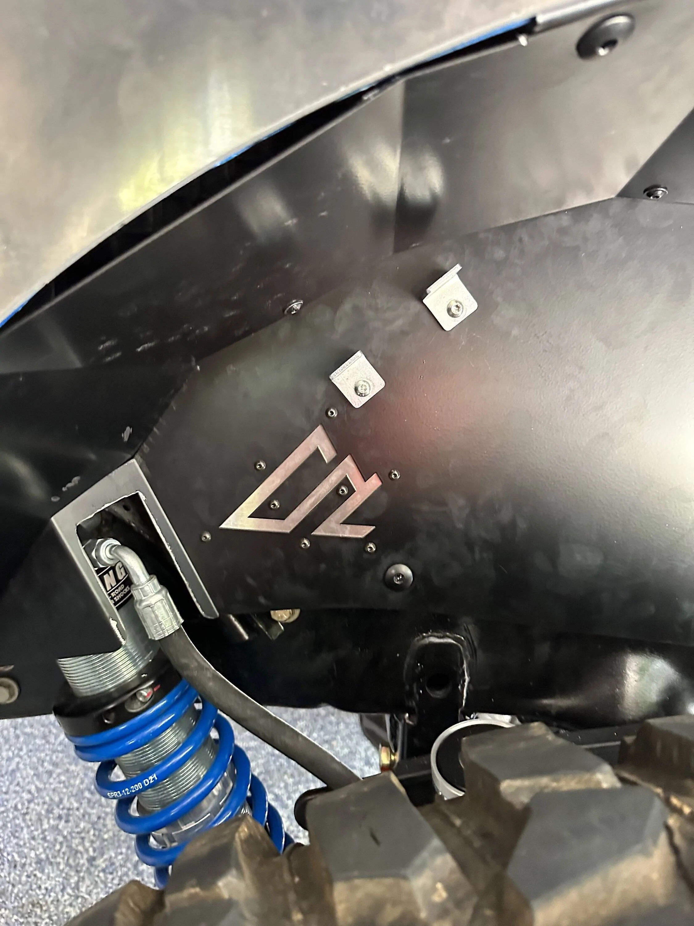

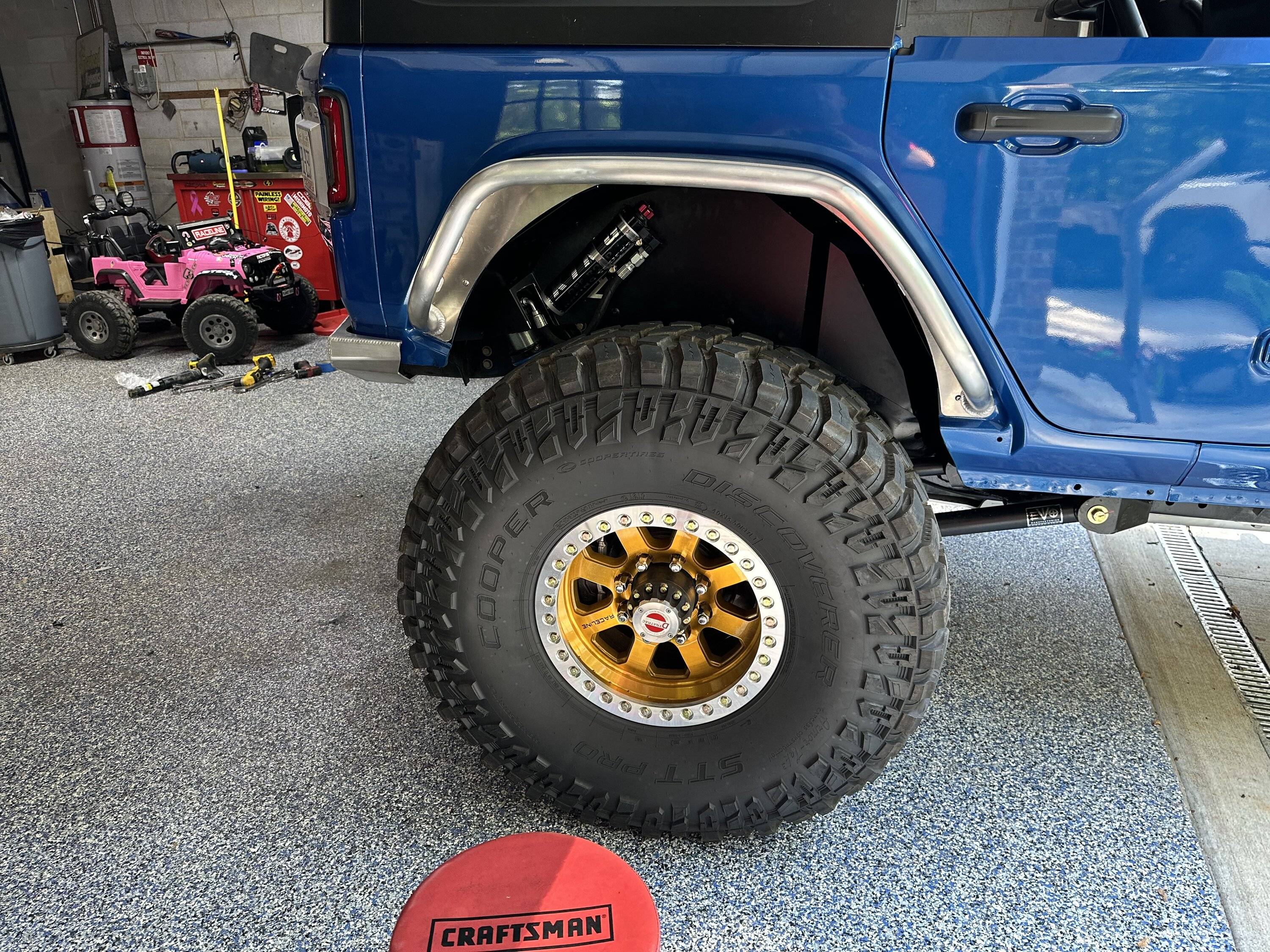

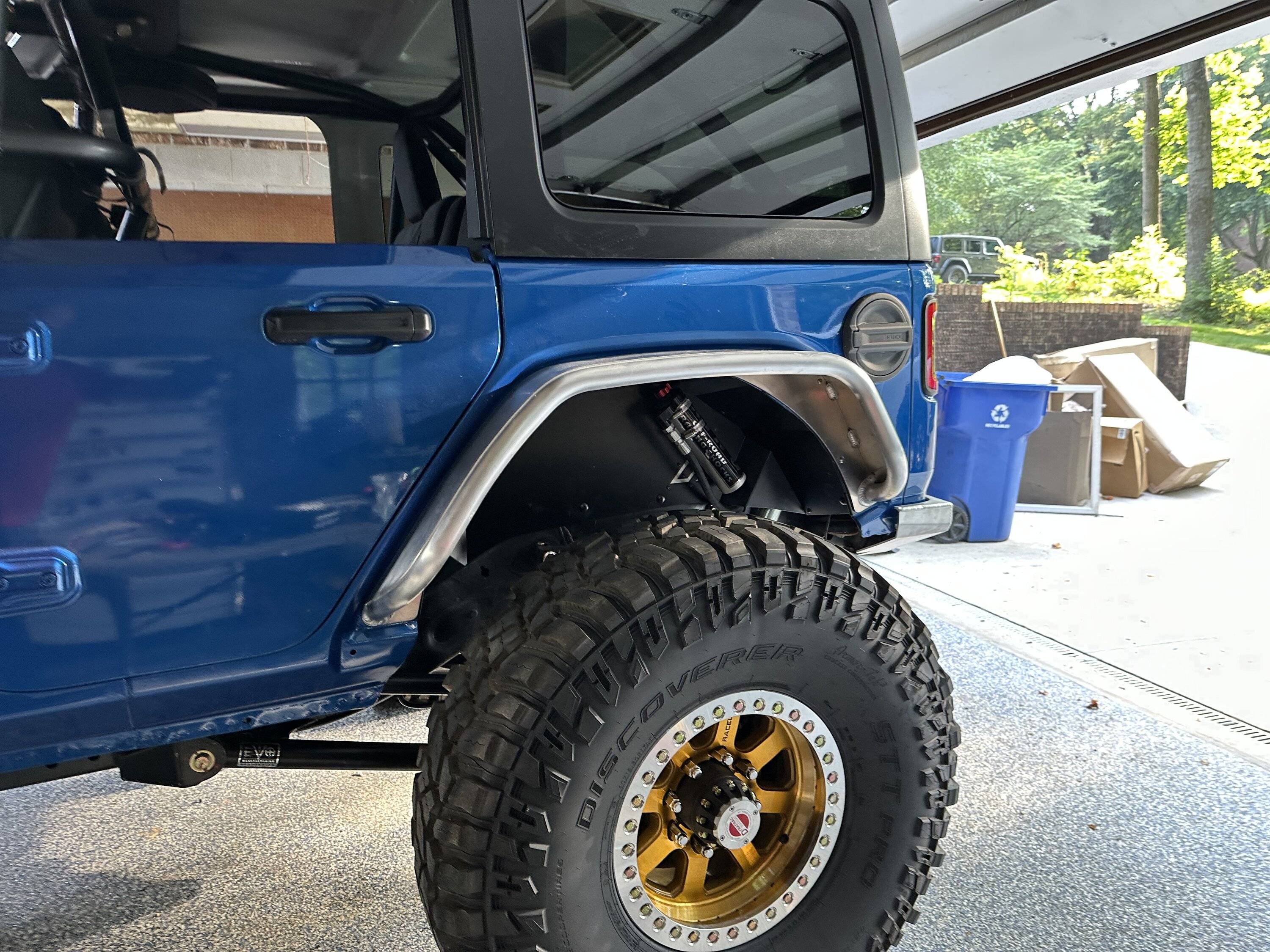

Drivers rear side done.
This side did not require any cutting for the coilover fitting. I did the same here with the nutserts and mounting the reservoir with the 90 degree brackets and hose clamps. Super solid mount.
