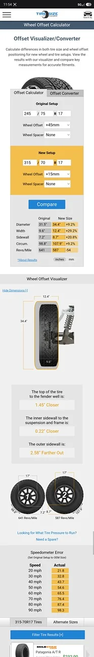

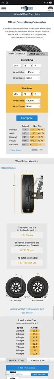

Im looking at some wheels for my 2026 JL sport that are 8" +30 5.7" back spacing with 285 70 17's.
By my math they should sit about 1/2" out further than the stock wheels. Correct?

25.4mm =1 inch. So your math is close. Stock wheels are +44, so 15mm difference. Closer to 9/16" of an inch, more closely 19/32"

Looks like the wheels are good to go with my oem 245, 285 and 315 sizes.
Figure I'll go with the 285's until I do the lift and source axles with better ratios.
