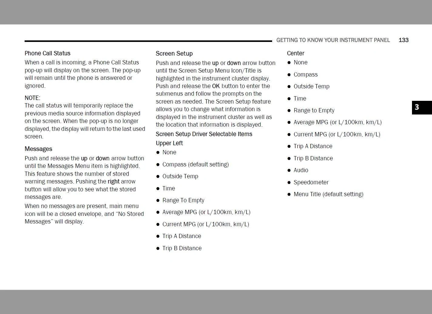

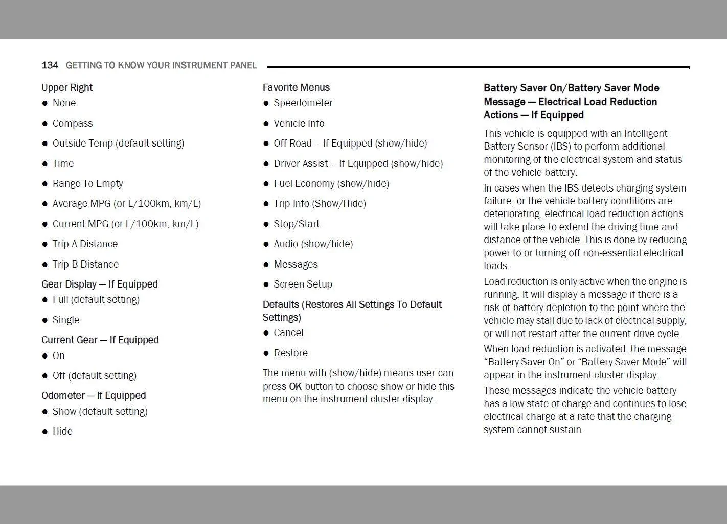

It's located on page 134 of the 2020 owner's manual, but it starts on page 133. It's called "Current Gear - if equipped." See below.
Jeep Wrangler JL 6spd flash intalled Page133
Jeep Wrangler JL 6spd flash intalled Page134
Ok, so this makes it appear it can be turned on and off. But default is still "on" so I'd check the menu to see if it is there. If so, you likely have the update and should be able to turn it on. @Rico1111 If not, then the update isn't present. Hopefully you'll find it and it will save you a trip back to the dealer.
The owner's manual reference is for automatic transmissions.
So there's no way to turn it on/off for manual transmissions? Have you confirmed this?
If this is the case, and the gear display for manual transmissions is "always on" after the Y07 clutch recall software update, @JeepCares or the dealer should be able to confirm that the recall didn't install correctly just by looking at the lack of gear display. Correct?
