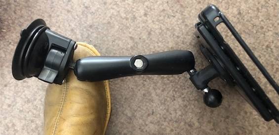

See my RAM setup below Ram suction cup, 6" arm, double ball for a 2" drop, Tablet mount. Choose the exact fit tablet mount for your device. Mine adjusts for Nav display and to the right for the passenger. Arm rest on the dash pad to reduce forces on the suction cup and to reduce screen vibration. Screen fits close to the dash.
Ditto Ram mounts, used em in airliners, never had an issue that wasn't caused by poor attach technique.
These look nice as well, but I'm trying to use the least amount of real estate up on the dash and windshield. The JL window is tiny enough and don't want to crowd it anymore than I have to.
