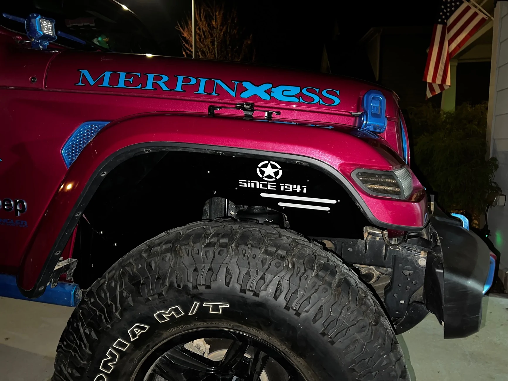

With mytop softtop, 3” aev hd dual rate(4”gain), 37 patagonia @36 psi
6’7”
You will need 2.5-3” lift to keep 37 from rubbing, tried really hard to do it with 2” on stock Sahara fenders and the liners were just a little to tight

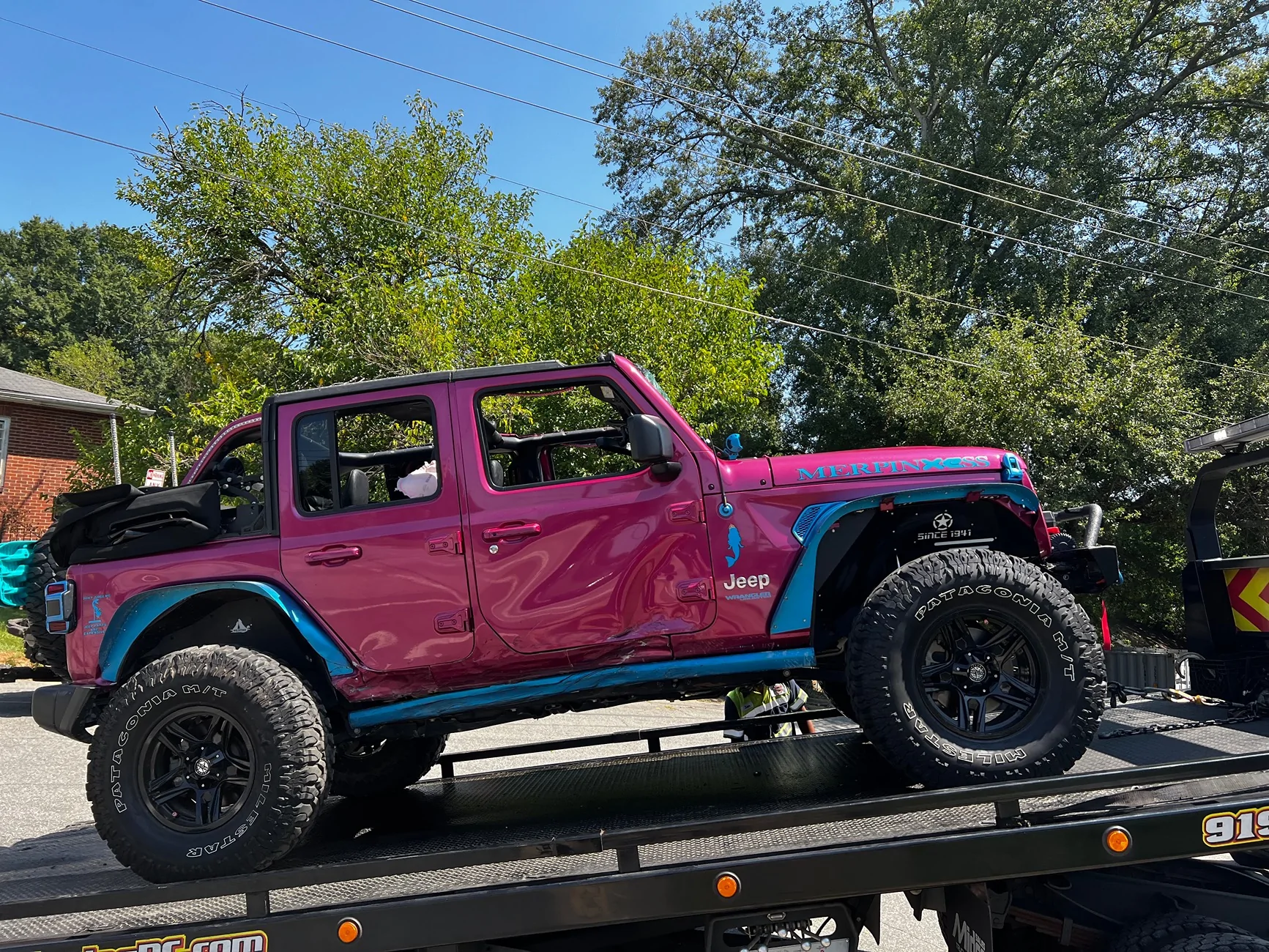

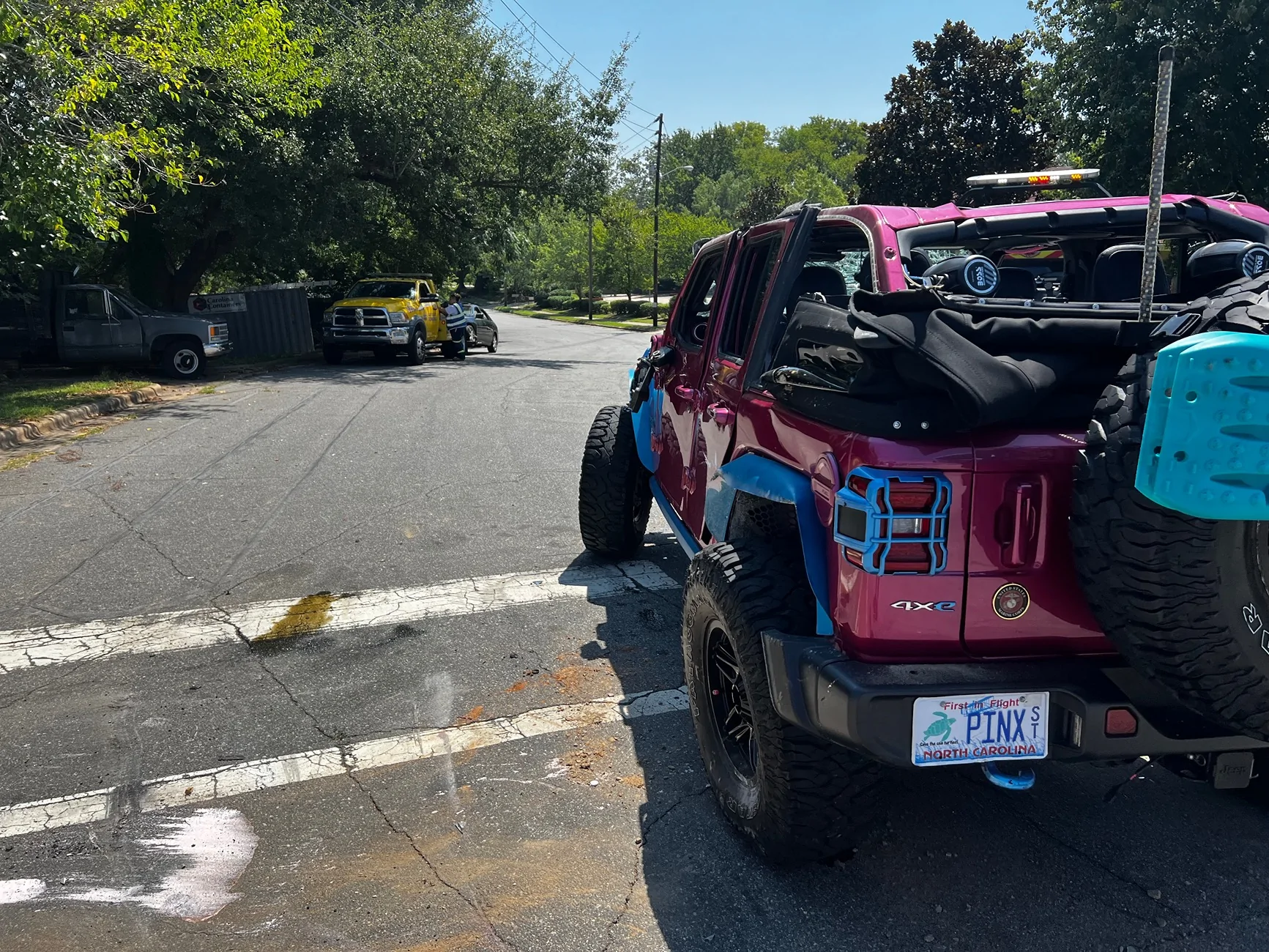

Yes, she was Sahara 4xe on 37”…sadly she looks like this now. After being tboned and flipped. Everyone walked away with only scratches, insurance bought us a new one.

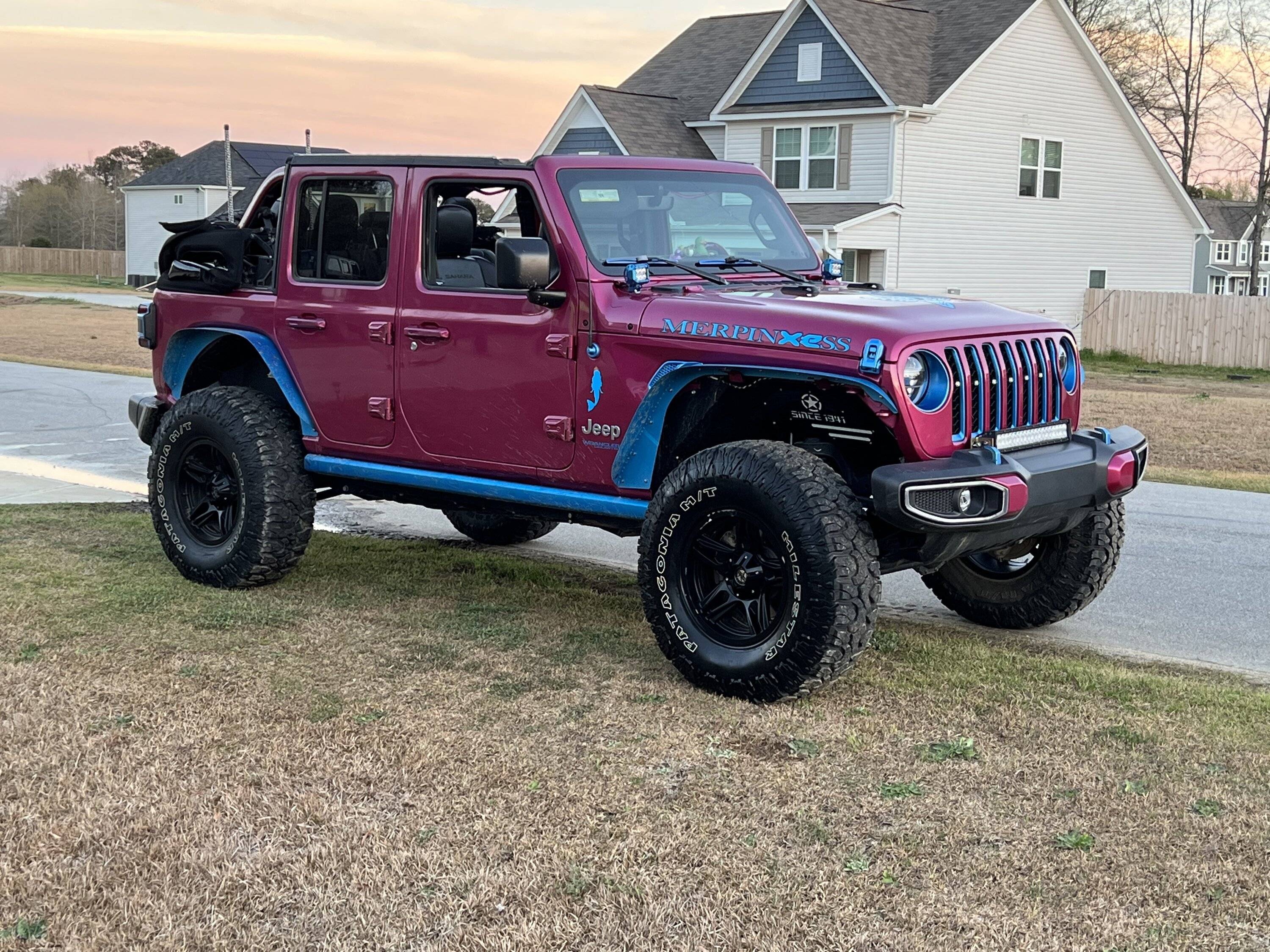

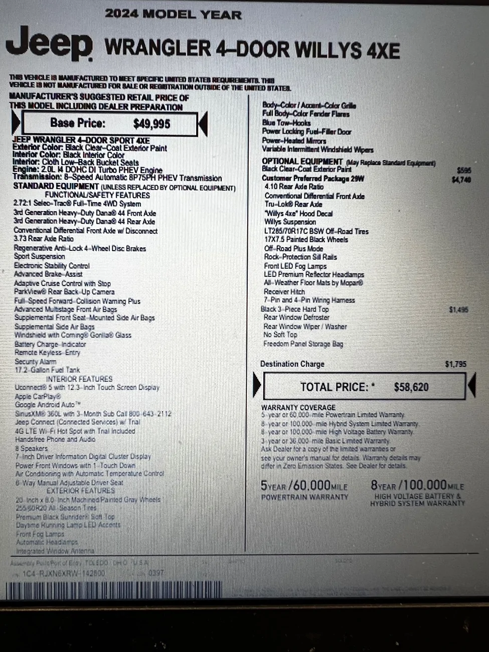

I just looked for the window sticker to remember the specifics. But the 21 4xe had better gears, cv deletes,with the rubicon front axle to reinforce the extra torque. She was a beast and after full steering upgrade(metal cloak), adjustable controlarms(8) rear trackbar with relocation, bilstien 5100 shocks, and the aev dual rate diesel springs 475 ftlb torque would still push her to 100mph and felt planted like a hummwv. Plus at 5 mph could do this

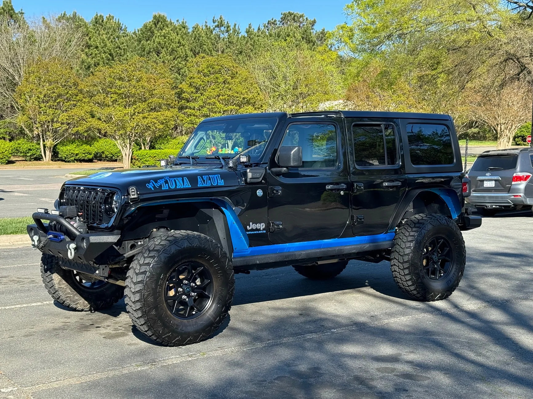

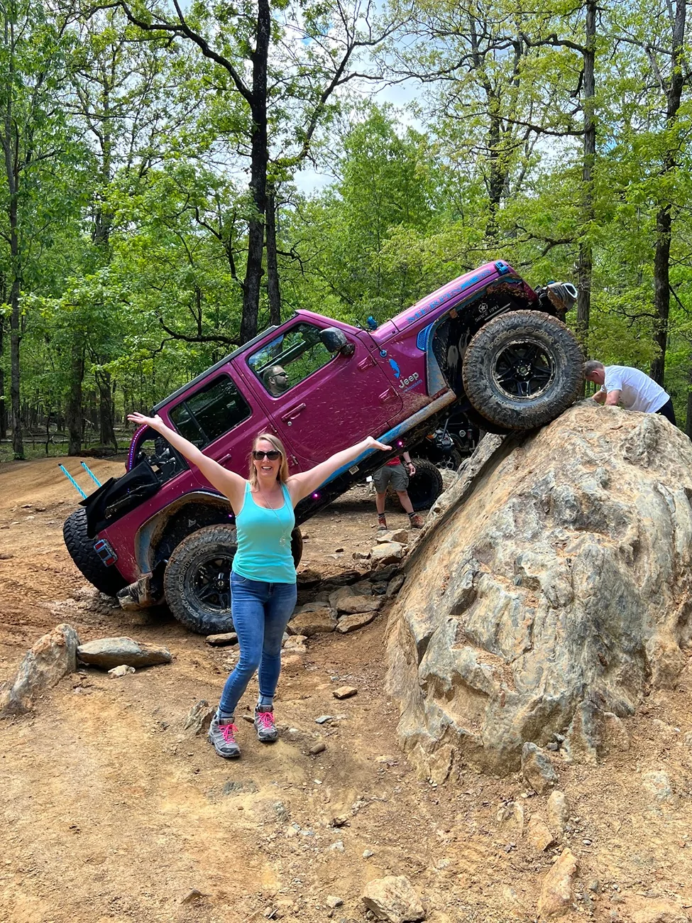

Thanks to the wonderful people we have met in the Jeep community we did a full rebuild in under 6 weeks for the Jeep jamboree. And a 24 4xe Willy’s performed the same with blood sweat and tears
Jeep Wrangler JL 4XE lifted with 37s Total Height IMG_7291
Almost forgot, u asked about mileage, the 24 miles of electric was still about the same. 80 on the highway is 12mpg, around town 18ish. Buy the 4xe for the 475 torque and reinforcements not the mileage, this is a brick

Thank you for all that info. Glad to see you guys were up and running again after few weeks of down time. Also great to hear about the Jeep community. 12mpgs is quite the hit but obviously Jeeps aren’t about MPGs. I’m coming from a supercharged LJ with 5.13s in it. I’m thinking if regearing to something like 4.88 would bring back those MPGs back up a little to like 16-18s on the highway. I hear anything above 70-75 with even 35s kills it on the highway.
I think the Willy has 4.10s if I’m not mistaken or maybe 3.73 still.

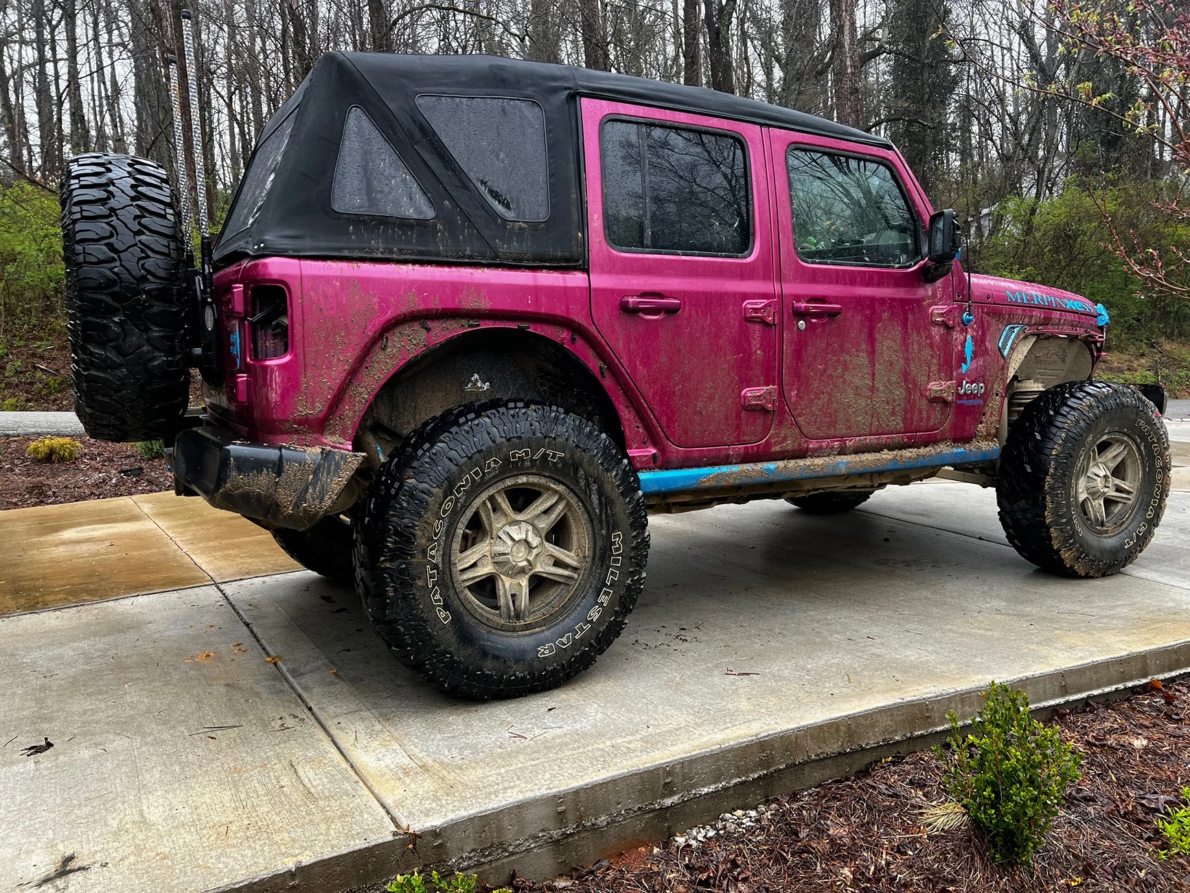

12 is flat out on highway, after charge is gone. Carpool was 12miles each way and never touched the gas. 18 is normal around town. Onthe trail we gained so much charge(max regen and hybrid)that very often if we go in full, even after a full day we come out 30-50% the power produced is much more than 4wd at 5mph uses and therefore there always seems like we have silent running battery, sometimes just push ev to burn some off and get strange looks running silent.
As you said 35 don’t fill wheel well right. Pinks was built over a year, we started wigh rubix takeoff springs and 34 AT. Then to 1.5 leveling kit, then to 3+ with 37 Patagonia MT, after fender liner removal and fixing steering right she acted like that is how it should have been done. Which is why we skipped all the middle steps on the rebuild.
Fenders and bumper had more effect on fuel at 80 than wheels, we did one trip between 37 on and fenders off, 6 hrs to TN and didn’t notice being under 300. 6hrs back no fenders dropped to mid 200. Here is the before and after…purely subjective and my memory of it, but I paid more with going 1/2 way with lift/tires than I lost in the few 6hr/80mph trips. Food for thought

I wonder if you got better mpgs with the fenders off because of the lift. Further away from the ground, you got more drag because well you collected more air going under the vehicle then over the vehicle. Jeep fenders are like scoops, air doesn't seem to flow over them like it would without fenders. I can see that happening, which would make sense.

I know that rock, buddy was one of the first to drive over it in his Sammi powered by a habussa 😁
Going for dickie bell BOH in a couple months...we have the group site booked.
Amazing how much URE has changed in 25 years. I will try for same picture
