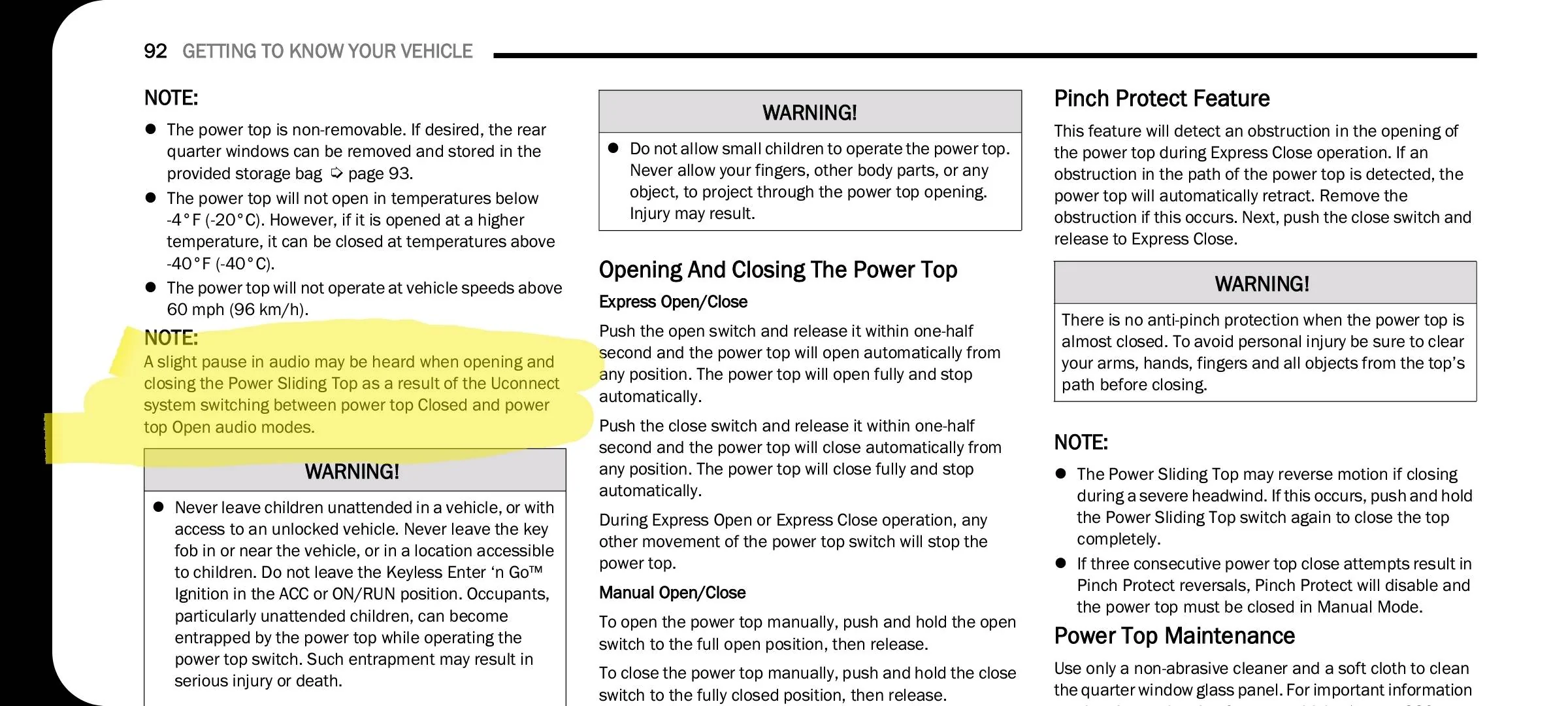

So itās not just the audio dropping out that occurs. It also lowers the output of the subwoofer by around 50% and there are some other changes to the speaker output when the SOT is open or the hard top is removed.![]()
Why is this done? Well, itās standard practice on any convertible top vehicle to change the audio profile when the roof is open. Why though is it standard practice? Simple⦠Emergency vehicle sirens. When the roof is open, wind noise is compounded and when you add in full bass from a subwoofer and full power speakers, a vehicle driver has more difficulty hearing sirens from emergency vehicles. The audio changes help make that less of an issue.
