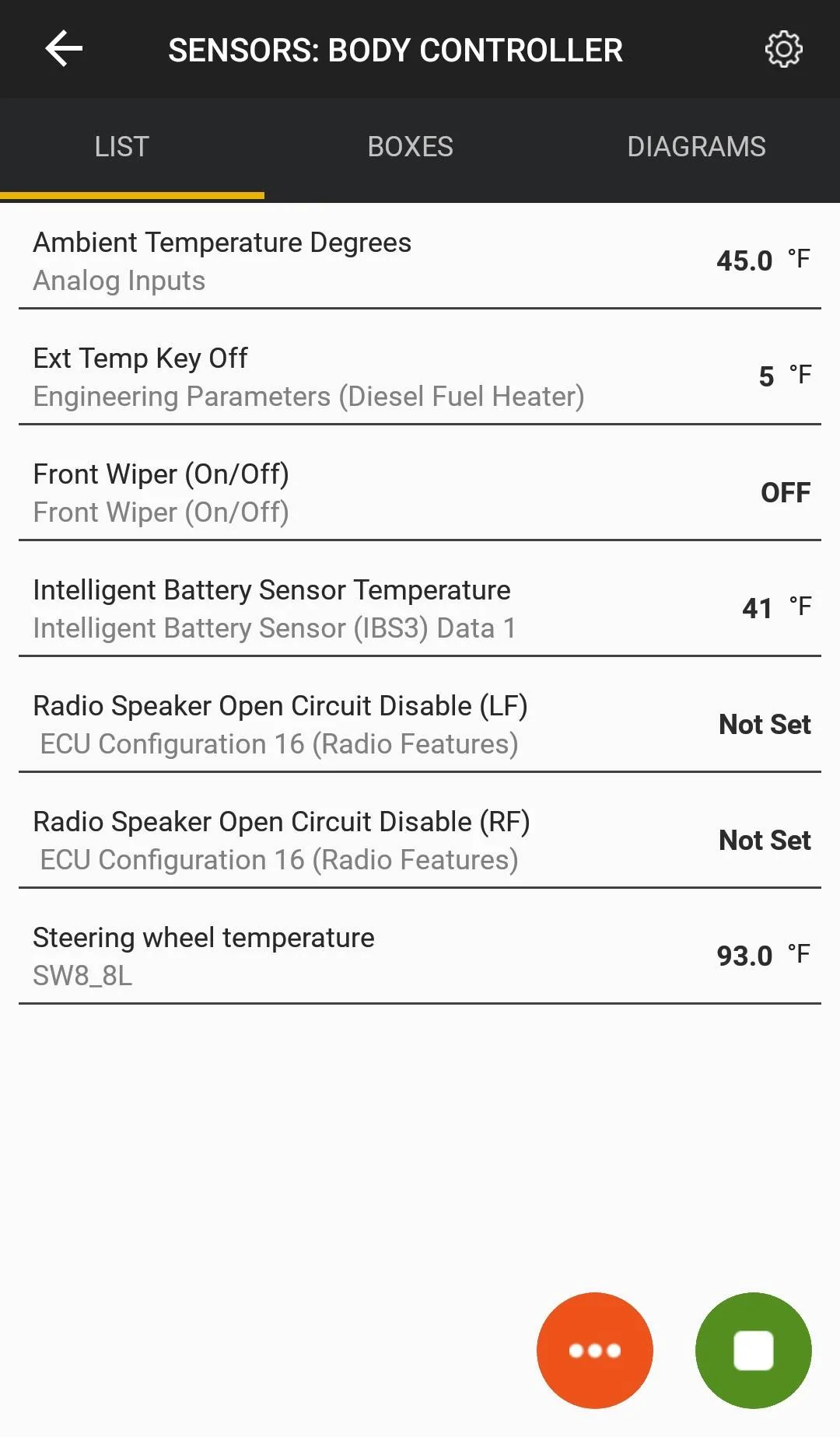

So, JScan is showing the steering wheel has a temp sensor. The highest I saw it go was 93F when operating for about 30 minutes at 39F outside. Not sure how that compares to other 4xe's or previous JL's. Works for me.
