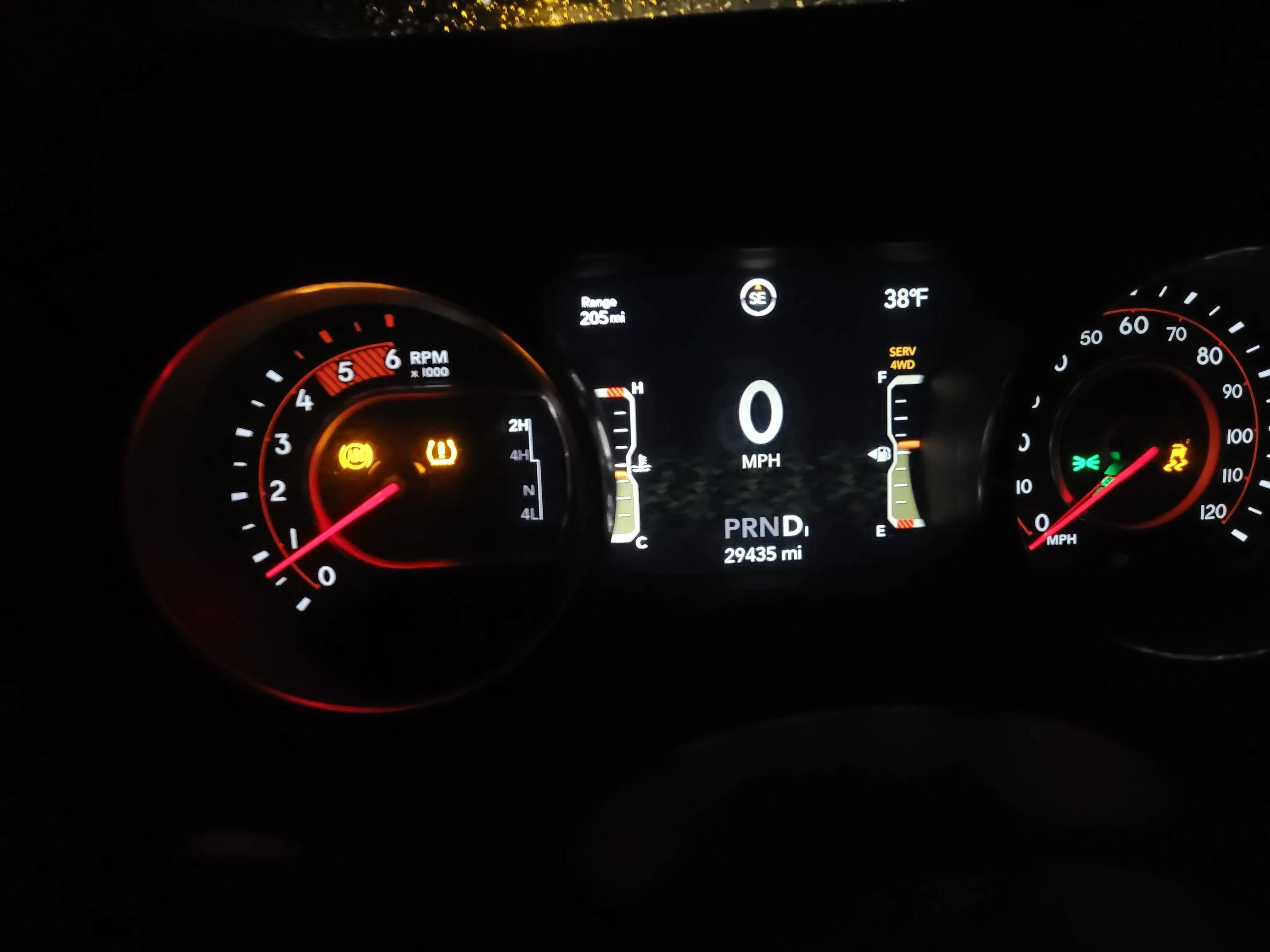

Here's a picture of my Gladiator's dash.
Jeep Wrangler JL 4WD temporary unavailable 20240106_200122
The 4wd still works with all these lights on, atleast for my JTRD.
