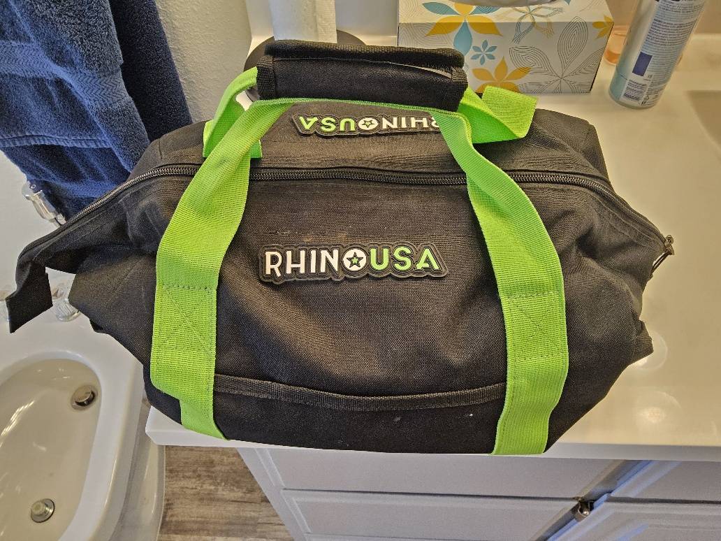

I wanted one of those 4 tire inflator, but after seeing many struggle with them, I decided not to. They seem to be difficult to get back into it's bag haha, that or there will be a leak somewhere and the whole thing won't work.
The coiled hose System is a handful. The straight hose system is not a problem and easy to get back in the bag. The air chucks do not leak thus you won't have any inflation problems.
Jeep Wrangler JL 4 WHEEL DEFEFLATION/INFLATION SYSTEMS 20240903_164642_resized
Jeep Wrangler JL 4 WHEEL DEFEFLATION/INFLATION SYSTEMS 20240903_164710_resized
Nice. I do like rhino products too.
But trying to knock out the priorities first.
Ball joints, tie rod and drag link, and regear.
I have a viair compressor, and works well, just takes longer.
The inflation system is a Speedflate System. I'm just using a Rhino carrying bag for it.
