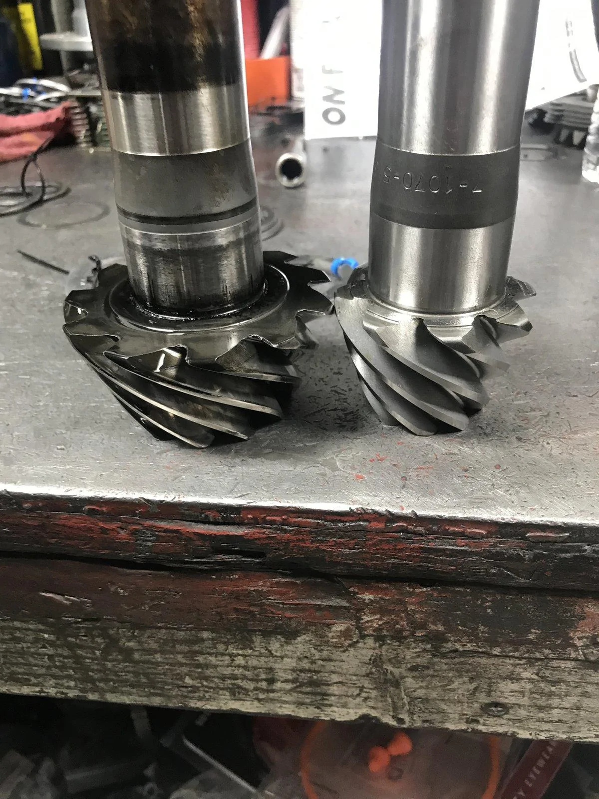

Ill agree that the pinion head is a little bit smaller but it sure seems stout enough. To make this driveable and have a better crawl ratio I don’t think gear swaps can be denied. If I do destroy the pinion I’ll replace it back with 5.13s

We saw that problem with the FJ Cruisers... 4.88s would fail before 4.56 or even OE. However, I wonder how much meat you are giving up on the 44? Is the pinion head that much smaller with the lower (higher) gears? So much so that you are giving up actual durability?
Brett
Here’s a picture I took while re gearing. It only looks so drastic because of how high the 3.45 gears are!
Roughly around the same size head as the JK 5.13, maybe a tad bigger and different design for the pinion.
Mechanic said the new 44’s are more like old school 44’s due to where the pinion rides on the ring gear.
Mine were 4.10s swapped to 5.13s. I wish I had taken more pics. The shafts are stout.
WHOLE lot of difference in the thickness of the metal on the head of those. Be interesting to see a comparison of a 4.10 to 5.13
