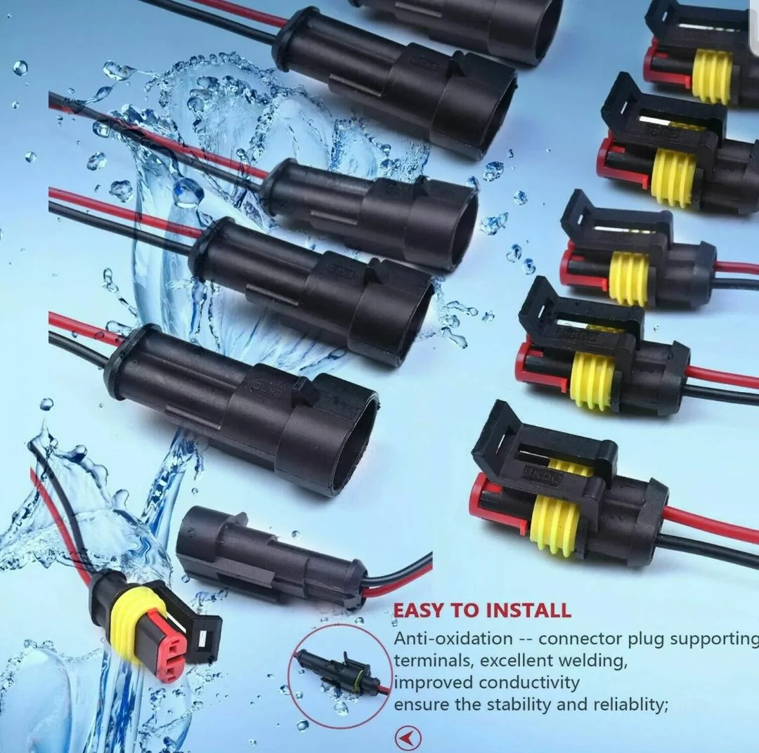

If I wanted to also keep the OEM brake light installed, I probably would have bought the Quadratec version. Instead, I bought the Rugged Ridge version and spliced in some waterproof connectors (like the ones in the pic below) so I can easily switch back to the OEM if my state inspection requires it.
Jeep Wrangler JL 3rd brake light for JLU Screenshot_20200104-225939_eBay
Nice! Easy to splice on those connectors?
Yep! If you use solder seal wire connectors, it will be really quick and easy.
