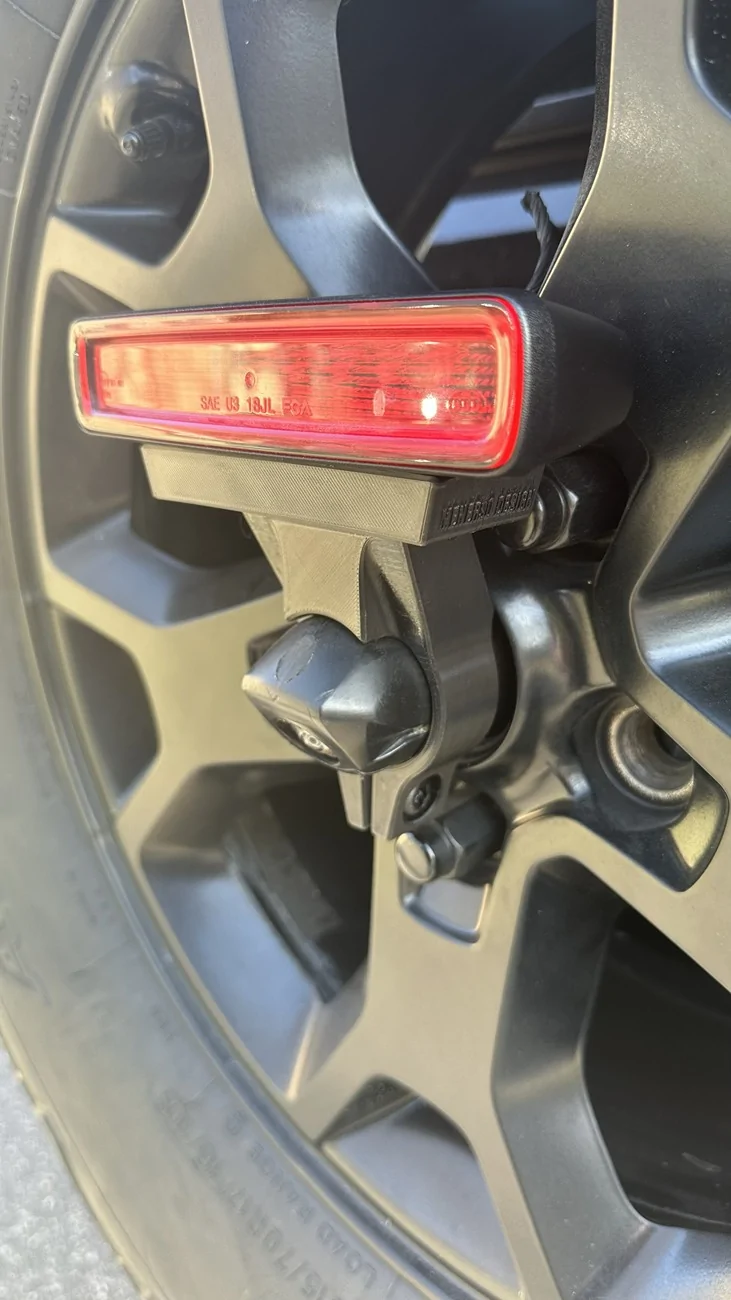

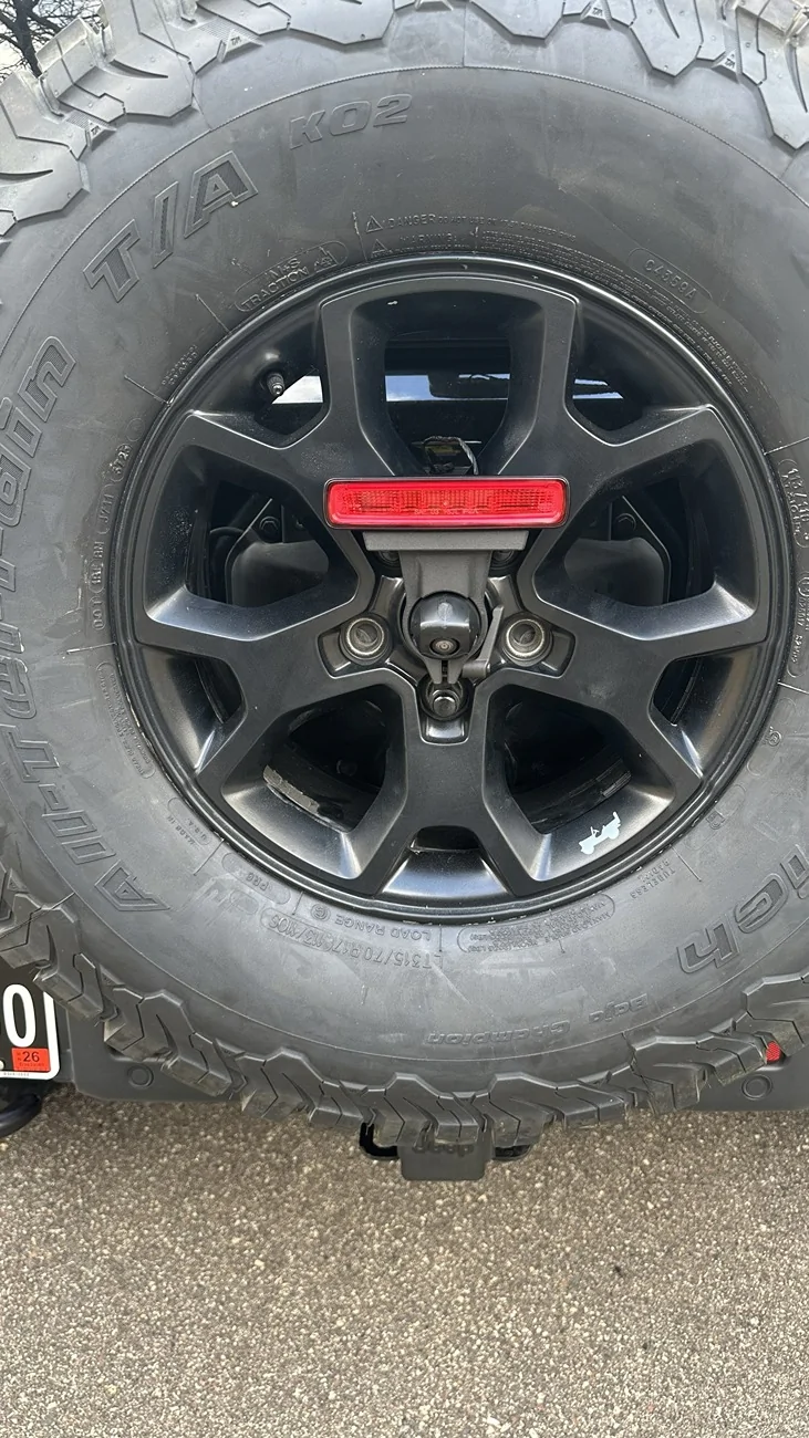

I just posted a model for relocating your 3rd Brake Light to the center of your stock tire carrier on the JL's. I tried some of the ones but they all required an allen key or different size socket than the lug nuts. I liked the Teraflex one, but you had to buy a whole tire carrier to get it. This one you can print yourself and use a T40 bolt so the Jeep Toolkit will suffice to remove. Once removed, just unplug the light and the spare comes off.

What material did you print it from? Hopefully not PLA.

I currently have it printed in PC. ASA Carbon Fiber is what is shown in the pictures. Yes, No PLA and NO Petg. ASA, Nylon, PC are recommended. ABS may work ok, but I would lean towards ASA then.

Thanks. It may not work for every wheel out there, but it would be easy to modify to fit by just remodeling it and re-printing.

I ordered it from Portal and received it in 3 or 4 days. The print quality is very good. Well worth the $20.
Looks good! Does it work with the XR spare?
Yes, it does. I installed it on my XR 392 today.
