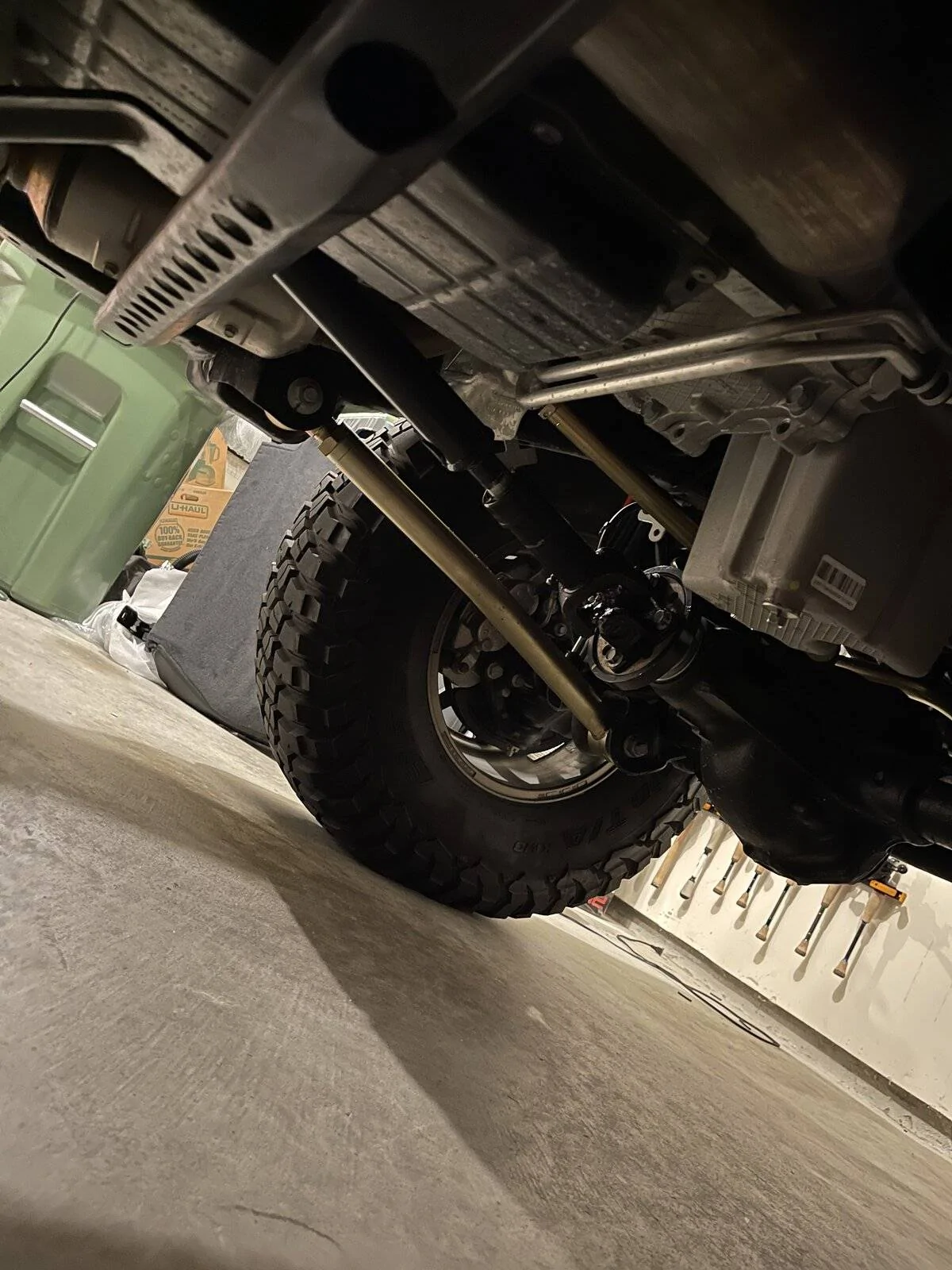

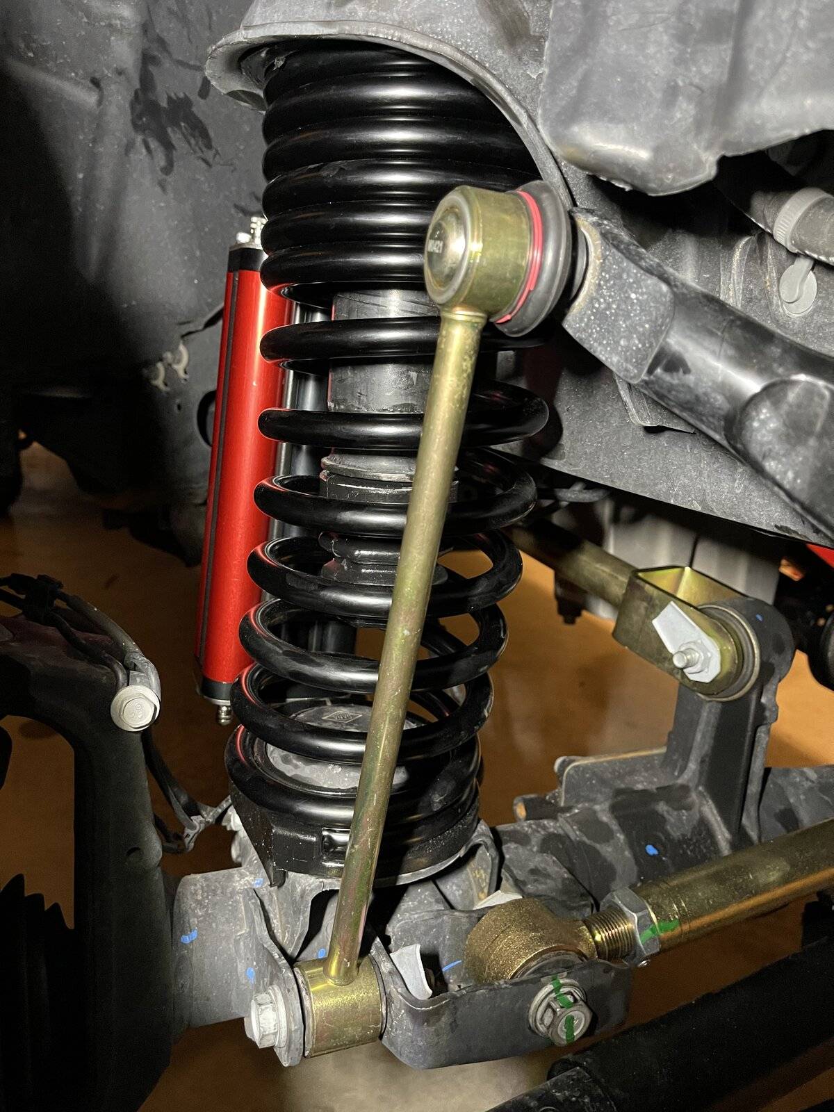

40s with 2" spacer front coils 1/2" spacer in the rear. Clears the tires no problem but will need to do the inner fender delete. Im also using control arm drop brackets with adjustable upper control arms.
