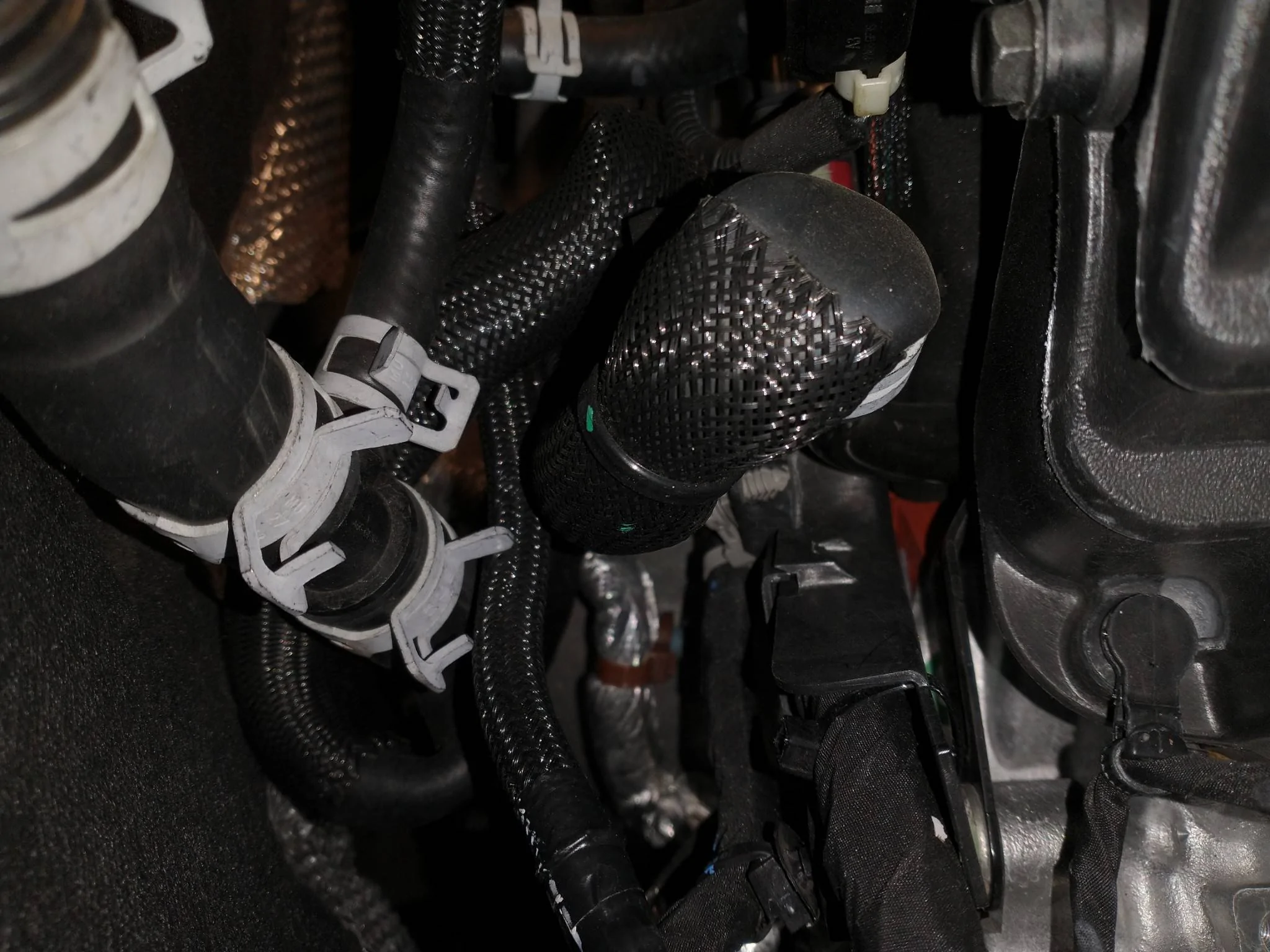

Someone else recently had the same issue and it was a kinked heater hose coming into the firewall. Best of luck with the dealership, should be easy fix.

Had a chance to crawl onto the back of the engine and look down at the heater hose mess. Unreal how Jeep thought this was engineered properly. There are at least 2 hoses kinked. Both restricted at least 50%. I tried to straighten them with little success.
From the pic you can see the kinked hoses at center-2 o'clock and the second @ 3 min-7 o'clock. The second one I was able to open up slightly but the first just bloodied my hands on the clamps.
Calling the dealership today.
Happy New Years, Jeep dudes and dudettes. You folks are the best!!!!!

You sir nailed it. Really appreciate the help.

Awesome, glad it was something simple and the dealership will square you away. The forum is just a great resource.
