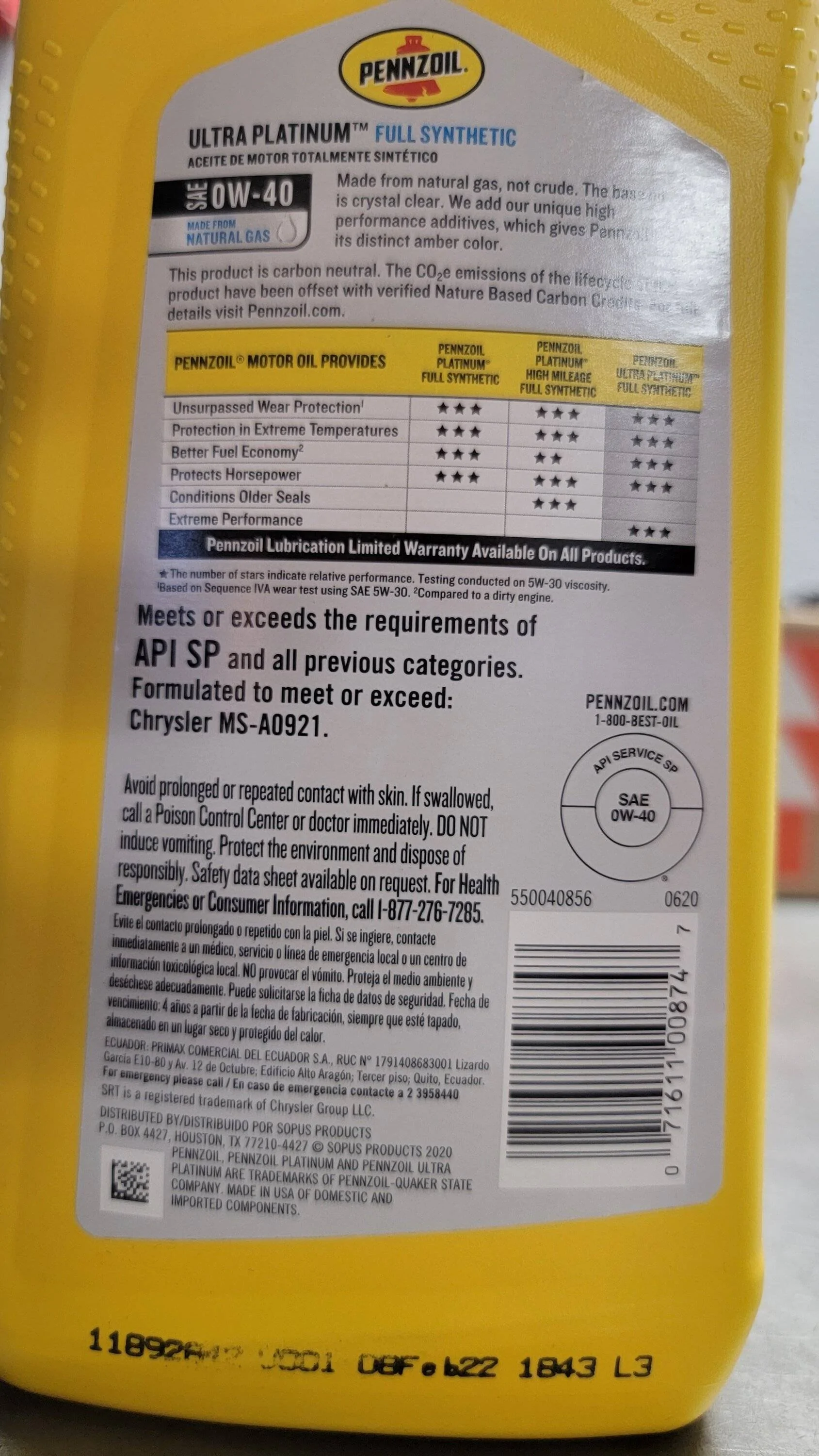

The shop's foreman did my service; he used the above oil and did a great job! I checked oil levels and it's good to go.
