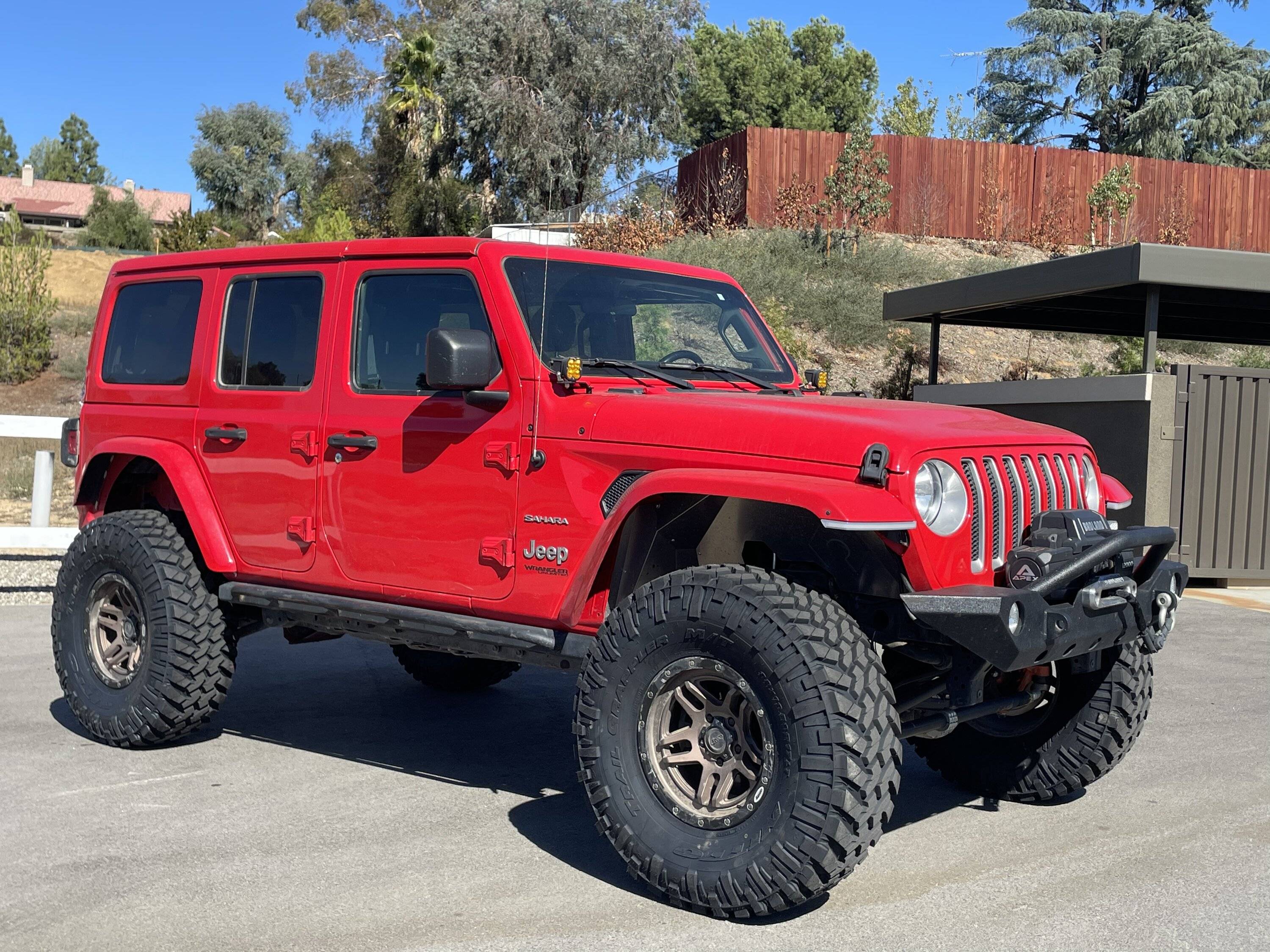

Having gone back and forth through tires I finally decided on the 38 inch nitto trail grapplers
They look great. I’m on 410s still protecting by pinion. My prior tire was a smaller 37 (35.7 mounted) these 38 are 37 inch mounted.
4.5 inch rock Krawler lift
Rubicon axles with Reid knuckles and dynatrac ball joints and Rcv shafts
Ready for the fordyce this summer

What offset are those wheels? Any straight on pictures to see the poke?

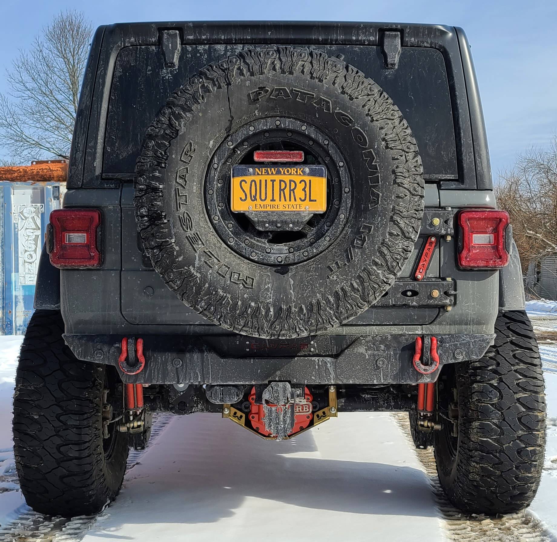

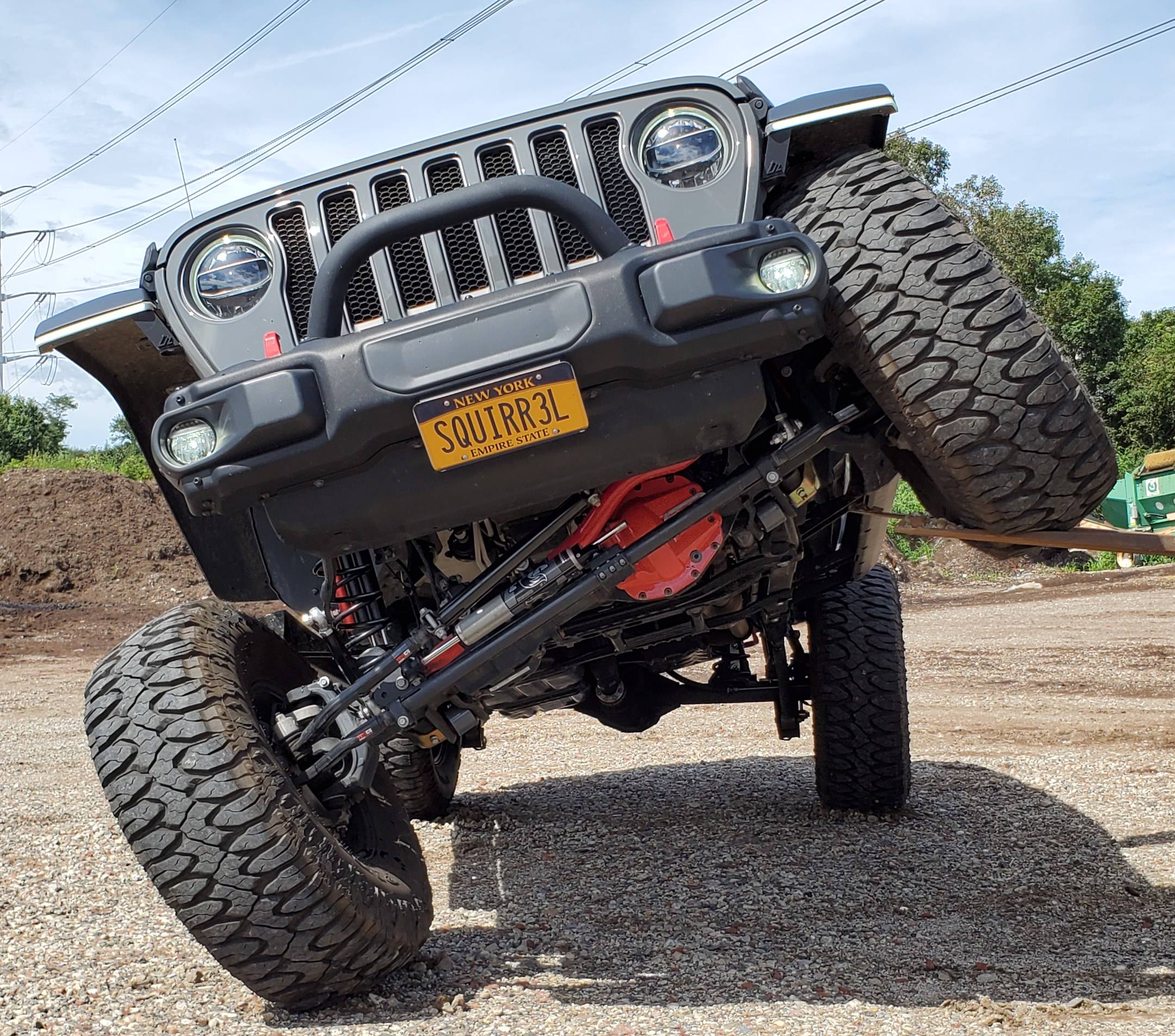

And some more recent pics from dead straight ahead and behind...

This may get a bit long, as I don't want to go the easy route by suggesting a different wheel with less backspace, because that's not an easy option on your end. You'll lose money reselling them, plus more time spent trying to find another wheel you like as much. I'm also a fan of KMC's XD series of wheels.
38's are an oddball size, so there's not enough options to afford us the ability of being too picky. Yes, your wheels will result in a 1" increase of poke compared to mine, but that is really not a big difference when standing back with both Jeeps parked next to each other. Given that, a half inch difference wouldn't be worth potentially pidgeon holing yourself in an already small enough pile of tire choices.
I see that you have a Rubicon, and I'm familiar with the 3.5" Gamechanger after about 50k miles before swapping to their new 4.5" springs and 40's, so I'll go out on a limb and assume that maximum articulation is your goal as well.

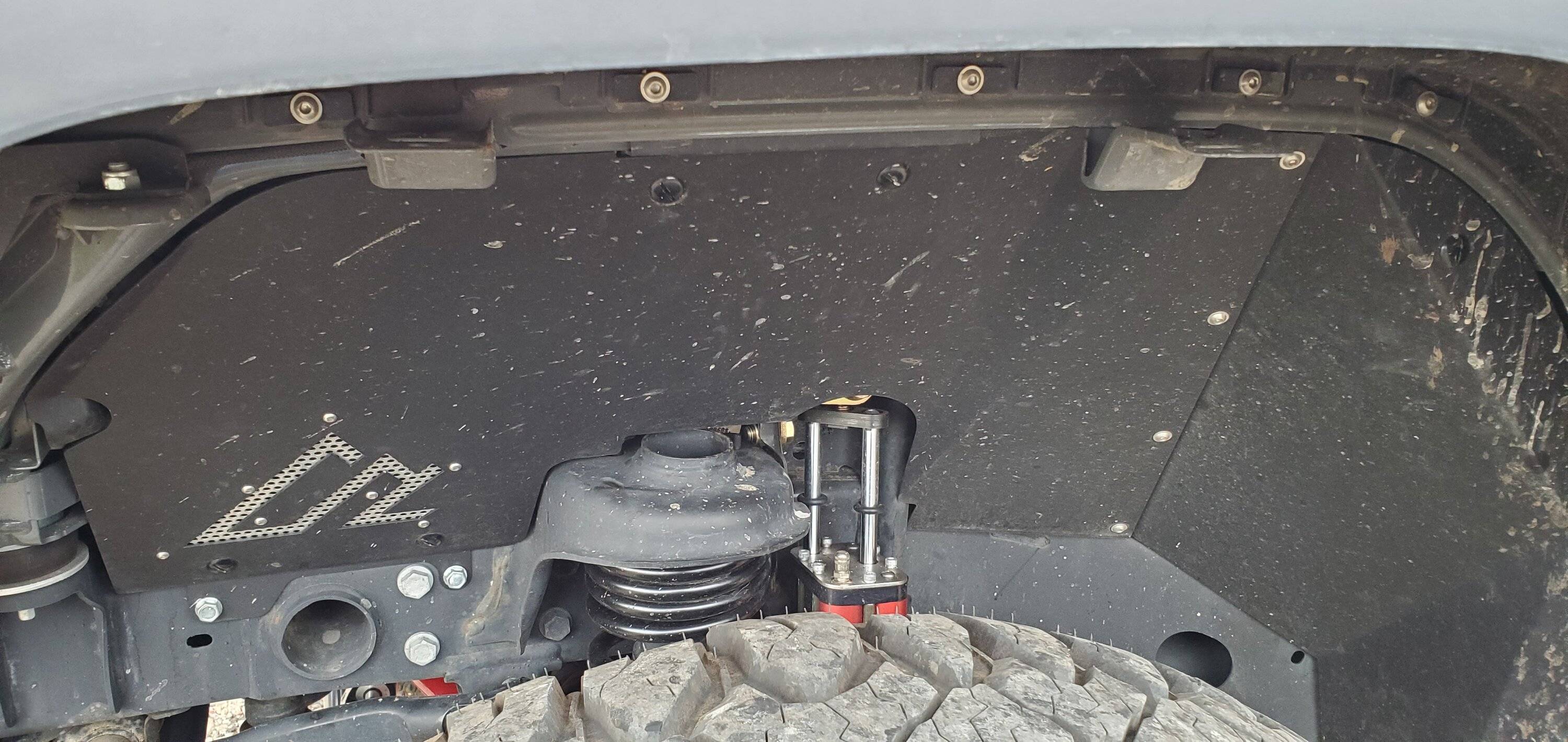

Since the fenders and liners are generally the first to limit uptravel, I chopped mine and added the most high tuck liners available that don't require major engine compartment modifications. Chopping the front will gain about 3.5" of tire clearance and about 2-2.5" in the rear. That's when the entire axle compresses at once, like dropping off a ledge. It's during the more common articulation, stuffing just one tire, that I noticed my next limiting factor to uptravel. The inner shoulder of the top of the tire hits the high tuck liners, while leaving a couple of inches of fender clearance left unused. My 4.5" backspace is the limiting factor of not being able to take full advantage of the chop.
This is where your 3.5" backspace will shine. All else being equal, you'd be able to run with at least an inch less bumpstop spacing than I can. That translates to at least a couple of inches of added wheel lift at the end of the axle, before unweighting a 2nd wheel.
This is the best pic I have that shows the unused fender clearance, while the tire was lightly rubbing the liner...
Jeep Wrangler JL 38 inch nitto trail grapplers 20200831_111218_resized(1)

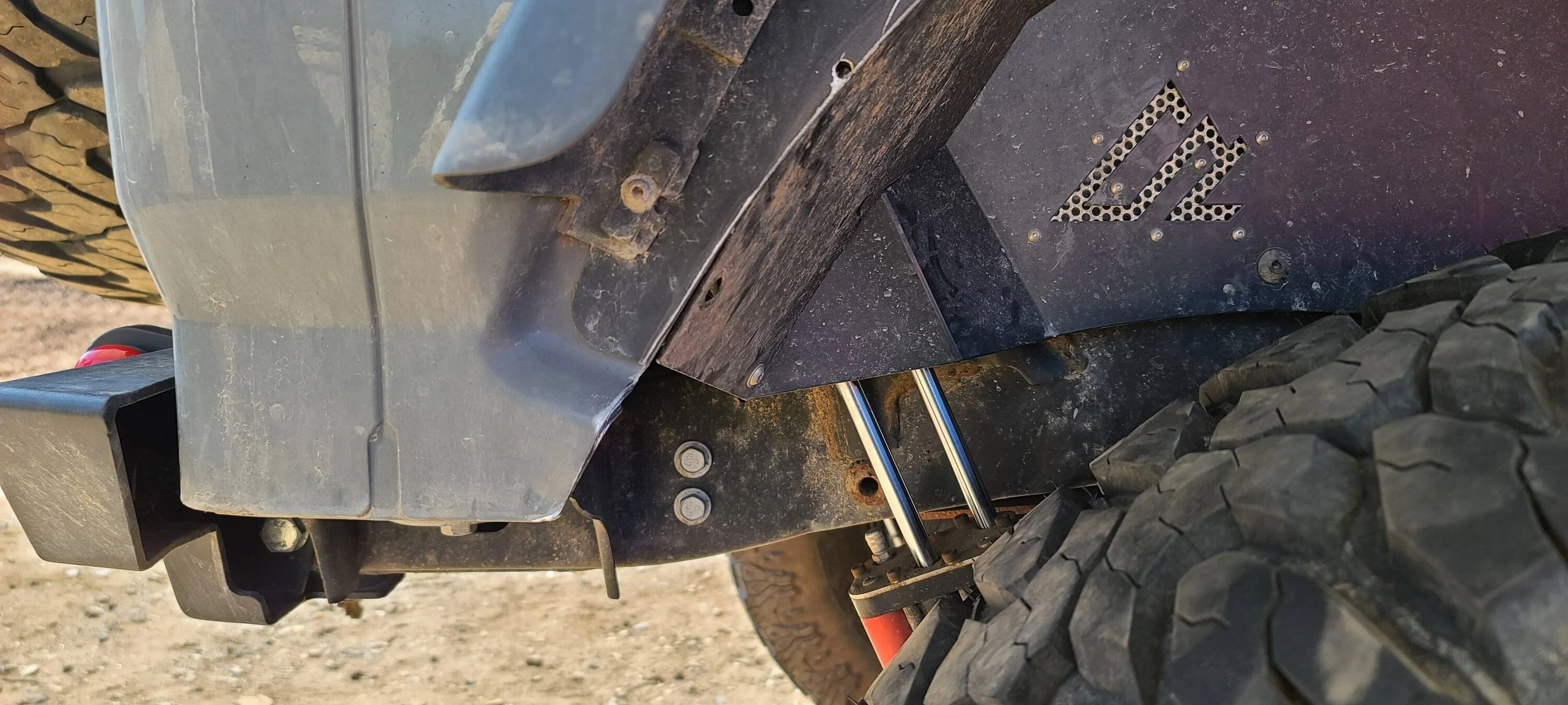

Also worth mentioning at this point, is that the 38's were hitting the rear pinch seams, which limited rear tire stuff by more than a couple inches...
Jeep Wrangler JL 38 inch nitto trail grapplers 20200831_111646
To sum it up for now, your 3.5" backspace has a clear advantage and I personally wouldn't further hinder tire choice by sticking to a 12.5" vs 13.5" tire, just for the sake of a nearly unnoticeable .5" of tire poke.
I could keep going on about backspace and it's affects on off camber stability and scrub radius, but this particular post is long enough.
Cheers for now, buddy!
