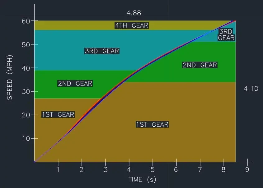

Once you have 37s it will be difficult to go back to 35s. It's like deciding to put a smaller T.V. in your living room and expecting to be just as happy with the view. 4.88 is a good idea with 37s and runs well around town, on the highway, and off-road. That said, here is a graph I made showing the difference between 4.10 and 4.88 with 37s. Big difference in the shifting but it was interesting to see that the 0-60 time didn't change. The reason you start to see 8th gear again is probably because it is shifting through 1-7 quicker with the 4.88 ratio. I'm no transmission expert but this graph makes me think that the 4.88 pattern is healthier on your transmission too. Another bonus is the 4.88 will change your crawl ratio from 85.9:1 to 91.9:1 if you decide to get into rock crawling.
