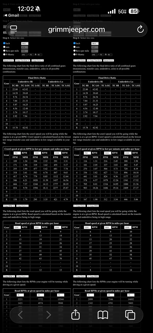

Thoughts on the 2.0 with 4.56’s and the light k02 37’s and some 21lbs rims?
You’d probably be fine. I’d normally recommend 4.88s with 37s but with the lighter gears and the lower torque curve of the 2.0 it’d probably be manageable. I still highly recommend a transmission tune though

I have xr 392 axles 4.56 gears. But yea other than that it’s a very light set up. I’m just torn between going Goodyear 315/70/17 55lbs or Bfg ko2 37 12 17 64lbs. Grim jeeper has me leaning 37’s. I plan on running scs rims that are only 21lbs. And oddly enough I have spare ti lugs from another project that are about half the weight of the stock ones.
Go with the 37s and with 4.56 you will be fine (especially if you drive a lot of flat sea-level miles).
