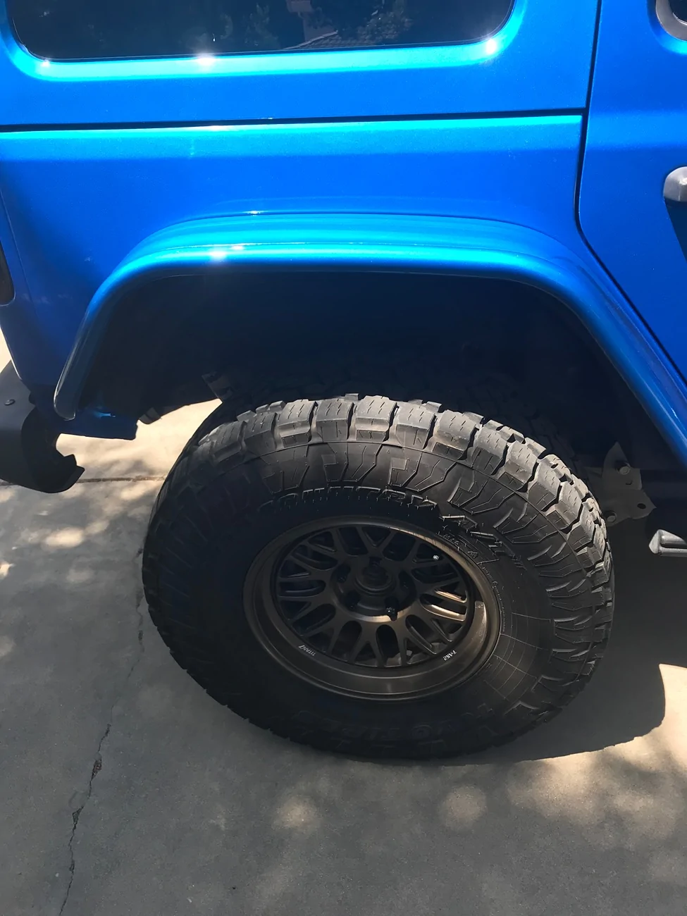

Did you lose any significant 'uptravel' in your suspension because of the taller tire hitting anything sooner?
no on my AEV 2.5 the bump stops stop the up travel before the tire makes contact with the fender.it is close but never rubbed once on Steel bender or Moab rim or flat iron mesa etc.. the AEV wheeloffset helps as well. know thephoto looks like it might be touching but it is not and the bumps are preventing any further travel.
