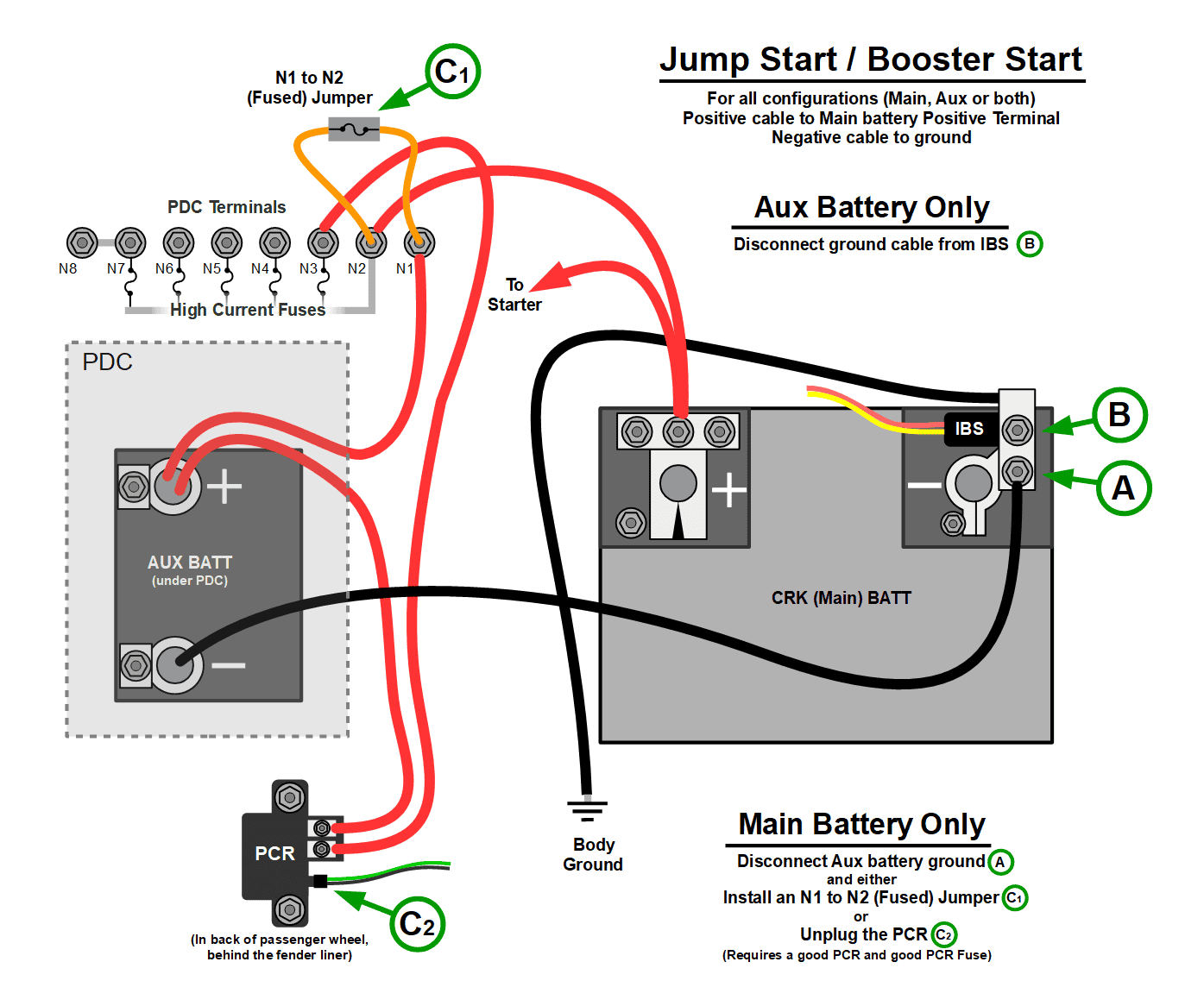

On another note; The two batteries, when connected in parallel, as they are almost all of the time, present themselves as one big poorly designed battery.
As has been shown in this excellent diagram which @Jebiruph prepared:
Jeep Wrangler JL 3.6L ESS IBS Information underhood-jumper-3a-
So, it is not that the IBS only monitors one of the two batteries, it actually monitors two dissimilar batteries as if they are one, and that does not seem like a very good idea
A really clever engineer might be able to grab some data from the IBS in the brief moments when the Power Control Relay has disconnected the parallel connection and then extrapolate from that data to make some assumptions about the characteristics of the individual batteries, but an engineer that clever would probably realize that measuring batteries is an inexact process and the small batches of data procured will not support meaningful conclusions, so the kludged system, as it seems to be implemented, is as good as any, for as long as the factory continues to install dissimilar batteries in a parallel configuration.

How would the Intelligent Brake Sensor and a trickle charger interact?
The trickle charger is not in communication with the vehicle's Body Control Module via the IBS. Yes?
The interaction between the trickle charger and the IBS occurs when current produced by the trickle charger passes through the IBS. If the charger negative is attached directly to the main battery negative post, the charging current going to the main battery does not pass through the IBS and would not be used by the IBS to calculate the main battery status. But the charging current going to the aux battery would pass through the IBS and would be used to calculate the status of the main battery.

Yes the IBS does not control the alternator, the IBS sends data via the Local Interconnect Network to the Module - Body Control. The BCM considers the data that the IBS sends and makes adjustments to the Alternator via the Gen Field Control, while monitoring the Gen Sensor signal.
How would the IBS and an off board appliance like a trickle charger interact?
The IBS may be able to observe the change in battery status effected by the trickle charger, even with the vehicle in sleep mode, but the vehicle is not equipped to communicate any info to the trickle charger, which might allow for best case charging of the battery array by the trickle charger.
Of course it could be possible, if it was specifically implemented as such, but it isn't in the current configuration.
With regards to the question posed "Does the connection point for a trickle-charger make a difference?" I do not think it does unless you disconnect the batteries from the parallel configuration and choose to charge one or the other.
If you do not disconnect the batteries the trickle charger sees one big battery with mismatched cells and it charges the system while the system reacts continually in an effort to balance itself.
The IBS sits in-between the main battery negative terminal and the negative battery cable so it can monitor all current flow into and out of the main battery. If you connect a battery charger directly to the main battery negative terminal, you have bypassed the IBS for the charging current going to the main battery, but the charging current to the aux battery will go through the IBS. The IBS will use that current flow for it's main battery status analysis.
While the IBS monitors the battery in real time, it's not necessary that it communicates to the BCM in real time. At some point when the BCM comes up, it will need to know the current status of the main battery.
It's about time for another disclaimer: I may post like I know what I'm posting about, but I don't have any special insider information, only personal observation and information from the internet.
