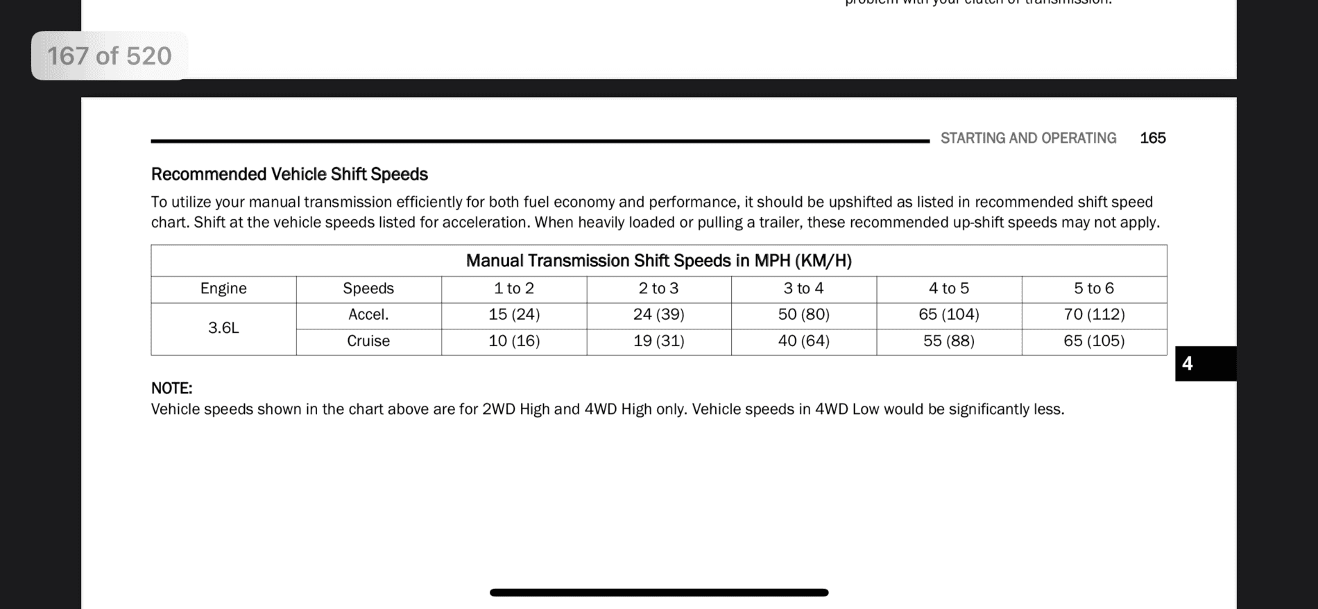

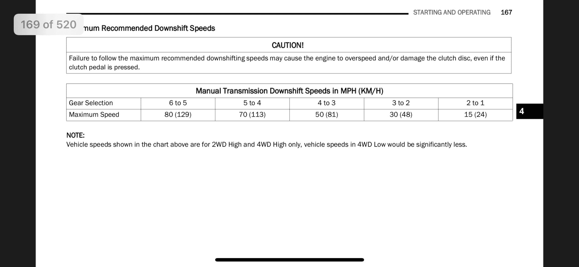

I'm worried I may be lugging the motor too often because I'm trying to stay under 2k RPMS and increase fuel economy. I've heard from Rubicon owners that the 4.10 gear ration makes the manual feel a totally different way. Some say it feels "right". In my Sport, I sometimes struggle to figure out what gear to use while cruising on the freeway. If I'm going 75 and go into 5th, I'll feel like I lose speed on slight hills and I start to lug the engine so I have to downshift. I still have no idea when to use 6th gear, it feels like its useless for Sport gear ratio?
I've read the Jeep manual and they mention the proper gear changes according to speed, but the higher gears and speeds still don't feel right. It claims 65 mph under acceleration is 4th to 5th gear change, followed by 70 pm under acceleration is 5th to 6th gear, but this feels like such a high gear and it seems like the engine immediately lugs due to losing torque and being under 2k RPMs.
I think its great to get this thread going because I know many of us manual drivers have different findings on the JL. We're all learning together.

That's because at 75mph your jeep is pushing so much air with it's terrible aero lol. 6th is pretty much useless, even with the rubicon 4.10s. With 35'' tires I have to be doing 80mph to use 6th. I'd prob get it back with some 4.88-5.13 gears but that's down the road at least until the factory warranty has expired. I'd much rather have another gear between 1/2, 3/4 or 4/5 for a vehicle like a jeep.
The JK had better 3rd and 4th gear ratios....

I would never downshift to 2nd at more than 30. It’s a Wrangler, not a Miata. I do employ engine braking and rev match to make that a smooth affair, but when I need to quickly decelerate I use the brakes. My $0.02.

I've heard of these warnings too, but my Wrangler doesn't give any audible or visual alert. I've also heard of speed relative lockouts for first and second, but I've never had first or second locked out either in my wrangler. Could it be that the recall "fix" has eliminated the need for these warnings of overspeeding the clutch. I think it is a far fetched assumption unless the cluch/pressure plate designs are different on newer Jeeps.
