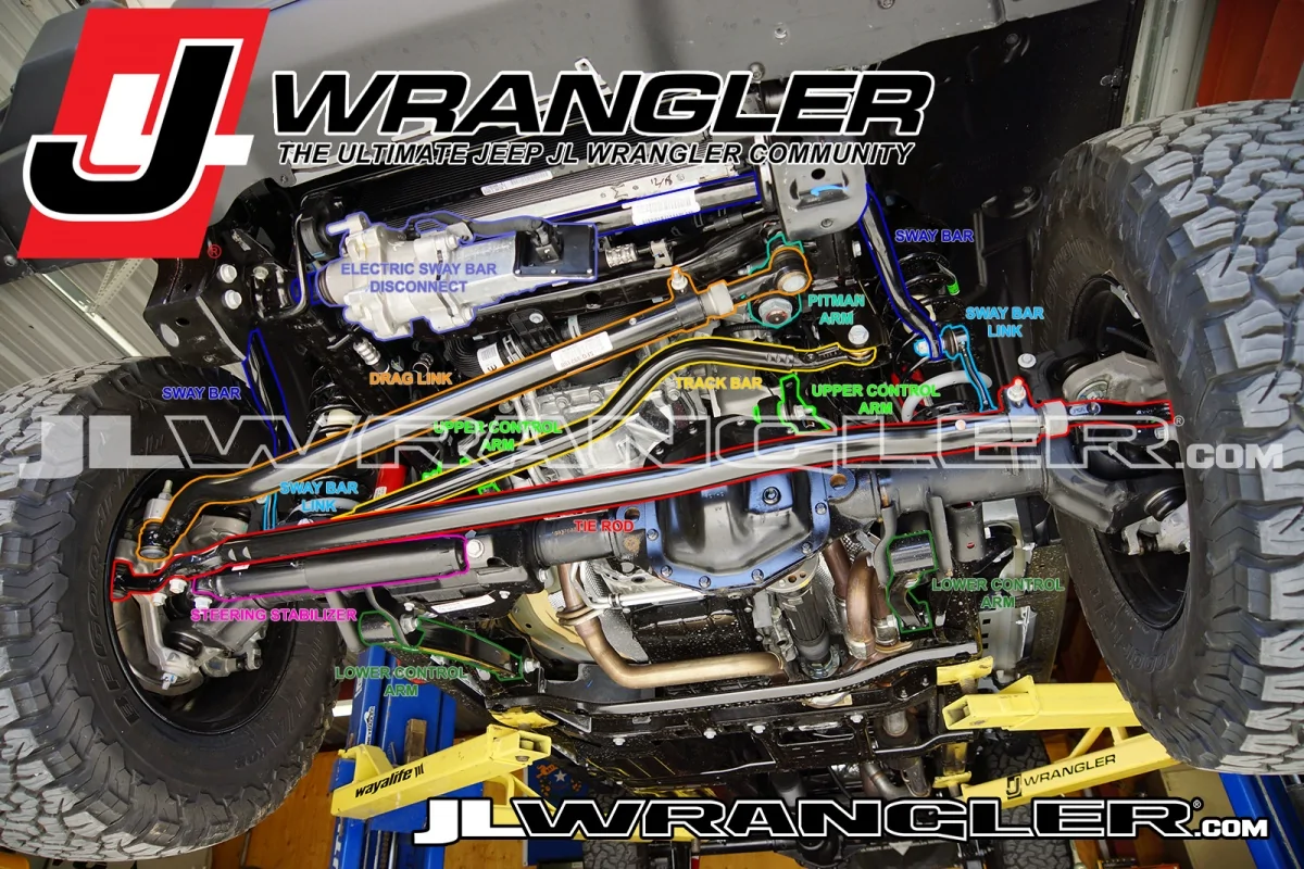

Get someone behind the wheel in the driveway or parking lot. Have them turn steering wheel back and forth (slowly) while you look at connections on tie rod and the drag link. If you notice slack or slop in the connections before the wheels start to move then it’s time for new bars.
It can also be as simple as needing to retorque the nuts on these bar ends. I have aftermarket so my torque values are different than you stock ones so I can’t tell you the value to check for.
Search torque values on this forum, there is an excellent thread/list of stock torque values.
I just changed all this on my 2022 with 40k miles last month.
Check YouTube for easy ball joint check video.

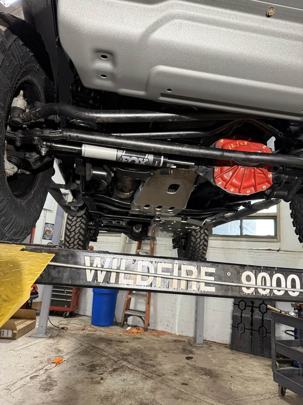

My 2021 JLUR would start to wobble at speeds over 30 MPH if I hit a bump or pothole. It only has 15,000 miles on it. 2" MOPAR lift, 35's x 11.5 x 17. New steelies properly balanced. I put on a Fox through shaft type steering damper and the problem has not recurred. There's no slop anywhere in the front end.
