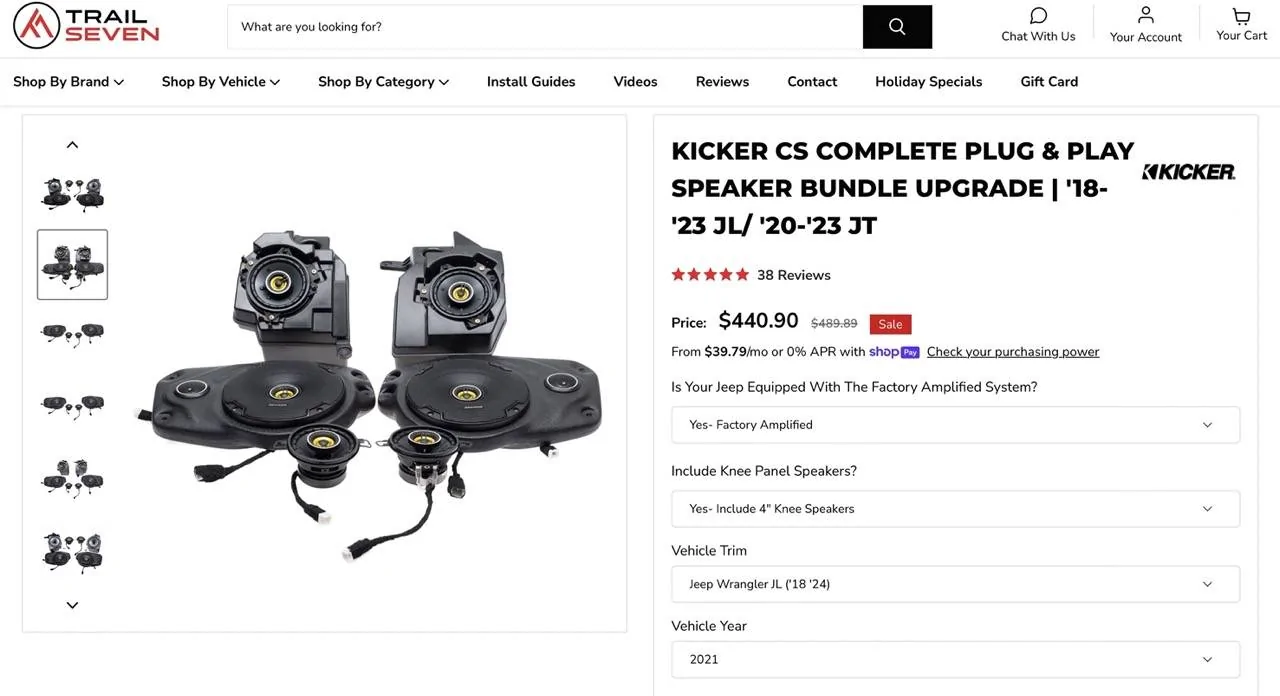

My situation is slightly different than yours, but might be somewhat informative. I have a 21 JL with the factory Alpine upgrade (amplified, with subwoofer). All of the speakers are full-range, but may be limited by a crossover somewhere. The ~2.5" dash speakers and smaller speakers in the soundbar are 4 Ohms. The 4" speakers (knee panel, soundbar) are 2 Ohm. I don't know what the sub is. It's still installed.
I replaced all (except sub) with a Kicker CS kit from TrailSeven.
Jeep Wrangler JL 2024 Speaker Upgrade Specifics TrailSeven
All of these are 4 Ohm. This is a pretty good deal when they are on sale. They solder the plug-in wiring harnesses (and crossovers on dash tweeters) onto the speakers, Tessa-tape all of it, and the soundbar speakers are already installed in the soundbar pods.
Their setup for a non-Alpine JL uses the same speakers, just not as many. Both systems have pre-installed crossovers on the dash tweeters.

Thanks for the reply! Great info! I’ve looked at the TS kit. It looks like a screaming deal but they changed the soundbar for ‘24. If the 4” knee speakers and dash tweets are wired in parallel, I’m assuming a 2 ohm load wouldn’t be too much. Your system has an external amp I believe, I’m also afraid of frying this very expensive looking head unit hahaha! Alpine makes a set of 4” components that might be a safer choice

Sticking with the same brand and product line is definitely the way to go. They will be "voice-matched" to each other.
can the factory mesh covers be used with this kit ?
On the dash and knee-panel speakers, yes. On the soundbar- no. The pods hold larger speakers that wouldn't normally fit in the original location.
