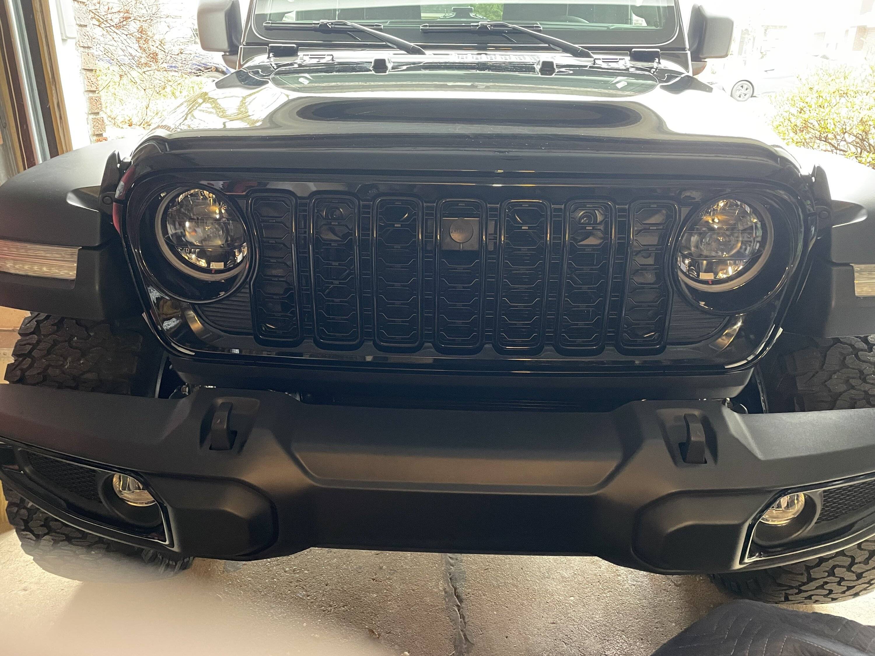

I think Mopar actually sells a hood lock as well. Basically the same device as the bolt however the opening in the plastic insert is in a slightly different location.
Nope.
The hole is in exactly the same location.
Here is a '24 grill with the factory hole on my '22 JLUS with a BOLT lock.

Thanks. I cut my opening according to the template, been wanting to replace it. It looks nice and clean.
