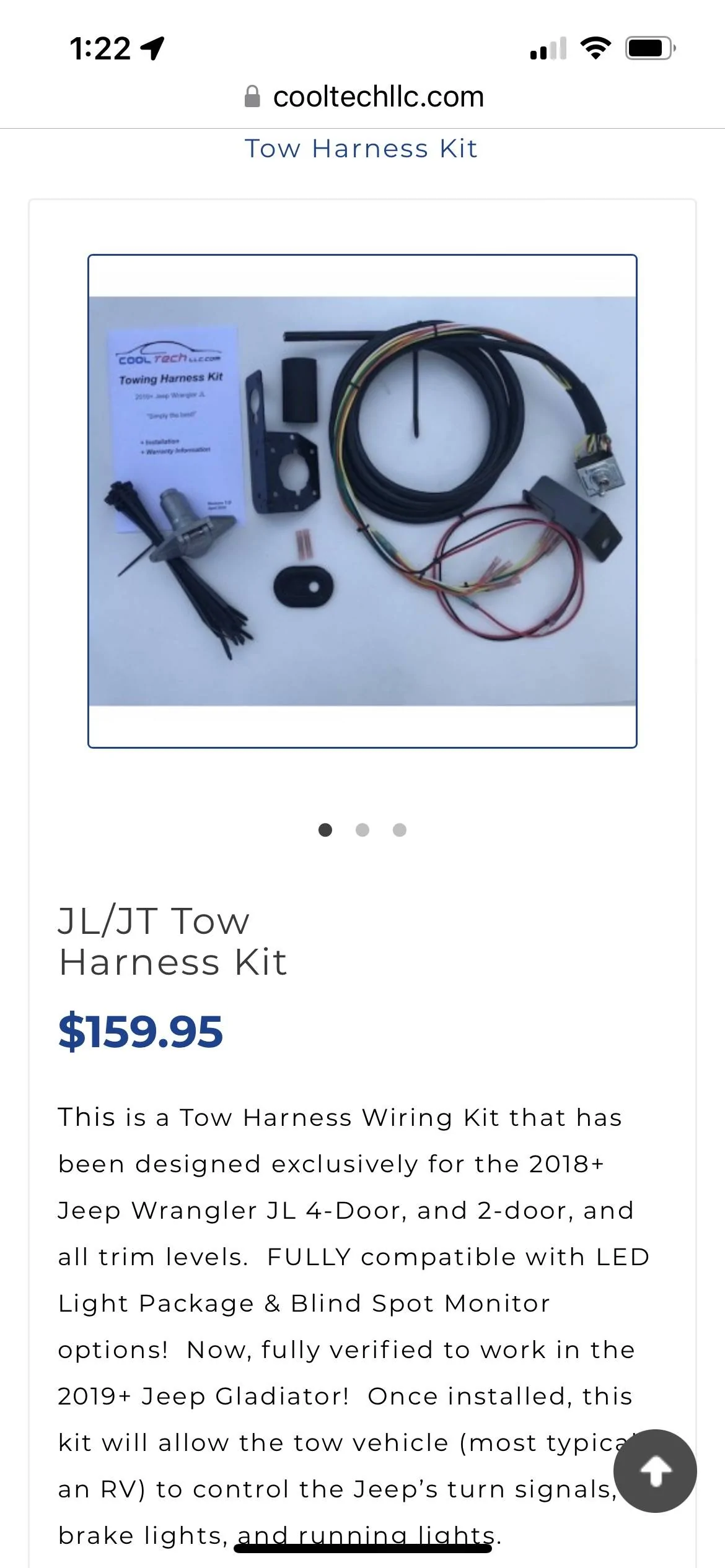

Blu ox and hopkins light wiring says there is no plug and play kits available for a2022 only kits where you splice wires are available, 2021 plug and ply kits are available for them,would that work or has something changed in the 1022 Jeep wiring, I don’t want to cut wire for the other kits

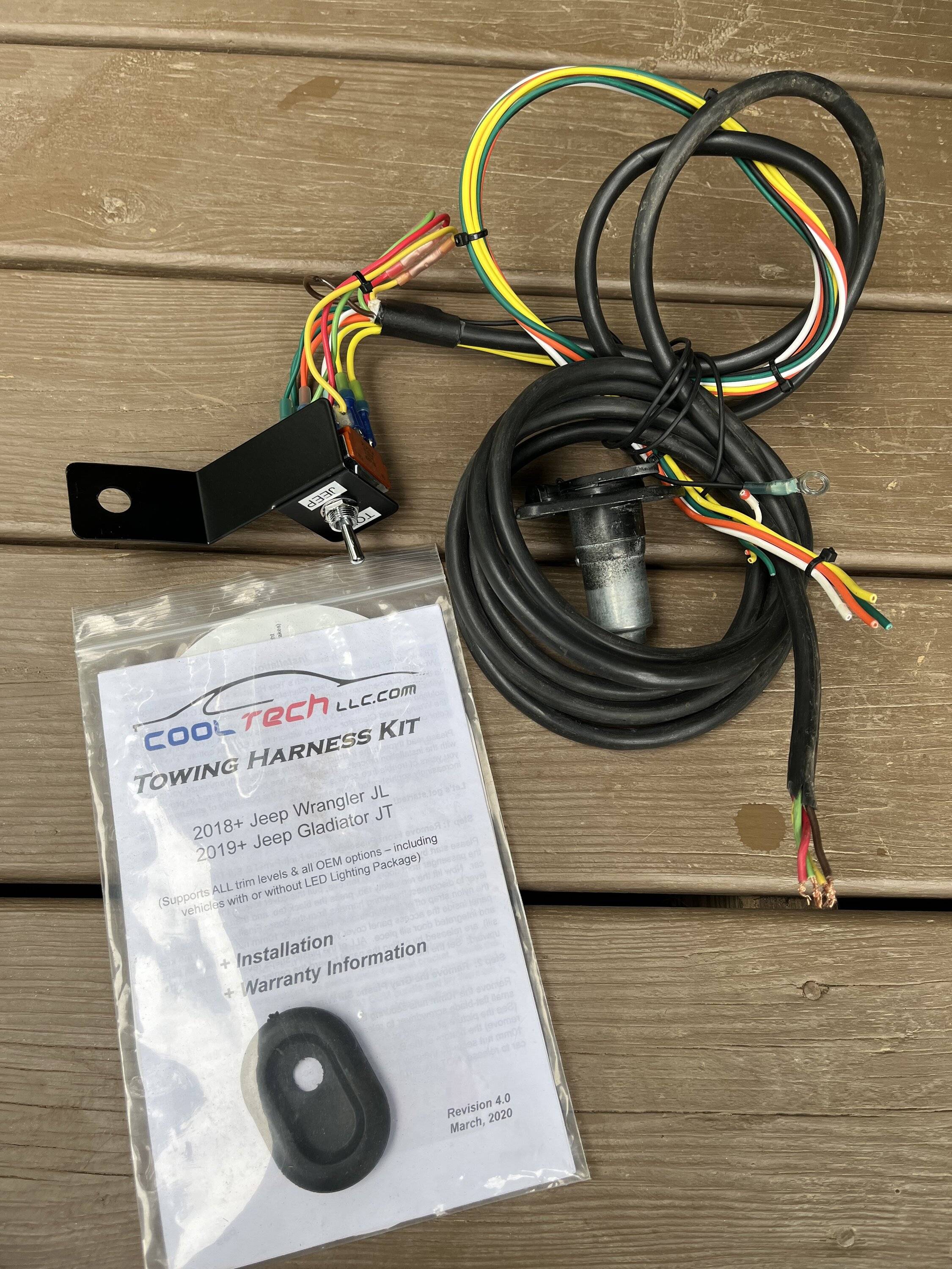

I have the Cool Tech wiring system that I took out of my 2021 JLU. It worked perfectly, but you do have to wire it into your system. I did it no problem.
