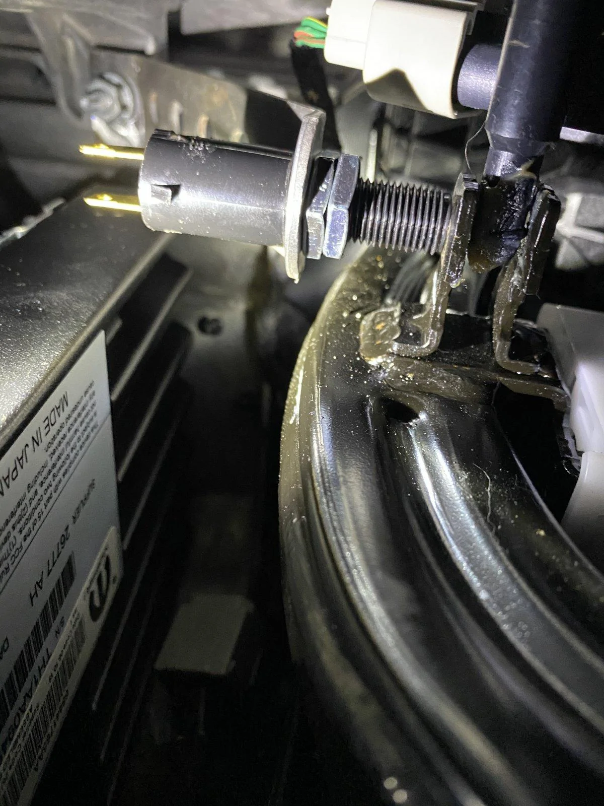

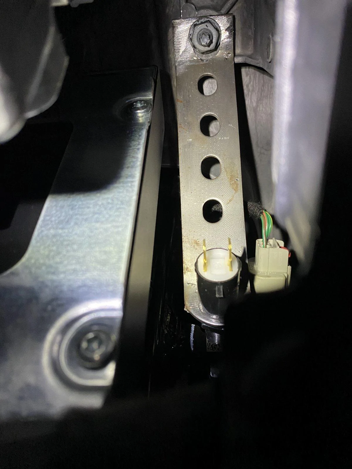

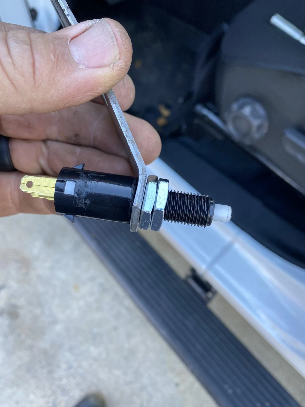

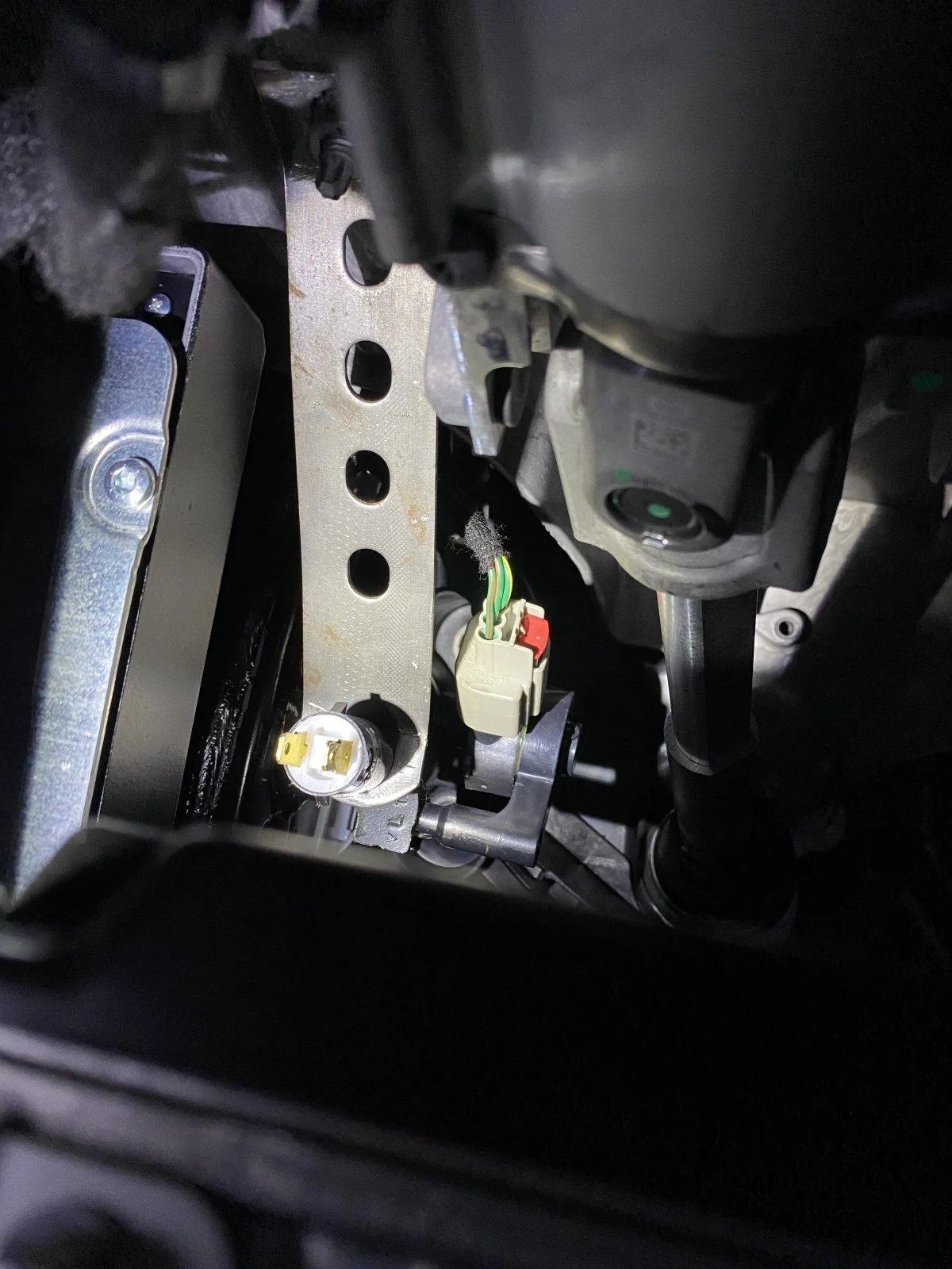

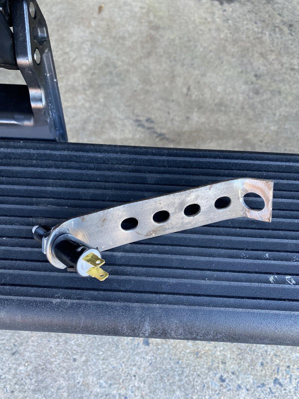

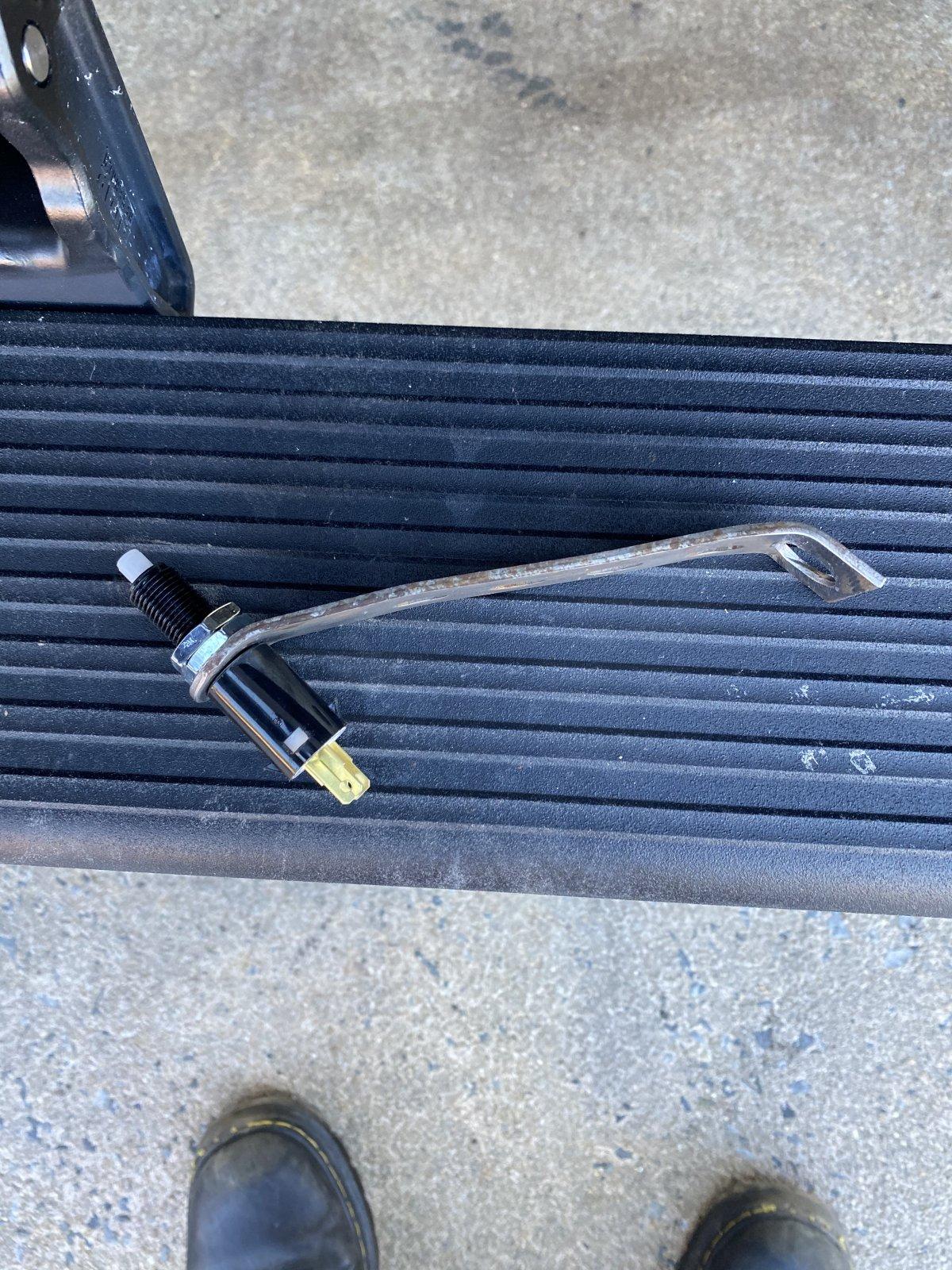

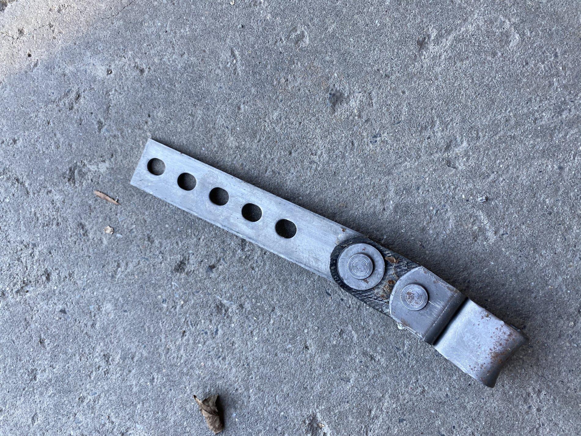

I thought I’d share what I done to obtain a brake light switch circuit for my Roadmaster Even Brake system for flat towing. After searching in the forum and seeing very few posts I decided to build my own. I couldn’t see paying the price for the bracket kits I found online so I put one together with some stuff I found around the shop. Here yah go!
