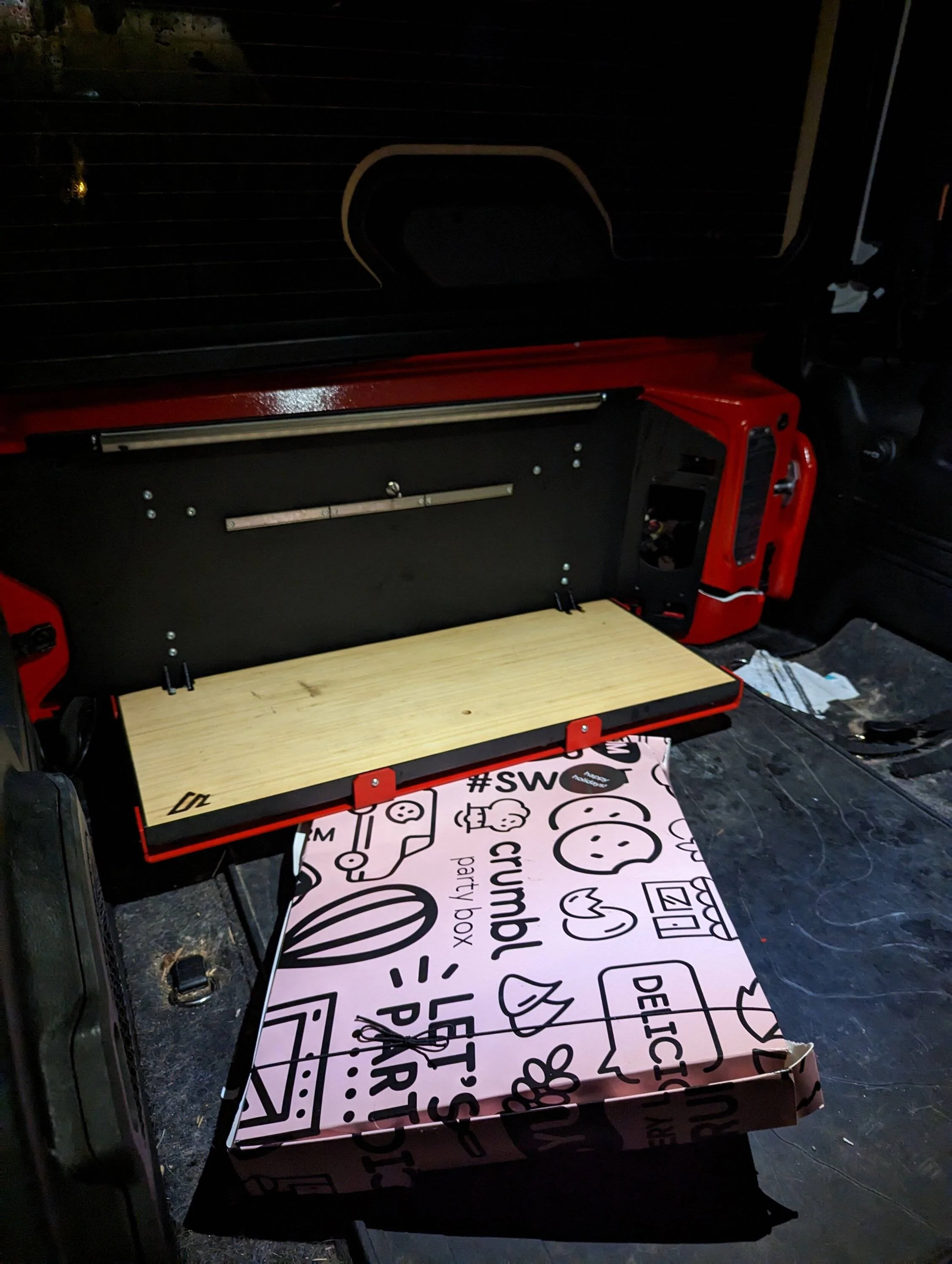

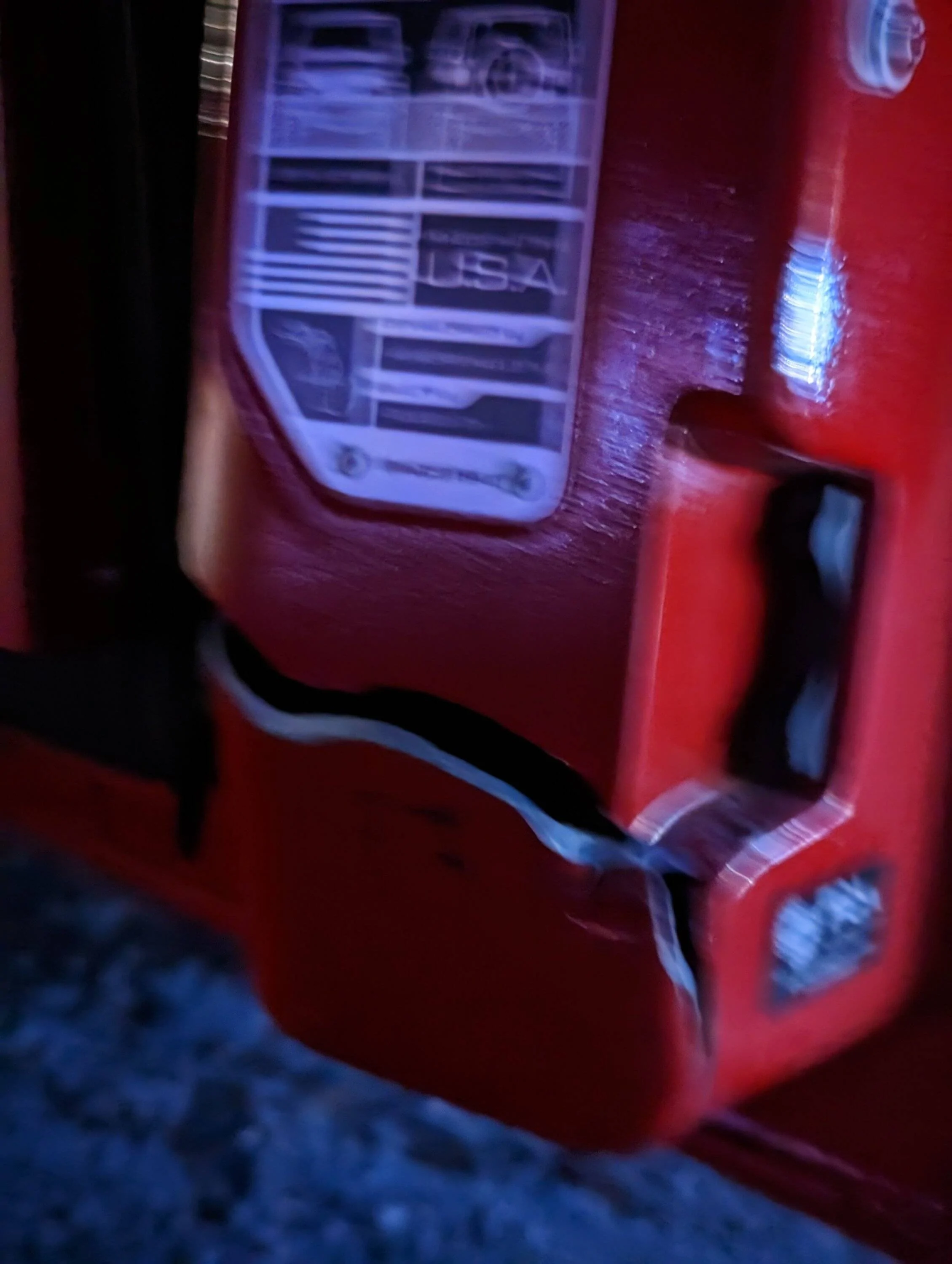

Hey folks -
Someone smacked our Jeep today, our steel bumper took the brunt of it. However, I opened the tailgate to see that it has almost exploded.
Is this the right part?
https://store.mopar.com/oem-parts/mopar-tailgate-68281561aj?c=bD0xJm49U2VhcmNoIFJlc3VsdHM=
I have attached a couple terrible pictures as we had to get to the hospital.
Was trying to find the mopar section - I'm guessing I'm going have to get this painted too?
Thanks folks and happy holidays!!

That is the correct part, but, here are 4 links to the same part that are about 200 cheaper than the link you posted.
68281561AJ - Tailgate 2018-2022 Jeep Wrangler | Mopar Wholesale Parts
2018-2022 Jeep Wrangler Tailgate 68281561AJ | Mopar Factory Parts
MOPAR 68281561AJ Tailgate | RockAuto
68281561AJ - Genuine Mopar TAILGATE (moparpartsgiant.com)
Yes, you will have to get it painted. Sorry if I'm telling you things you already know, but, you'll need to know your paint code (can be found on door jamb) to ensure that the place you choose can paint it appropriately. They *should* know that, but, best to be able to ensure that you'll get the right product.
You'll also need to keep all the hardware from your old tailgate. The plaque on the tailgate with the Jeep dimensions etc can be removed drilling out the exisiting rivets, then you can rivet the plaque onto the new tailgate.
You can wrap your Torx bit in electrical tape or some type of tape to help avoid some paint marring while undoing the bolts that hold the tailgate to the hinge, but unfortunately some of the paint will crack.
Painting should be under 200 bucks if you find a local spot.
