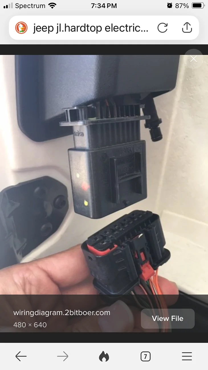

Firstly, did you check that the connection is plugged together? It’s at the back of the hardtop on the driver side.

I checked the connections and all were tight. The spray hose actually had fluid on the end, but did not come out of the spray. The fluid was filled as well.

In addition to the hardtop, you also need a set of freedom panel mounts, a set of bolts for attaching the hardtop, and a wiring harness with a washer. The wiring harness itself consists of a steering wheel mount and wiring to the rear window where the washer, heater, and wiper are. As our colleagues wrote, in the back on the driver's side, when you access the rear trunk, on your left hand side you have a socket for the hardtop, and it consists of an electrical socket and a connector for the washer. You have to have this connected for everything to work.

Check fuse 21 is not blown and seated correctly
ScotM
Scot
Jan 3, 2023
38
1,236
1,896
Southern California
2022 Jeep Willy's JL 2 Door
You probably need this tool and start checking pins for voltage starting at the fuse box to make sure you have power at 21, then back to the main connector at the back of the Jeep that plugs into the hardtop.
