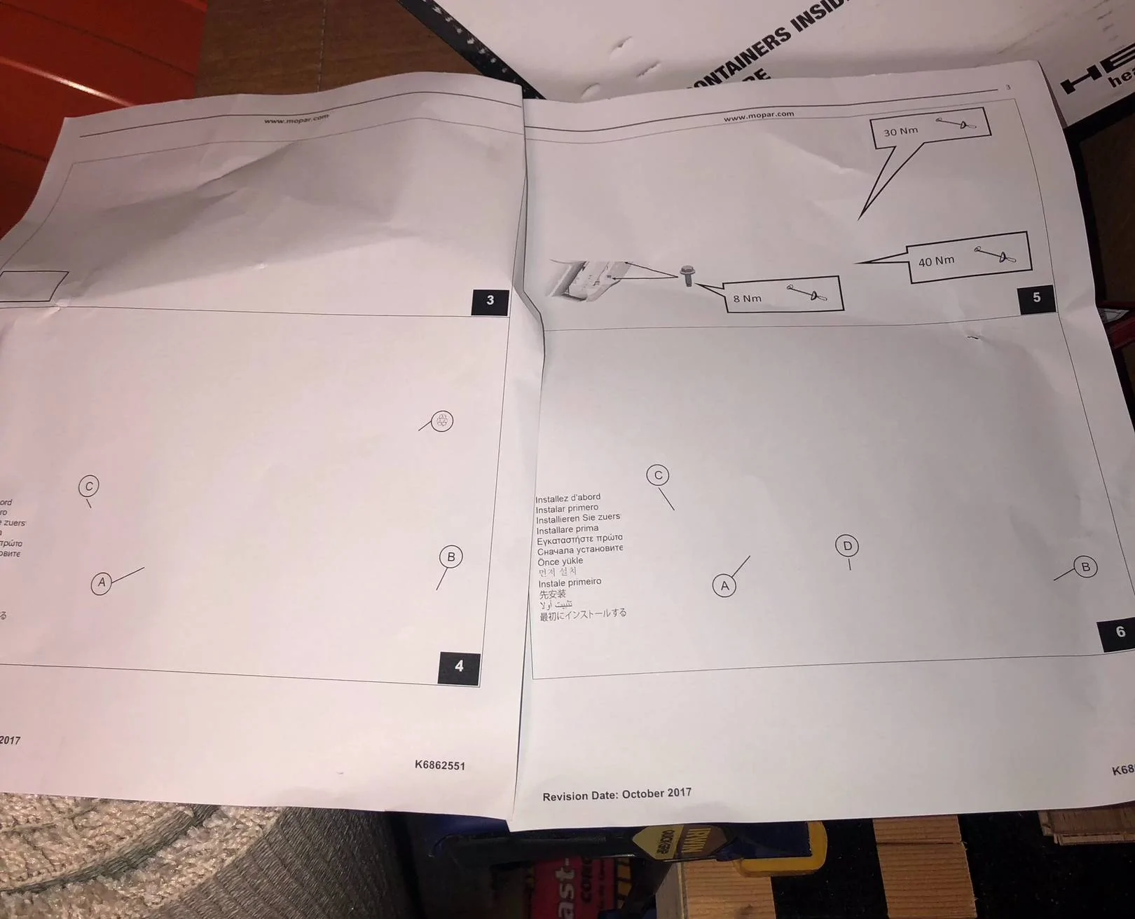

If the wiring is all there, it’s a very easy DIY to add the hitch receiver.
This is true! Much rather have the wiring and add a hitch vs. the other way around. FWIW though, the Mopar hitch instructions are lacking, LOL ?. Good thing the installation is intuitive.
Definitly, of the three items in that option to be missing, the hitch is by far the easiest.
