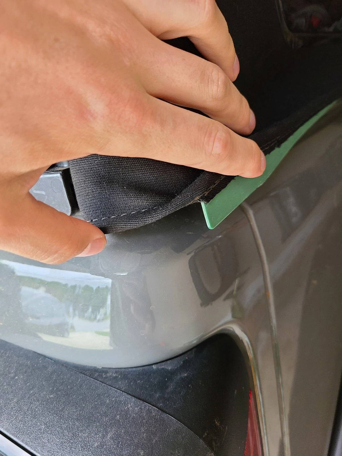

Thanks for all the input. Here is a pic of exactly whats wrong. No matter how hard I push on the corner it won't pop in.

If you don't pull up on the bottom tab by the bracket when installing, it doesn't want to align since the tabs will fold up. At least that was my issue the first time or two.
This. May not be your issues specifically, but if you dont hold the green tab that goes the length of the window while you put the pillar in it wont go all the way on.
Edit: wow you posted at the same time I did, I think this might be your issue
Edit2: Pics
Line the pillar up and push it up and into place
Rotate the tab out
Push in

OK I will try that tomorrow. I didn't know there was a tab up top. To me it seemed like it just rested up in there. I hope that works. Thank you.
This helps a lot!
I would not drive around like that, especially on the highway.
I’ve been meaning to have my son film me installing my windows because I think I have it down to a science, and I don’t follow the same order as listed in my 2018 manual.
Try this:
Remove the window, the slide just the top into the channel. Next, grab the rear pillar (the one in your picture) and put the top part in, first. It should move into position easily, though you may have to move the whole window side to side to line it up. Once in place, line up the bottom tab from your picture. Move the plastic ziploc thingamajig out of the way as needed, and pop that tab in. It should make an audible click. Once in, fasten the bottom ziploc from back to front, and snap in the vertical ziploc last. Finally, tuck in the Velcro tab above the vertical ziploc.
Hard to describe in words. I will try to get a video done.
Bottom line, that tab should click into place.
Ok, yeah mine will do that. I honestly have never worried about it. Follow what @OldGuyNewJeep says. I just give it a good smack and move on:like:

I do the same, Slide the window in, insert the top of the rear pillar into it spot in the top and then insert the tab while getting the green tab into place in its slot on the body and run the bottom tab into the slot from back to front (I know what you mean about describing it). Then I insert the front green tab into the the C Post slot. Mine locks in pretty good, but I've never really heard a click though. Never had one blow out, but I've never driven without the rear window in place holding the left and right rear pillars tight into the body.

I think it may have to stretch because no matter what I do it will not snap in. When the back window is in the whole top is really locked in and doesn't move when I drive at high speeds on the highway.
