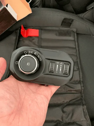

We are new to the Jeep Family so after a few weeks we decided to replace the headlight switch on our 2018 Wrangler Sport JL. Our Vehicle Didn’t Come with Auto Light Switch. Part used was OEM
Parts Used: 68292842AB

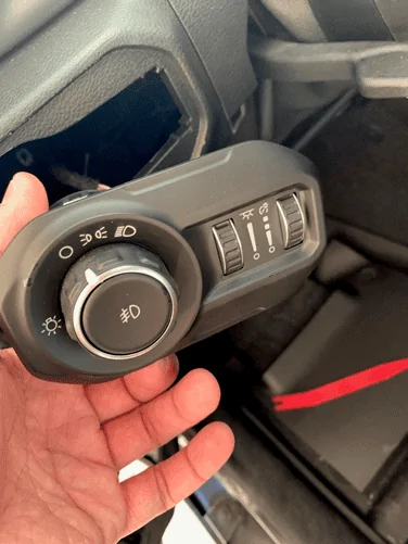

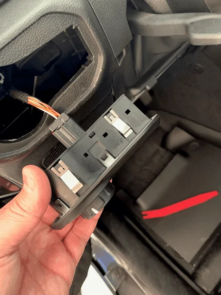

We Used the trim removal tool to pry out the old headlight switch. You can also use a screwdriver

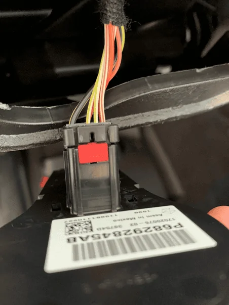

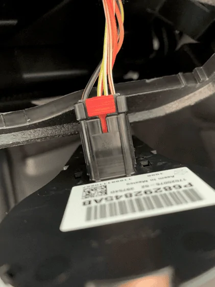

Lift the Red Locking Tab to remove the Connector, Don’t forget to Lock the red Tab after replacing the Part.

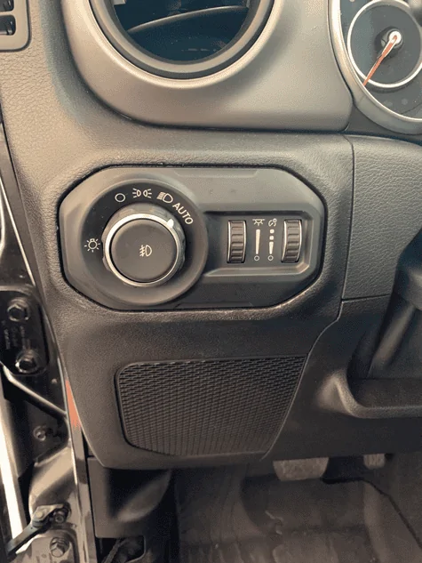

Leave it on Auto, Car turns off Lights go off.
