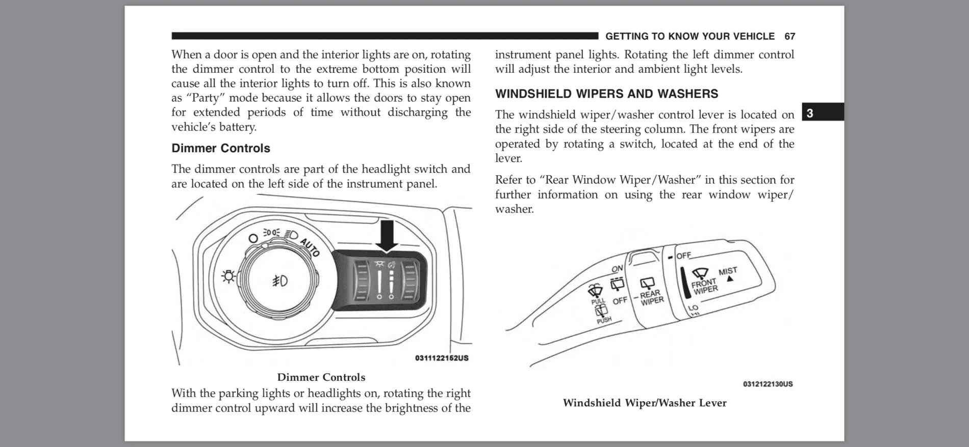

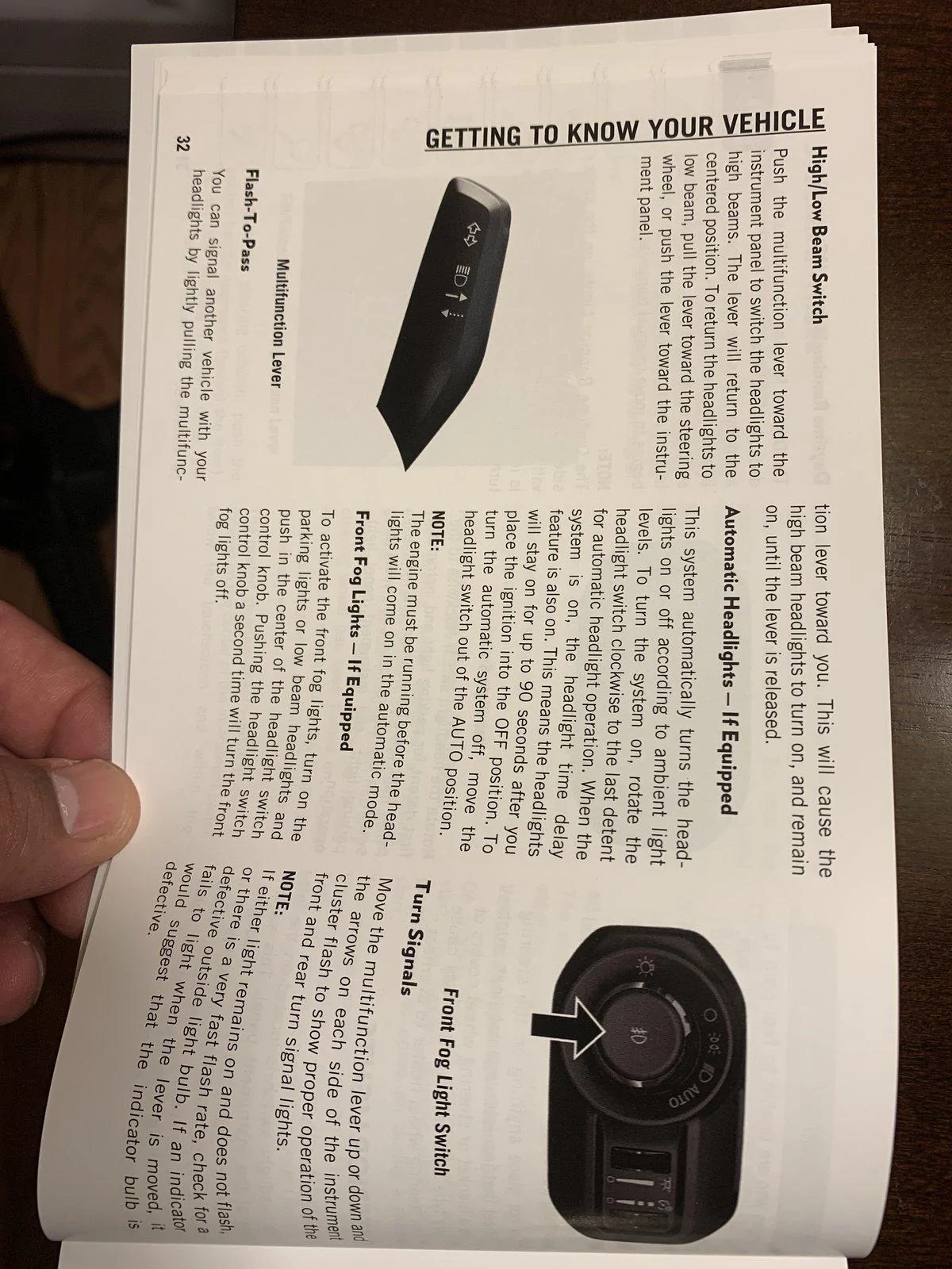

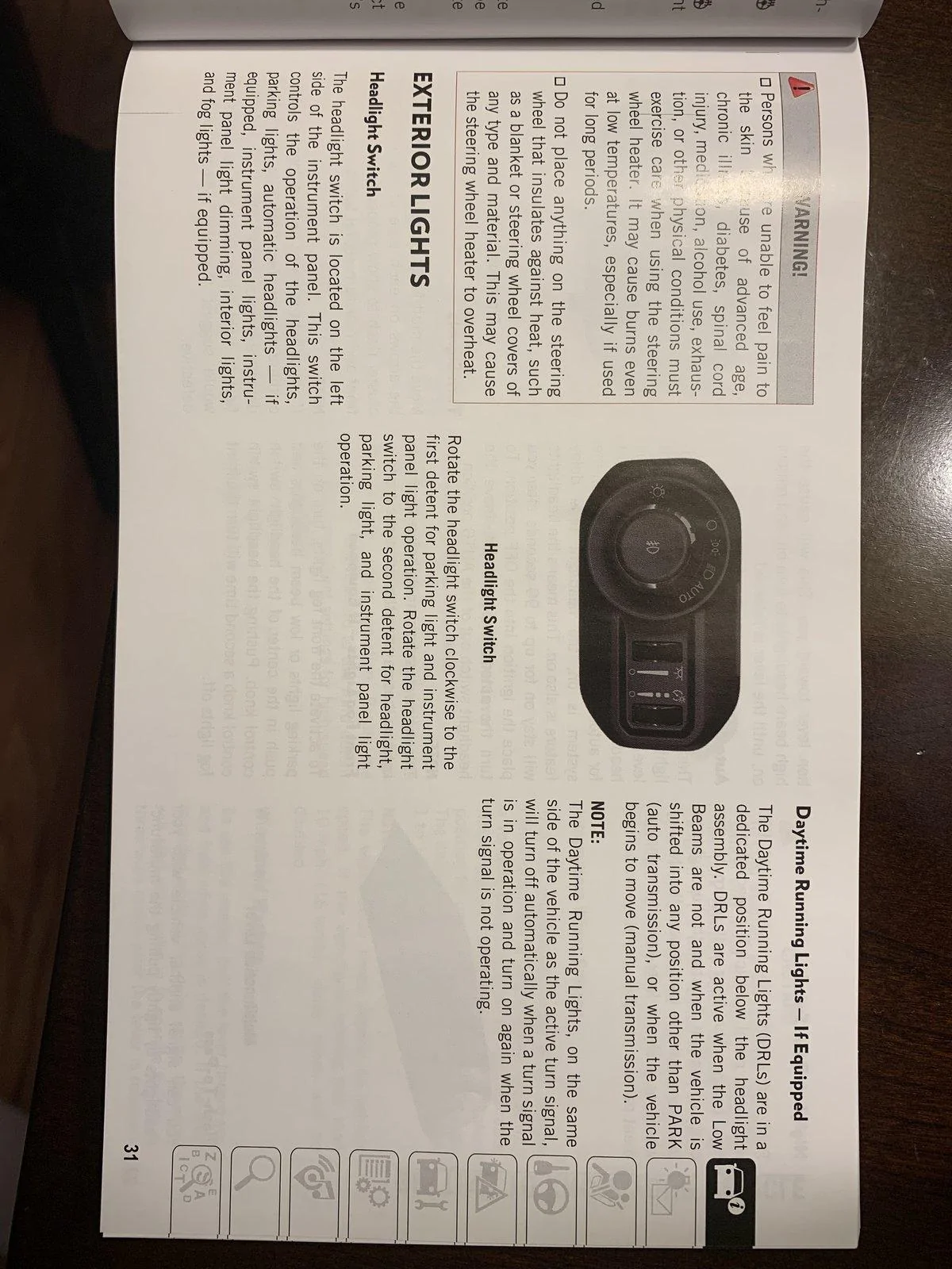

Hello guys and gals,
I bought my '19 sport 2 door in may. It had 13 miles on the odometer.
There are 2 knobs to the right of the headlight switch mounted vertically.
The farthest right knob dims the instrument cluster, hvac control buttons, touchscreen, etc. and works like it's supposed to.
The knob on the left closest to the headlight switch doesn't do anything and hasn't done anything since day 1 with me. I have played with it using all kinds of different combinations of: key on, engine off, key on, engine on, headlight switch off, headlight switch auto, doors open, doors closed, dome lights on, dome lights off.
Am I missing something or doing something wrong?
The owners manual was no help.
Thank you in advance!
