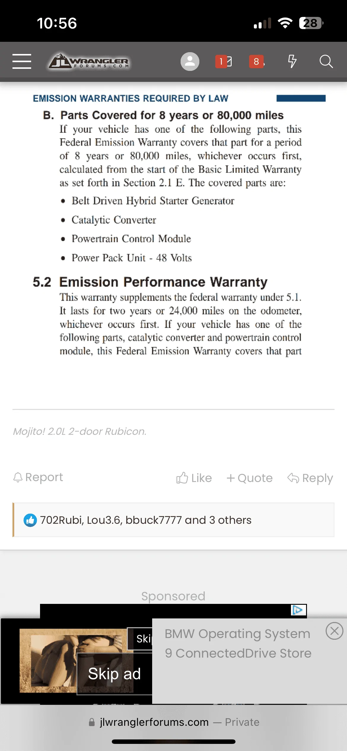

Yes the 12 volt battery is only 36 months. Regarding the 48v battery, you need to look at written warranty data; I am certain it’s eight years or 80,000 miles for the 48v battery and belt start generator and associated equipment. Just look it up online….
