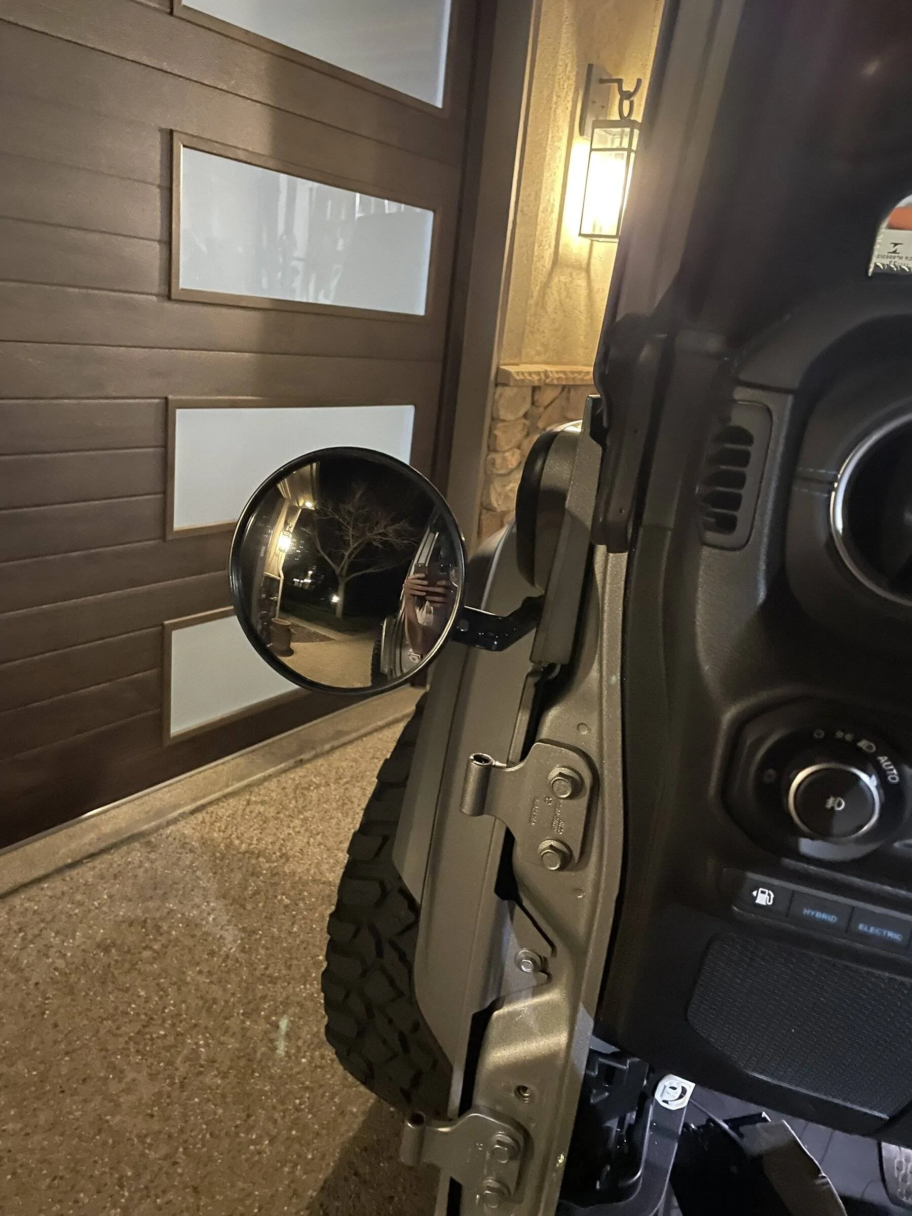

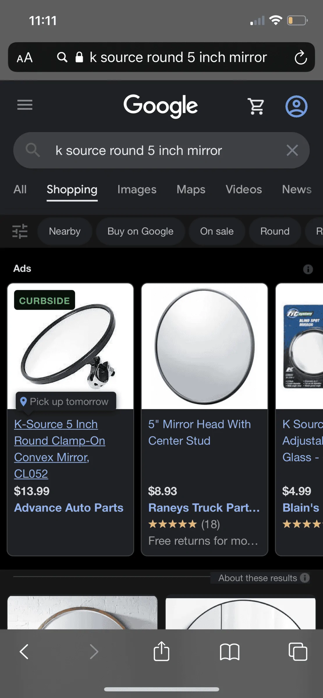

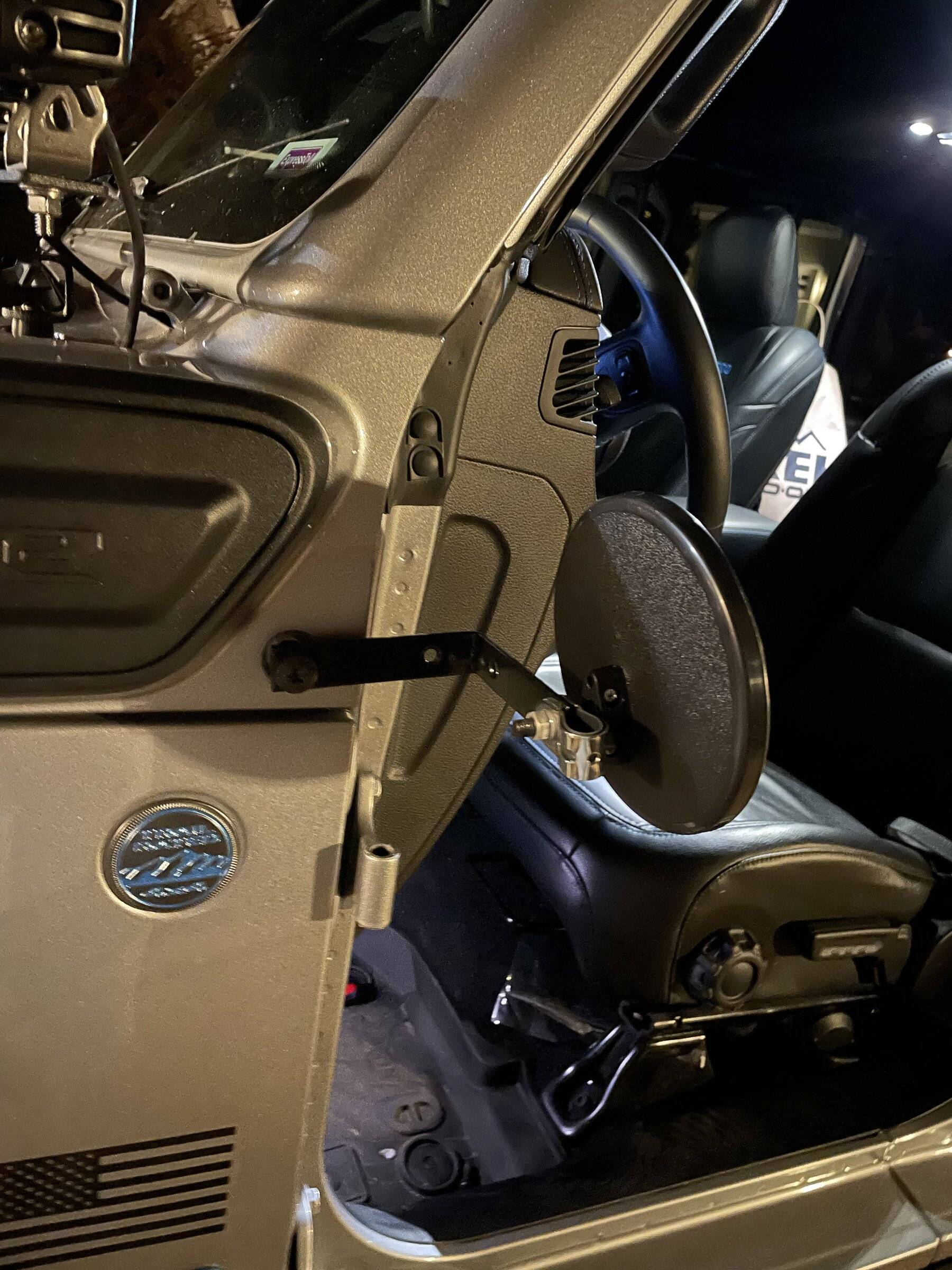

Headed on a trip to Moab this upcoming weekend for my first time on Hell’s Revenge and wanted to take my doors off for the trail. Just found out that Utah requires a side mirror but didn’t have time to order one. Found this K-Source 5 inch Round Clamp on Convex Mirror, CL052 at Advance auto parts for 15 bucks. After that I ran to Lowe’s and grabbed a normal L shaped corner brace from the hardware section and enlarged the hole on each end with a drill. Additionally, I used the OEM hard top bolt for extra length and found 2 M8 nuts to use as spacers on the back side of the bracket. This helped to space the L bracket away from the body and paint. Looks great and seems to be very sturdy. Can’t wait to try it out this weekend. Great alternative to the 100 dollar mirrors online.
