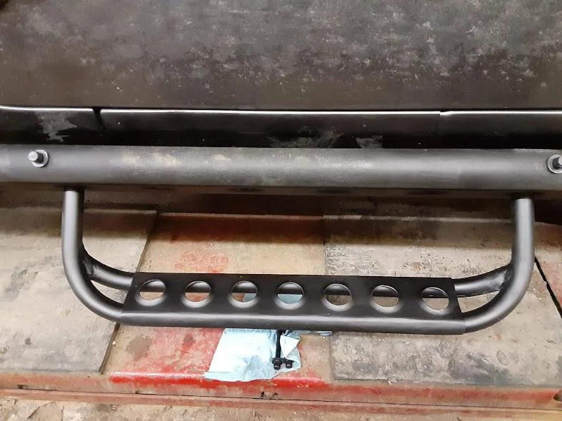

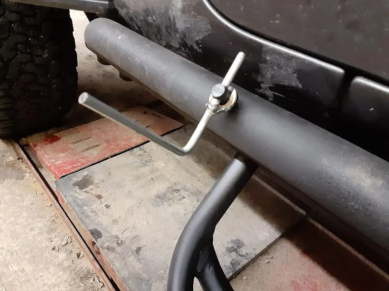

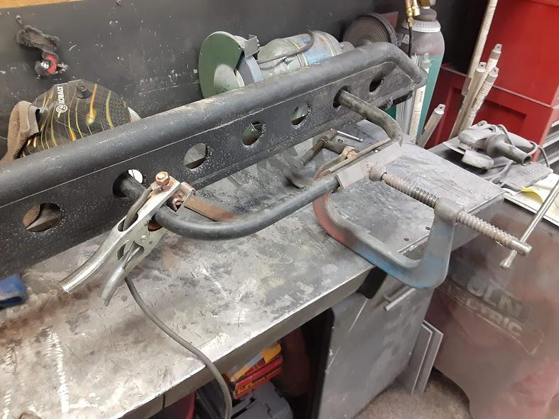

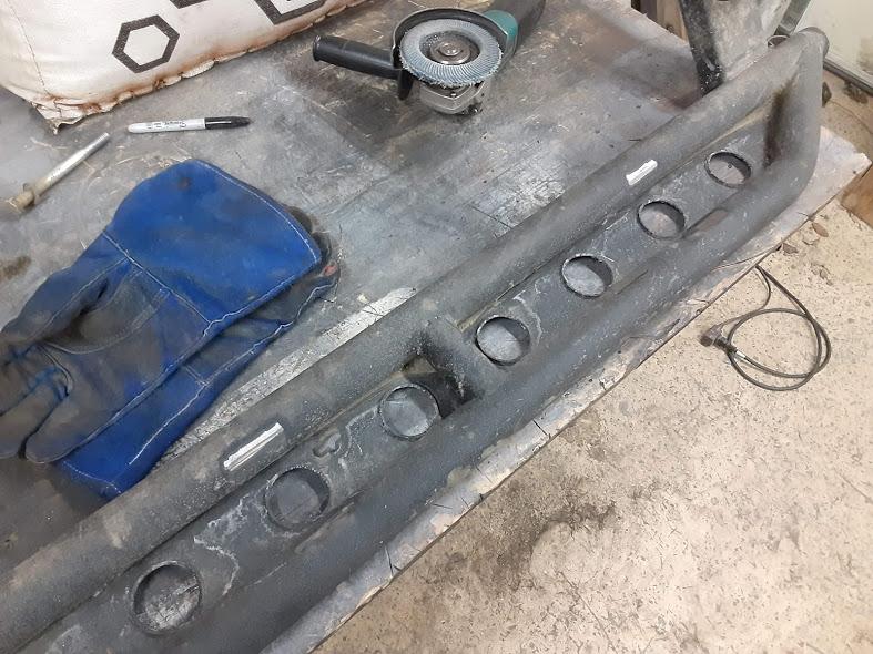

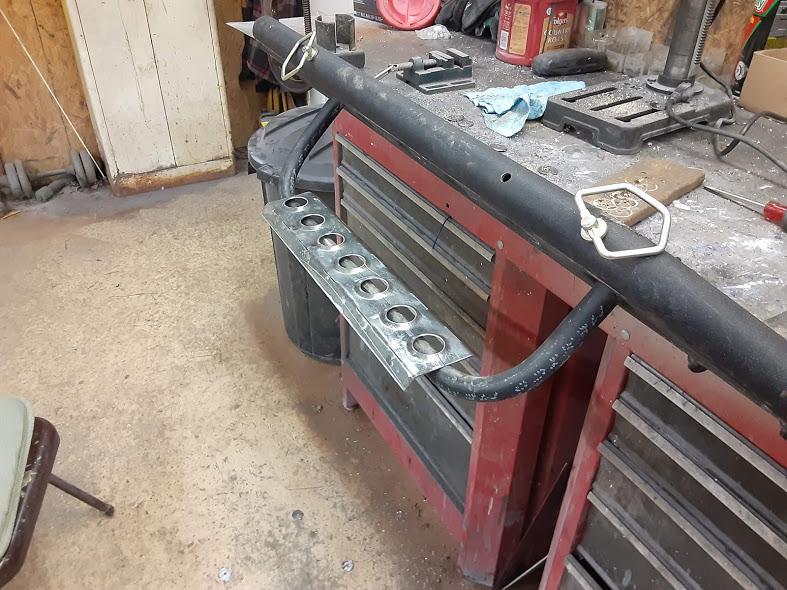

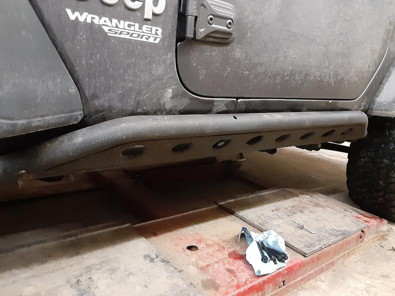

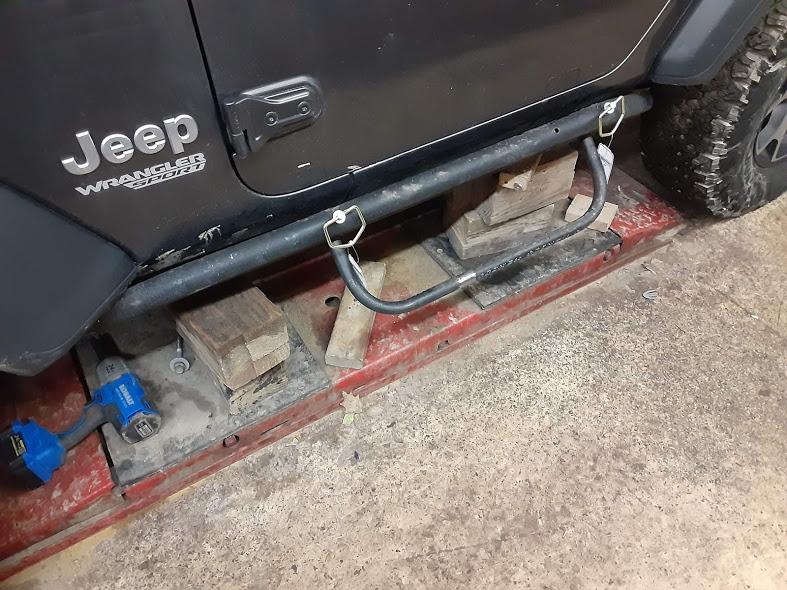

Built a couple of "weekend warrior" removable steps. It's my daily driver and I'll be installing a 2.5" RK X Factor lift and eventually 35's so I wanted some steps but removable so they can be removed for wheelin. Made them out of pipe with a cheap HF pipe bender. I really like how they came out.
