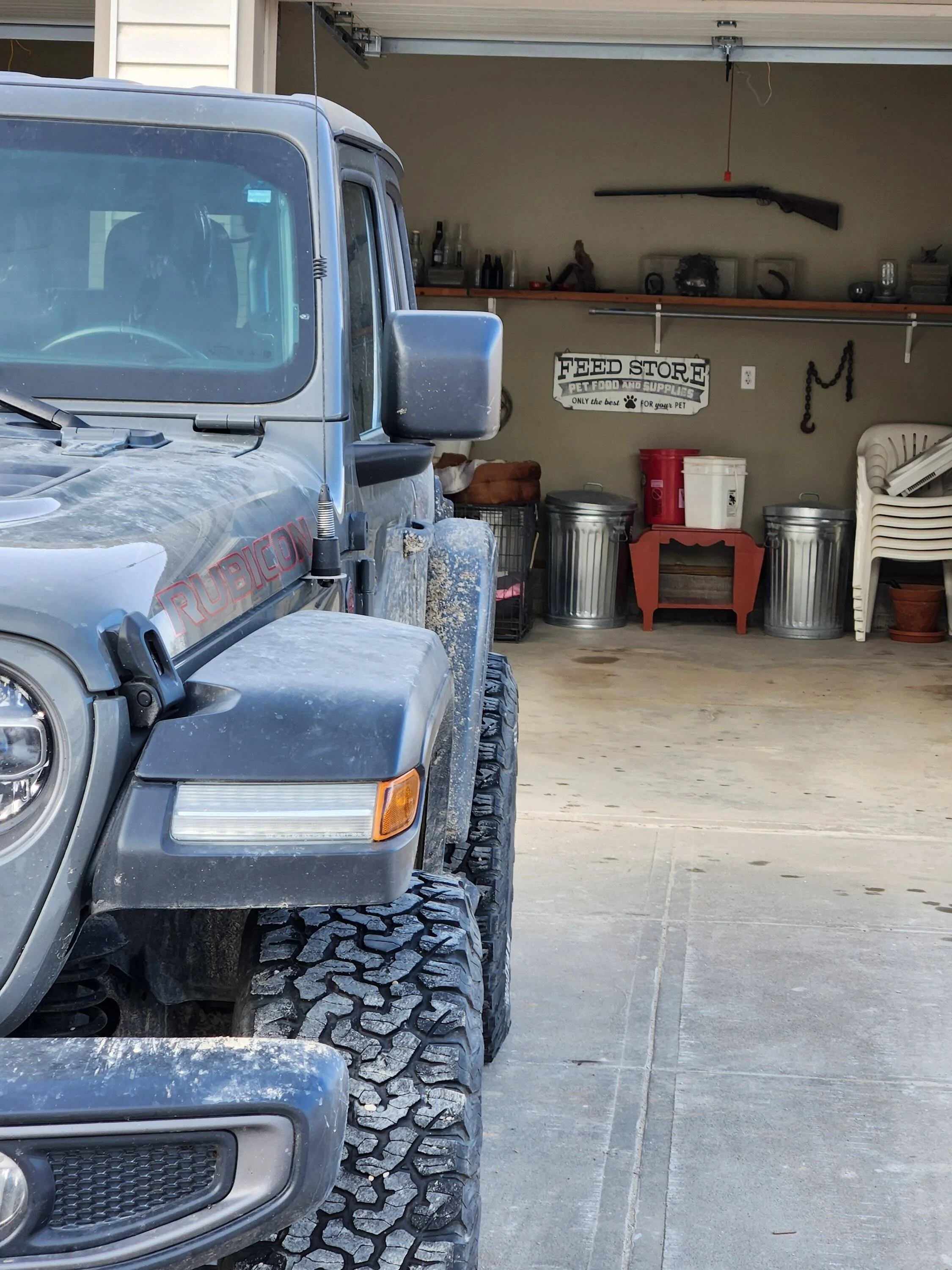

I add 2" wheel spacers because I wanted some poke and a more aggressive stance. I have a 2020 2dr Rubicon and stock rims/tires. I can not justify spending money on rims that would give the same look. I have driven it up to the Black hills and wheeled on a bunch of Forest service roads. Image is after install.

I like the vintage Feed Store sign and rifle hanging in the garage. Are your tires 33's or the XR 35's? Looks good either way. Thanks for showing me what it would look like. Thats helpful.

They are 33's on stock rubicon rims.
