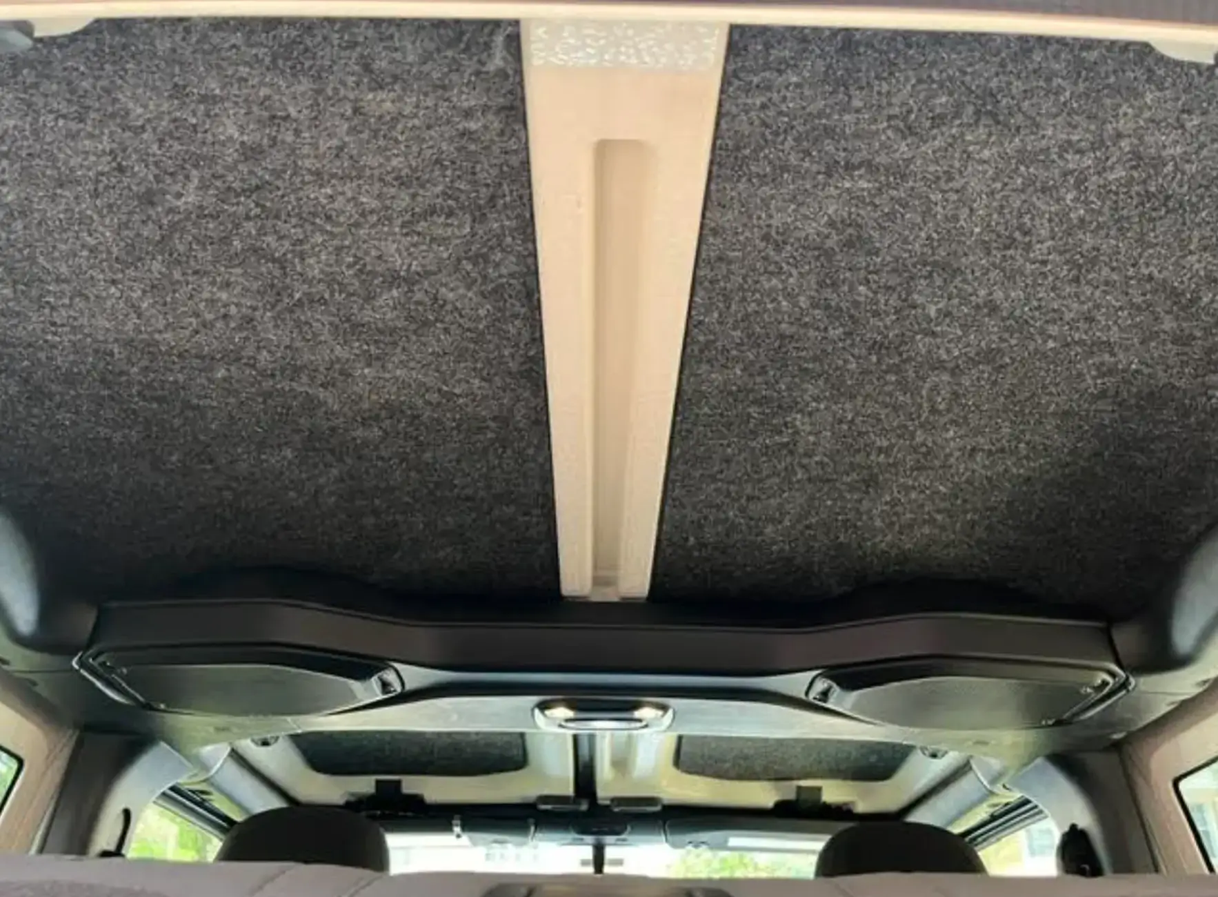

I'm in Florida too...just installed these on my 2-door, Husky Guardian headliner kit. Easy install with high-quality 3M stick. They look fantastic, definitely block some heat, and slightly improve the audio, especially my Fosgate 10" sub. They're $199 at Extreme Terrain, but Quadratec sells them for $169, but out-of-stock. I asked Extreme if they price match, and they did. Quad has a few more pics of them...really nice quality.

Two questions.
Did you have to take the top off to install the panels? Most of the kits I’ve looked at want you to take the top off and turn it upside down.
Do you think it quiets down the interior? I have a 2021 two door Willys hardtop that is my winter Jeep but it squeaks and creeks on bumpy roads. My summer Jeep is a 2022 four door Rubicon soft top that with the top up, I believe to be quieter than the hard top. I’m interested in trying to make the two door quieter.
Blacksport
May 15, 2025
143
180
Ft Lauderdale
'25 Wrangler Sport S, 3.6/manual trans...'23 Corvette C8...'25 Yamaha XMAX
Two questions.
NO, did not take the roof off. Test fit the headliner first. Pull the protective tapes off from the back, leaving maybe a foot still on at the front, letting the tapes hang off the side. When it's position & stuck, gently pull the tapes all the way off. I did remove front roof panels to install the headliners.
With the headliner in place, the Jeep is cooler, and the noise is somewhat reduced, but I doubt it will fix squeaks & rattles. Check all your top bolts, and if you can, check the big bolts underneath that attach the body to the frame...

Received the package yesterday which was ordered and shipped on Friday.
Wiped the inside mounting surface of the hardtop with isopropyl alcohol.
Test fit the rear panels before pealing the tape and inserting the panels at an angle between the soundbar and the hardtop works the best for me.
Pealed back the paper from the 3M tape within 4" of the front end, installed the panels and removed the paper from the tape.
The overall installation time of the panels front and rear along with cleaning the inside hardtop mounting surface with alcohol was approximately and hour.
The panels fit well; I will know more on how well the panels insulate from heat/cool as time goes on.
