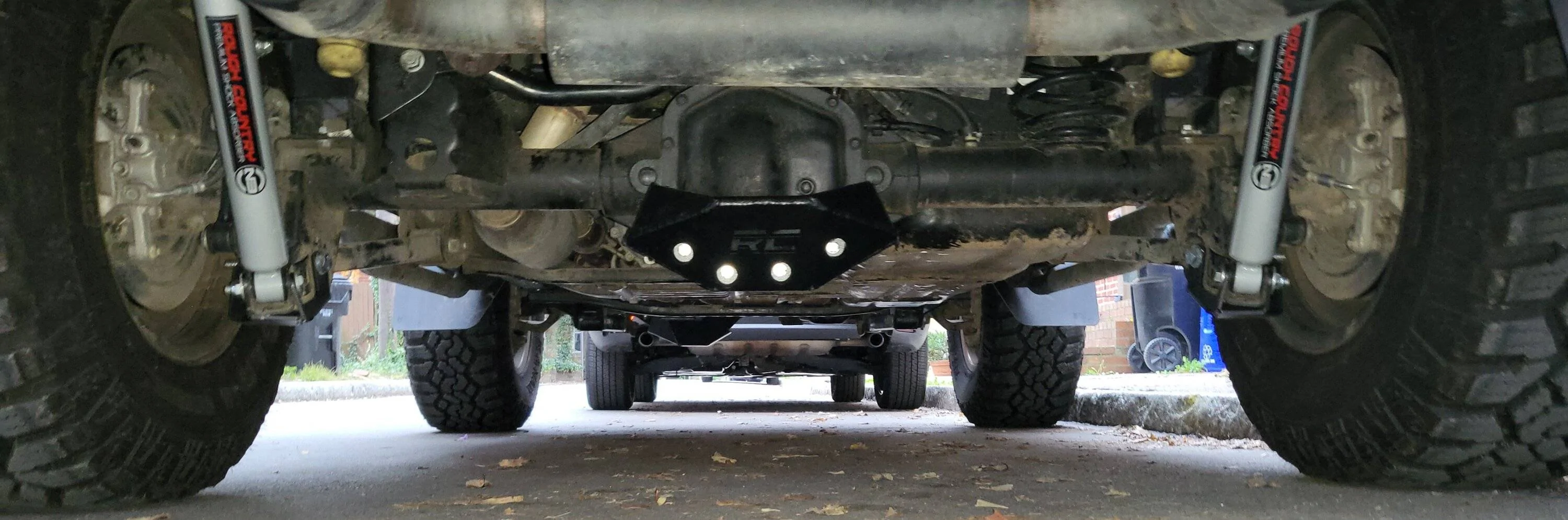

I have a manual 2 door rubi with 4 inch coil lift..., control arm drop, adjustable front and rear track bars, and selector shaft brace.
Wondering if I should get track bar brackets for the axles, drive shafts, adjustable control arms.
Anyone get to this point yet?
No steering issues, ever.
More worried about breaking the driveshafts on the trail

Am I reading right? You added 4" of lift using stock control arms? Idk, but that seems like a lot without adjustable control arms. Curious to know how much the control arm bracket drop is. Have you had your caster checked?
As for drivelines, that depends how much droop you have with your particular set up. I wouldn't be flexing out until you know what your driveline is doing.

At 4 inches of lift I'd do all 8 adjustable arms and trackbar front and rear.
There are other things to consider too like rerouting your ebrake cables under the rear axle. 4" seems excessive for a 35 are you planning to go to a bigger tire?

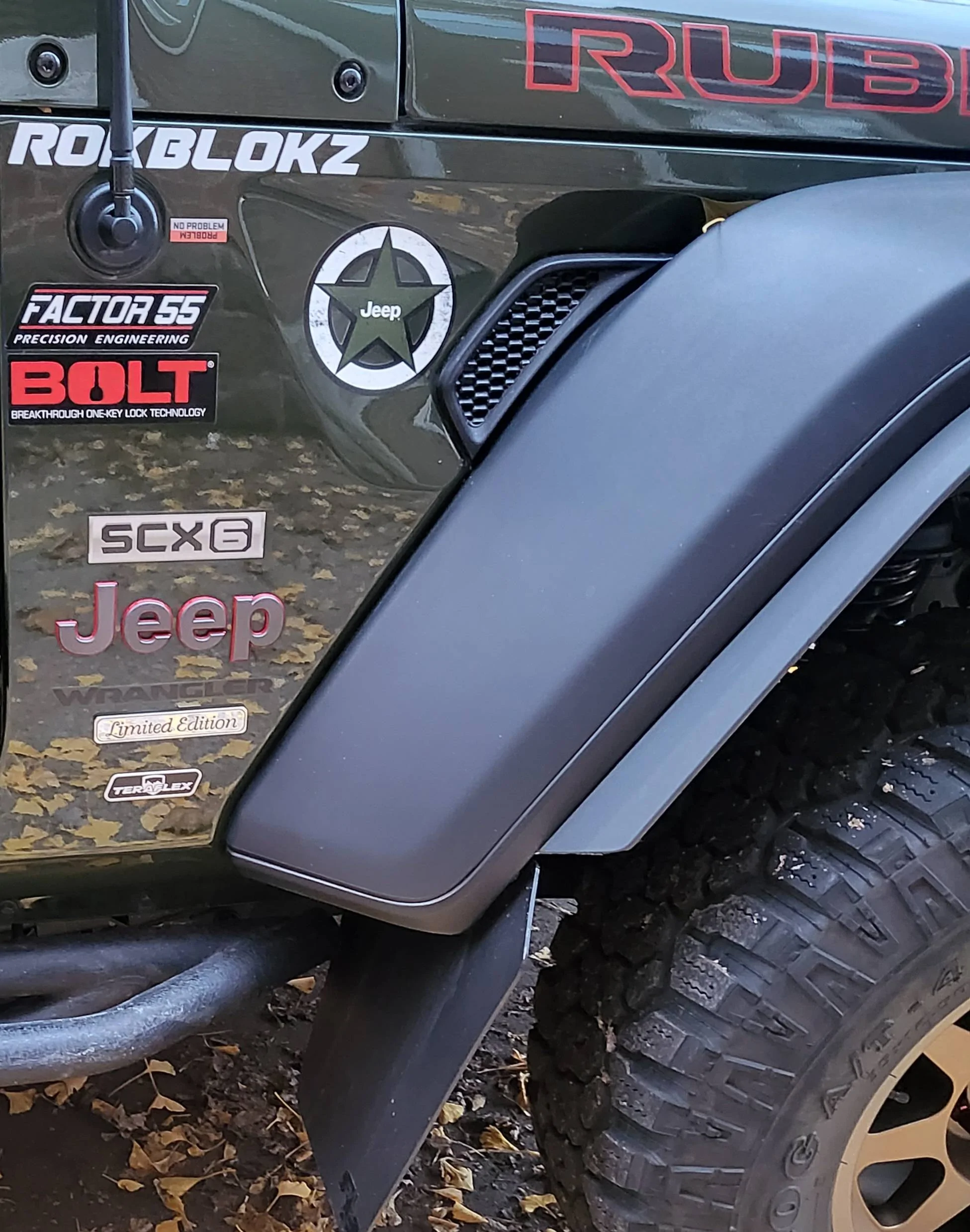

I really am posting to say that your jeep looks really good, never seen mudflaps on a wrangler that I like but those are cool! I also like the lift to tire ratio going on there.

I did it at 2.5" of lift. You just reroute them under the rear cross member. I can't say how much the brackets would give you. When I did the lift I put on a 12.3 travel shock in the rear and it was actually in the lift directions to go ahead and do it.

Adjustable track bars- check
Ebrake cables-check
Front brake line anchors-check
2.5 inch bump stops- check
Teraflex control arm brackets with support brackets-check

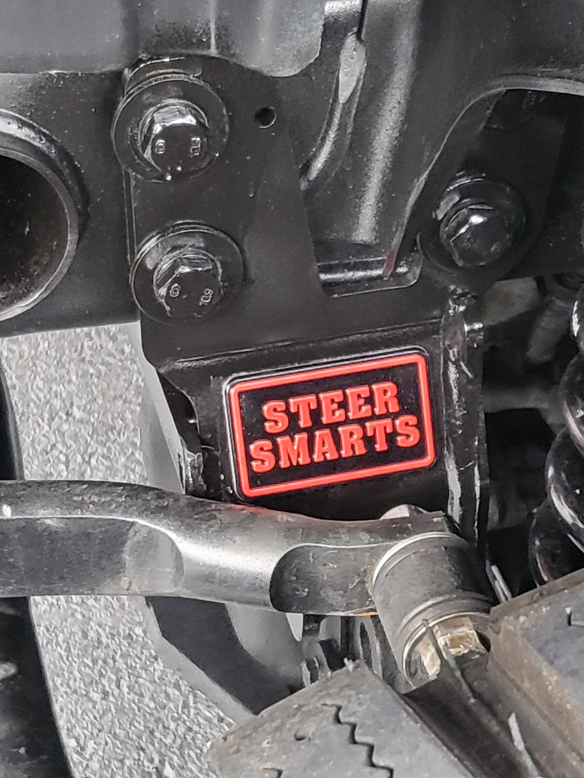

Steersmart selector shaft/ trackbar brace- check
Also skid plates on rear control arm/shock, front and rear differentials.
BTW...the control arm drop and the steering brace is grate

Your driveshafts will work till they don't but at 4" I'd consider it. Pick your fav brand really.
As far as trackbar brackets if you've got adjustables that will get you what you need. If yours steering arms have decent angles and it's steering nice I'd run it.
If you don't have an engine/trans skid I'd consider one if your going to be in the rocks. The trans lines are pretty exposed under there.
I also use that steering brace and their front steering setup. Everything steer smarts makes is solid.

I'll third driveshafts. If you're running shocks that give you the amount of flex one expects from a 4" lift, you're going to want aftermarket front/rear driveshafts. Tom Woods, Adams, JE Reel, your local driveline shop, any of them should be able to build you a decent pair of driveshafts.

What mudflaps are those? Also great looking 2 door.

Already did the ebrake cables, keeping the 35s for now with the stock 410 gears. I'm debating on wich to do first...control arms or drive shafts. Thanks

Don't know why you'd go for adjustable control arms if you already bought and installed drop brackets. Also the engine/trans skid protects your oil pan as well. Drive shafts seem like the first thing I would do on your list.
Is there something your wanting it to do better? Have you had it out wheeling?
