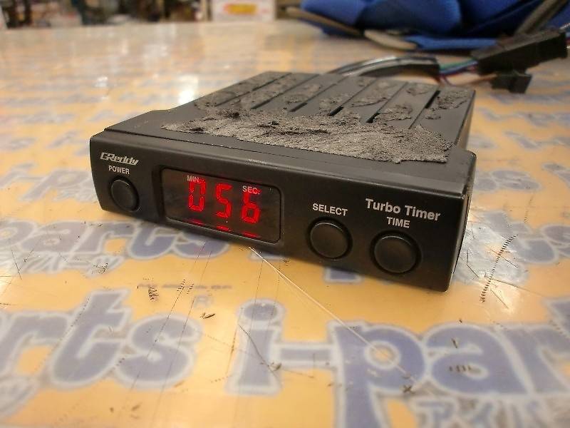

Did you not select the turbo timer option?
Jeep Wrangler JL 2.0 turbo cooling in e-save IMG_6472
