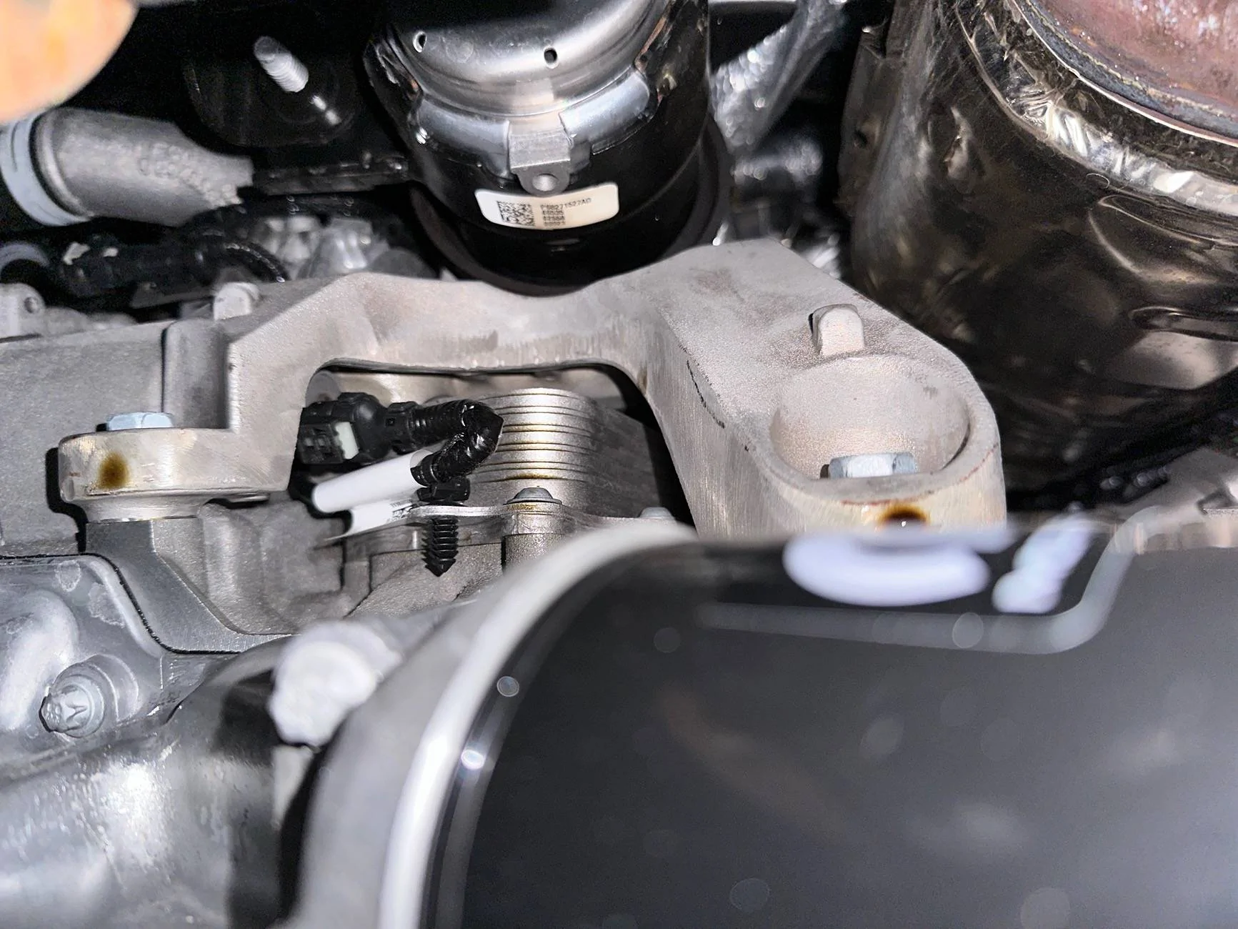

I’ve got a drip coming from the oil cooler. Looks like around the screw there. I tightened it up about 3/4 turn, guess we’ll see….

2024 Jeep Sahara 2.0L
which bolt? the one in the center of the picture on the cooler?
It looks like it’s coming from the small torx bolt on the oil cooler itself the one you can see in the picture in the center.
