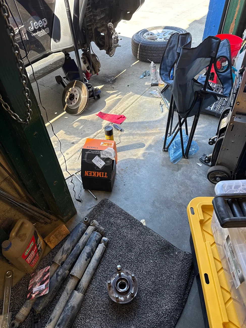

At first it was just replacing what was worn out brakes, wheel bearing, adding “steps” is what she asked for…

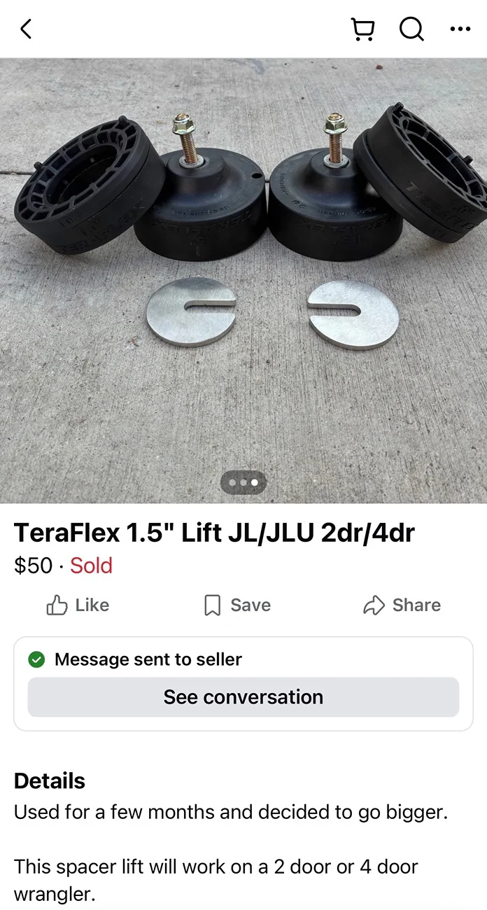

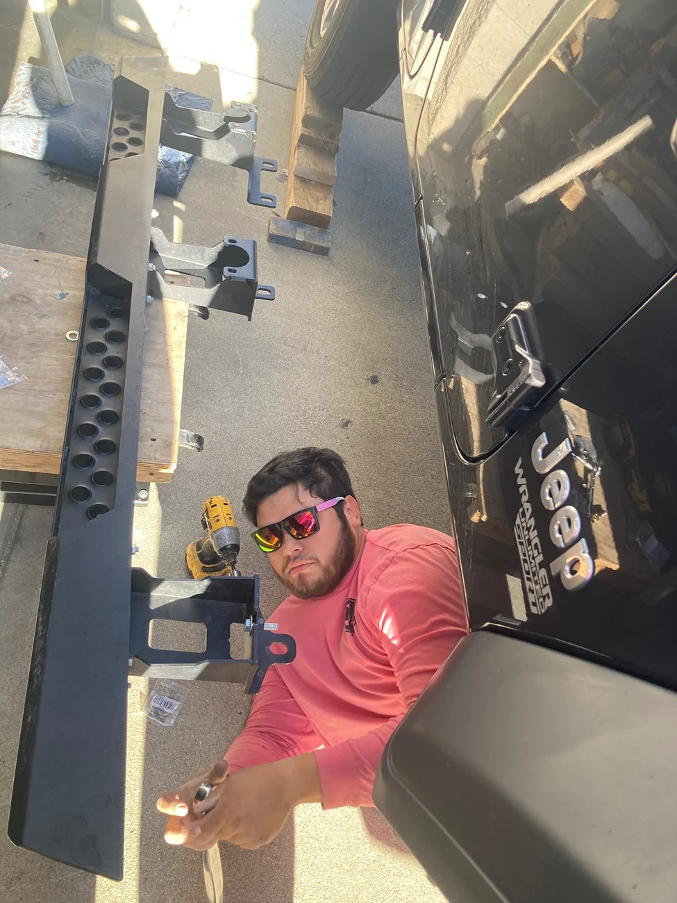

First up was sliders off marketplace. I wanted her to find the limits of the lil sport safely and the bare pinch weld down low felt cheap. Best to cover that up with LOD Destroyers I found on marketplace for $300.

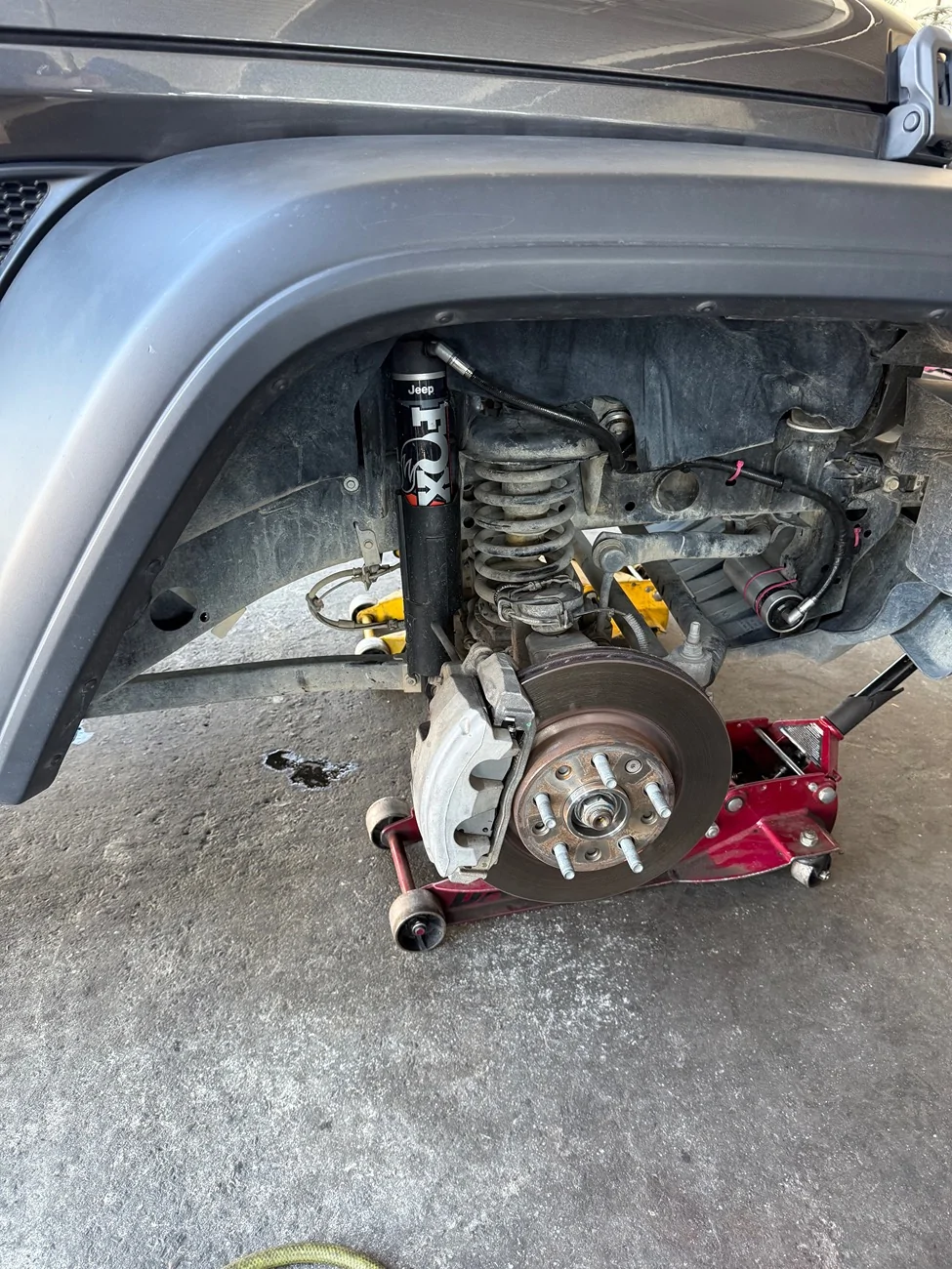

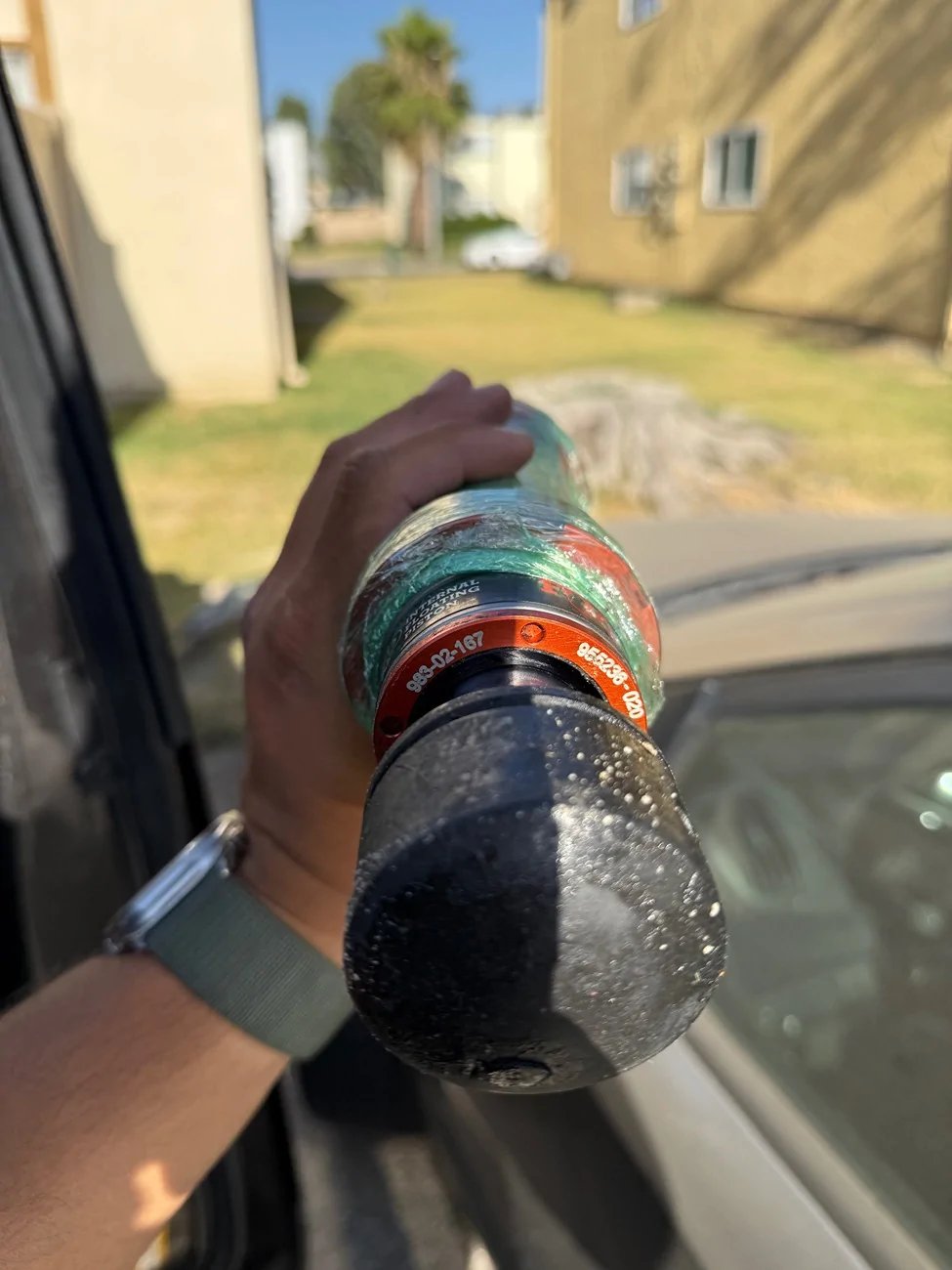

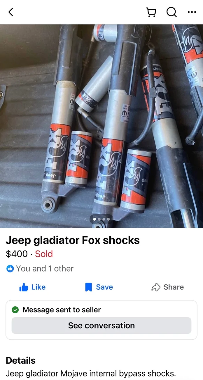

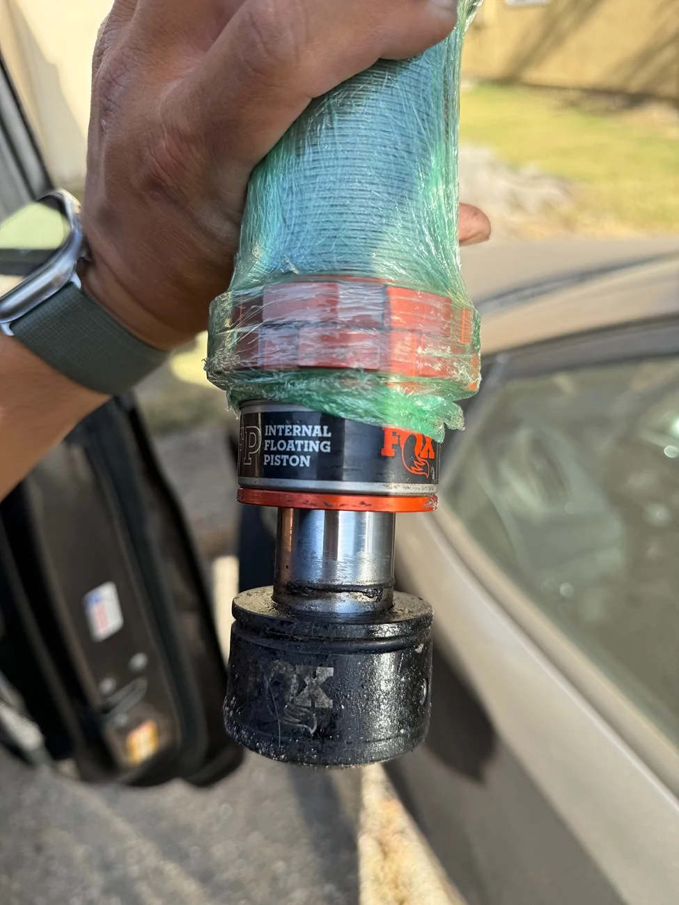

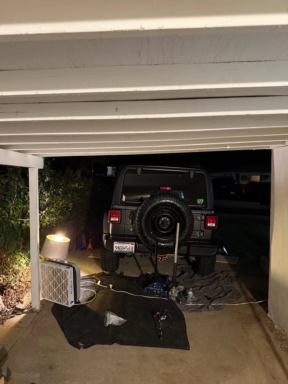

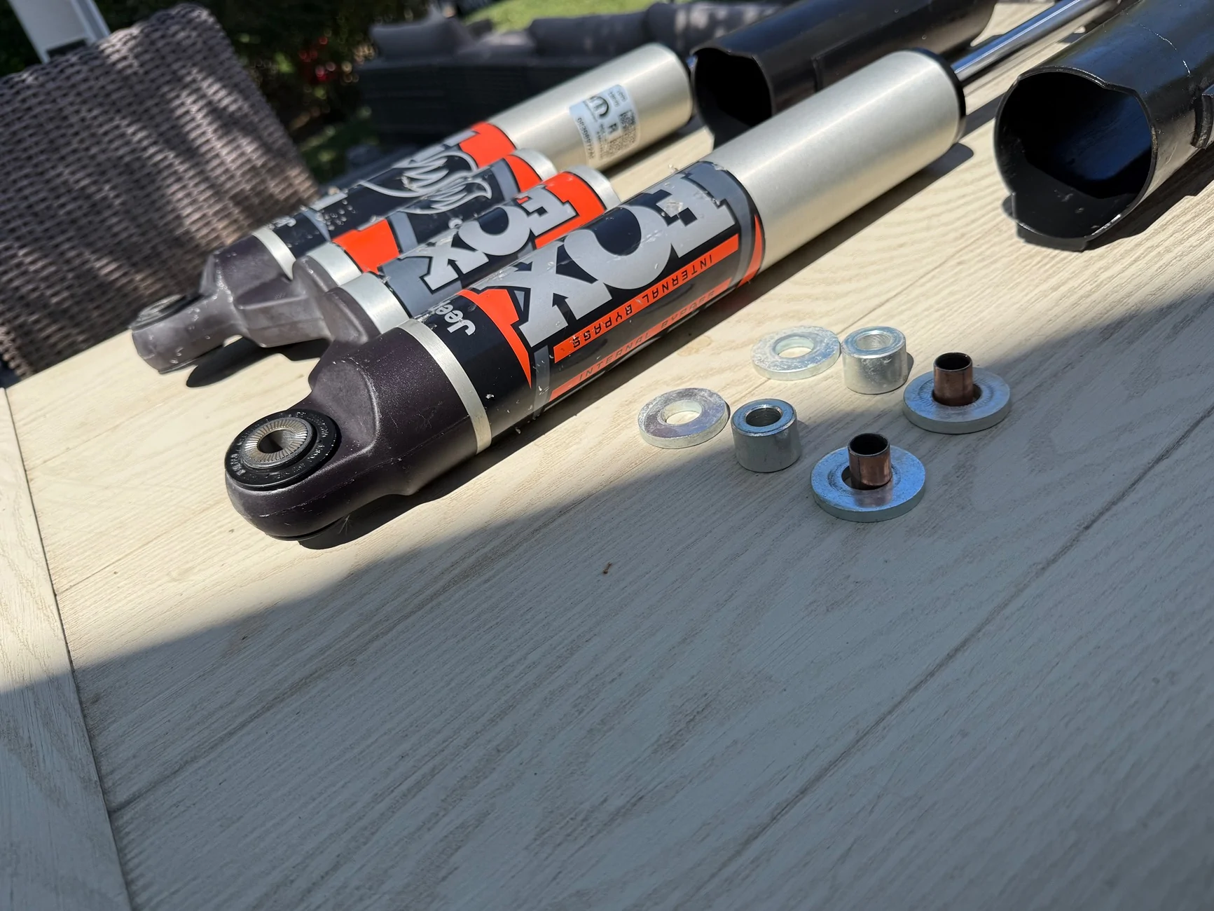

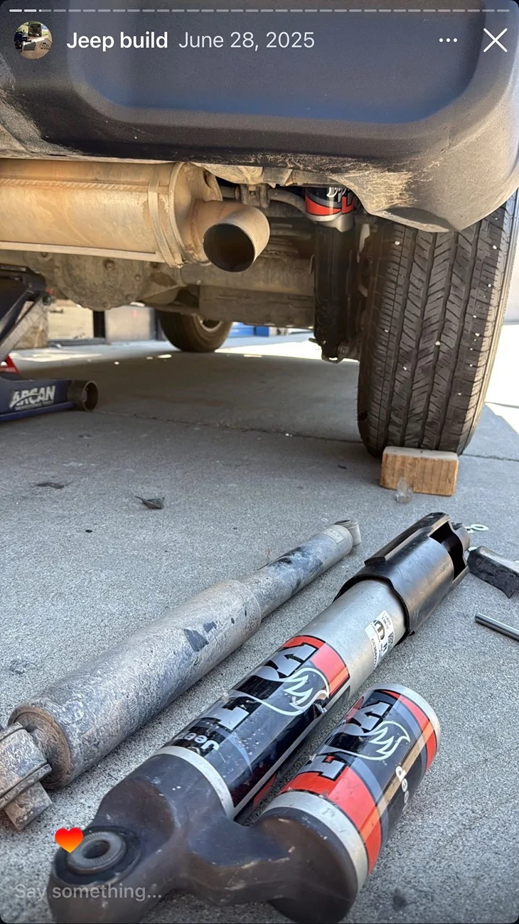

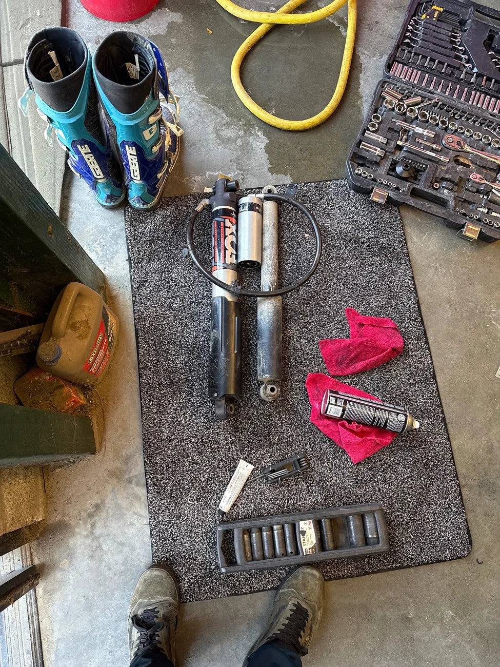

next her stock shocks had reached their due date. I was able to convince her a set of Mojave shocks in Arizona were worth the road trip. We ended up only paying $300 for a set of new take offs. The Mojave shocks had less than a 1000miles on them. The shocks are super easy to get on a wrangler. Just some bronze bushing from Amazon that I found on this forum and some washers in the rear to space them out. We have put over 10,000 miles on this set up beating the ever living snot out of it.
Jeep Wrangler JL Lil Sports guide from Marketplace Mojave to a Raptor hunting journey IMG_3981
Getting the shocks on was super easy thanks to this forum. Also seeing how undervalued and misunderstood they were was also apparent.
Jeep Wrangler JL Lil Sports guide from Marketplace Mojave to a Raptor hunting journey IMG_0982
Getting them to work well was a bit of a process. But our house hold motto is “trust the process”.

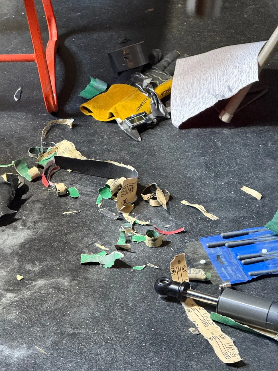

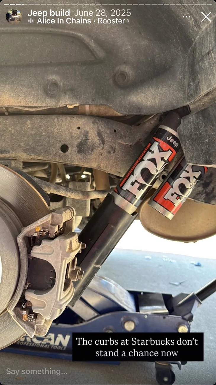

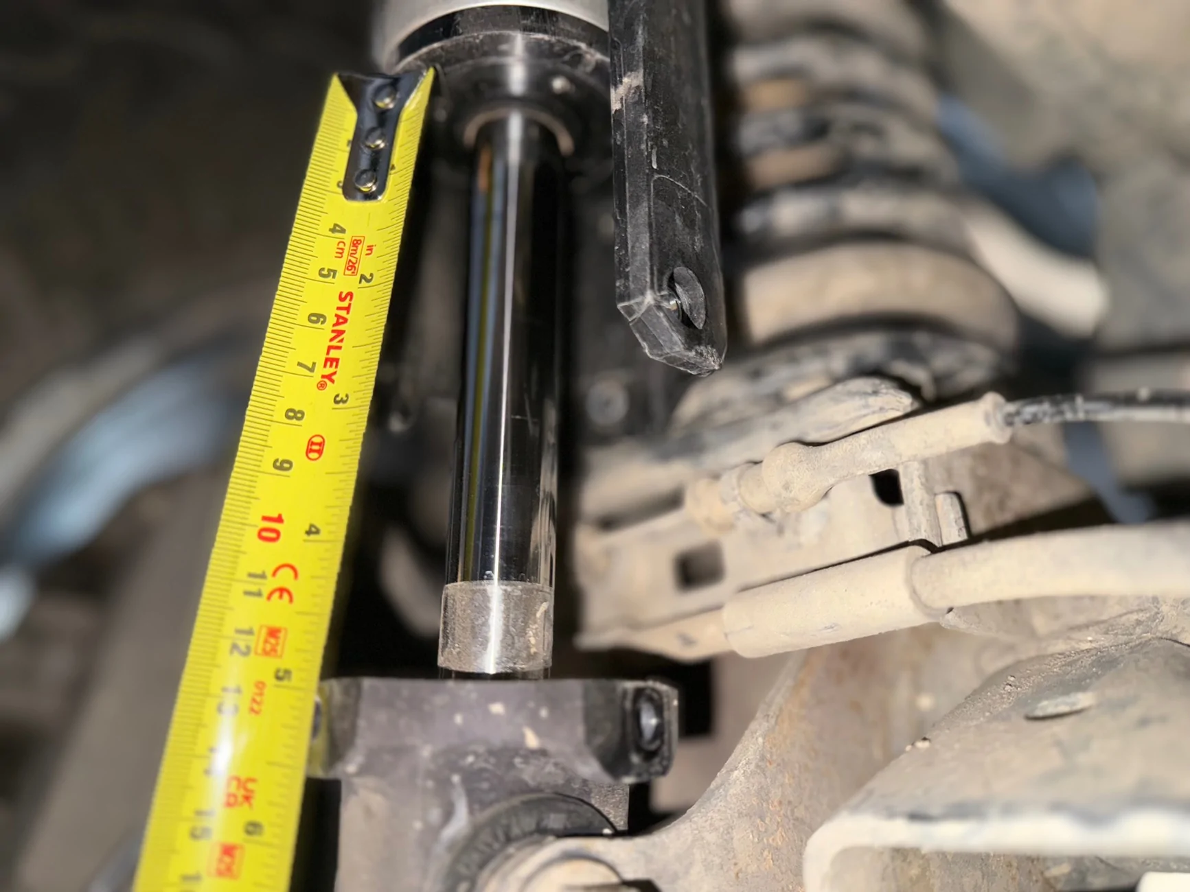

We rode around with the Mojave shock damn near bottomed out for a month while I gathered some more parts. And my wife fell in love with her new go kart. Being in the final bypass stage left us with a race car. Zero roll through any corner or on ramp. From that point on we decided to keep her new charming driving dynamics.
Jeep Wrangler JL Lil Sports guide from Marketplace Mojave to a Raptor hunting journey IMG_1726
Jeep Wrangler JL Lil Sports guide from Marketplace Mojave to a Raptor hunting journey IMG_1727

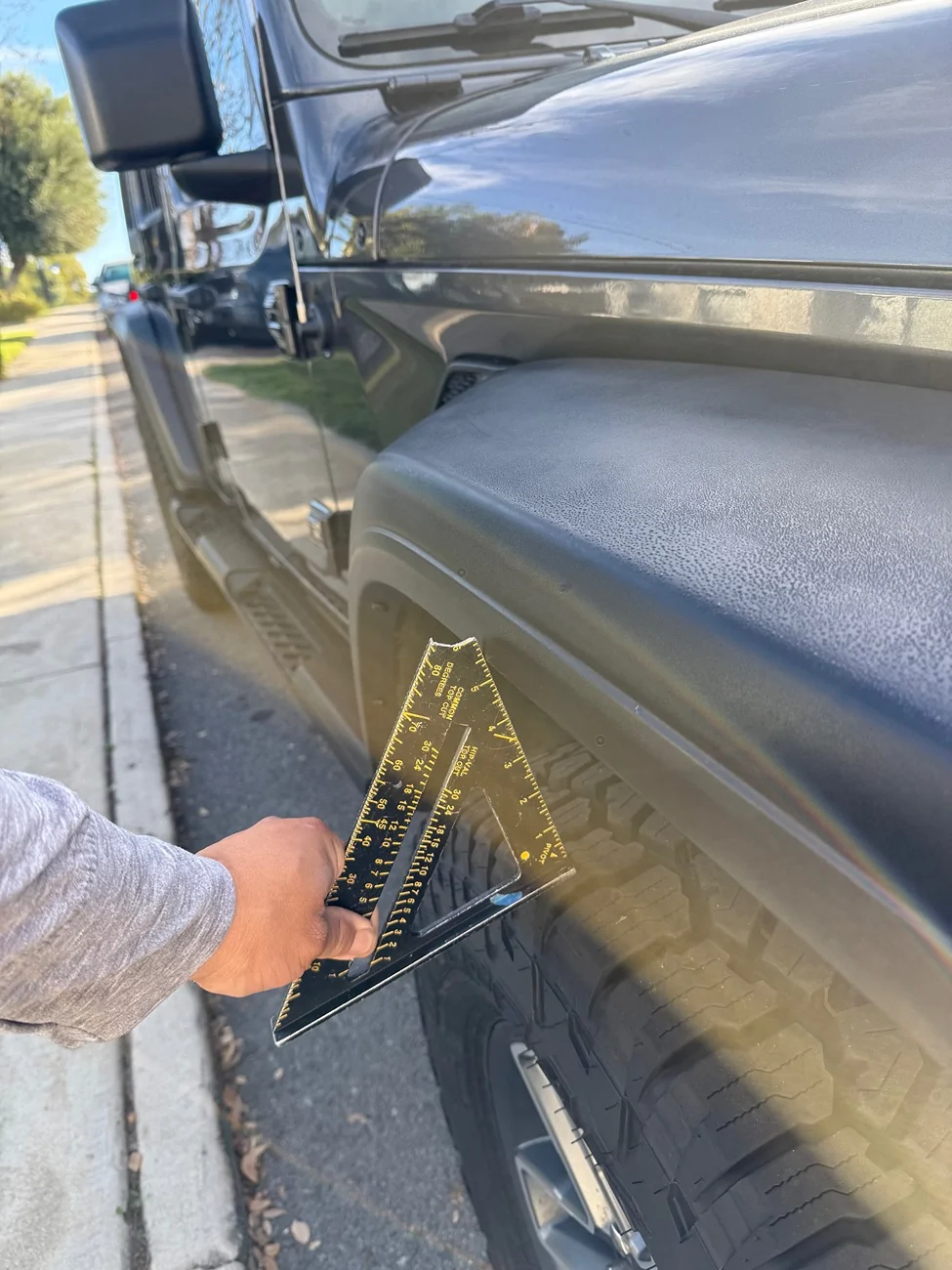

I decided Mojave shocks needed Mojave wheels. With our narrow sport axles the offset was a major part of that choice. I managed to snag a set with no miles and the nubs still on them for $1000. My wife was in flight and expecting me to pick her up from San Diego airport. The seller was kind enough to meet me at a parking lot near the airport and we swapped all the tires on there while my wife was taxiing down the run way. They were so pumped on the idea of our build the father son duo actually pitched in on the swap and also kicked a few shekels off their asking price.

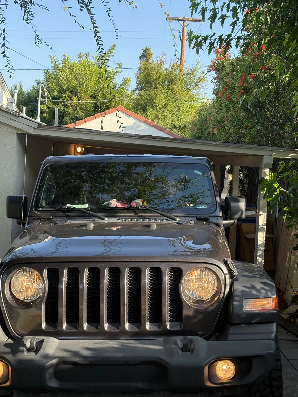

Our old and low carport is both a godsend and a pain. We’re constantly questioning if the next mod will put us over our height limit

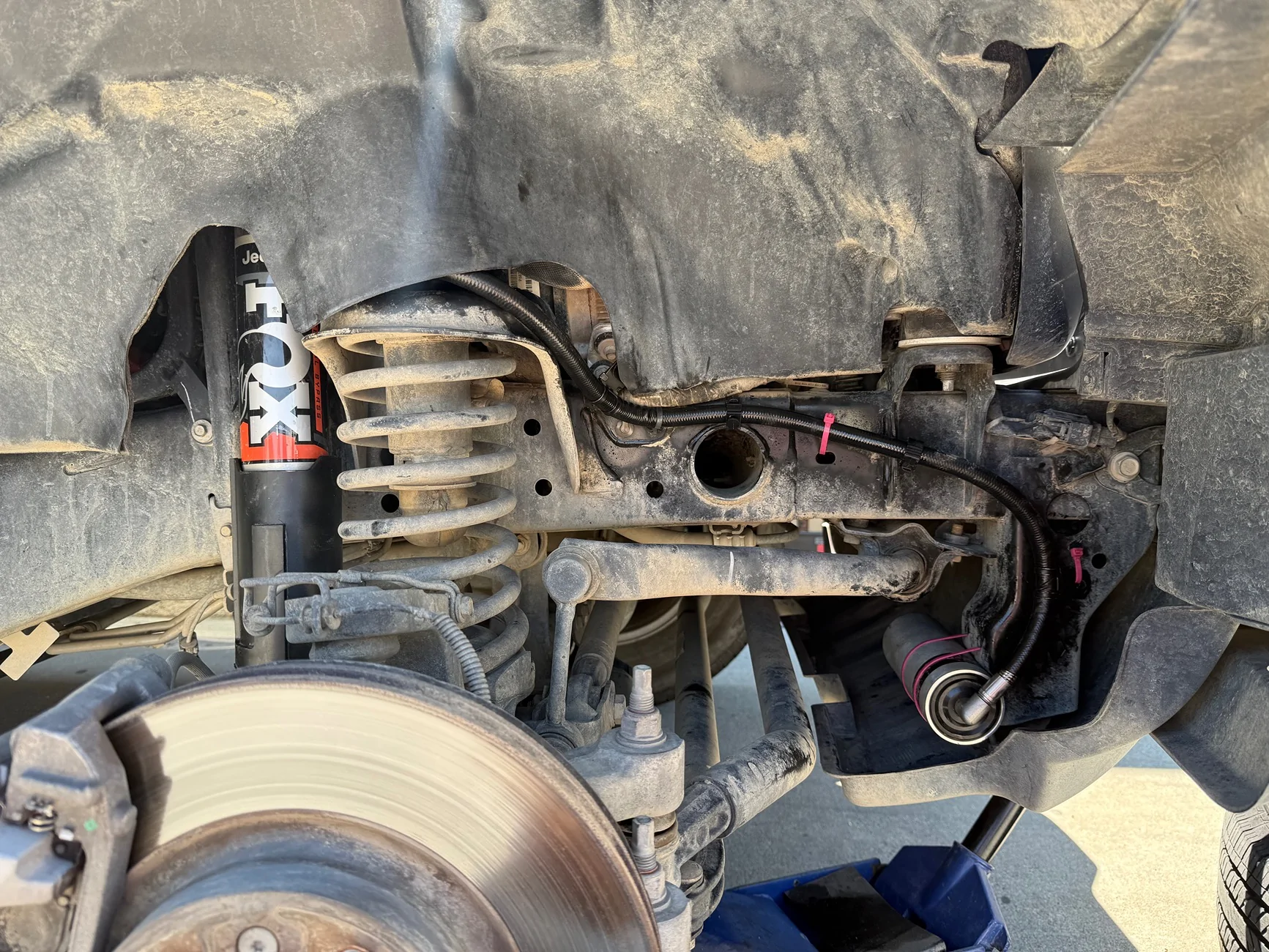

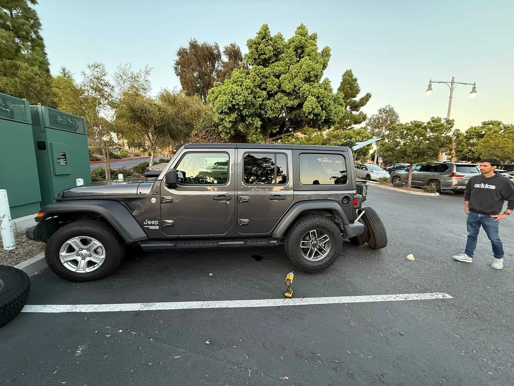

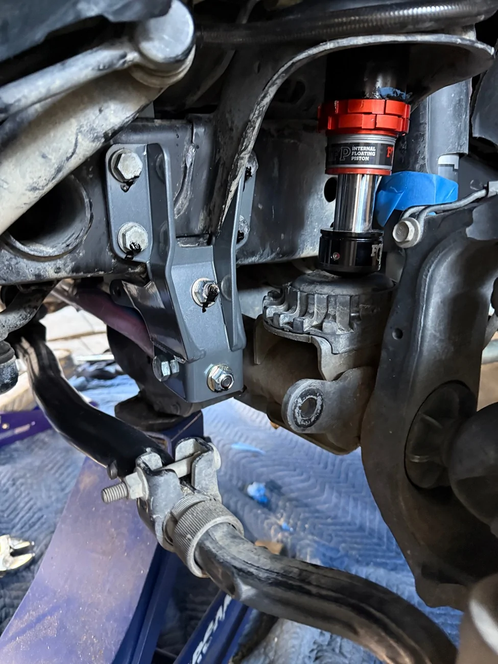

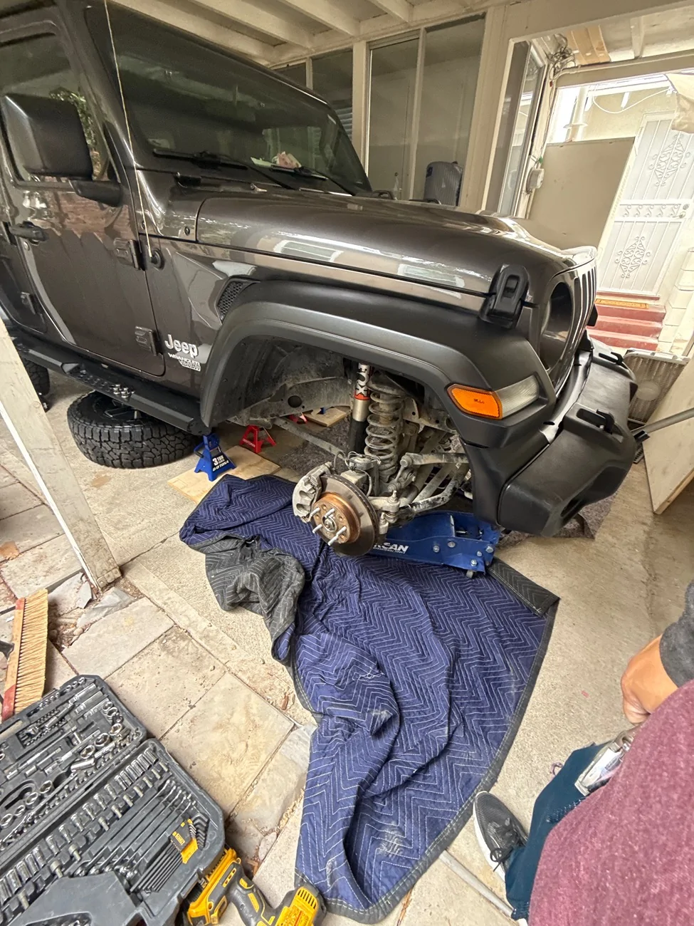

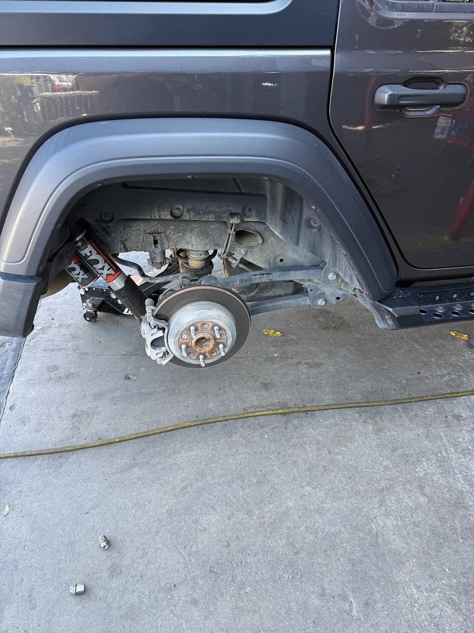

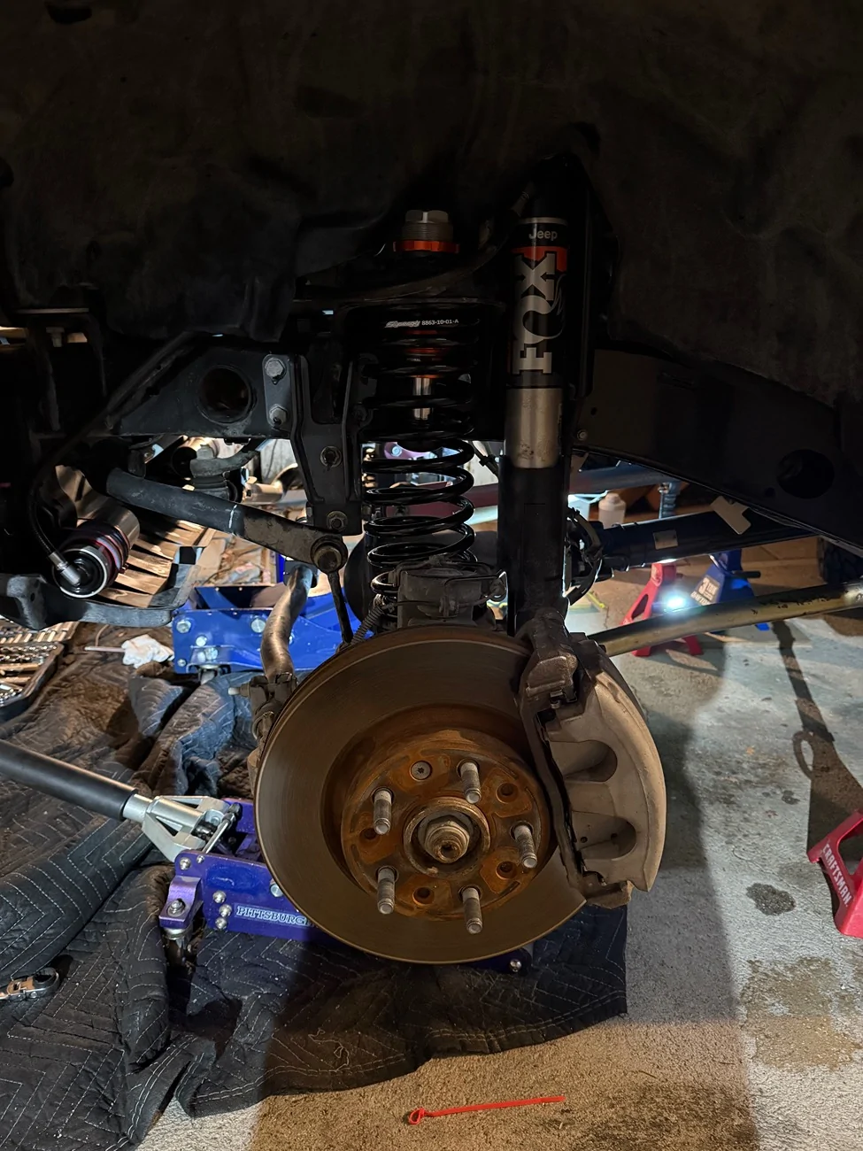

I wanted to check stance and get an idea of what ride height those Mojave shocks would start to work best at. So a teraflex spacer lift for $50 and a favor from my cousin in La to grab them for me saved the day.
Jeep Wrangler JL Lil Sports guide from Marketplace Mojave to a Raptor hunting journey IMG_3990
Granted getting them under the jeep took the better half of a day figuring out how all that went together. The spacers were for an 1.5in lift which put us just above the bump zone on our new massive shocks.
Jeep Wrangler JL Lil Sports guide from Marketplace Mojave to a Raptor hunting journey IMG_1921
The rear took twice as long as the front
Jeep Wrangler JL Lil Sports guide from Marketplace Mojave to a Raptor hunting journey IMG_1922
for a sport car setting this worked really well

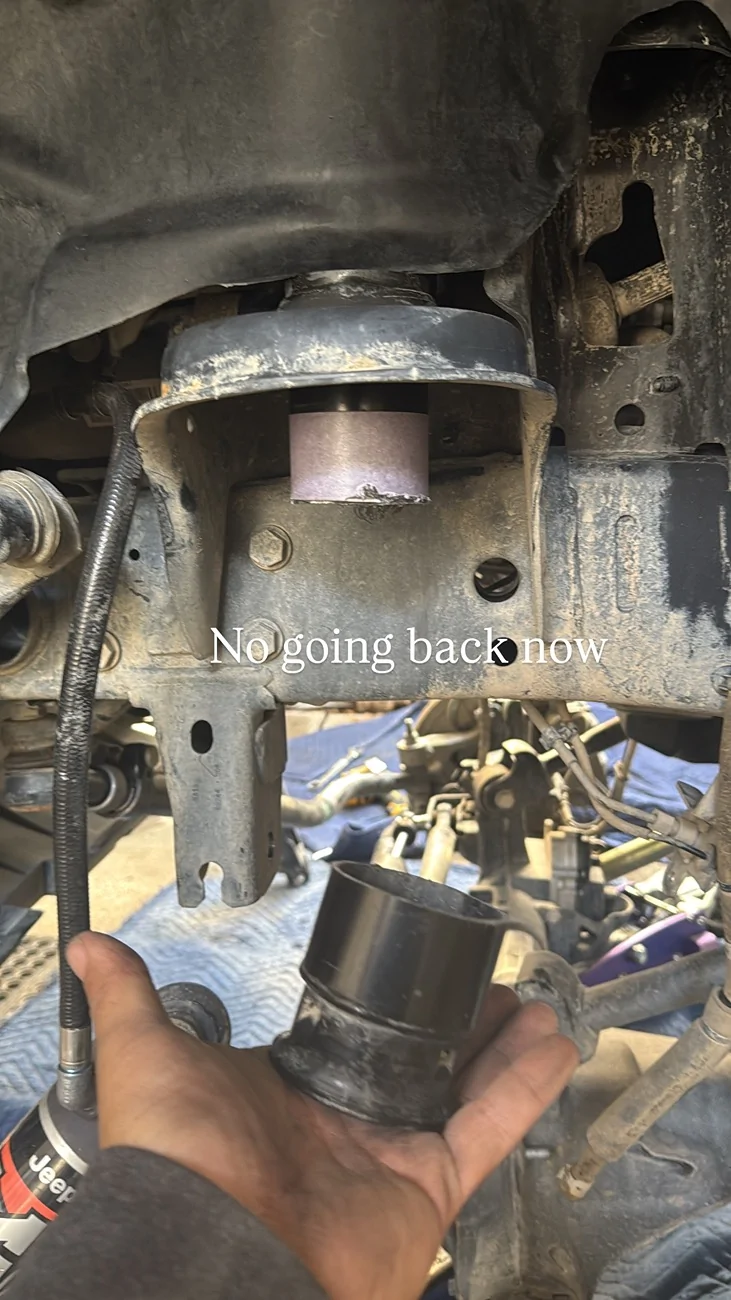

Cutting off the brake line bracket was terrifying at first.
Jeep Wrangler JL Lil Sports guide from Marketplace Mojave to a Raptor hunting journey IMG_1931
After lifting the jeep it got a tad twitchy and I wasn’t stoked on that new trait, so back to my market place archives I went and found some arms I had been eyeing for a few months.

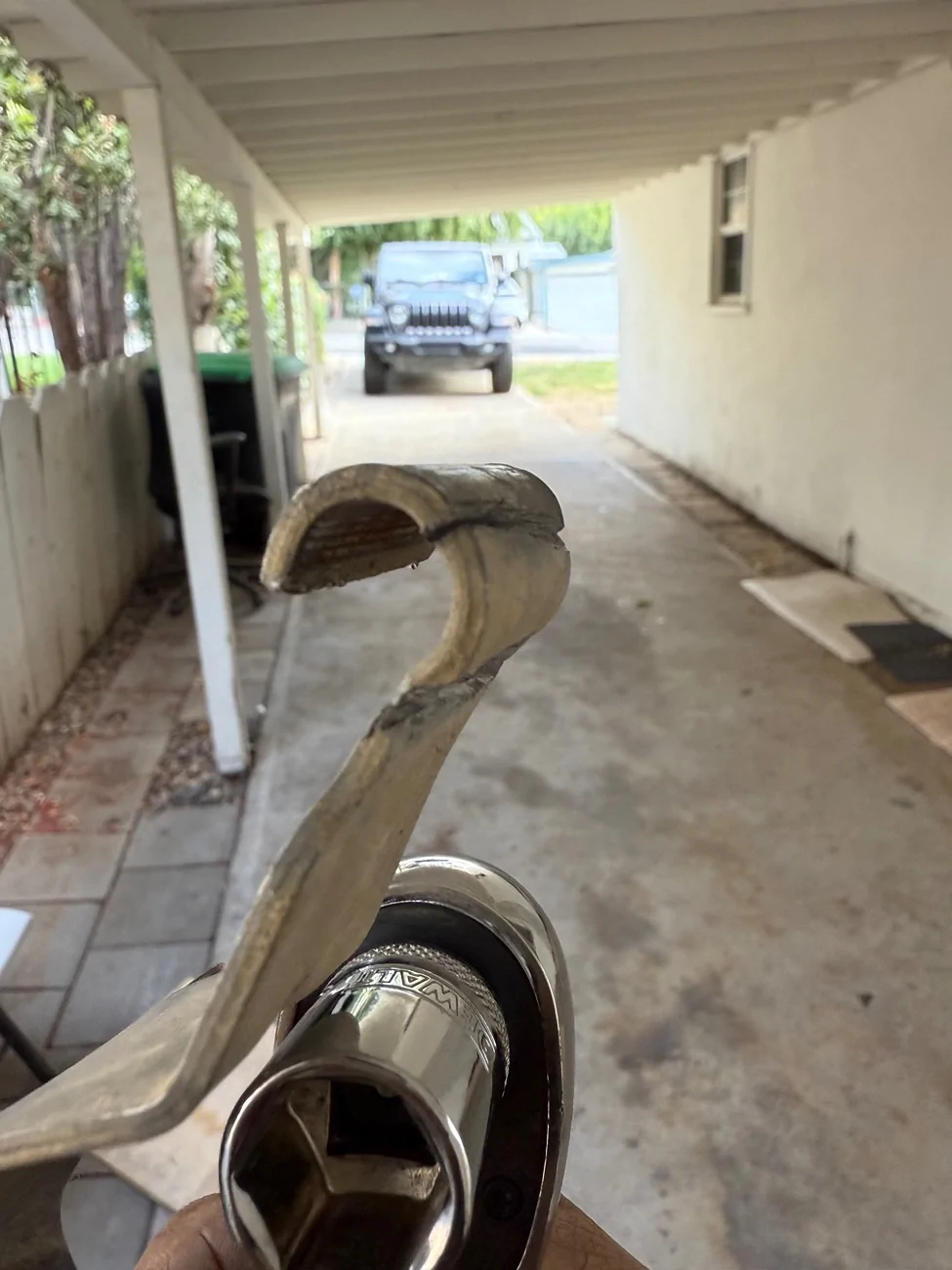

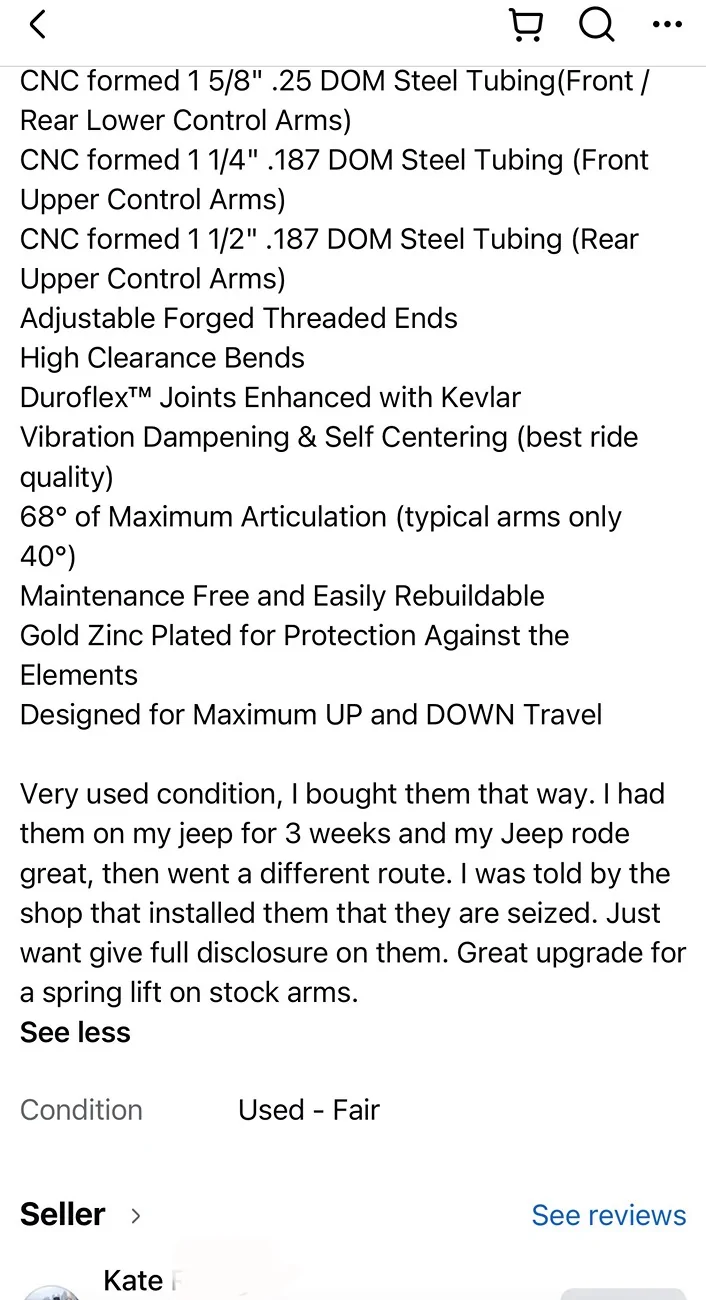

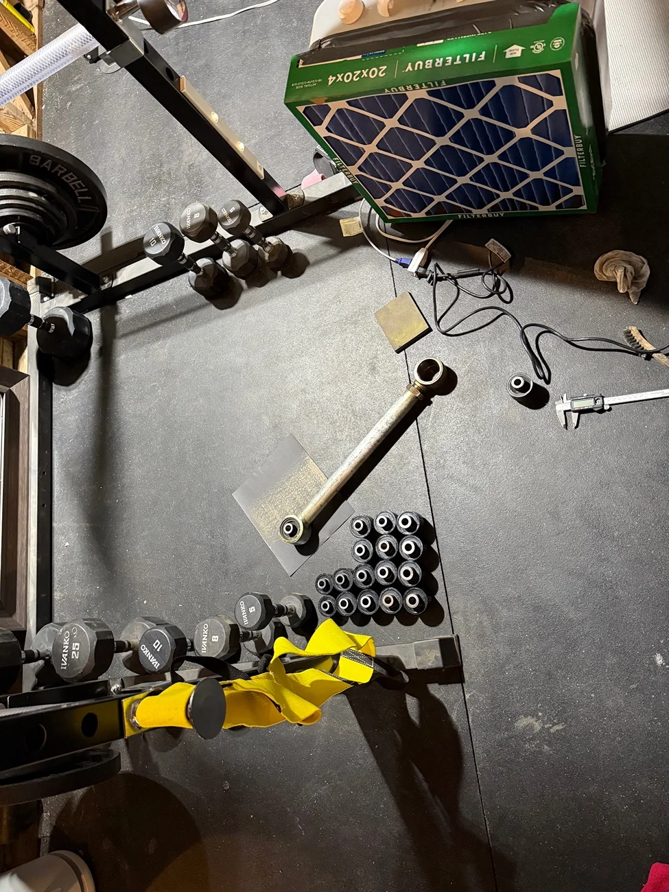

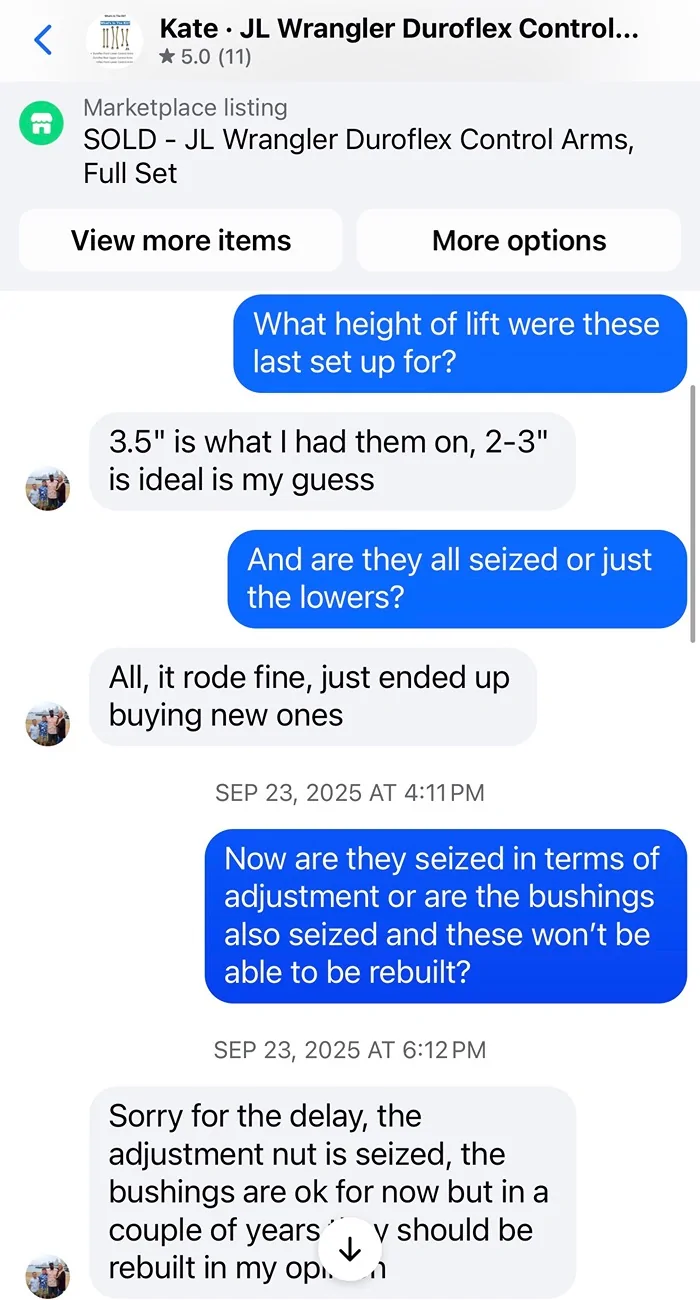

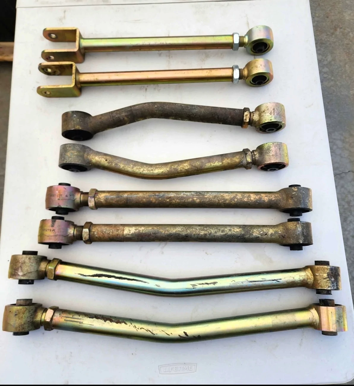

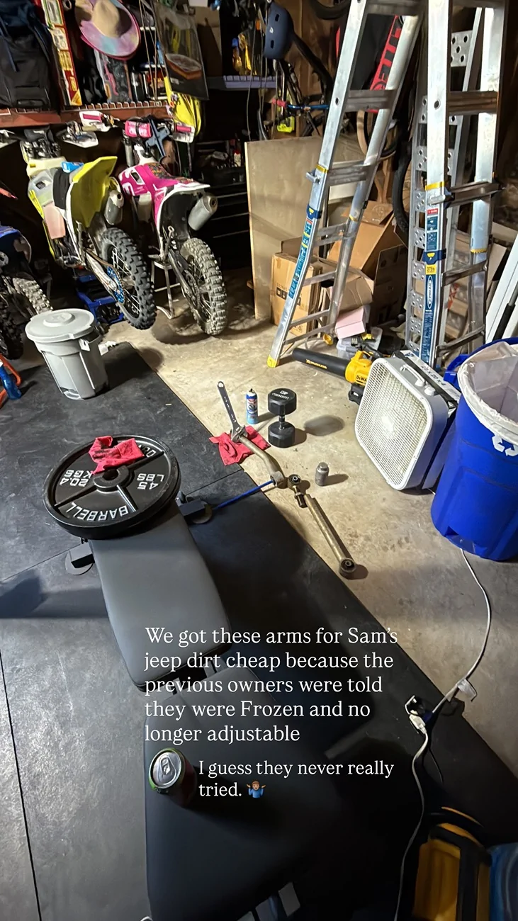

I found some metalcloak arms that were listed as fully seized non-adjustable and needing a rebuild. They were about 200miles away but by sheer luck of months of low balling the seller, they drove the arm up to us for the low low price of 400$. If there seems to be a theme with the price you’re seeing my wife’s budgeting at work, and our deal was I could spend whatever I wanted as long as it was all money made off selling things on facebook marketplace or here
Jeep Wrangler JL Lil Sports guide from Marketplace Mojave to a Raptor hunting journey IMG_3986
Jeep Wrangler JL Lil Sports guide from Marketplace Mojave to a Raptor hunting journey 6AA646A5-7592-45EB-AAEA-2A7EF52EE0A3
Jeep Wrangler JL Lil Sports guide from Marketplace Mojave to a Raptor hunting journey IMG_2173
Jeep Wrangler JL Lil Sports guide from Marketplace Mojave to a Raptor hunting journey IMG_2282

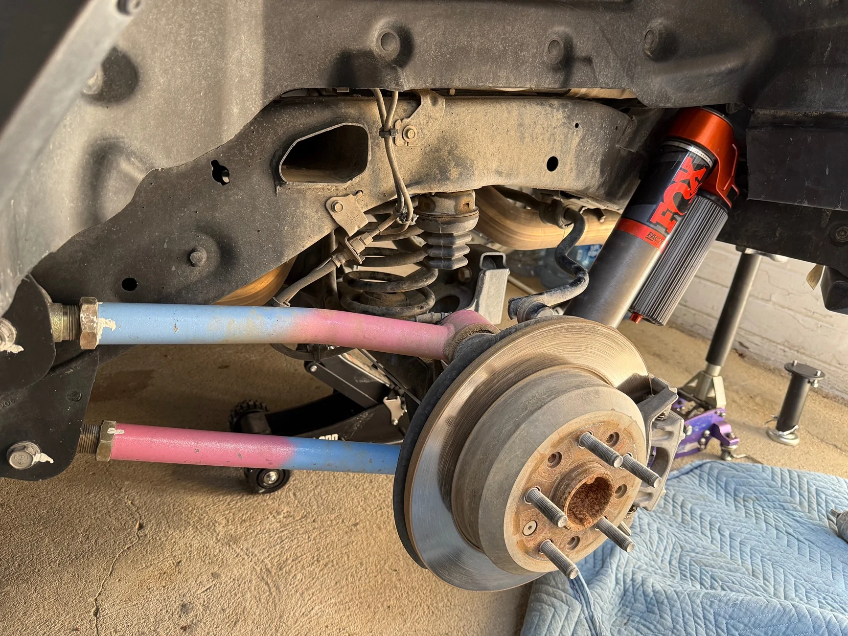

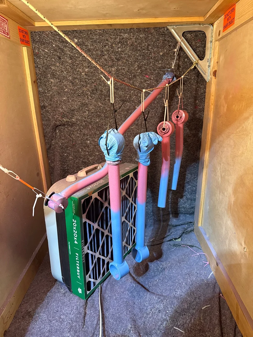

While we didn’t mind the gold, given the chance I figured it best to add some personal touches while we had them off the jeep.
Jeep Wrangler JL Lil Sports guide from Marketplace Mojave to a Raptor hunting journey IMG_2288
Please if you put your own metalcloak arms together yourself. Add some anti seize, I know everyone chirps about never needing to adjust your arms down the road but. You never know what kind of deals you might run into down the road that might make you want to change your setup. More on that down the road
Jeep Wrangler JL Lil Sports guide from Marketplace Mojave to a Raptor hunting journey IMG_2319
Un-pro tip with setting up metalcloaks arm. Don’t use their measurements when hacking together misfit parts. I used teraflex and evos numbers and our ride quality increased exponentially. We put each set on two at a time to get a feel for how the jeep drove with each addition. Plus it made the whole process seem less daunting. I just swapped them when I finally had time after work but only 20-30mins of work each time. But for about a month we drove around with just the front lower arms while I contemplated what exactly I should set the jeep up at considering I’ve gone off the deep end with my Frankenstein lift

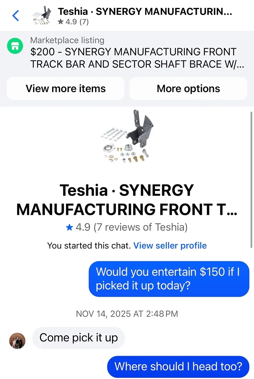

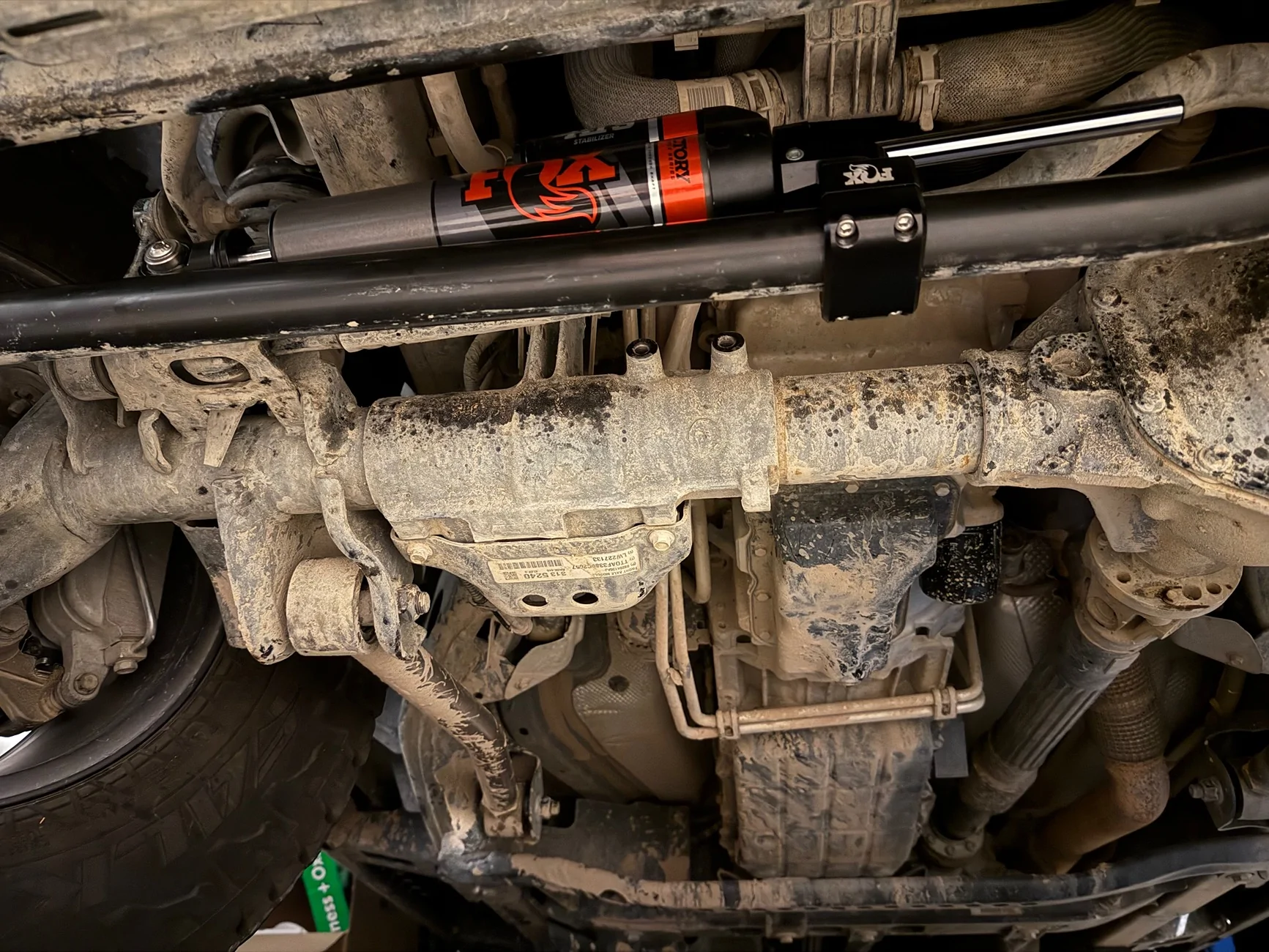

I found a synergy steering brace brand new for $150, when I went to pick it up the seller had a garage full of random parts, he worked at a dealership that returned most the jeeps back to stock before sending them to auction. He offered me a metalcloak track bar for $20 and I scurried home with my new haul that was starting to slight creep up in budget.
Jeep Wrangler JL Lil Sports guide from Marketplace Mojave to a Raptor hunting journey IMG_3993
Jeep Wrangler JL Lil Sports guide from Marketplace Mojave to a Raptor hunting journey IMG_2362
Jeep Wrangler JL Lil Sports guide from Marketplace Mojave to a Raptor hunting journey IMG_2360

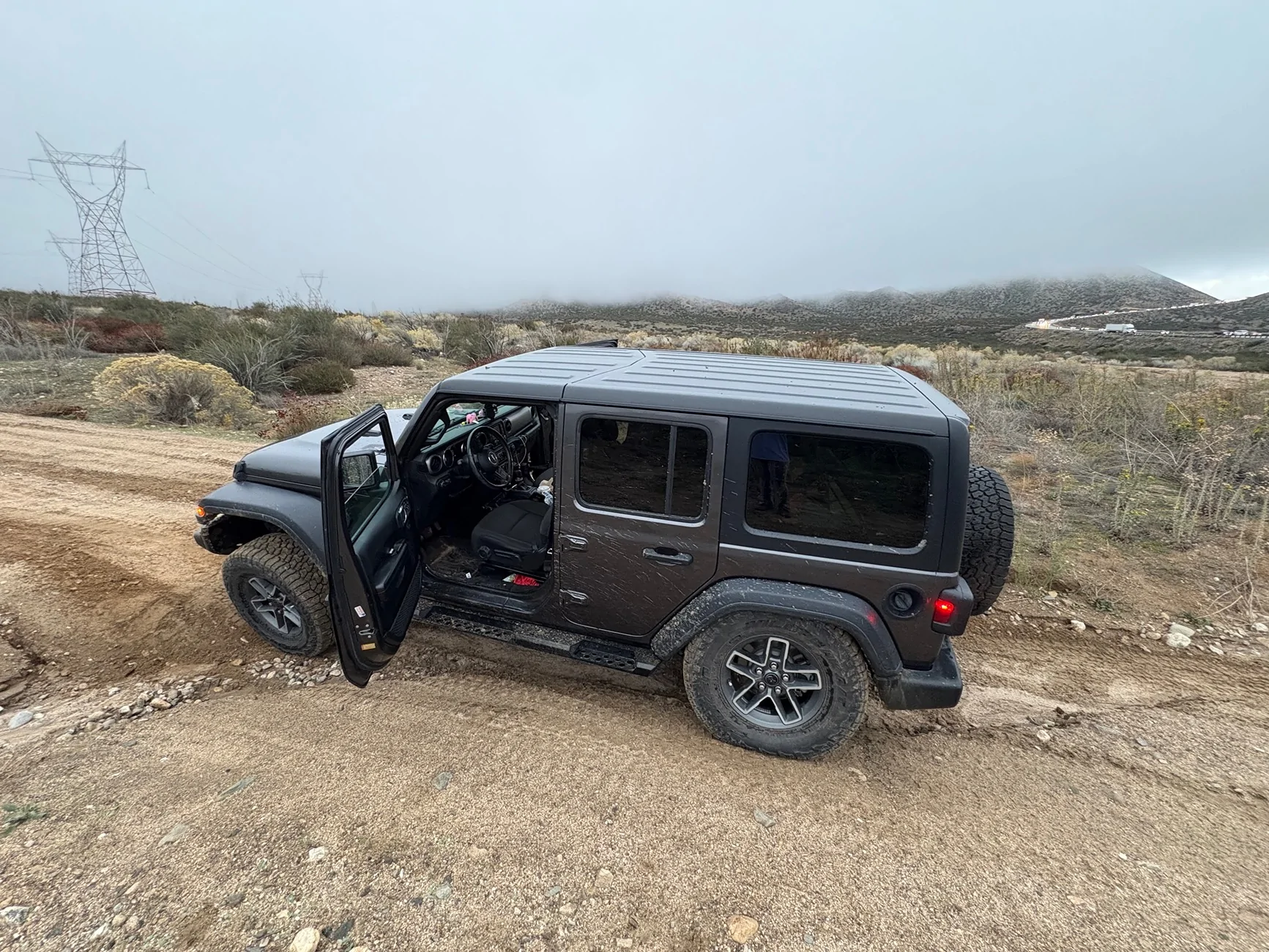

Confident after testing the jeep in our local whoop section and trails not far from our house. we really started to beat on this little jeep. But we were adding parts slowly to see how each new addition changed the feel.
with a spacer lift, Mojave shocks, bumps, steering brace, metal cloak track bar, and lower front arms to start we went razor chasing.

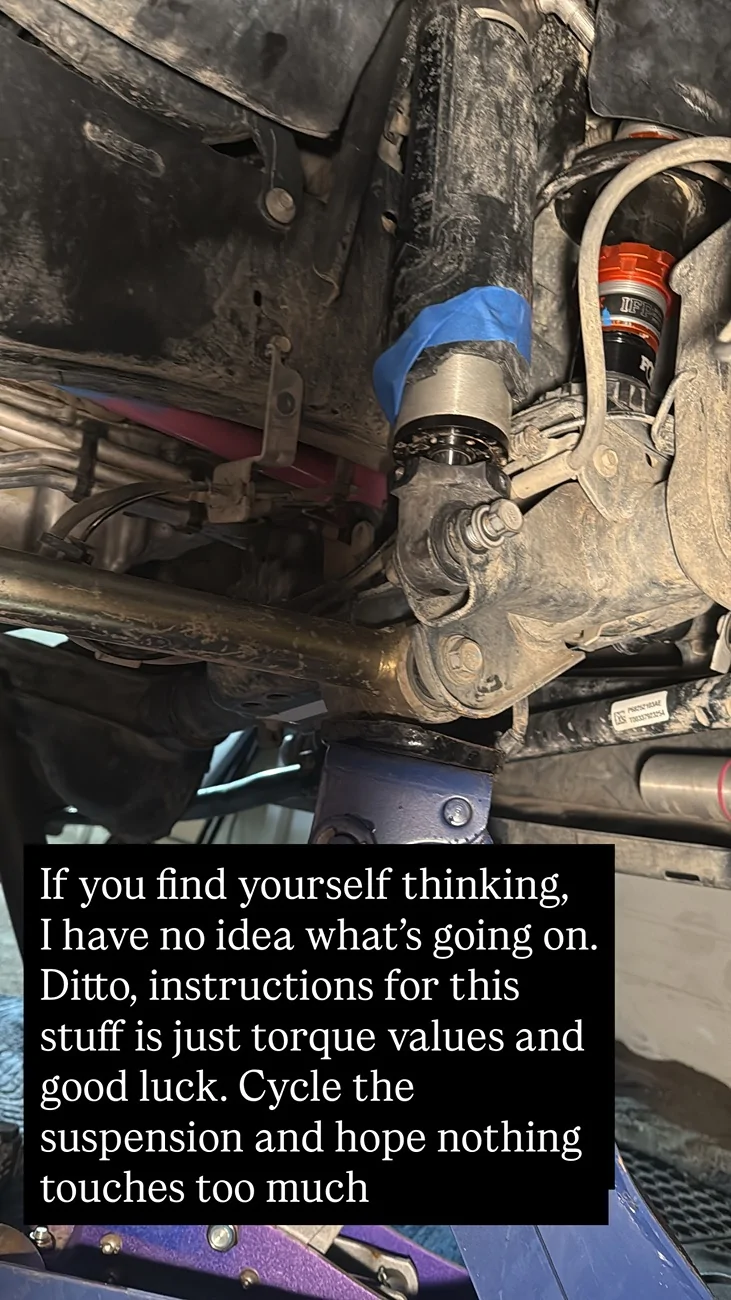

Adding the rear arms allowed us to cycle the suspension without rubbing the fenders. I pushed the axle back slightly and was immediately impressed by how it freed up the rear end. Felt like we dropped tire pressure by 5-8psi. A much smoother more plush ride.

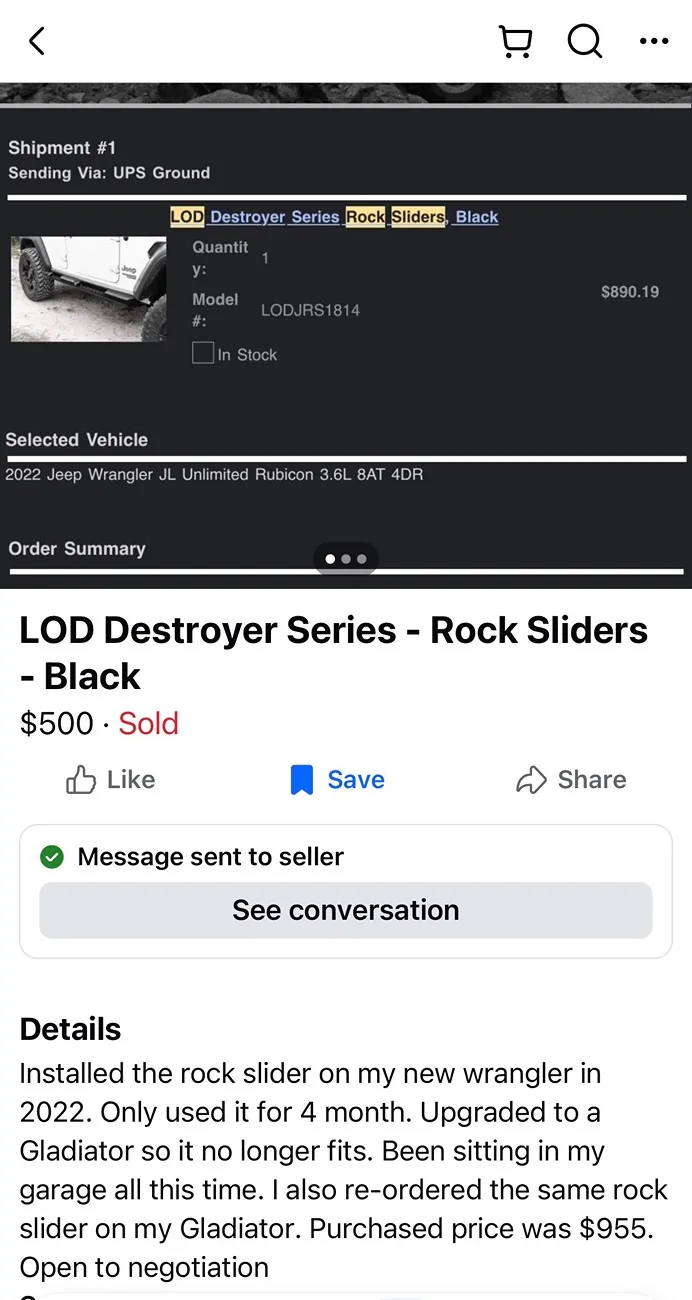

I’m quite jealous that you found LoD destroyer rock rails for $300!!!! WTH man!!!! 😂.

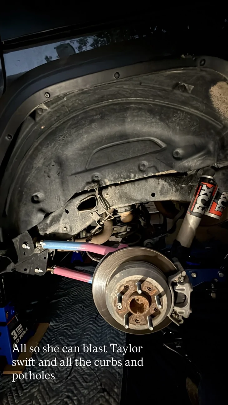

Of Note... our control arm numbers are a generic starting point based on our coil heights... we recommend doing an alignment once installed, especially with different coils, to ensure the rig is dialed in for the best ride quality. - Matson
I definitely started with your numbers im pretty sure Ive memorized your instructions by heart now. I appreciate how through and clear they were. And thank you for building such beefy beautiful parts. I can’t recommend your arms enough. I’ve convinced three of my friends to switch over so far. And you’ll see down the line some of the people I’ve bought parts from have been converted. We added each pair individually, my wife and I are both in agreement that with each set the suspension freed up (which I felt was critical for the Mojave shocks working so well early on with their stock valving on our lite 2.0l sport) also the road noise felt muted just a tad more with each addition. We live near some of socals worst roads and we always pick the jeep first to go anywhere. Your shipping was super fast too which allowed us to make some very important trips for us. While I rebuilt the arms I honestly didn’t need to, each one I took apart could’ve easily gone on without needing a refresh. Thank you.
Jeep Wrangler JL Lil Sports guide from Marketplace Mojave to a Raptor hunting journey IMG_3619
They make these 3.0’s float over every bump, my wife goes up and off curbs purposely now.

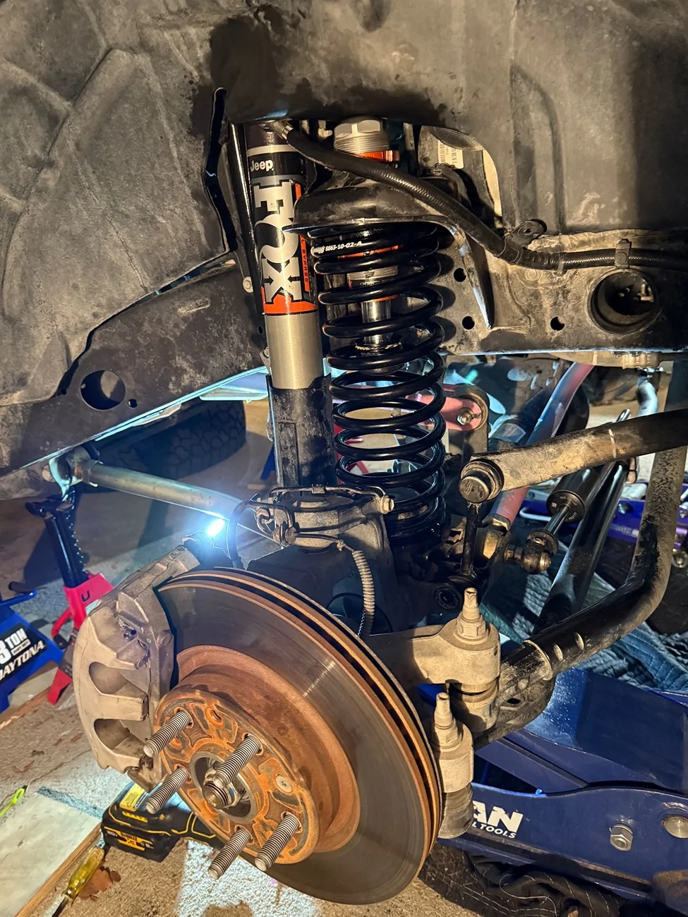

With a small teaser of where this build went, some important changes were made in this build.
First gen was just the Mojave shocks
Second was our metal cloak arms
Third would be finding ride height and hydraulic bump stops
Jeep Wrangler JL Lil Sports guide from Marketplace Mojave to a Raptor hunting journey IMG_2673
Jeep Wrangler JL Lil Sports guide from Marketplace Mojave to a Raptor hunting journey IMG_2674
Jeep Wrangler JL Lil Sports guide from Marketplace Mojave to a Raptor hunting journey IMG_2676
Fourth is the addition of some synergy one inch springs.
I might switch these out for 2in the future if i ever catch a set for sale.
Jeep Wrangler JL Lil Sports guide from Marketplace Mojave to a Raptor hunting journey IMG_2678
Jeep Wrangler JL Lil Sports guide from Marketplace Mojave to a Raptor hunting journey IMG_2680
Jeep Wrangler JL Lil Sports guide from Marketplace Mojave to a Raptor hunting journey IMG_3955
with the help of Roth shocks out of brea,ca I was able to nail down a target spring rate and these hit the nail on the head with a featherweight jeep. I found these on the forum here after 6 months of hunting and $170 in shipping they really tied the ride together. All in I paid $370 for the springs which wasn’t far off half the cost new but all the money I had in my market place funds at the time. There’s also a large part of my that likes saving parts from the shelves. Lord knows I’ve got plenty on my shelf I’d like to find homes for.

To this day our main goal is that our jeep stays perfectly flat in any corner. We rotate weekly runs to Big Bear or lake Havasu so we spend a lot of time behind the wheel on curvy uneven roads. My most his youth wheeling gutted track cars as his daily’s absolutely fell in love with our sporty jeep. You can chuck it sideways at 60 and it will skid the tires before it leans over.
My cousin and his girlfriend joined us on our Pismo trip and had rented a dune buggy to follow us around. About ten minutes into our exploring the dunes they lost power on a climb and slide into a bowl. The cvt belt broke a clutch bolt and down they went. Their replacement was slightly better but still struggle to keep the jeep in its sights.
Safe and stable are top priorities and light weight and low center of gravity seems to help those qualities. I would rather keep it mid travel and small tires than chasing it around the freeway. It’s a riot to wheel. We have 60mph winds in our area being blown around is no fun. This sport is rock solid in the winds. No hands on the wheel straight as arrow. Driving dynamics come first for us, and we verify every change we make along the way in hopes on not getting too lost on set up. I have an alignment rack available to me but we haven’t put the jeep on it yet, mostly doing all of it by feel and a tape measure for now. maybe someday I’ll throw it on just to see the numbers but for now I’m enjoying the process. I’m a one man assembly crew. And this is our first jeep but we build a lot of other things that have some crossover knowledge

Dang man great write up and pictures…and awesome you are doing a purpose built rig for your needs and environment! I love it!
I watched them sit on marketplace for well over two months. Thought worst case they say no 🤷🏽‍♂️ they needed a few bolts but I have an ace hardware across the street from my warehouse And I was really worried my wife would smash her rockers and doors. She tends to hit stuff out in the desert
