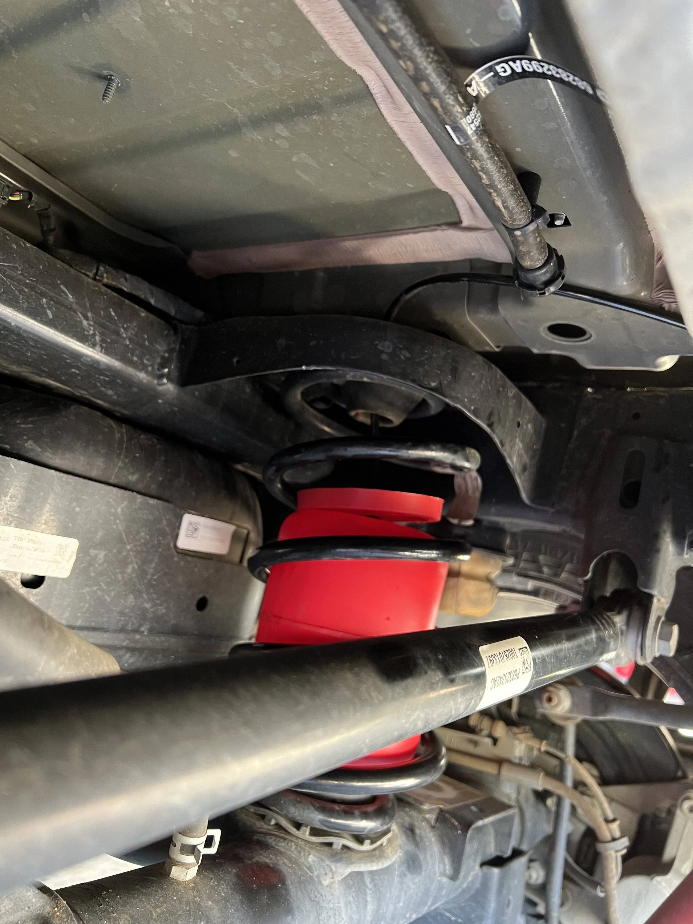

Today’s project was installing the Air Lift 1000 rear helper bags on my ‘21 JLU Willys. Having never installed anything like this before, I have to say this was shockingly much easier than I thought it would be.
With the suspension at full droop, it’s incredibly easy to install the air line and the bags. There’s a ton of room to work around. I’d seen everywhere that the hardest part of this install was shoving the bags in between the spring. I would agree but it was much easier than I thought it would be.

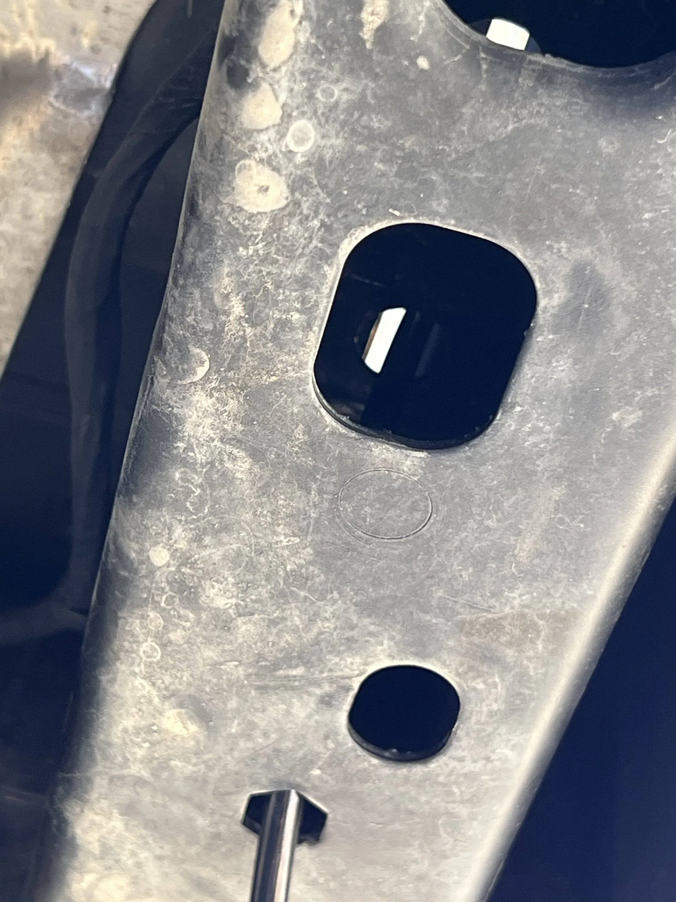

I ran my lines all the way to the rear of the frame and threaded the line down through it. Ironically, there are four hexagonal openings in the bottom of the frame that the supplied hardware fits through exactly making for an incredibly low profile install.

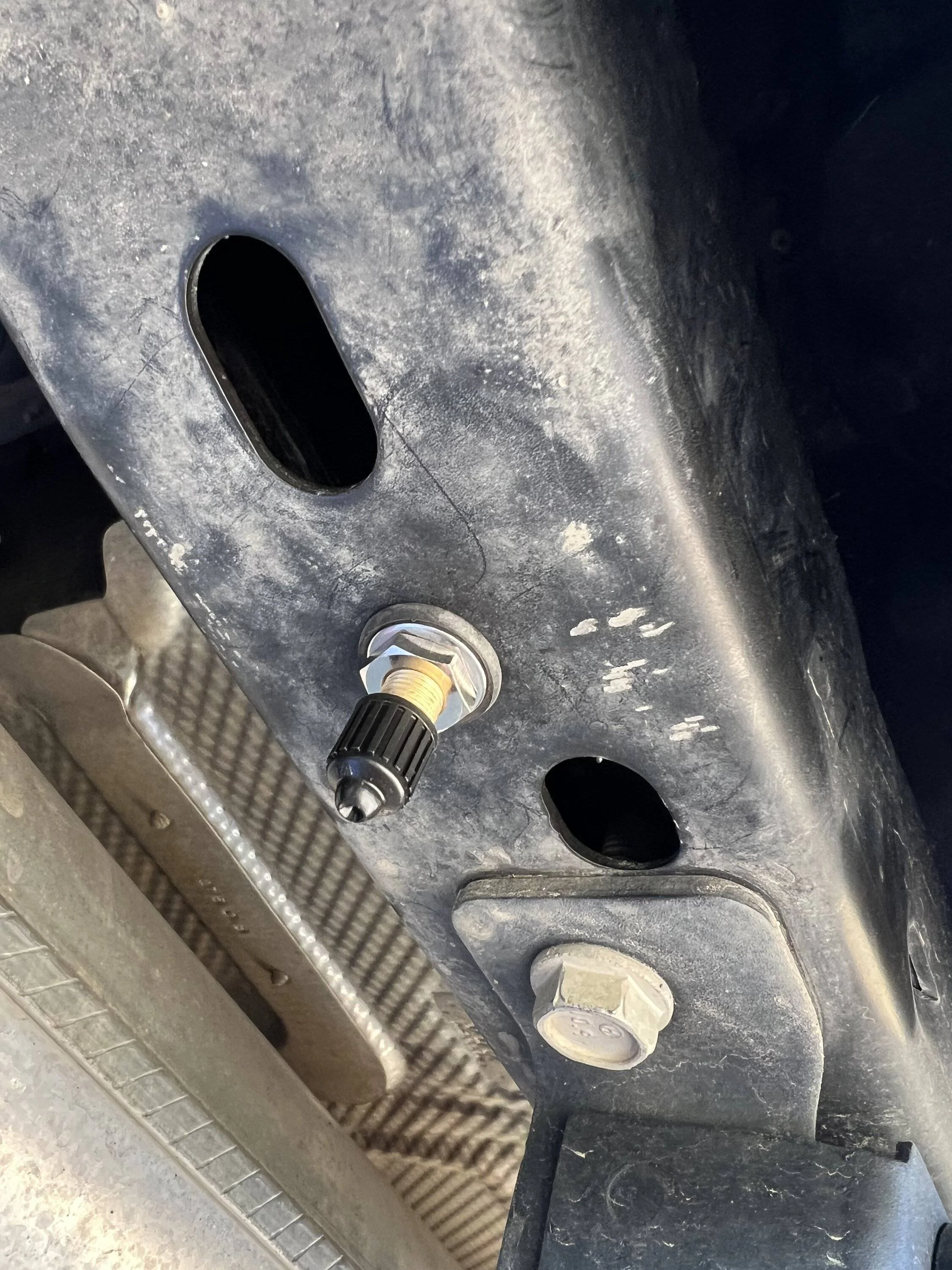

Following the instructions, you can install your valve stems right here. I had to put the lock washer in through the larger hole to the top of the picture but it was very simple the get my finger in there and feed it right over the hole.
Jeep Wrangler JL Air Lift 1000 Install - Quick and Easy IMG_6473
This makes for an insanely clean install. You cannot see the valve stems when standing behind the Jeep, which I like and I think will greatly discourage someone coming along and messing with them. I also just like a more factory installed look but that’s just me. If you have the Tow Package, one of these hexagonal openings is being used to secure the trailer plug bracket but there are three others to work with.

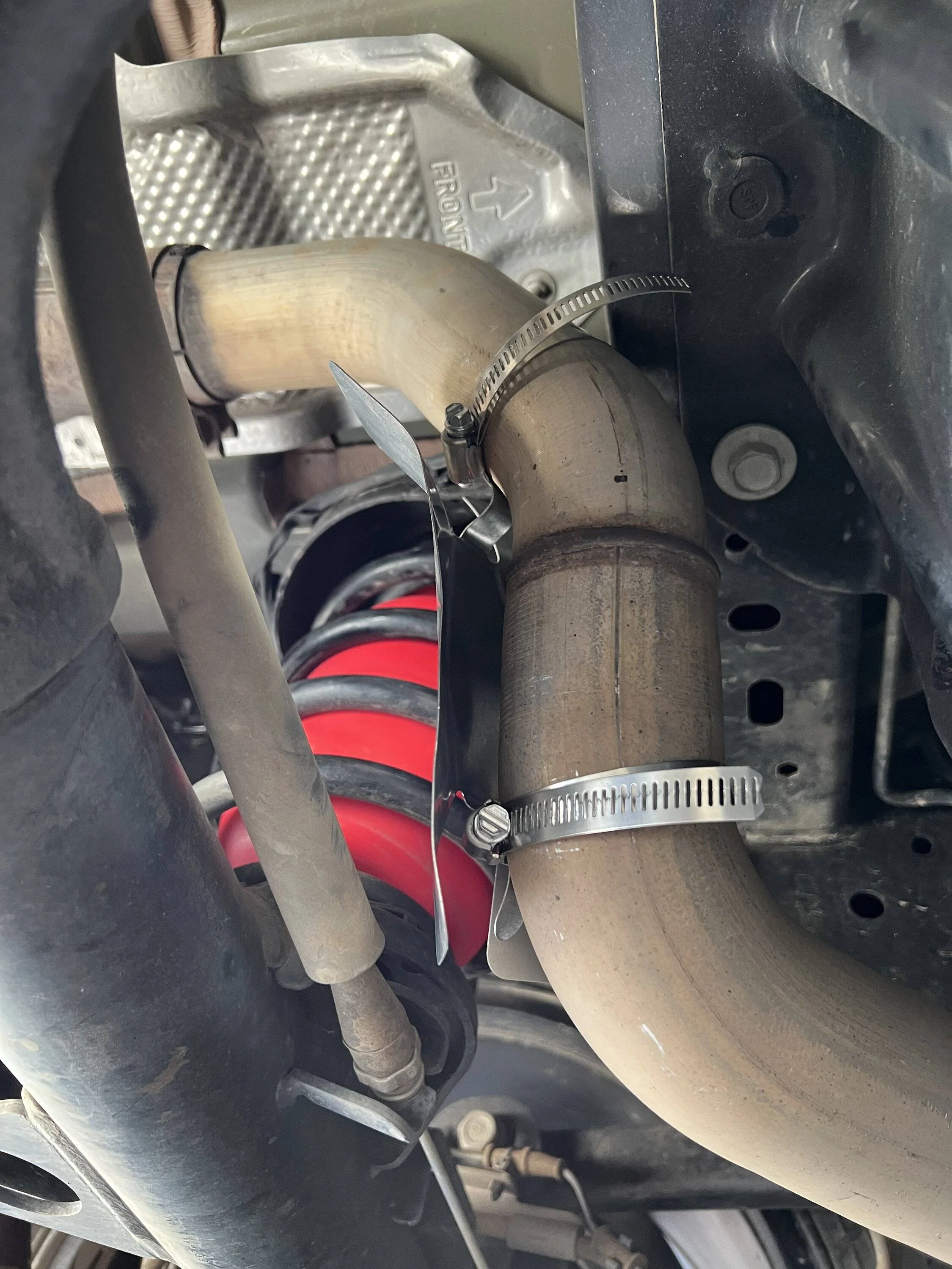

Installing the heat shield was definitely the quirkiest part of this install. I have the 3.6 so the exhaust runs down the driver side.
Jeep Wrangler JL Air Lift 1000 Install - Quick and Easy IMG_6483
The install is frankly quite easy and the heat shield is very pliable and can easily be shaped to the contour of the exhaust. I will say, I felt like the instructions were lacking here and there’s really nothing said about where and how to place it. I mean it’s kind of obvious what it’s trying to accomplish but I think it would’ve been nice to get some reassurance from the manufacturer that it’s in the right place.

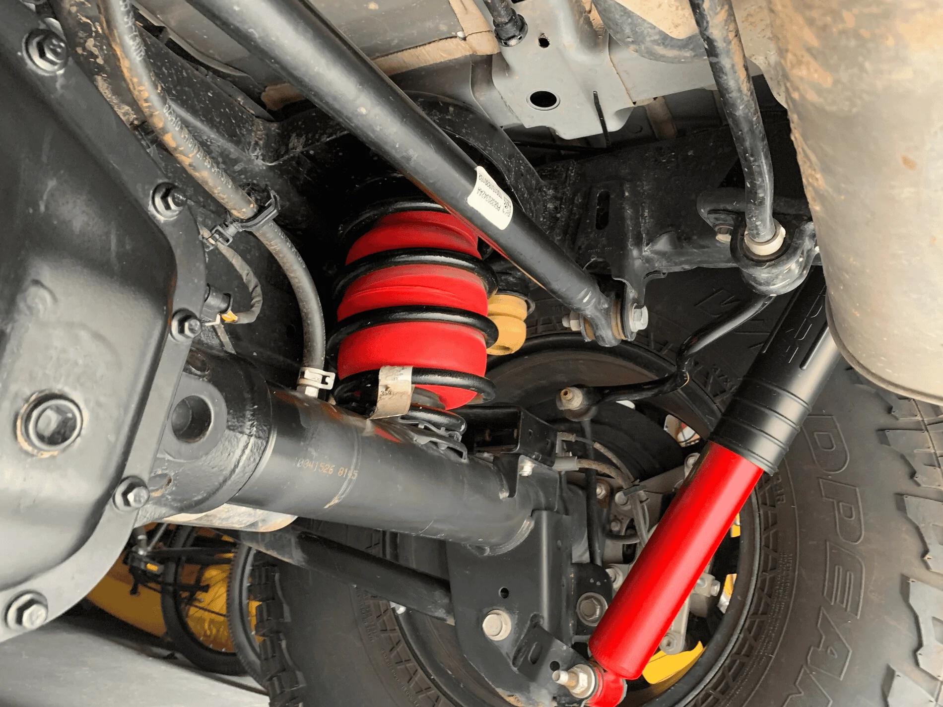

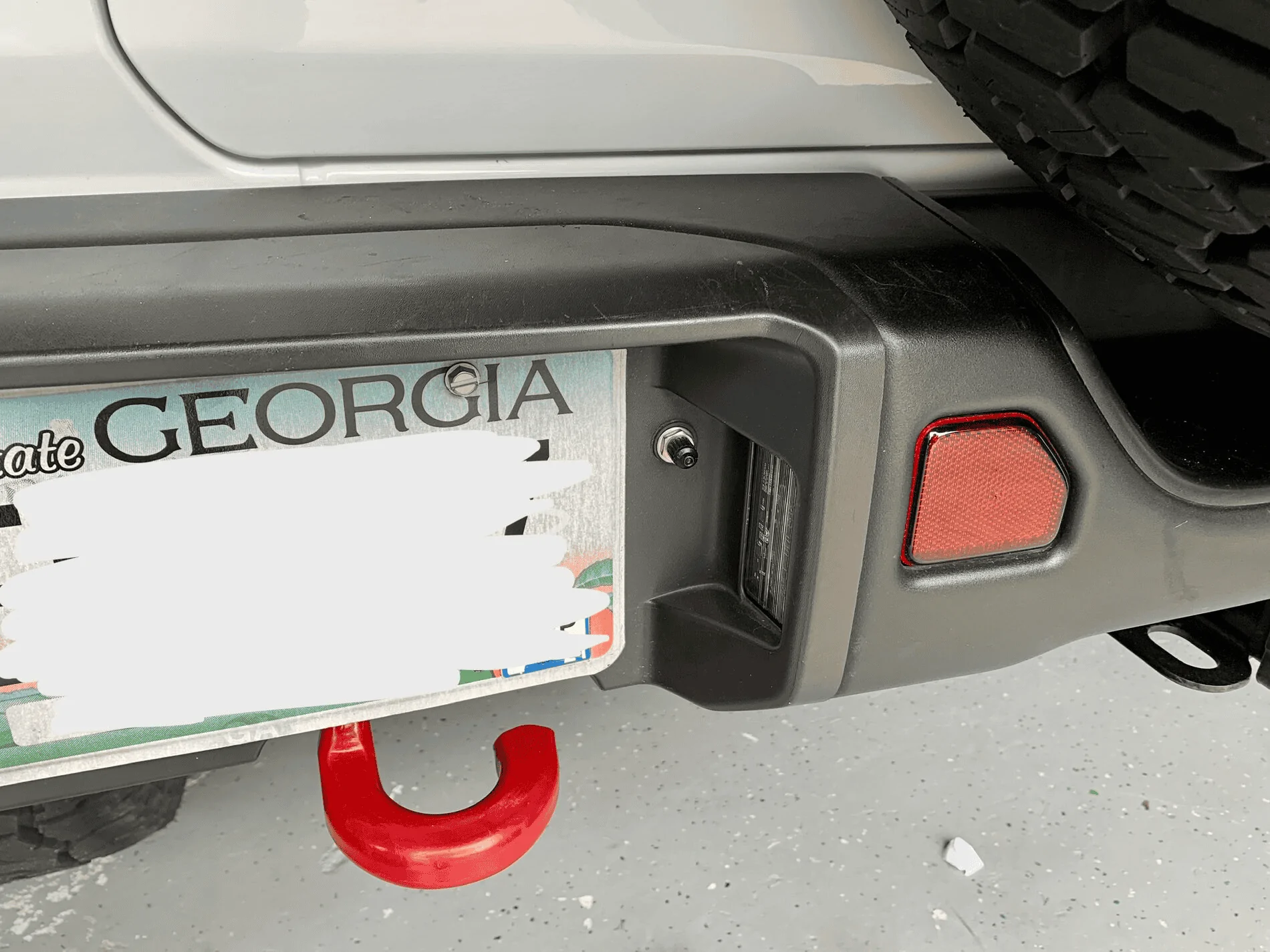

I installed the kit in 2021 and have been very happy with it. The functionality that you get for the money can’t be beat.
I had concerns about wheeling with it, and have been pleasantly suprised that the bags both still hold. I did have to replace one section of air line that was pinched on a wheeling trip. I also have limited suspension travel over stock with a 1.5” lift and a 2” bump stop extension so that may be a factor in longevity when wheeling. The Jeep is more family rig than anything else but we have been on challenging trails since installing this: Windrock, Choccolocco and 3 or 4 other trips.
It was great when we had the trailer, but even since we got rid of the trailer, I’ll add/remove air at my leisure if I don’t like the way the jeep is sitting. It also helps with squat when loaded down for roadtrips/cargo carrier/bike rack. It’s such a small volume of air I just use a bike pump and it’s easy access at the rear bumper.
After a front lunchbox locker in a TJ, it’s the best bang for the buck I have ever spent on a vehicle mod.

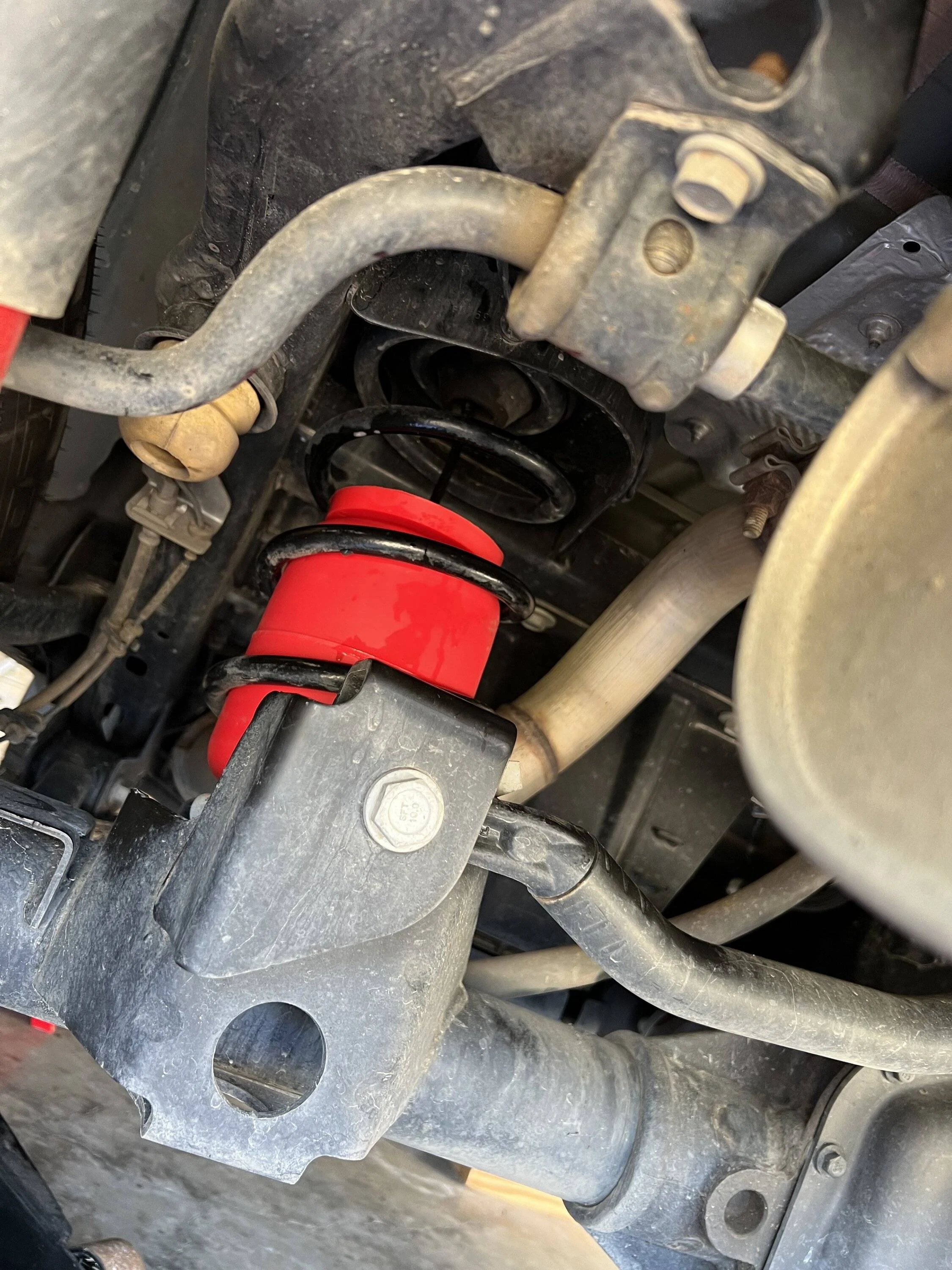

Added a picture of where and how I installed the heat shield. I took the picture within less than a minute of getting back home today with the exhaust and everything still nice and hot. The bags and the lines felt more or less cool to the touch so I feel confident now nothing is going to melt or get too hot.
