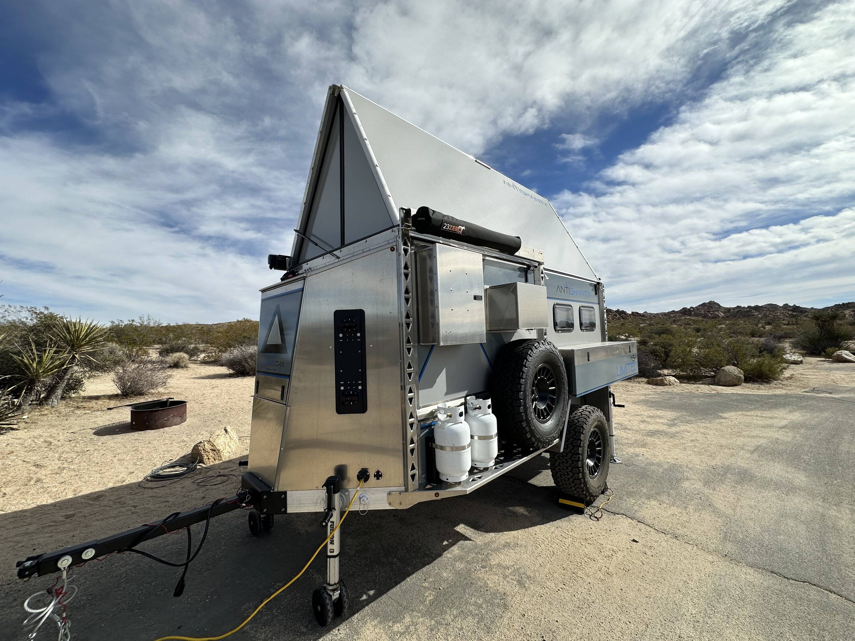

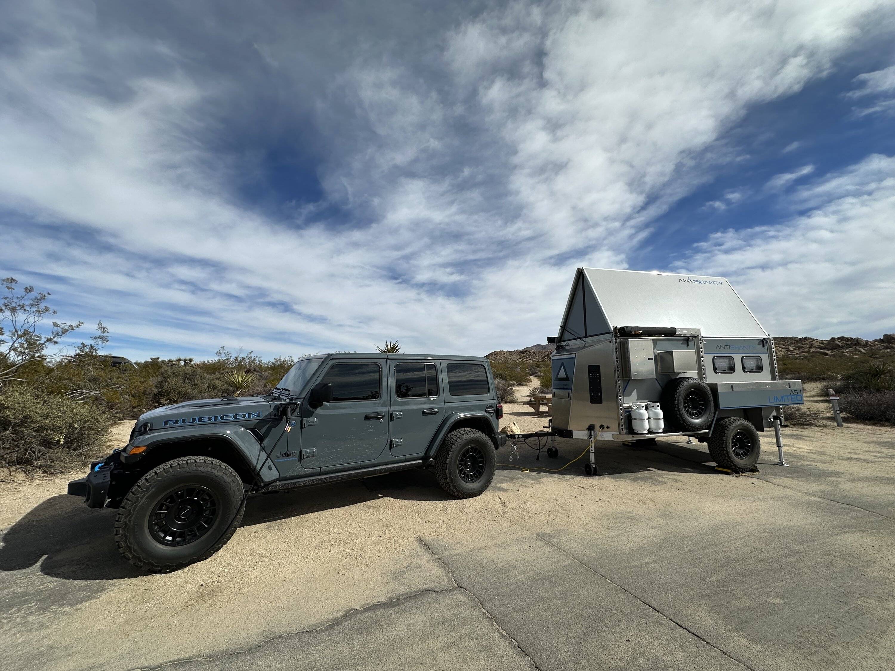

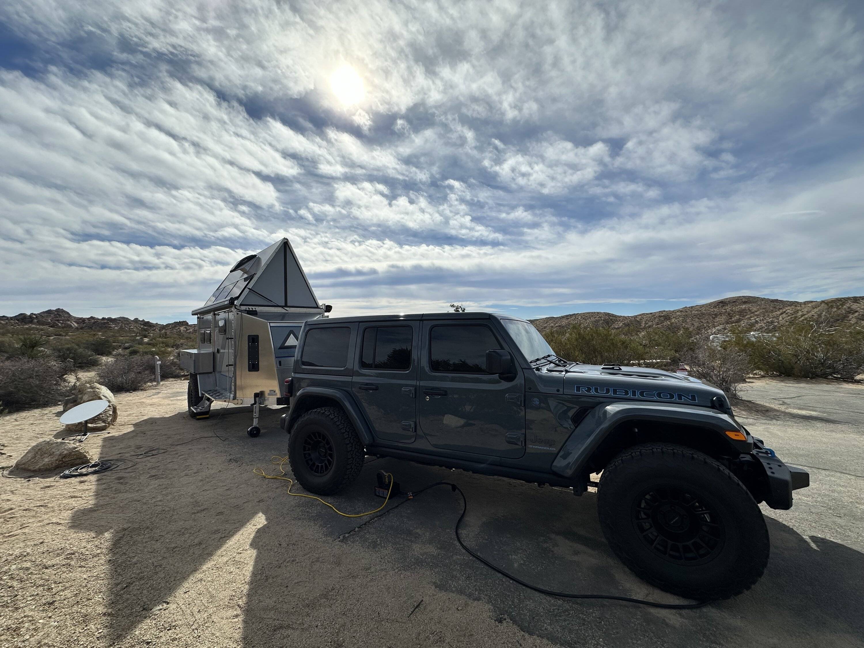

I recently returned from camping in Joshua Tree National Park (JTNP). All of the designated campground sites in JTNP are without electric, water or sewer. This was the perfect time to see how my Jeep's Power Box would perform. TLD; it worked great!
I would put my 4xe into "Battery Charge" mode while out exploring the park which would top off the Jeep's 17kWh battery. When I returned to my trailer, I would plug the trailer into my Jeep's Power Box. Not only did it power the entire trailer, but it would charge my trailer's 4kWh battery pack. This allowed me to unplug the trailer from the Power Box in the evening.
There was one thing that seemed strange to me. When using the Power Box the Jeep would turn on the driving lights (headlights only). When it started getting dark I had another camper come by to let me know that my Jeep's headlights were on! In hindsight, maybe it was because I was running the Power Box in Hybrid mode...? I also noticed that I needed to turn off the climate control and the screen. Seems like the Jeep should be smart enough to do this. Please let me know if it's user error.

No, I tried turning the headlights off, but it didn’t work.
The trailer is built by a company called AntiShanty. It’s been an awesome pairing for the Jeep 4xe. Couldn’t be happier with it and post-sales support from AntiShanty.
